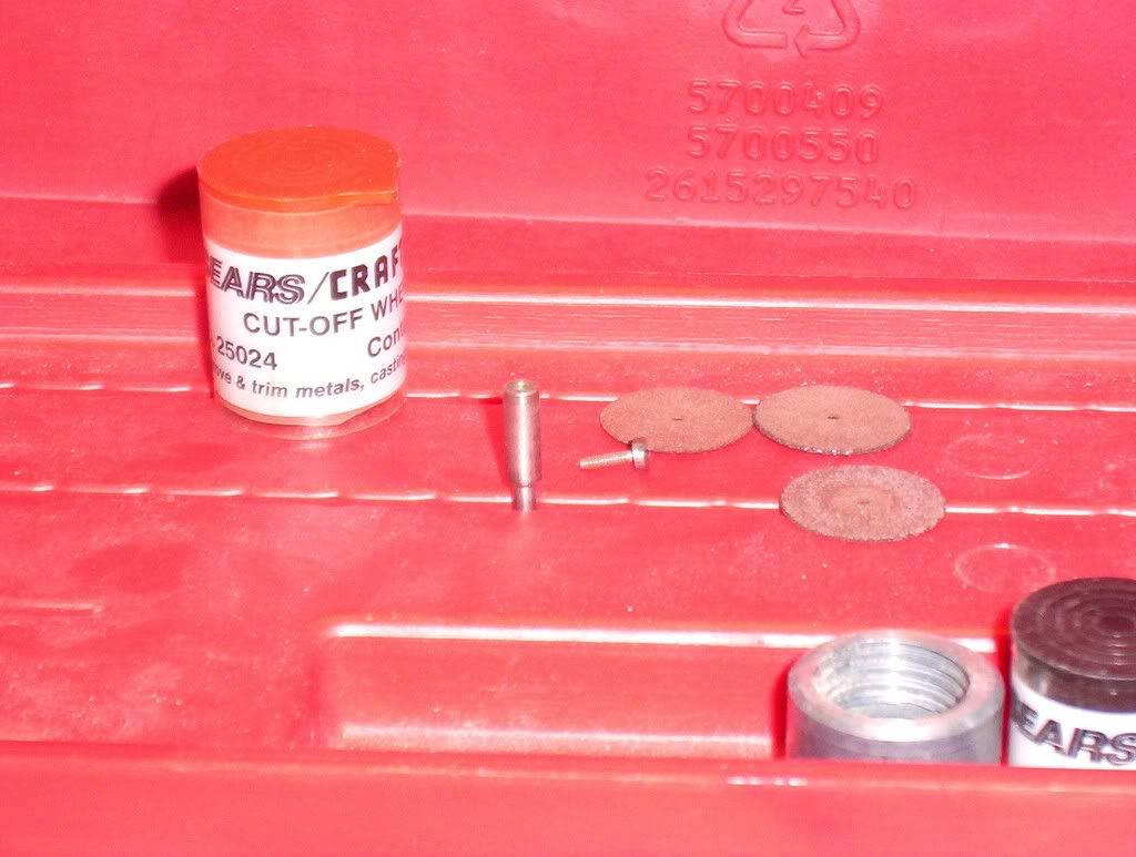

mikelo Posted May 18, 2007 Author Posted May 18, 2007 Sorry jbwelda, I will try to take some pictures. I just figured that if you had a Dremel, you would be familiar with the piece for holding the cutting stones. It is a common piece as it holds several different styles of cutting stones, wheels and sanding disks. They are held on by a screw. I just realized you can put more than one disk on at a time.

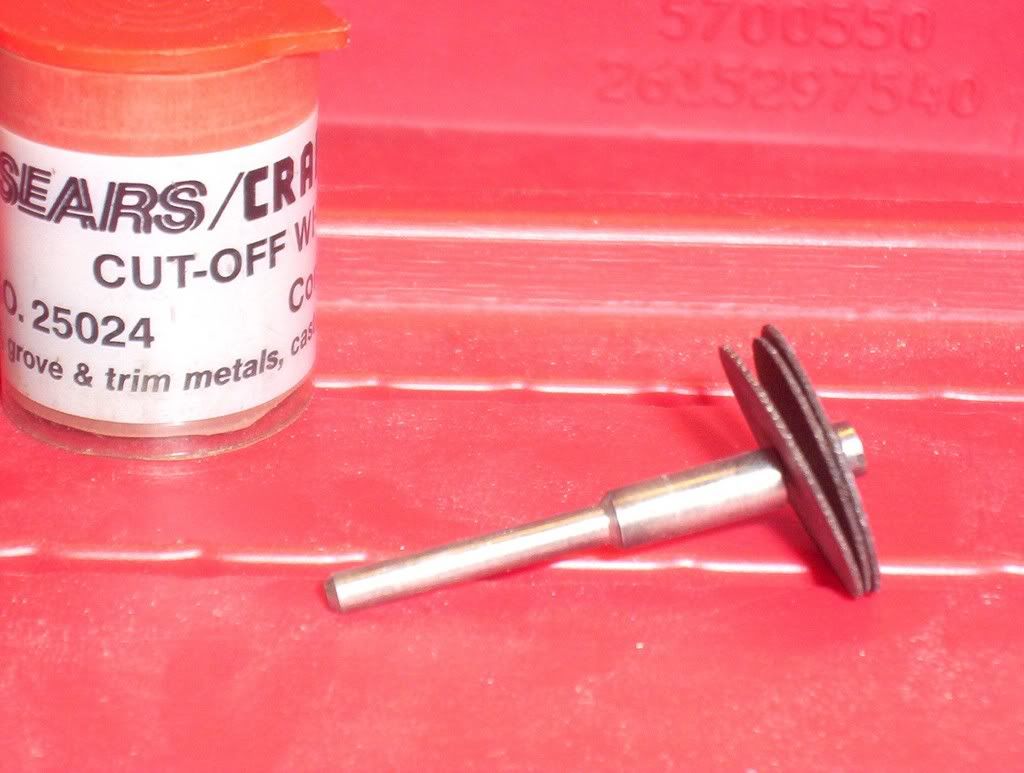

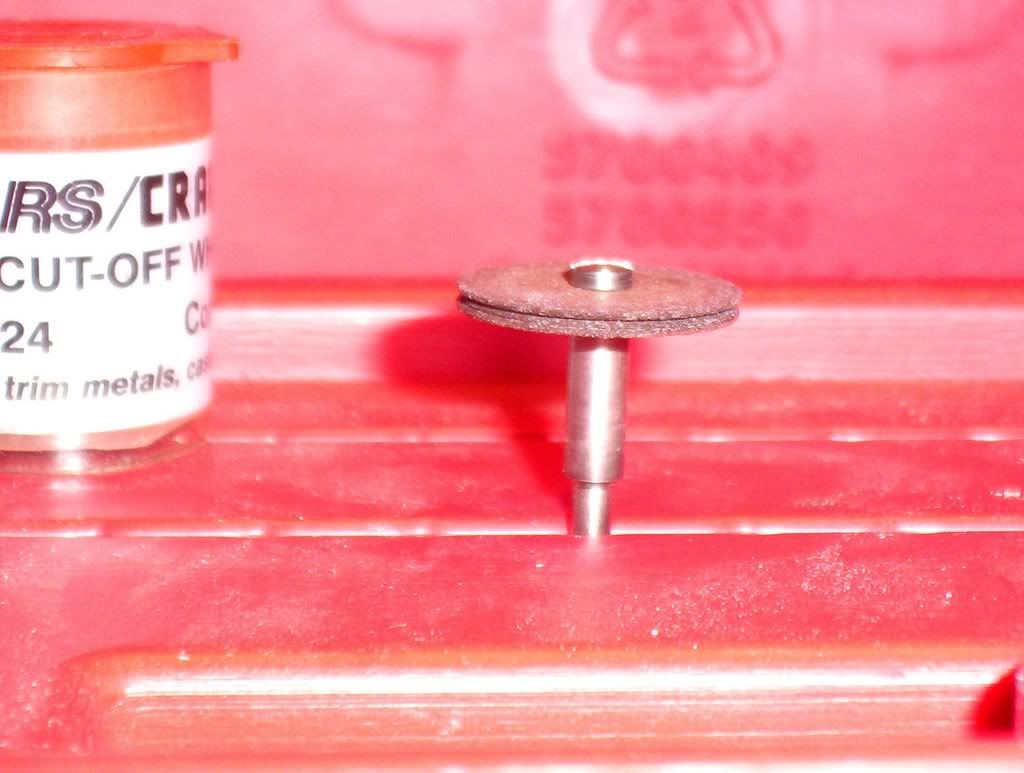

mikelo Posted May 22, 2007 Author Posted May 22, 2007 OK, here are some pics to try to help explain. The mounting screw and disks. 3 disks on the mounting screw. Tighten the screw. Hope this helps.
