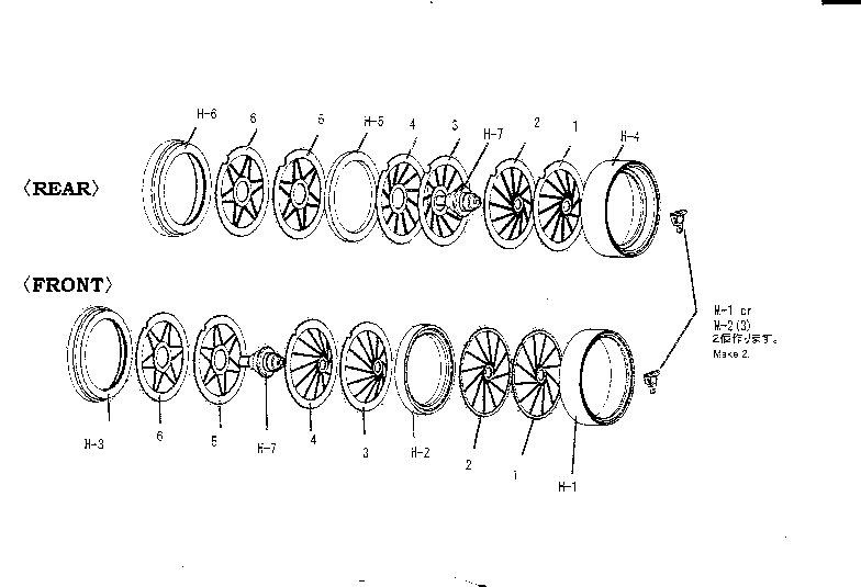

sjordan2 Posted December 31, 2011 Author Posted December 31, 2011 (edited) On 12/31/2011 at 9:36 PM, Futurabat said: I always scuff the glue surface (and any surface recieving paint) with 400 grit paper. Next, the same surfaces recieve a coat of self etching primer. These two actions give purchase, or bite if you will, to the paint/glue. The location of where the part will mount decides the adhesive for me. Sometimes super glue is appropriate and other times epoxy. I have also mounted these parts using Future, or double sided tape. I hope this is some little bit of help. 1. Etched to resin = super glue/epoxy 2. Etched to painted surface= Future/epoxy/double sided tape 3. Etched to bare plastic= super glue Thanks. That helps in attaching to the model. Regarding the Borrani wheels and wipers, I'm talking about metal-to-metal assembly of the PE parts. This is clearer than the wiper parts. The problem is, the MFH parts are intended for the Ferrrari 250 GTO, which has a deeper dish for the rear wheels, and I'm trying to put these wheels on a Maserati 3500 GTi, which has the same wheels all around. I can't figure out how to assemble them, or how to make the rear wheels the same as the front wheels. Further, there are three different sizes to the rim parts, which don't have parts numbers. As you'll see below, they don't give any indication as to how the spokes should be oriented or twisted relative to one another, they just stack the spoke parts on top of each other. This is why I'm asking for a person who is experienced with these parts to do a tutorial. Edited December 31, 2011 by sjordan2
