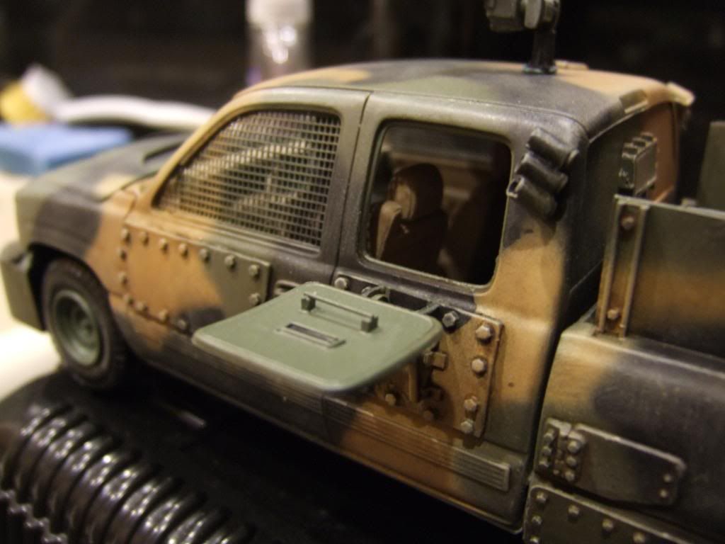

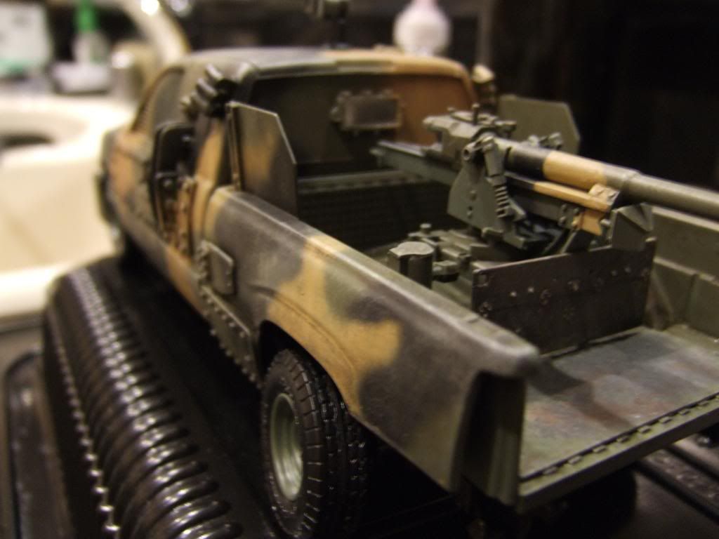

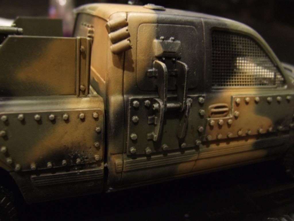

Agent G Posted February 2, 2012 Posted February 2, 2012 All the weathering so far was done with oil and enamel. You can clearly see the difference between the body and the wheels, which have not yet been weathered. More to come. G
outlaw035 Posted February 2, 2012 Posted February 2, 2012 G...ur recon truck is look'n better all the time...grt8 job on the rivets....

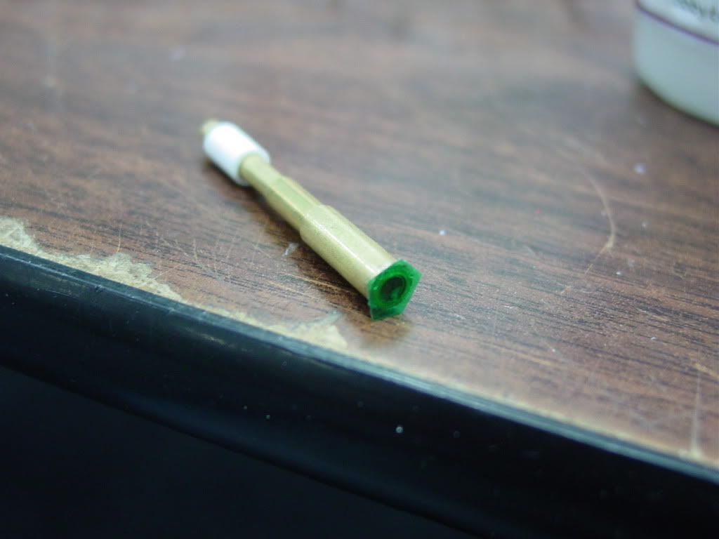

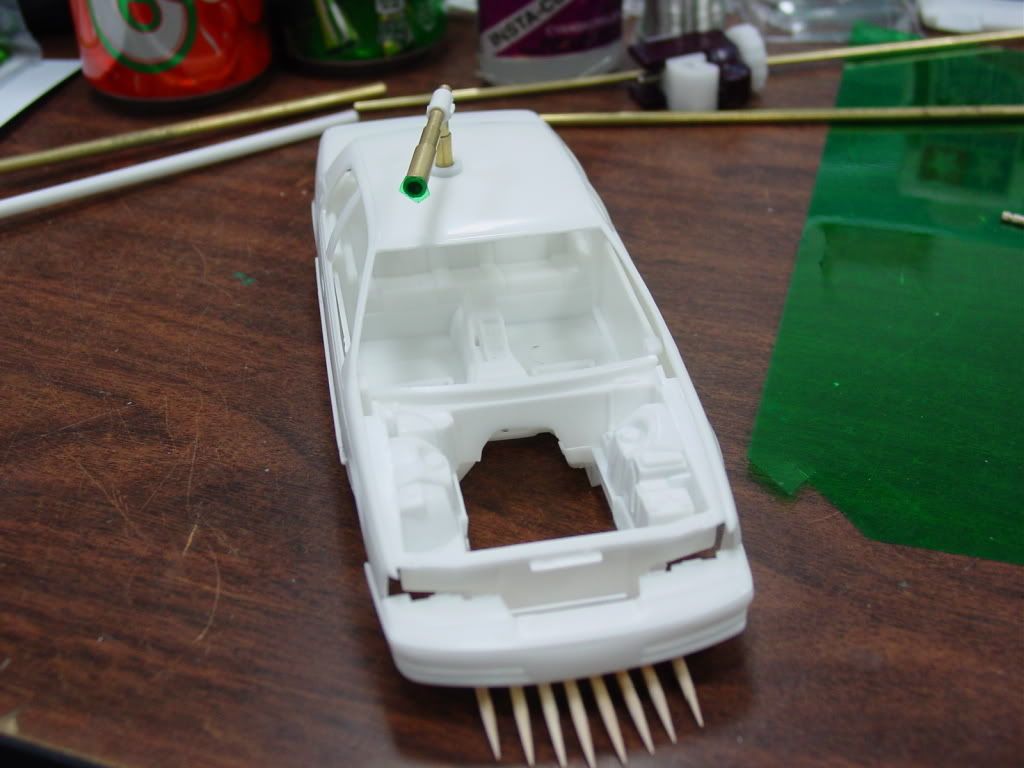

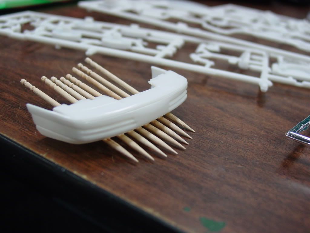

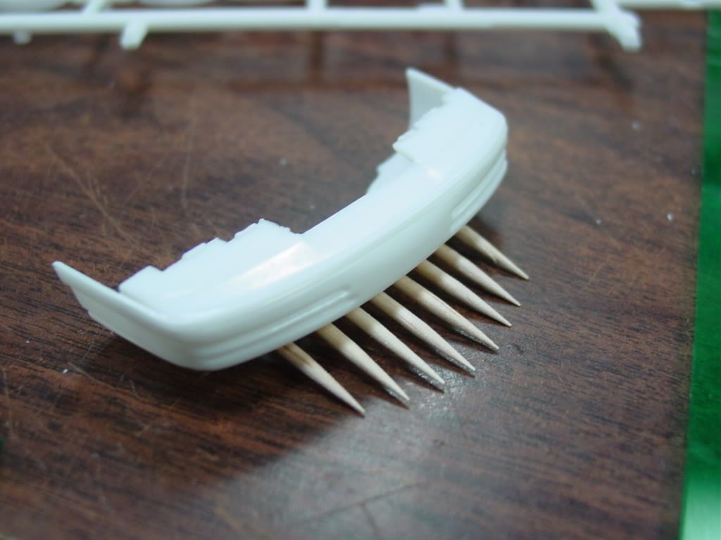

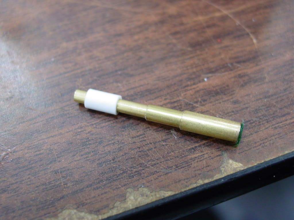

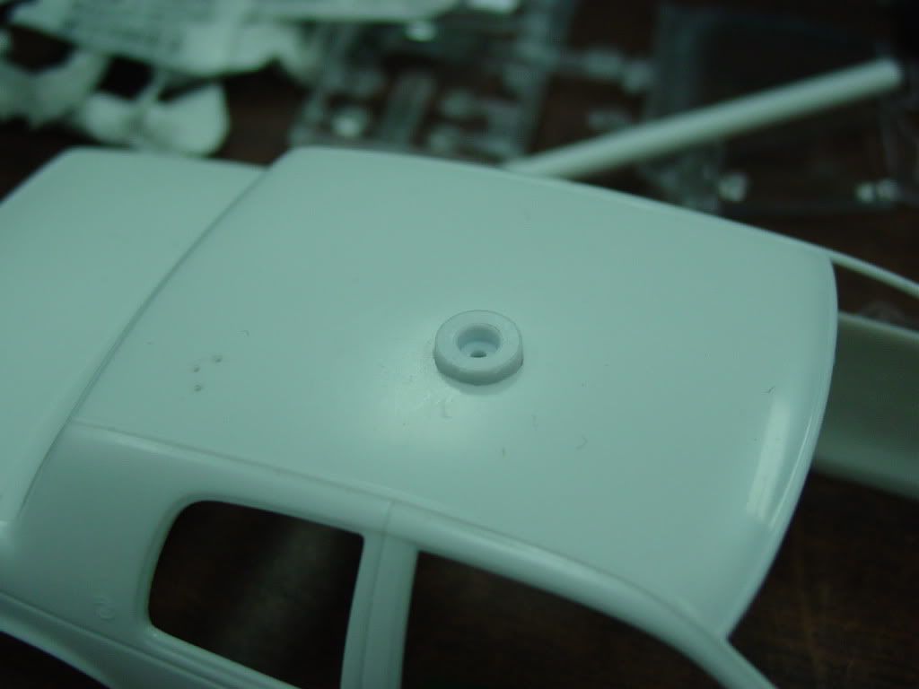

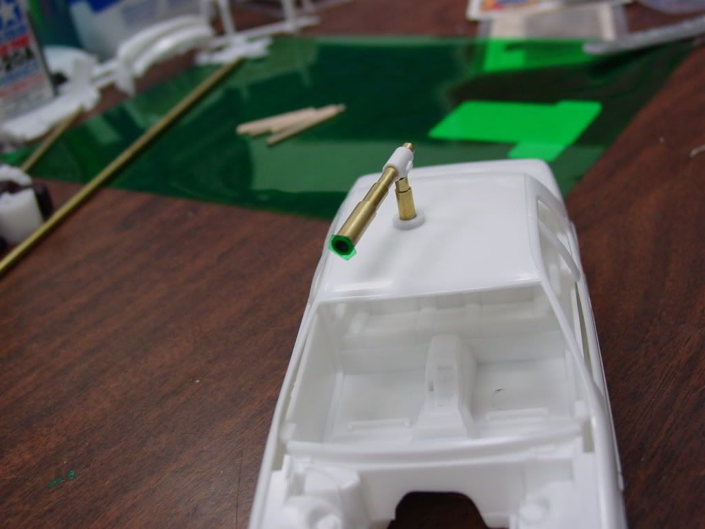

wgflatliner Posted February 2, 2012 Posted February 2, 2012 alright i started working on mine. i'm going to call this genre a scout or reconnaisance type of vehicle. it's a 92 mercury cougar. aftermarket stuff include animal print decals from scale motorsport, some brass tubing, clear styrene, styrene rods and pattern styrene sheets so far. i started with the spikes in the front with some toothpicks i used the brass tubing to create the scope along with styrene tube to help create a mount. i used clear green styrene to form the lens on the front. i figure that in the future, they wouldn't have precision cut lenses, so i made it look like a piece of glass that was slapped on. i then cut out an off-center hole in the roof to place the scope. it's off center on purpose as i plan on having a hatch in such a way where it'd line up with the user's right eye. i will also be putting in an arm rest kind of deal on it. I know that to make this scope functional it will require the use of modifying the interior extensively. so be it! that'll be soon enough once i get the body work done. i also drilled out some holes for some antennas. more pics coming

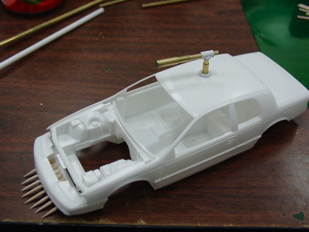

wgflatliner Posted February 2, 2012 Posted February 2, 2012 i took one of the mounting tubes and cut it in half to create a mounting bracket to the mount, and some more brass tubing to replicate the idea that the scope can be adjusted vertically. it is inanimate, and won't move. but you can see through the scope!! and the body mocked up with the current progress. enjoy!

Kit Basher Posted February 2, 2012 Posted February 2, 2012 Wayne, that recon truck is looking great! Tailgaters beware!

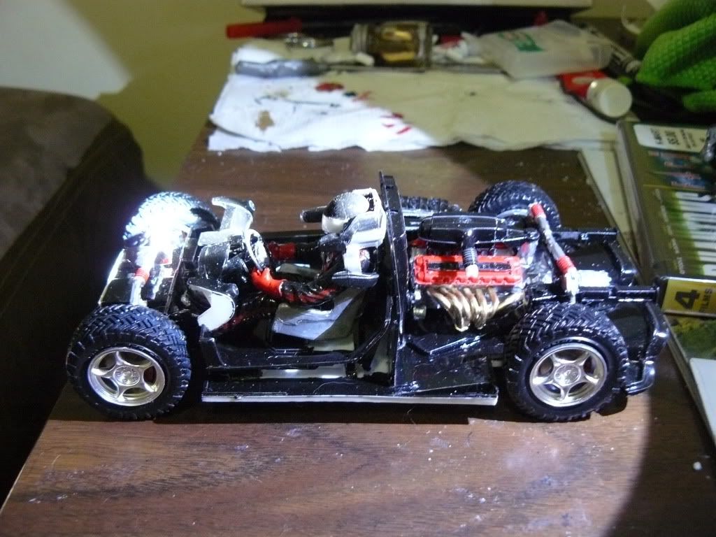

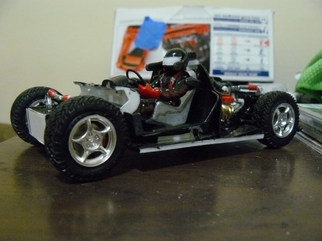

001slick001 Posted February 2, 2012 Posted February 2, 2012 Here is what I've been building.The engine and chassis are from an Enzo kit.The rims are from an RX7 kit and the tires are from a jeep kit.The driver and seat are from a NASCAR kit.I'm going to have to scratch build the body.The engine will run on corn whiskey,easier to make and find than gas.
blazefox Posted February 2, 2012 Posted February 2, 2012 slick ur enzo is awesome Tenderizer lookss awesome Scout truck with the flak cannon in it looks awesome Gonna post pics soon of new project Codename : ROADRAGE
