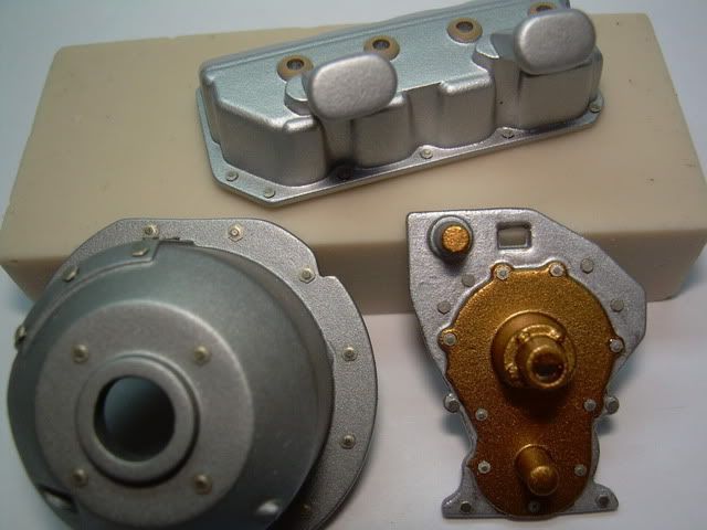

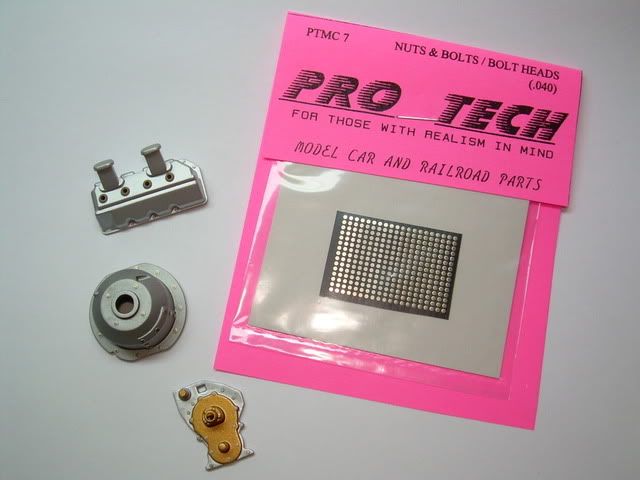

Pro Tech Posted January 17, 2012 Author Posted January 17, 2012 Thanks guys, appreciate it. Just a very small update here. I wanted to show how my Nut/Bolt Heads (PTMC 7) can be used in 1/16 scale. These are listed in my 1/25 catalog but are really a multi-scale item. I used the .040 size here and used Future (floor coating) to attach them. Thanks :as always" for looking. If you have any questions, please ask away. Charlie Pro Tech
eviltwincustoms Posted January 17, 2012 Posted January 17, 2012 Thanks Charlie for the update. So I have to ask, with your Nut/Bolt set when you pull them off of the black backing are the backs of the PE flat? The reason for asking, is I purchased some Nut/Bolt PE, can't remember who now... but when I went to apply them the backs of the PE had like a raised area. Causing them to not lay flat on my subject matter. Or is there a process one should use to get the PE part off of the back paper backing so this doesn't happen? Still new to the small PE parts that come on this paper backing stuff. I have only dealt with PE on the tin tree sort of thing..
John Pol Posted January 17, 2012 Posted January 17, 2012 Charlie you always do nice work. Now can explain how you attach those PE nuts in bolts. Or better show photos on how you attach them. I always to buy them to use them but have no idea to do this if I did I would buy them for sure. John Pol
Mooneyzs Posted January 17, 2012 Posted January 17, 2012 (edited) Hey Bart... you should be able to take your xacto knife and slide the tip under the bold head very carefully and pull off the rubber backing. tje rubber backing is there to hold the parts for lack of better the packaging. depending how the PE parts are made is they either tend to be on a tree where ou have to cut then off and then file/sand or in my opinion the ones on the rubber.backing are more user friendly but cost a little more to make. John... wth these bolt heads you basically take them off the backing and you will need to glue them to whatever parts you want. You can glue them with white glue, 5 min epoxy, gator glue (its a white glue kind of like micro scales krystal kleer glue but is an acrylic glue) and future floor wax. I have yet to try it Charlie's way with using Future but really want to try it out. I yhink it really boils down to personal preference on what you find the easiest and best for your application. you could do ca glue as well but would need to be careful because where it sticks it may be stuck. the other allw you time to get it into position. Edited January 17, 2012 by Mooneyzs
Pro Tech Posted January 18, 2012 Author Posted January 18, 2012 Thanks Chris for chiming in with the great info. Like Chris said it all boils down to personal preference on gluing etc. so here's the way I glue P/E parts. First, Bart, the nuts/bolts are perfectly flat on both sides so they lay flat on your subject. On gluing any P/E parts this is my process - if the surface is gloss or semi-gloss I use Future (floor coating), I think it's now called Pledge with Future Shine. I use a very small (00000) brush and apply a small dab (smaller than the part size) where you want to apply the part to. Next use the same brush to pick-up the part and lay it down onto the dab of Future you applied. If you need to move the part use a toothpick to move into final position. If you make any mistakes you can use glass cleaner and clean the Future off and start over. If the surface is a flat sheen I will use 5 min. epoxy. Charlie Pro Tech

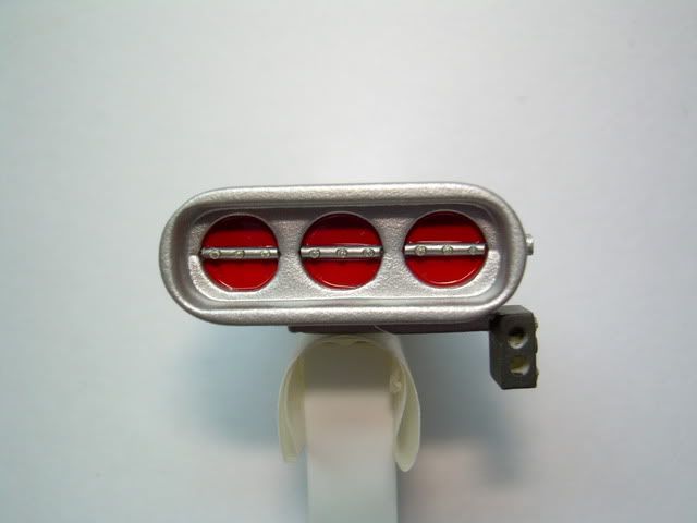

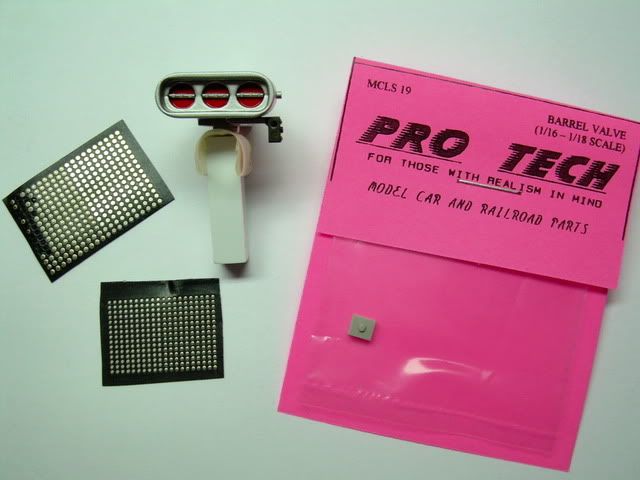

Pro Tech Posted January 23, 2012 Author Posted January 23, 2012 Hey guys, got a little more done on the injector hat. I have listed descriptions below pics. Thanks for looking! Pro Tech parts I will use to detail the scoop - PTMC 7 Nut/Bolt Sets .020 and .030 along with MCLS 19 Barrel Valve. Here is barrel valve installed detailed with the .030 nuts/bolts. I tossed the kits butterflies, made new ones out of sheet styrene and glued them from the backside. I glued the scoop halves together, filled/sanded the seam and final sprayed with aluminum color. To do the cross-shaft I used some small solder (.028 I had) cut to fit the three openings and glued in place with Future. Next I added the .020 nuts/bolts to the shaft also with Future. Charlie Pro Tech protechmodelparts.com 1
Mooneyzs Posted January 23, 2012 Posted January 23, 2012 (edited) Charlie... that injector hat is looking great. the detail is very clean i think I am going to have to borrow your idea on the bold heads on the solder. That looks killer. keep up the great work on this. Edited January 23, 2012 by Mooneyzs
