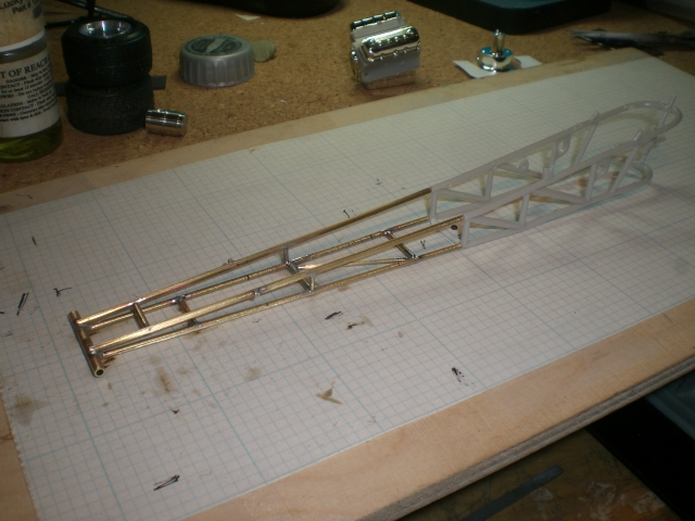

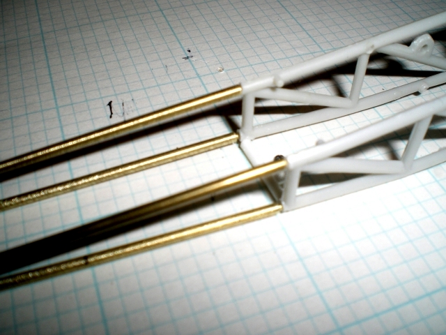

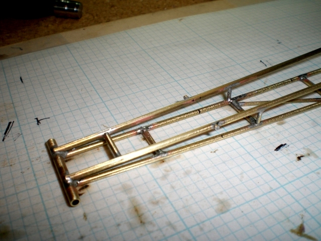

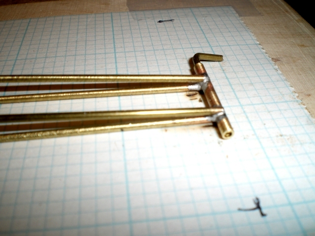

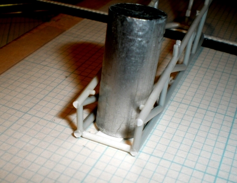

I build on graph paper making it far easier to keep things inline. I made a temp cross beam with a tab glued on to have a way to anchor the frame down to the flat base. Then used a small screw to center the frame. As you can see, being off center shows up instantly. I drilled out the ends of the frame and inserted pins. I used 1/16th tubing to make dead straight rails which will add a precision look (hopefully!) to the finished frame. Once cut to length, they were soldered to a tube. Again the graph paper made everything go quickly. The pins allow all of this section to be removable until final assy. So no worry melting the back half while soldering the front. Of course I had to set the body on the frame. I waste alot of time doing that kind of stuff.

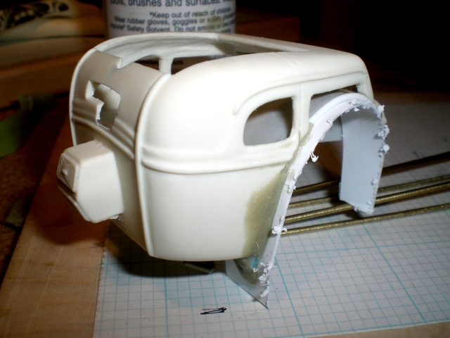

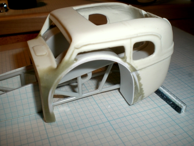

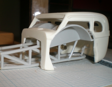

I started cutting the body up in order to slam the thing all the way down. Plus I wanted to move it forward...so I attacked it with a barrel sander in my Dremel. The Jawbreaker had a vital piece of internal tub that needed serious trimming to fit the resin body. Plus at this point, I had to grind out the roof's thickness. Once I had the body on the frame with the tub and double checked everything... a couple drops of super glue locked in the tub and body forever. BTW I did pre-sand the tub.

Nice work so far, especially hacking up a Flintstone resin - not my favorite pastime... I like the tub and the resultant lowered body position. I'm looking forward to seeing more on this one. Do you find the visit the drag racing world different in any way from your sojourn in the world of F1, Prototypes and Japanese models?

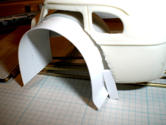

Back to this tiny model. I know it's looking rough right now. It's about to get worse. I'm not saying this is the best way to do this...just another way to do this. We all have something to offer.
I cut a couple of strips and pre-bent them over a 1/2" rod to 'help' it conform to the inside wheelwell. They were glued in place. One side was pretty close..the other way off. I bridged the gap with a piece of plastic. I use a fantastic product from AVES Apoxie called Apoxie Sculpt. It's basically A/B epoxie putty. It's a little like soft warm clay. Not sticky to your fingers and easy to mold in and around areas. I bridged the gaps all around the body and wheelwells and let it dry for a couple hours.
It was important to get the new bottom side window line equal in thickness. Also the edge is not square, it's rounded. I used a piece of rod to define the path and create the new wheelwell's outer edge. I got lucky. The gap just happen to be wide enough to countersink the rod to the depth of the bodies outter surface..... :blink: Ya following that!!??

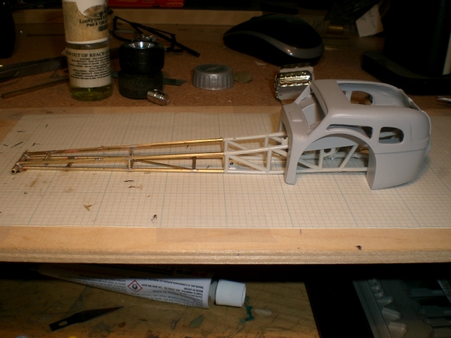

More 1/16th stuff arriving! But I don't have this body in 1/16th so this will have to do. This doesn't have to be any super detailed build. Just having fun and it's capturing the look I am striving for.

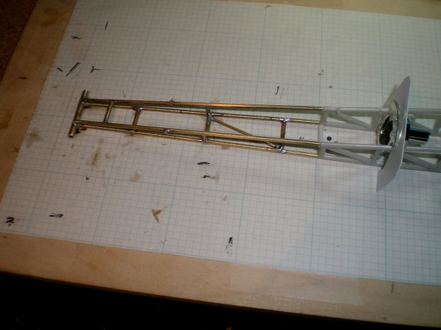

I started on the forward frame this morning. While it's harder to cut brass, it's way easier to allow solder to fill and contour around a joint. I'm trying to get in the habit of pre-sanding all tubes before cutting and installing. It's so much faster than cleaning up after the build. The Flintstone body is what it is. I sanded off the drip rail over the windows because it was poorly finished. I'm almost to the point where the rough body work is done. Some internal smoothing, exterior sanding and body mounts come next. I need some old school M&H slick tires. I'm out of my element here. I had a set in the 60's! They are gone now. I did find an aluminum moon tank. Always wanted one as a broke teen....but never bought one. Any aftermarket making a good resin slick?
Every time I look at this, all I see is red color on a black frame. If this is an old car, I guess there wasn't alot of choice back then.

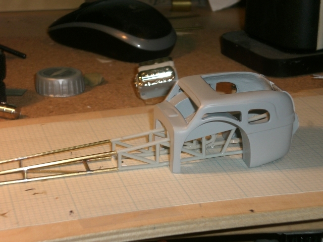

I started on the front suspension with no plan at all. The kit's axle was held together with the bodywork, not really attached to the frame. The part itself was horrible. The middle section would never look as round and polished as it should. I tried bending an axle, etc, with no great breakthrough. Then I decided to just use the ends. I cut a couple pieces of brass 3/32nds tubing and soldered them to the end of the fork. I piece of 1/16th alum tubing held them in alignment while soldering with no fear of soldering the tubes together. A piece of tubing will be kept in place with hidden joints, when the parts are finally installed. The outer parts are glued forever. It will allow me to build the radius rods, steering ,etc.
The next big problem was the inside of the shell. It was rough from chopping and grinding and was pretty poor to begin with. I smoothed it out some and brought out a marvelous product. Apoxie Paste, is a must for blending shapes together. It's the worse product ever to apply, being an extremely sticky, gooey paste. I put it in place then cleaned my hands and the car body surface. Once you wet your fingers with their solvent, the top surface melts away allowing you to push and contour the paste into a perfect smooth surface. I also used a wet Q-tip to shape the paste. Once finished, the paste appears continues to pull back and recess itself into the corners (i think) while it dries. Or it's just getting translucent so it appears to be shrinking. Anyway the stuff is like magic. The photo's are right after i finished smoothing out the paste and a final wipedown of the surface.

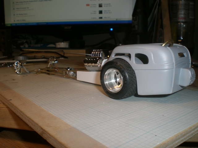

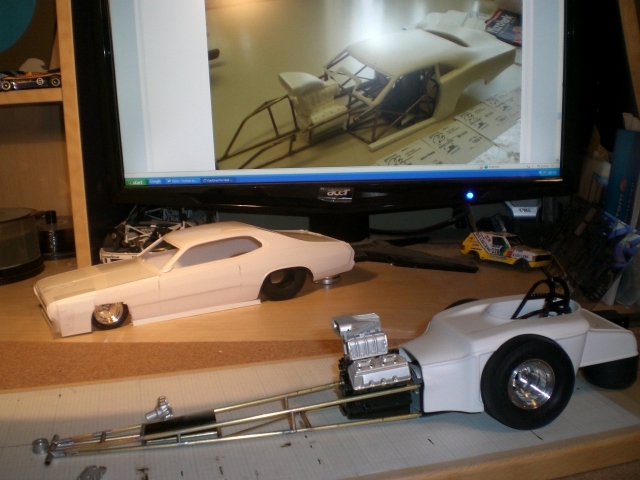

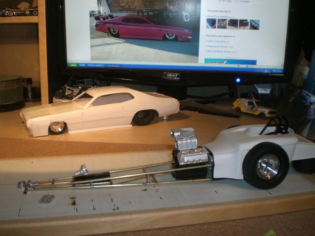

Sometimes work..or toys in the mail.. stop progress altgether. Every day this week something came in the mail. All of it was 1/16th car stuff. My dragster came in the mail so I cut the frame up. I can ruin a kit in seconds!! The wheels came in and they were stunning. The next day a Revellution funny car arrived and all I could see in that body was a PROMOD Duster in the rough. Shaved off the rear spoiler, and moved the front wheels back to 112" . This might become a full blown model. I saw a front gear driven twin turbo setup online. It will be a cool combo. The 1/16th dragster with the comp resin 23T body is taking shape quickly. I built the frame today, and of course did another mockup for visual stimulation. I swear I made no engine noises. :unsure:
post-9240-0-95821300-1328927124_thumb.jp
post-9240-0-62474400-1328927186_thumb.jp
post-9240-0-36130700-1328927193_thumb.jp
post-9240-0-24398500-1328927202_thumb.jp
Just untill I get some M&H slicks! I'm keeping the coupe as an old car. Just HAD to put some wheels in place. I think the slicks will barely stick out from the sides. Wire wheels are on their way for the front.

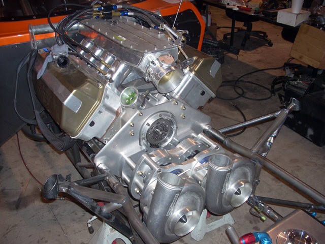

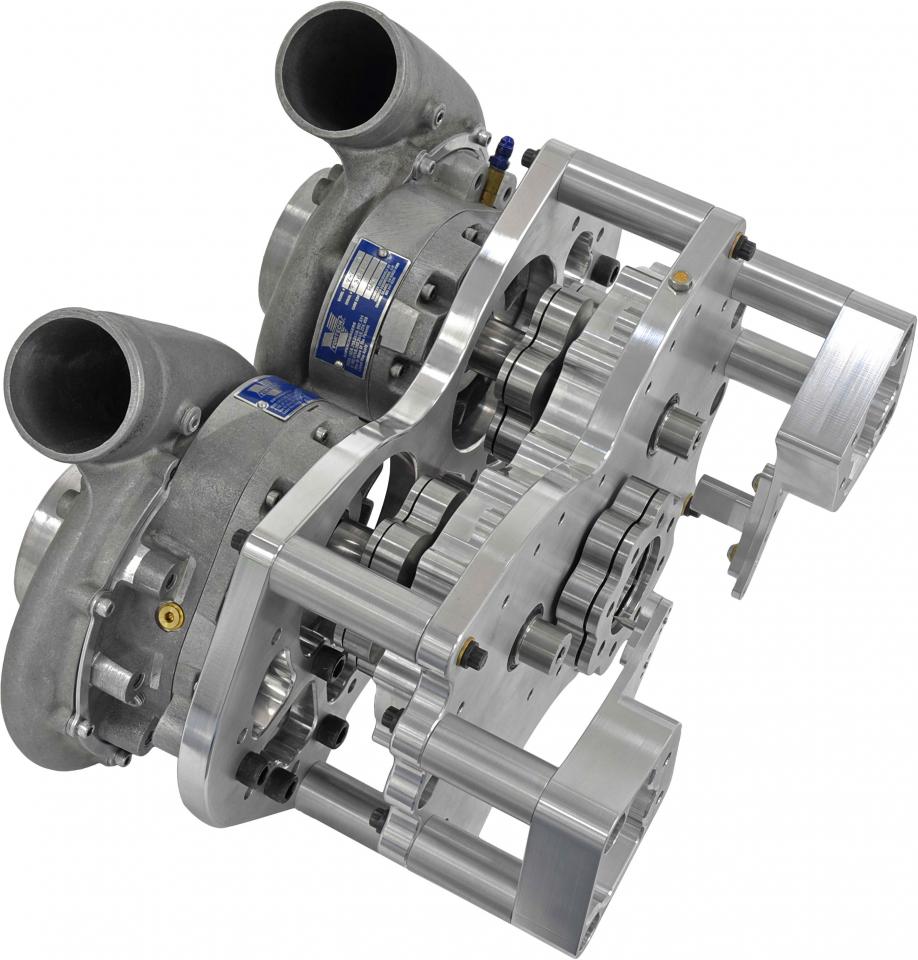

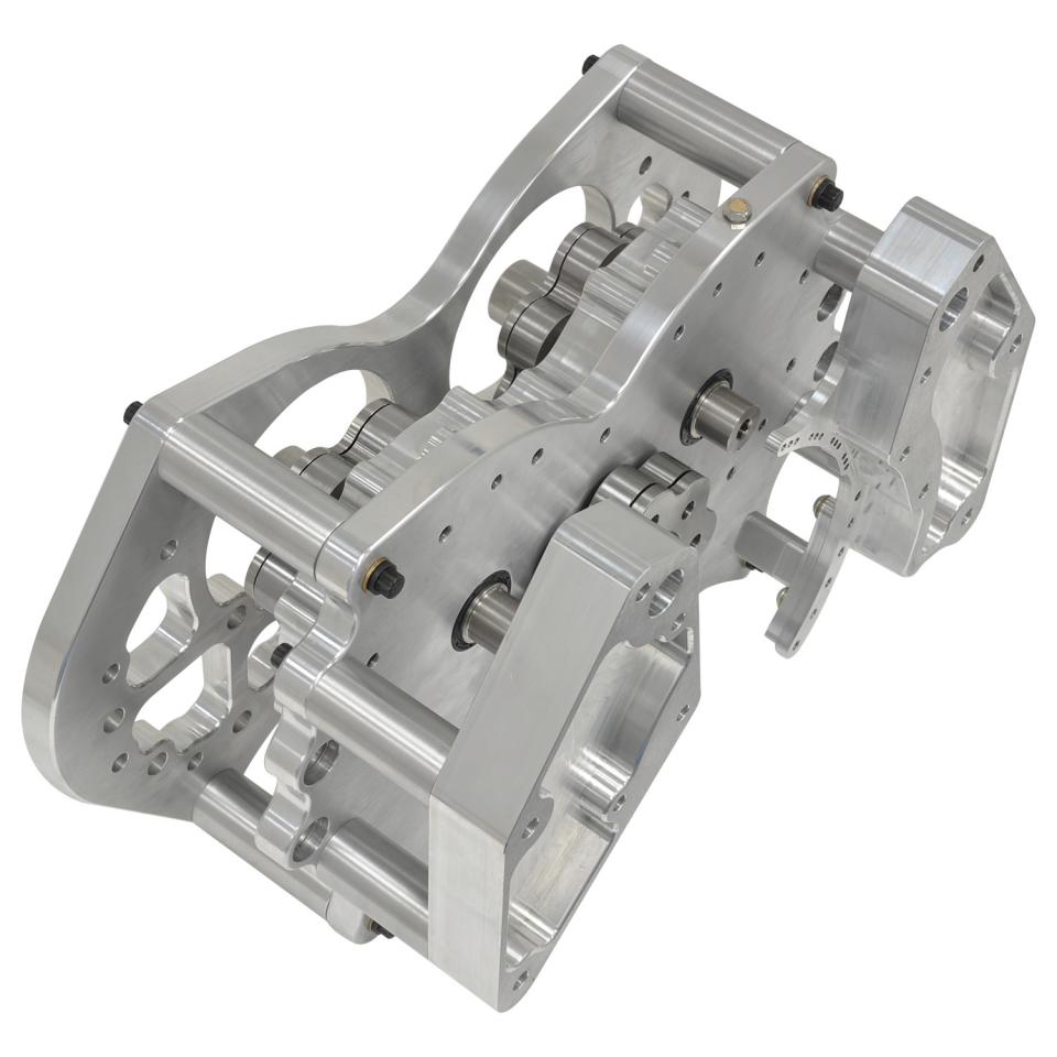

Look at this cool setup! A gear-driven twin turbo allows you to keep the headers simple and the intakes feeding the intake manifold from the front. It's different, and it would be tough to make exact, but not real hard to make it capture the look. Of course one would need a couple turbo's.....

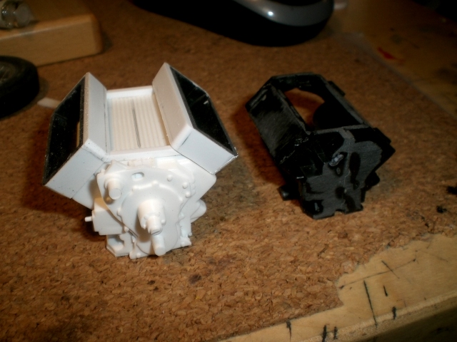

I'm always struck by the shear size and style of the Sonny's wide bore engines. I really like the valve covers. So I took the 1/16th funny car valve covers and cut them down. I filled them with epoxie putty and let dry. Shaped the cover with nailboards and put on a coat of primer to see if they looked the part. I was happy enough to keep right on going. I then added a .060 strip to widen the heads. Very thin end caps were glued on over ground down ends just to clean up the design. I took the funny cars block and widened it with two .060 strips of evergreen. I capped the top of the block making the head area of little bit wider. A couple of turbos have been temporarily set at their final angle with a bit of epoxie putty. The rest is just stuff to play with as the design continues. It's now a bigger more modern engine for sure. Nothings done...just getting some basic shapes together.
Those are acctually Procharger superchargers.
