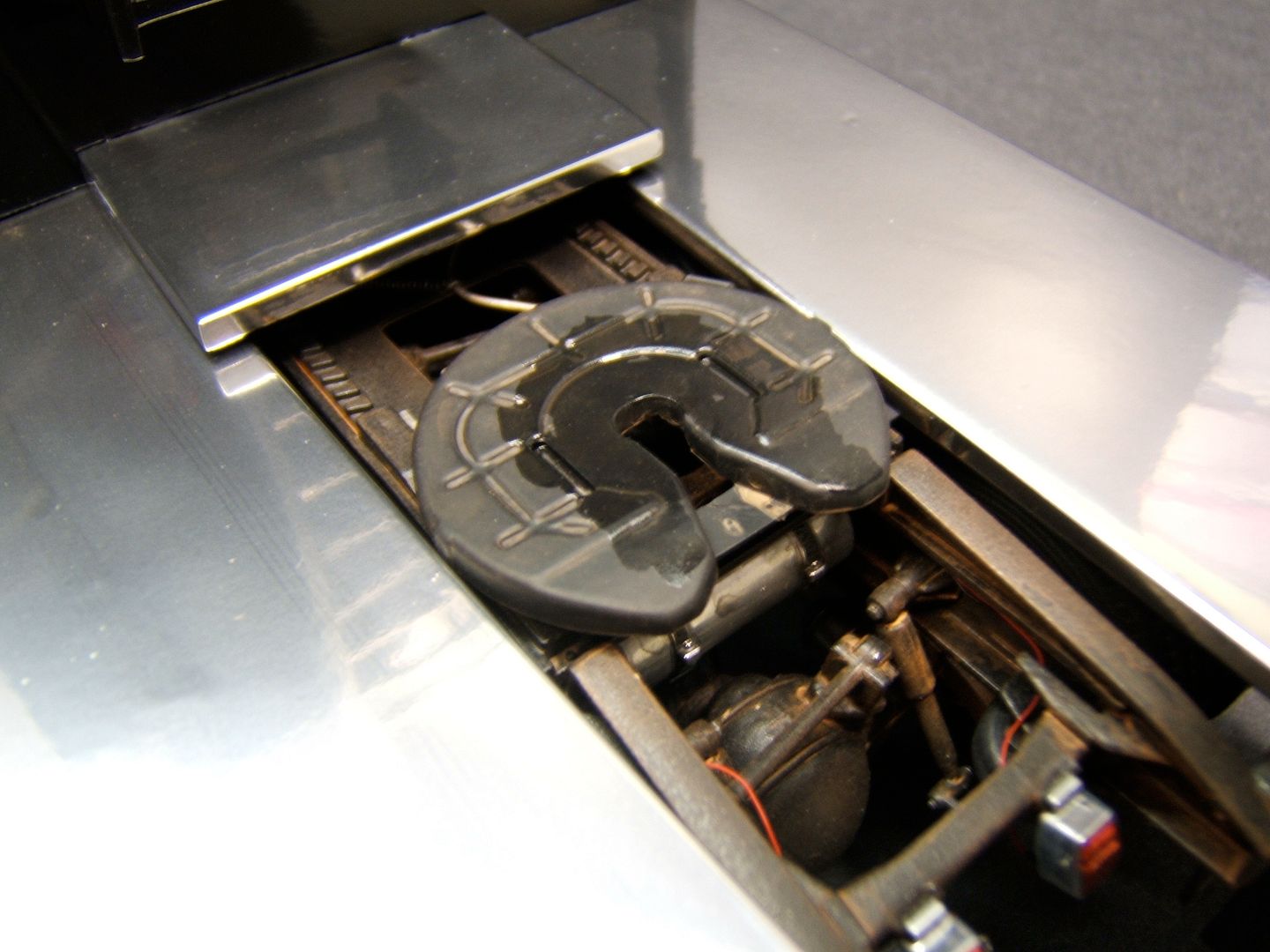

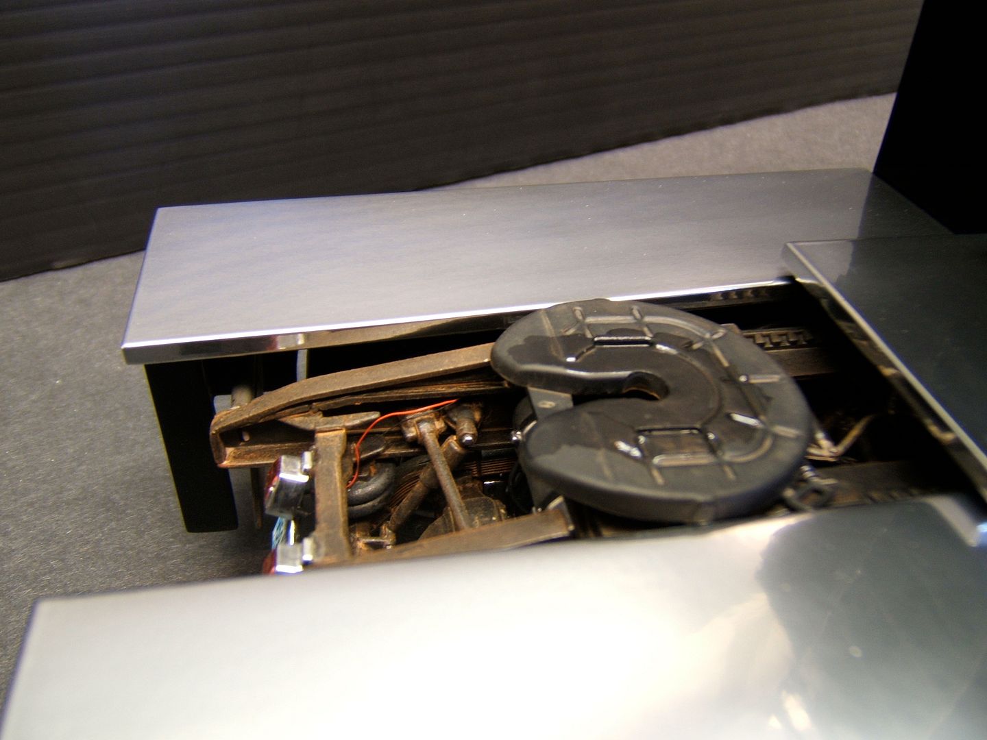

carchub Posted June 10, 2012 Posted June 10, 2012 (edited) Amazing work you're doing! The detail is quite unbelievable, it's perfect! May I ask what method you used to weather the chassis/frame? Thanks, carchub Edited June 10, 2012 by carchub

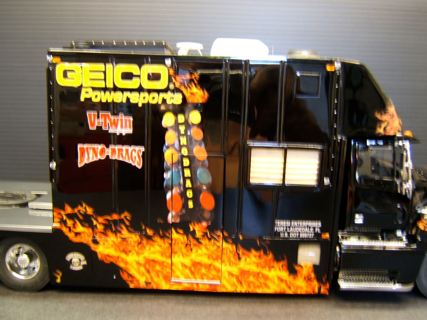

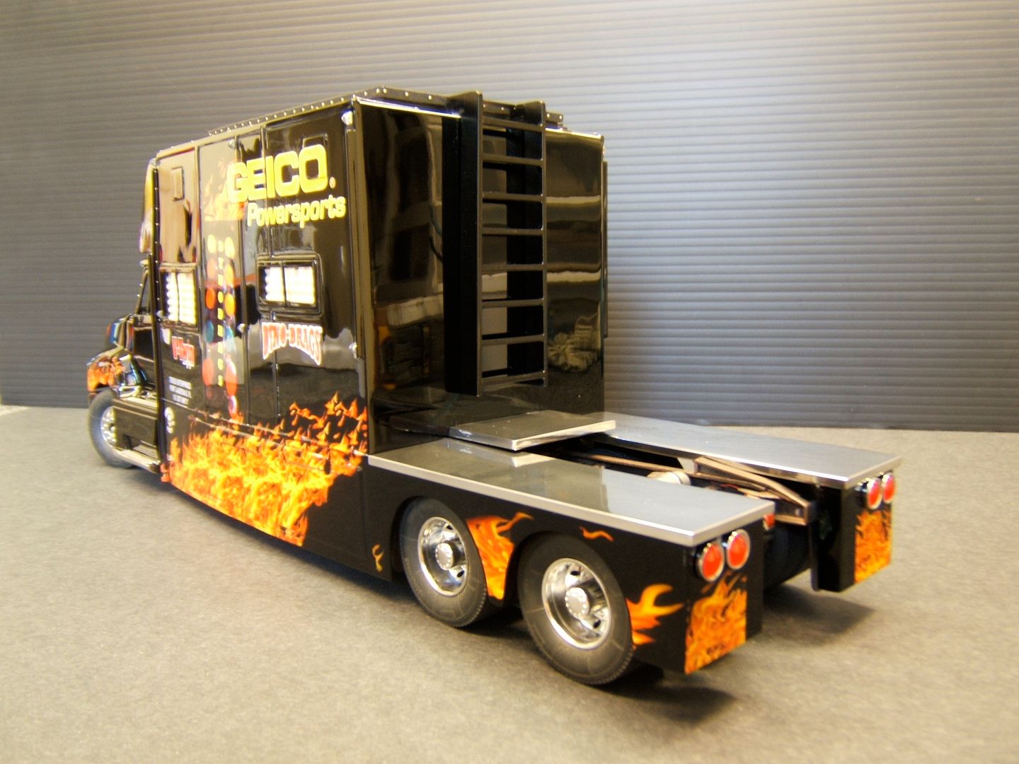

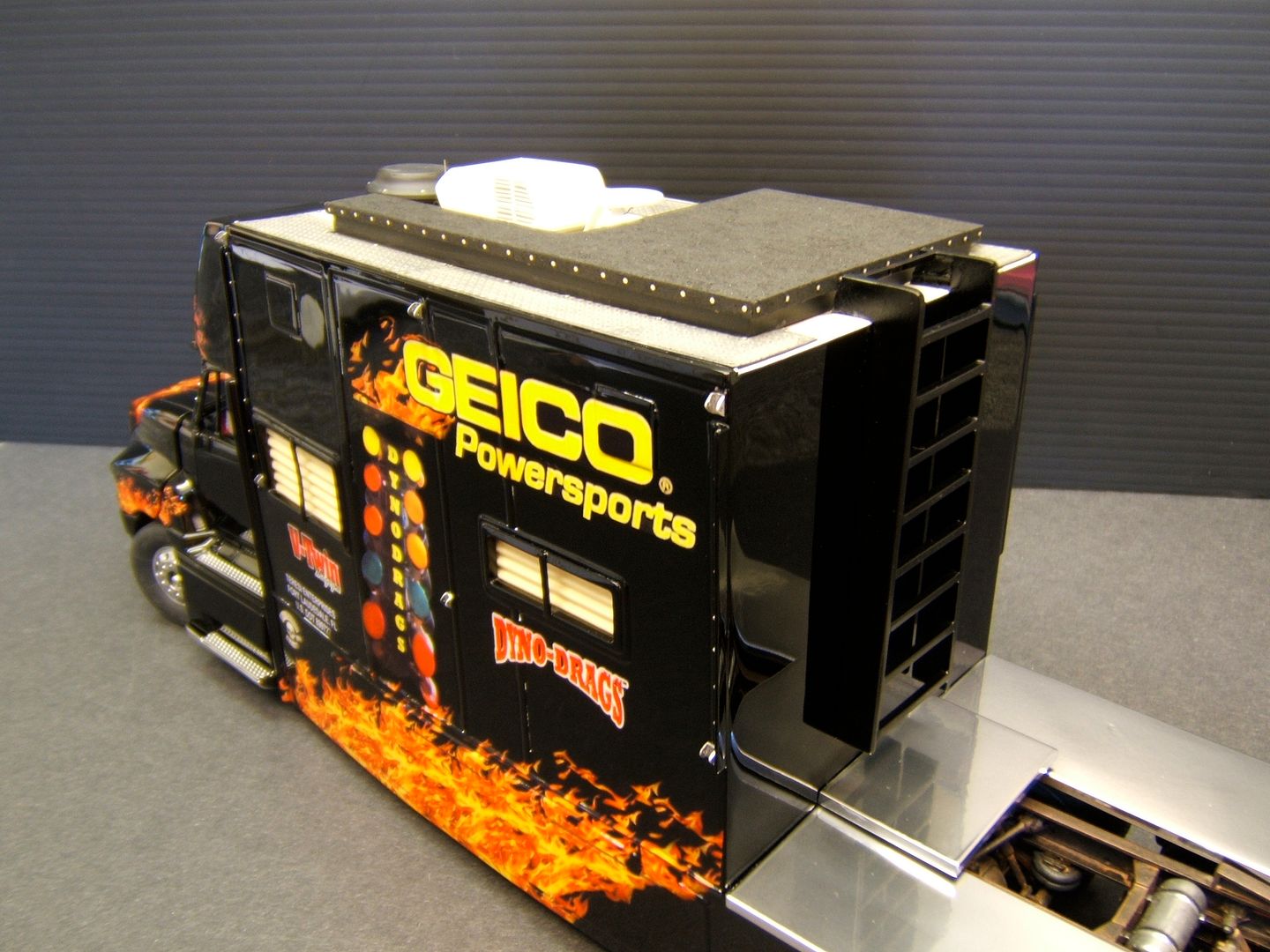

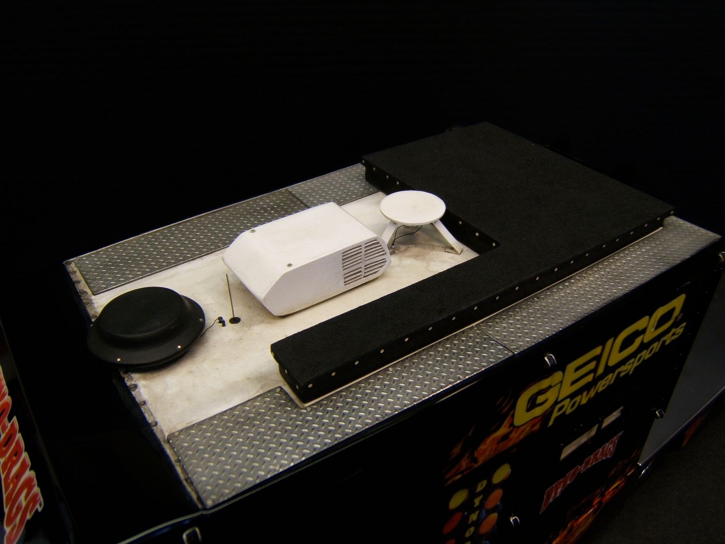

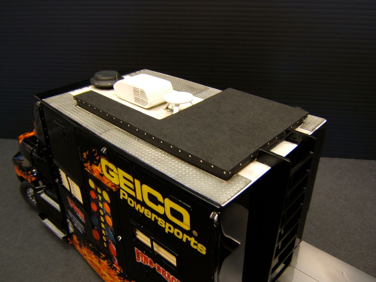

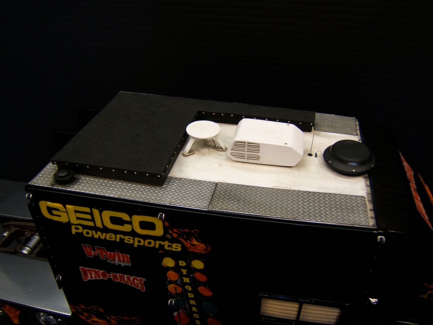

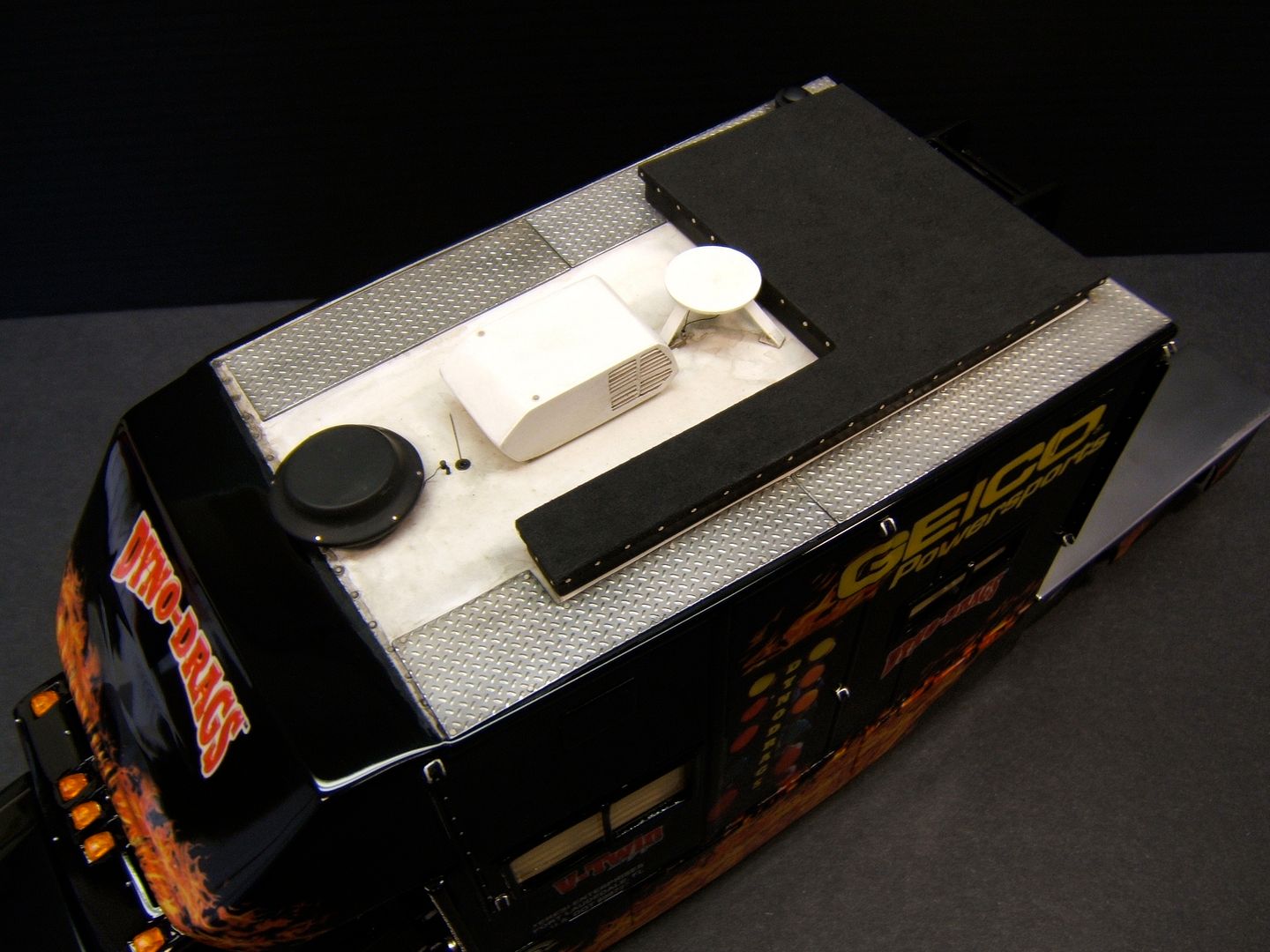

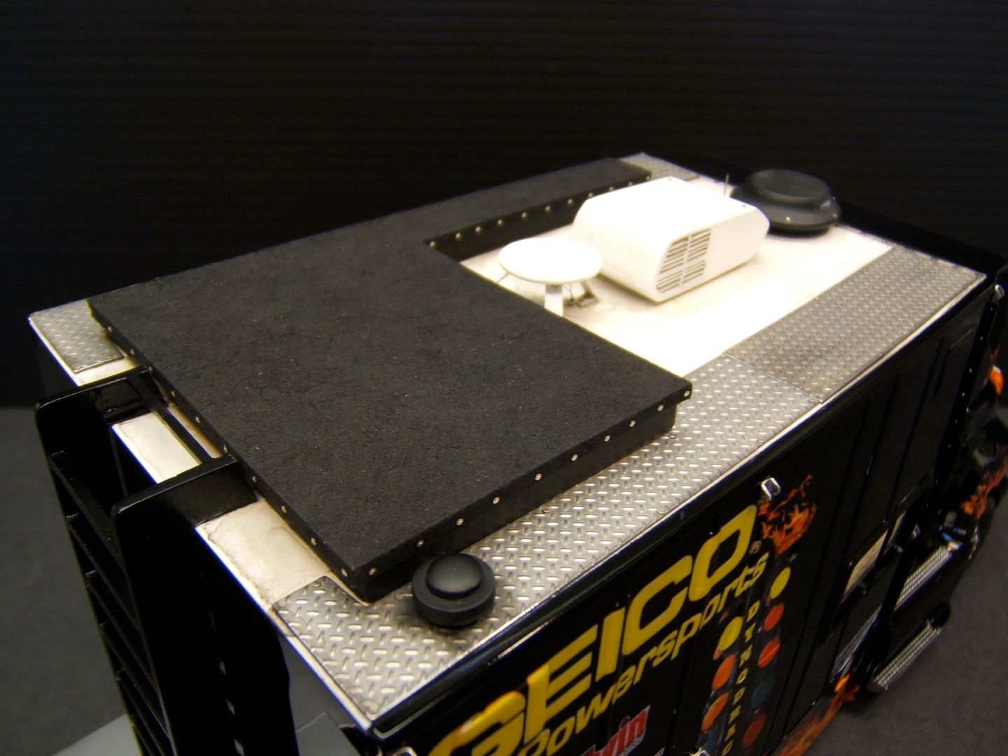

John Teresi Posted June 10, 2012 Author Posted June 10, 2012 Hello.......thank you all so much for your kind comments........I attached all the components that go on top of the sleeper......scratch built storage bin,antenna`s,vent`s, ladder and air conditioner........also made some awning brackets......I will put on the mirrors and running lights tomorrow.......thanks for looking.
John Teresi Posted June 11, 2012 Author Posted June 11, 2012 Amazing work you're doing! The detail is quite unbelievable, it's perfect! May I ask what method you used to weather the chassis/frame? Thanks, carchub Roland........I use "Osh" brand flat black paint for the base color......then I give it a wash with "Folk Art" acrylic dark gray water based paint.......then I give a final wash with "Delta Ceramcoat" acrylic autum brown.......after it dries I give a mist coat of semi-gloss Krylon paint or Dull coat.......thanks.

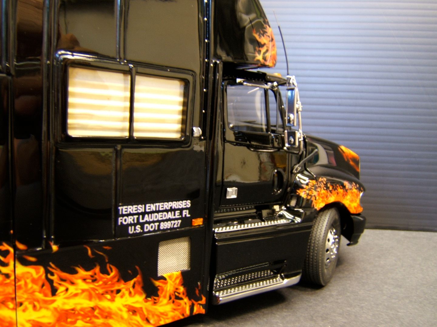

jbwelda Posted June 11, 2012 Posted June 11, 2012 like i pointed out in a PM (that you made so i couldnt reply back to...whats up with that?) you misspelled Lauderdale on the side...but since as you say the real truck has it misspelled too, then its not misspelled at all but true to reality on your truck. just wanted to follow up on our PMs

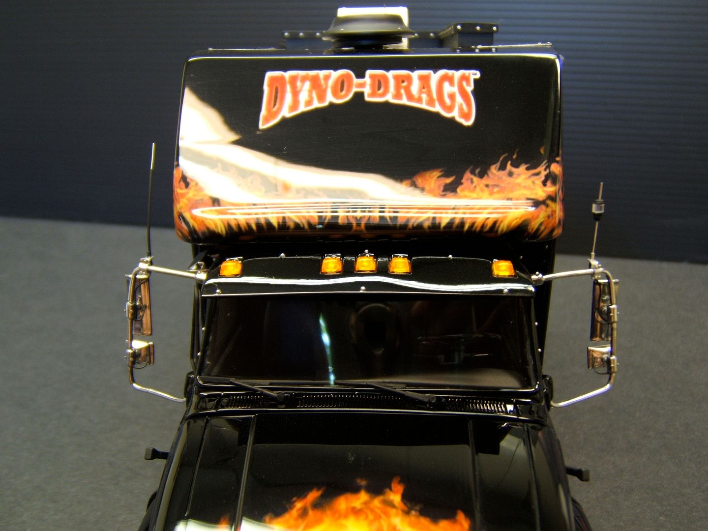

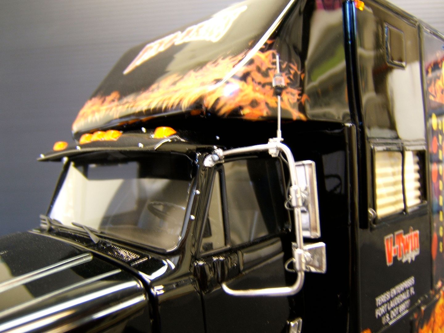

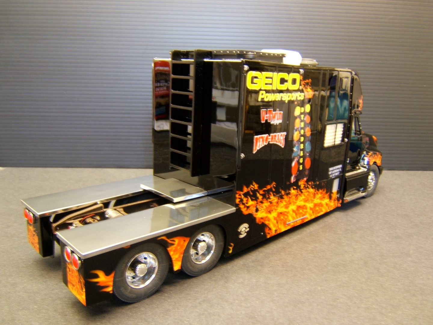

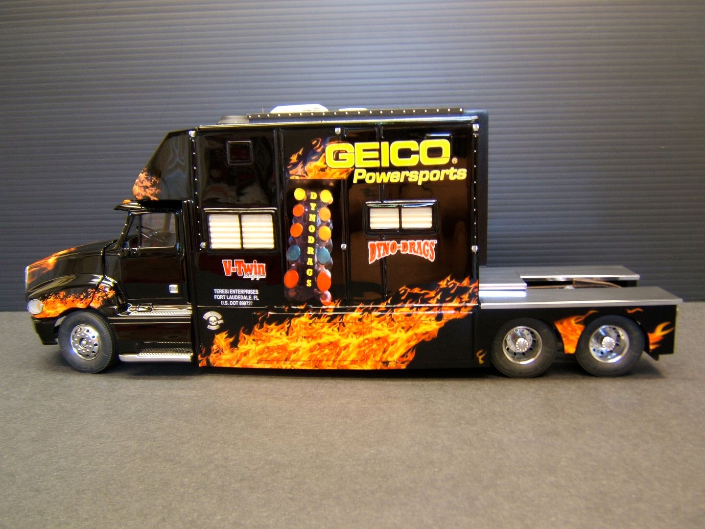

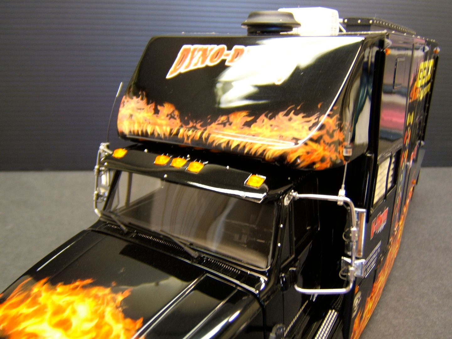

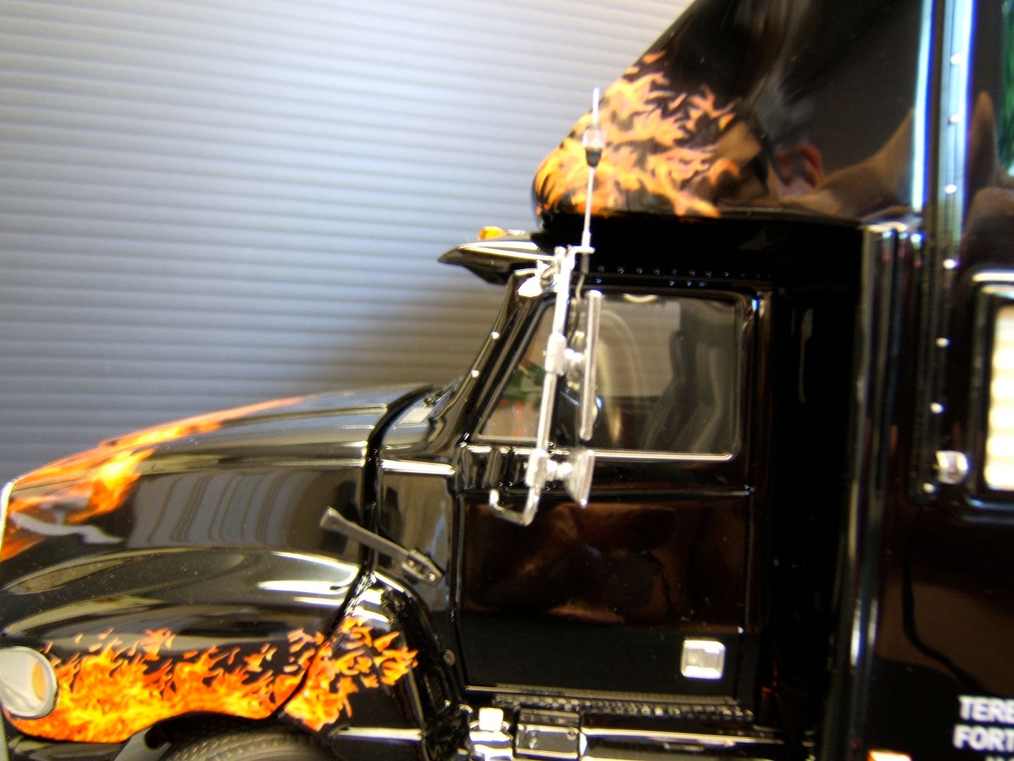

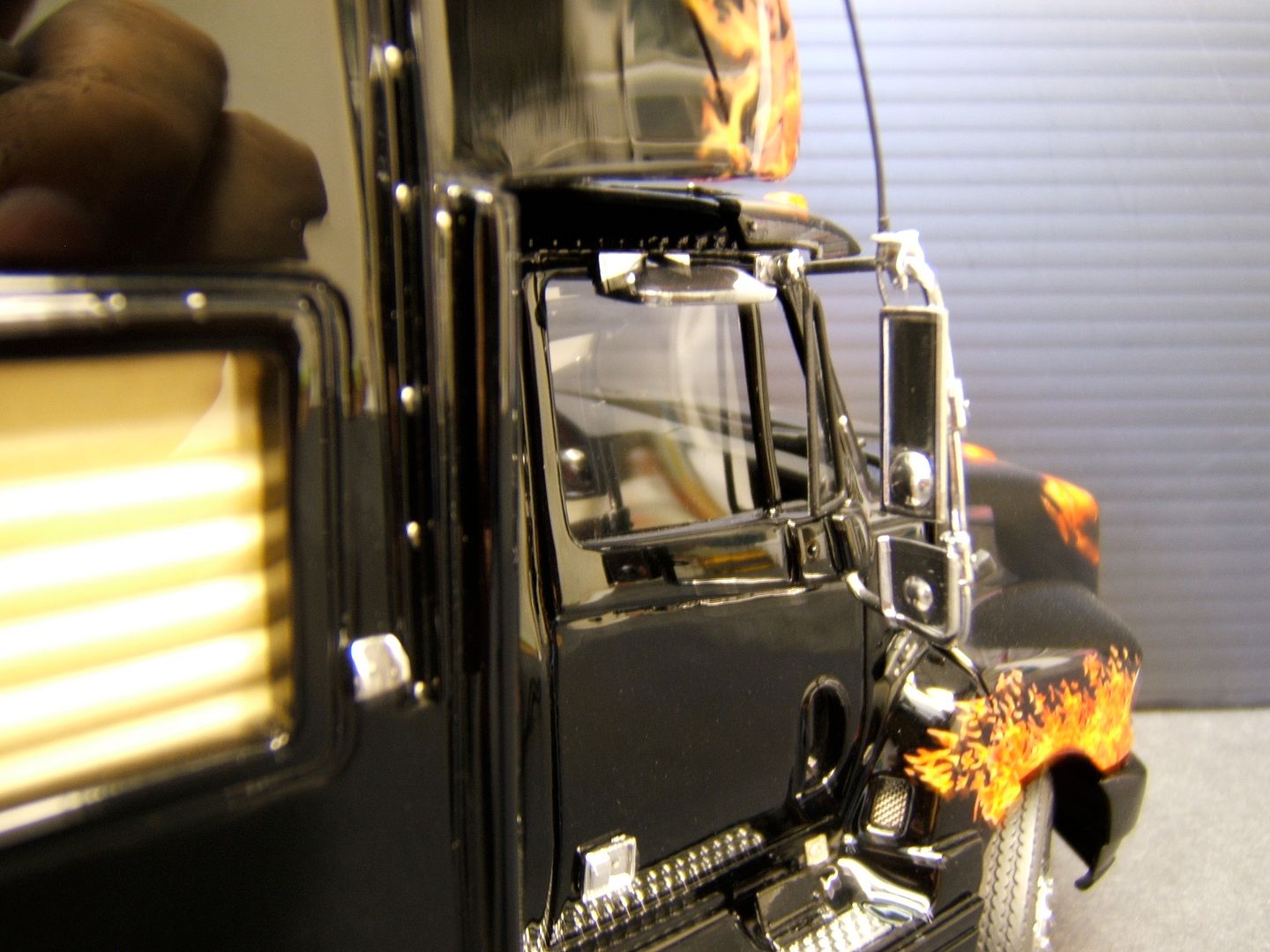

John Teresi Posted June 11, 2012 Author Posted June 11, 2012 Hello.......thank you all for your kind comments......I did some more work on the Cab/Sleeper........I attached the mirrors, hood straps, windshield wipers, antennas, running lights, and the fifth wheel......I will finish up the trailer tonight.......thanks for looking.

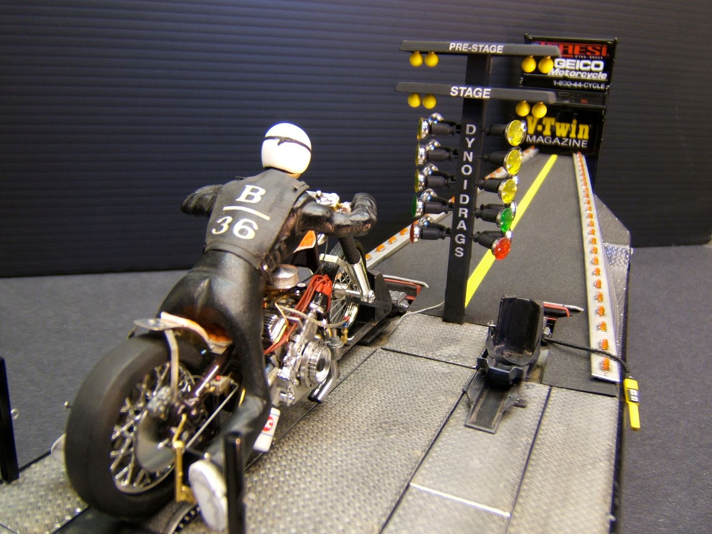

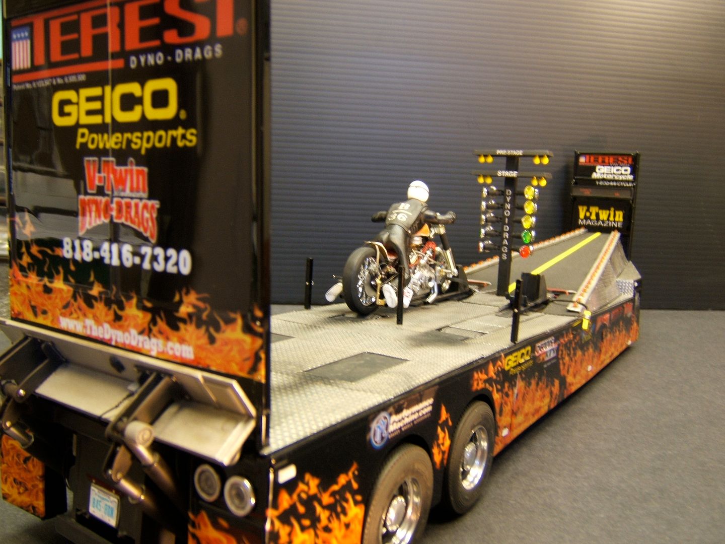

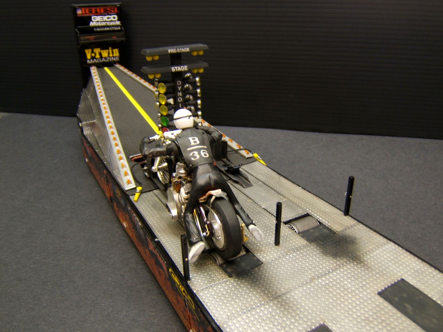

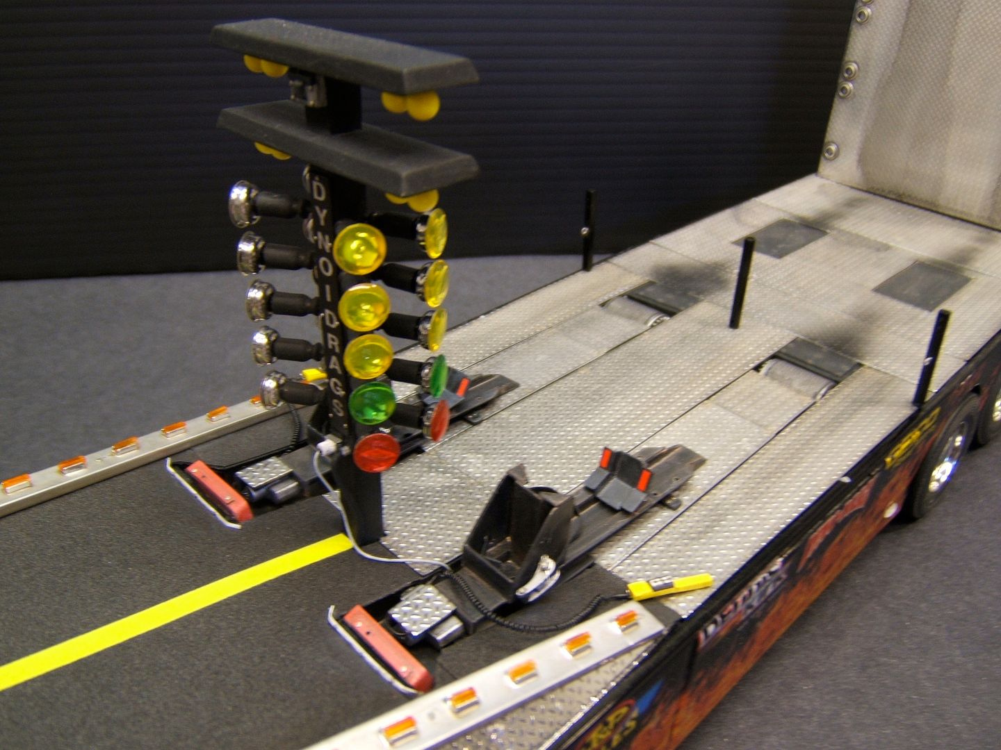

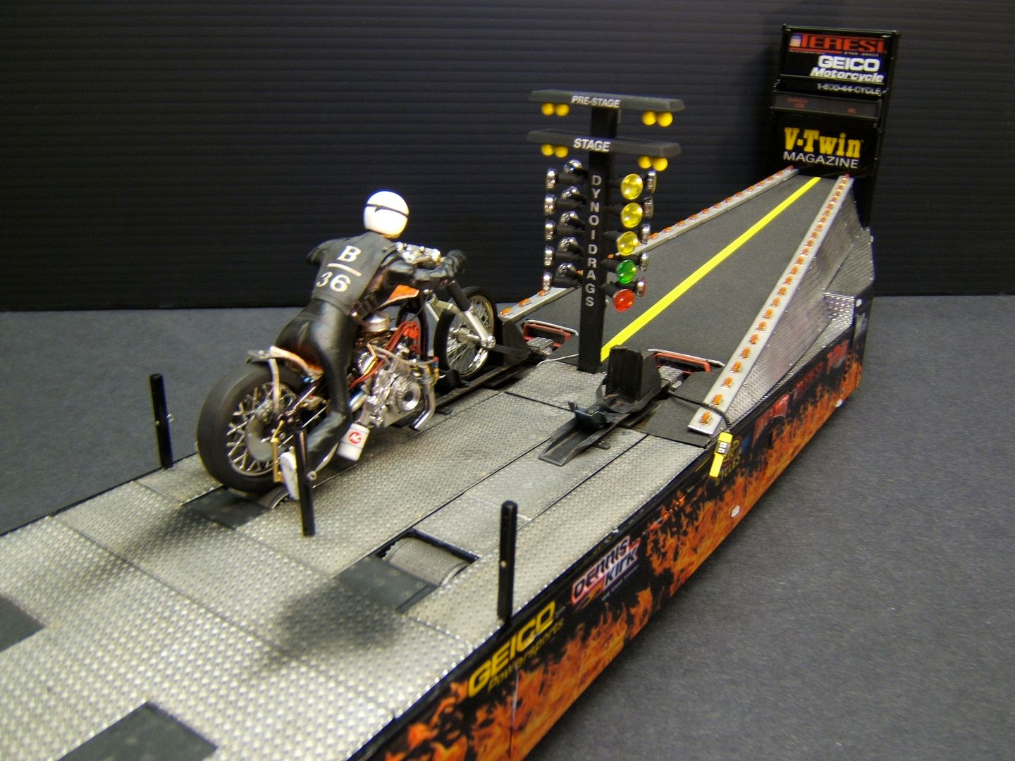

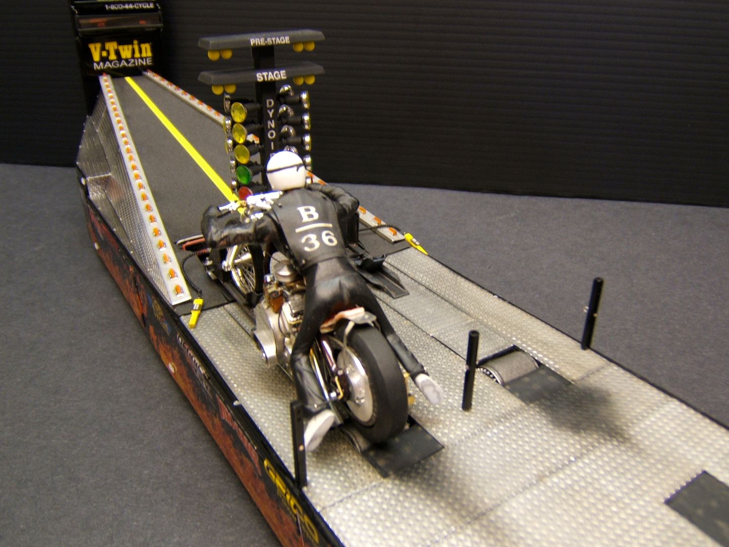

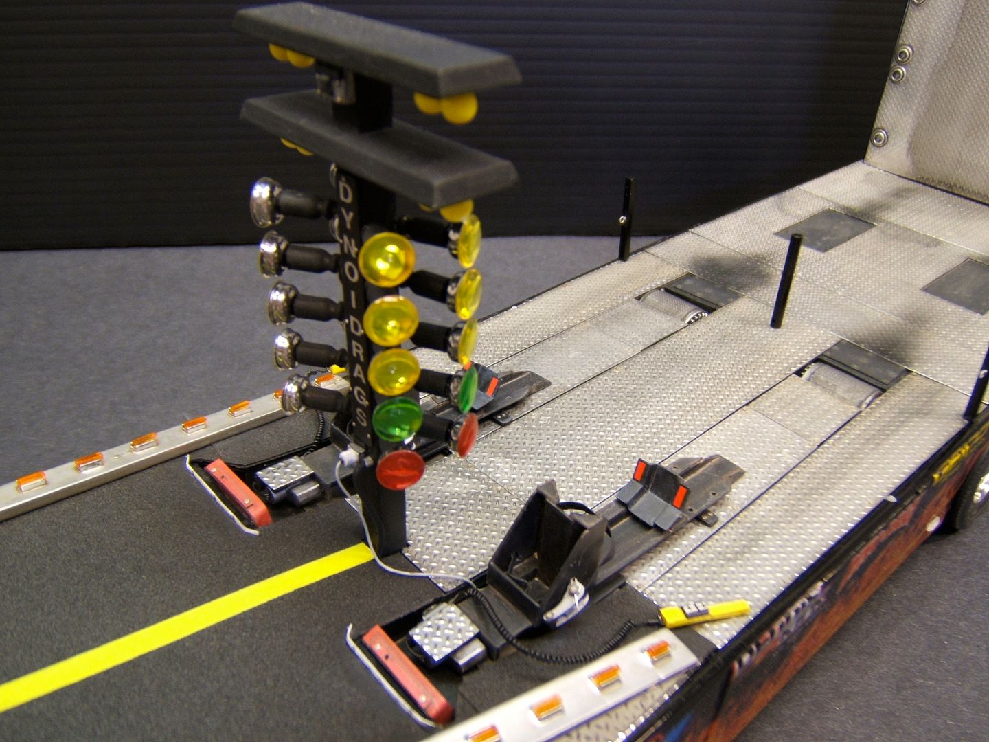

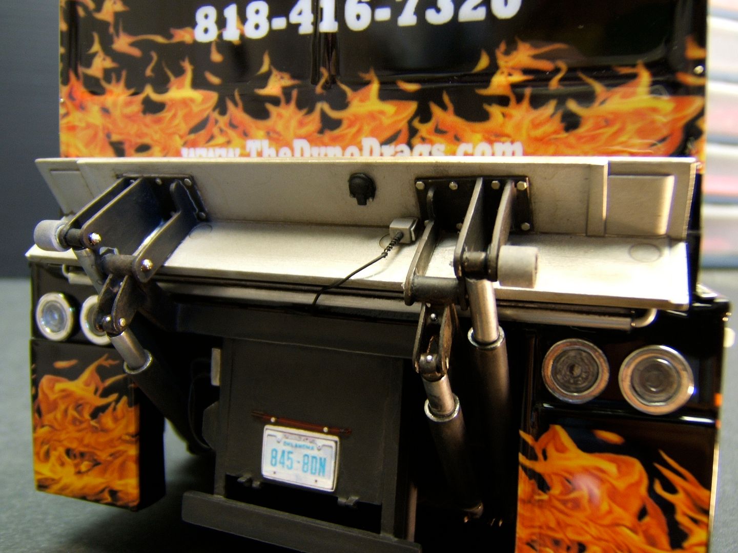

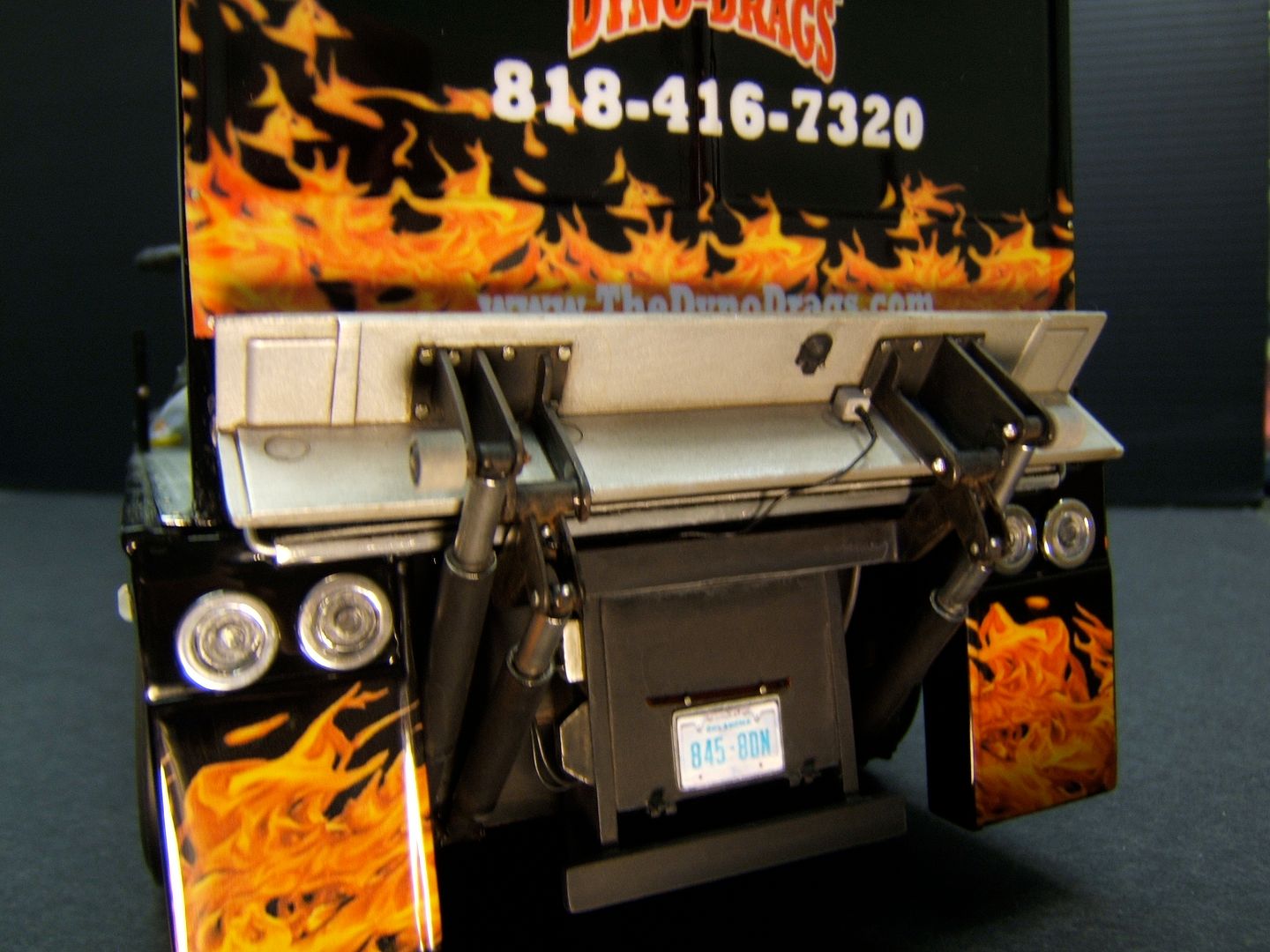

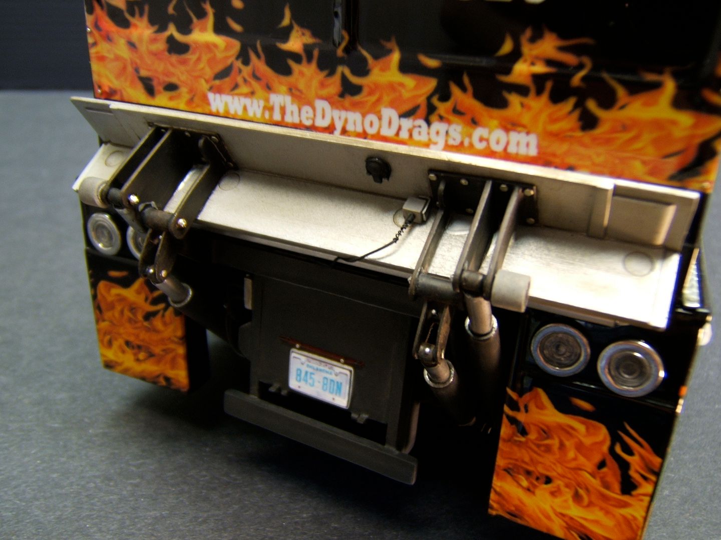

John Teresi Posted June 12, 2012 Author Posted June 12, 2012 Hello......thank you all for your kind comments........I finished the tailgate,got the electrical, license plate and the roller wheels on.......I also put on the running lights on the trailer......changed the yellow bulbs on the christmas tree......and did a little more weathering......thanks for looking.
