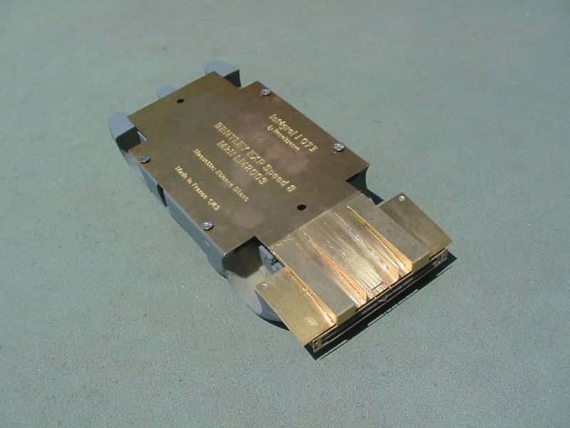

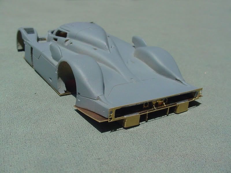

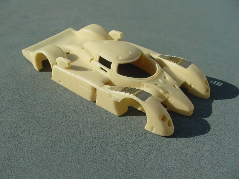

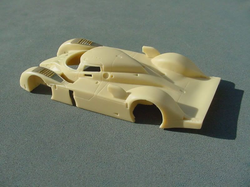

Scale-Master Posted May 10, 2012 Share Posted May 10, 2012 I spent a few hours to clean up the flashed over but low pin-holed resin body casting. Forming the brass fender louver panels and bending the actual louvers was a bit tedious, and I was a little surprised that I had to rework the right side recessed area of the body/fender so the panel could even be close to fitting semi-flush. The chassis is all brass which I soldered together. Quote Link to comment Share on other sites More sharing options...

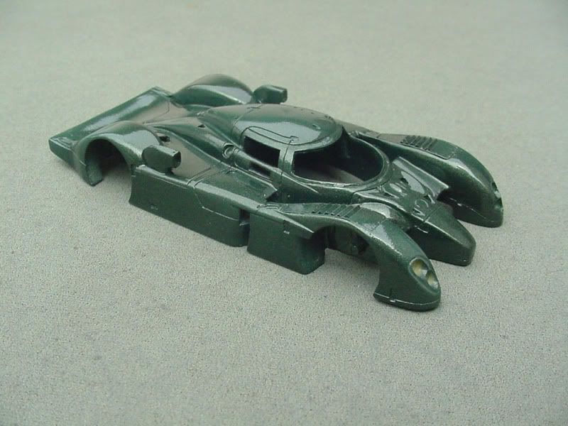

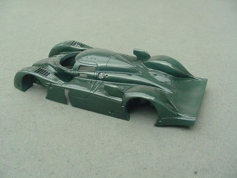

Scale-Master Posted June 6, 2012 Author Share Posted June 6, 2012 Yes, it is 1/43rd scale. OK, so I got the base color on it... I used Zero Paints for the Green, I also used their clear to seal it prior to decal application. Quote Link to comment Share on other sites More sharing options...

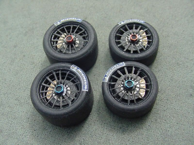

Scale-Master Posted June 6, 2012 Author Share Posted June 6, 2012 Scale/size is irrelevant, just detail whatever size you are working in to what it can take. The wheels/tires/brakes are made up of mostly PE in an aluminum rim with rubber tire and machined nut. Quote Link to comment Share on other sites More sharing options...

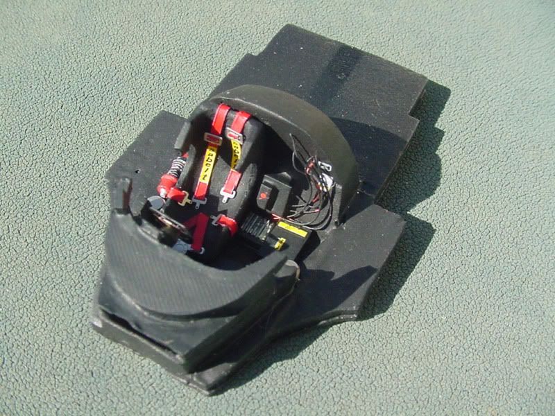

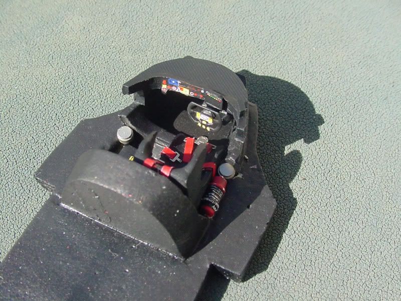

Scale-Master Posted June 7, 2012 Author Share Posted June 7, 2012 The interior is done. I tried using the lead foil from a wine bottle as directed by the instructions for the seat belts this time. In some ways it is easier than tape (like I usually use) to work with, other ways a little more work. It looks a bit heavy in 1/43, but it also makes it pop. That might be a good thing once it is all inside the car. Quote Link to comment Share on other sites More sharing options...

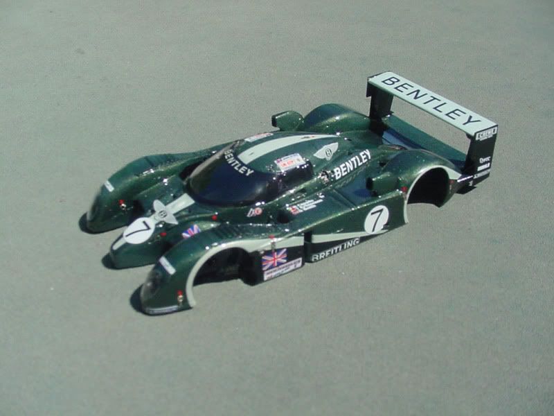

Scale-Master Posted June 7, 2012 Author Share Posted June 7, 2012 Decals and paint are done, onto final assembly… Quote Link to comment Share on other sites More sharing options...
Art Laski Posted June 8, 2012 Share Posted June 8, 2012 (edited) Great cockpit! Did you make the buckles too, or were they part of the kit? Edited June 8, 2012 by Art Laski Quote Link to comment Share on other sites More sharing options...
Art Laski Posted June 8, 2012 Share Posted June 8, 2012 Another question- what did you do to get that carbon look on the dash? My little Lola could have used that treatment in places. Quote Link to comment Share on other sites More sharing options...
Scale-Master Posted June 8, 2012 Author Share Posted June 8, 2012 The buckles come in the kit. The PE in this kit is great, and there is a lot of it. But some of it does not fit well, especially where it needs to fit to resin parts. The dash (and front splitter and rear wing uprights) are decaled with C/F decal that aslo came in the kit. ScaleMotorsports makes some nice C/F decals and has them in 1/43rd. Quote Link to comment Share on other sites More sharing options...
Art Laski Posted June 8, 2012 Share Posted June 8, 2012 Thanks, Mark. The CF was so subtle, I thought it may have been a paint technique. I've used SM's CF in 1/24 before and it was good stuff. I'll have to get a sheet of the 1/43 in case another one of these builds comes across my workbench. Last week I uncorked a bottle of wine for my wife and her friends at her scrapbook party (those girls know how to do their hobby!) and I was holding the lead foil in my hands thinking it was a pretty interesting, but never thought of using it in modeling. But after seeing your belts, I'll definitely hold on to some next time. Lots of uses start coming to mind. -Art Quote Link to comment Share on other sites More sharing options...
