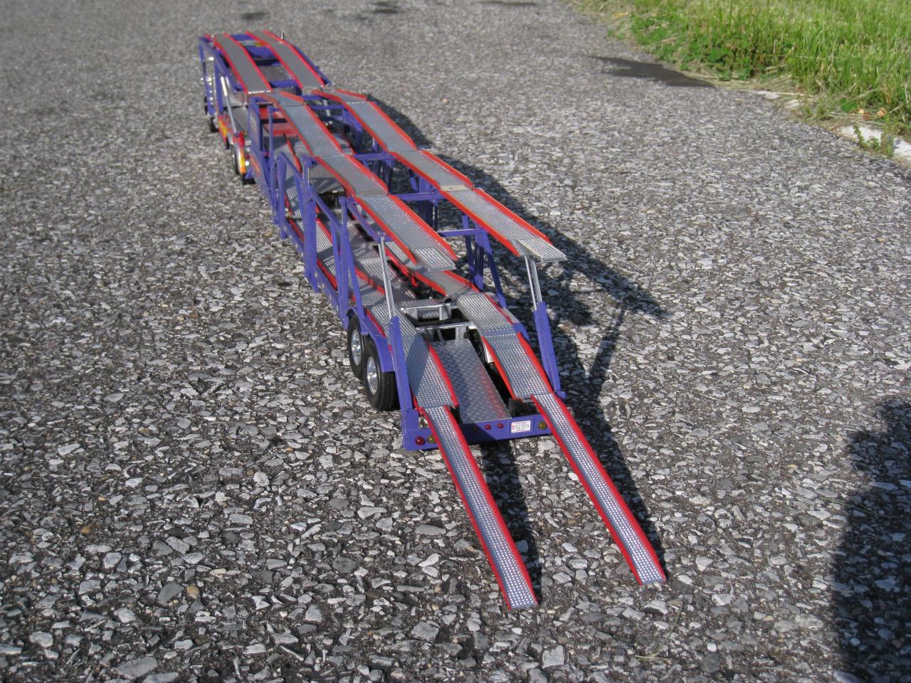

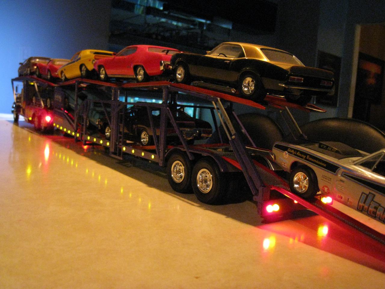

Thundercat Posted May 30, 2012 Posted May 30, 2012 This build took me over 4 months. Over 240 hours. Instaud 49 LED's. Scratch built the upper and lower racks on the rig. Streched the chassis to put in the sleeper cab that the kit didn't come with. Lowered the fifth wheel to align with the trailer. On the trailer I scratch built all the front lower framing to lower the king pin and hide the batteries. Built outer framing for the LED's.

ewaskew Posted May 31, 2012 Posted May 31, 2012 That is a very nice build and the load is very impressive also. I saw a real one the other night and thought about your build and how cool it looks in the night time photos.

Thundercat Posted June 1, 2012 Author Posted June 1, 2012 Thanks TJ. I'll check that out. Earl. That's where I got the idea. I was going to light up a car but I saw a auto transporter out side of my job one night all lit up. I thought hummm, I wonder if I can light one of them up.
