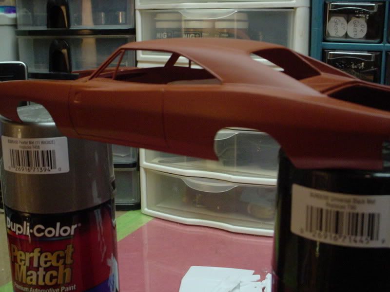

bryan_m Posted July 13, 2012 Author Share Posted July 13, 2012 Heres the colors i am using........duplicolor lacquer. black metallic, and pewter silver metallic. also snagged a new can of clear. i bummed i cant use my airbrush, my compressor died, so its rattle can time! one final shot of it in primer... and i was thinkin about adding an "undead" driver........i might hack these guys up and make one! not really sure yet. thanks for lookin, and for all the great comments! cheers bryan Quote Link to comment Share on other sites More sharing options...

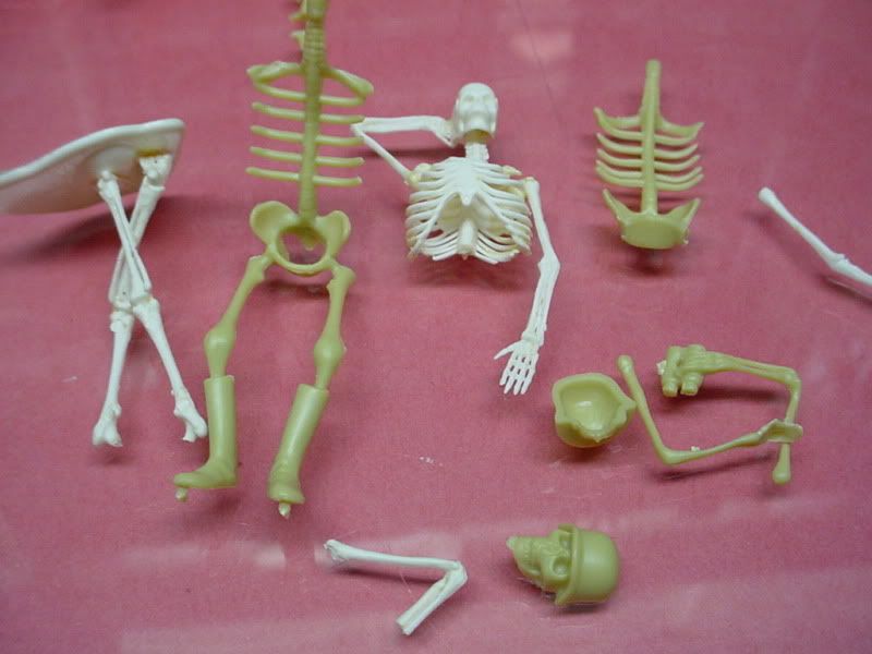

bryan_m Posted July 13, 2012 Author Share Posted July 13, 2012 heres a skeleton i hacked up a while back, he was supposed to go in my 32 ford ratrod sedan, but i didnt pose him just right, so now he is waiting for a new home in one of my builds... he came from the "rommels rod" kit, i ground down the nazi style hat, and made it look like this.....chopped up his arms and legs and re-posed him.... now he needs a ride! thanks for lookin! bryan Quote Link to comment Share on other sites More sharing options...

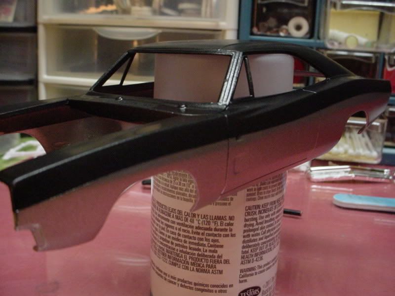

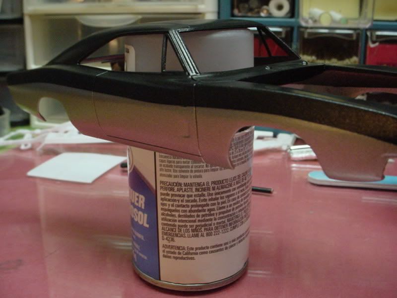

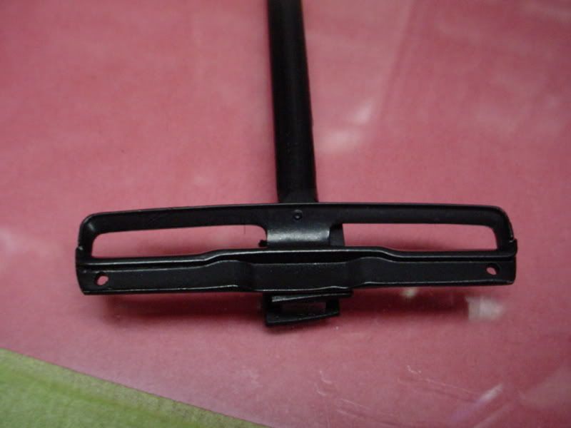

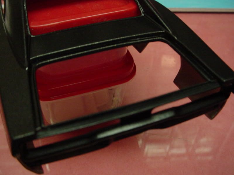

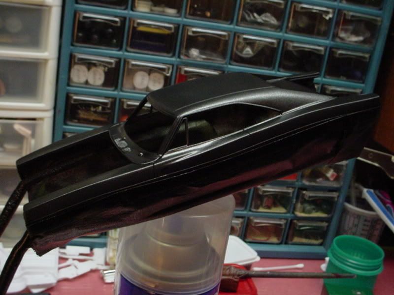

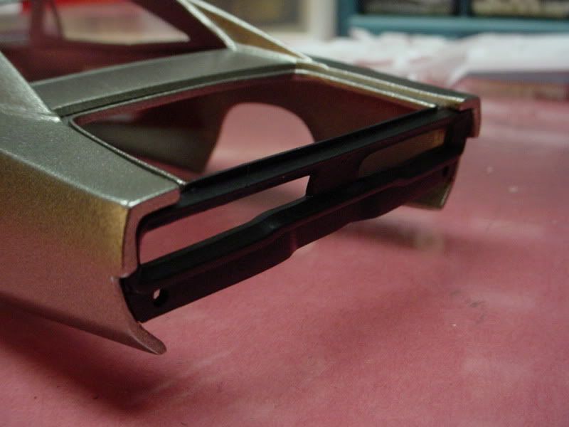

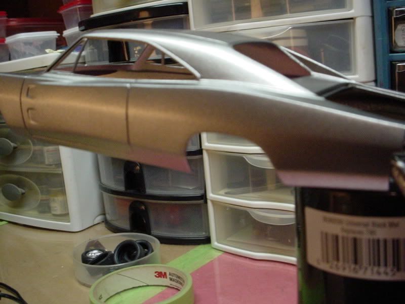

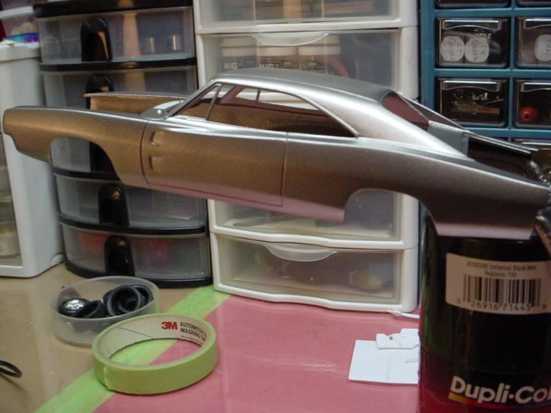

bryan_m Posted July 13, 2012 Author Share Posted July 13, 2012 ok, i got the silver shot on the body....now it will be like watchin paint dry! LOL ill shoot the black in the morning before its a 100 degrees out and the humidity is 100 too! LOL heres a couple shots... i also shot the rear tail light panel in satin black. thanks for lookin guys! lemme know what ya think........ more to come bryan Quote Link to comment Share on other sites More sharing options...
bryan_m Posted July 13, 2012 Author Share Posted July 13, 2012 the humidity is still a little high tonight, i can see that it made the rear panel a little hazy......ill have to shoot it with satin clear tomorrow! thanks again guys bryan Quote Link to comment Share on other sites More sharing options...

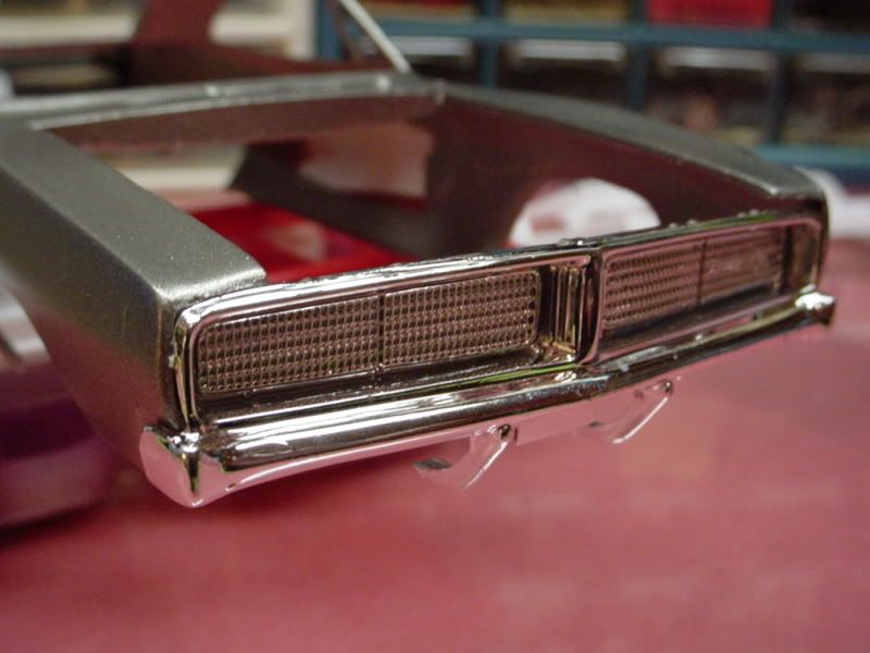

bryan_m Posted July 13, 2012 Author Share Posted July 13, 2012 heres the rear tail light panel set in place, i like the black and silver together, always a great color combo. and now that i have sat it in place, i think i am gonna have to keep the chrome on the bumpers and grille. the chrome looks great against the silver..... and i think my work on the trunk jamb came out pretty decent too.......im startin to get motivated on this build again ok i would have posted a pic of the jamb, but photobucket is being a HUGE PAIN again!!! is anyone else using photobucket having problems with it? its really makin me nuts! thanks guys! bryan Quote Link to comment Share on other sites More sharing options...

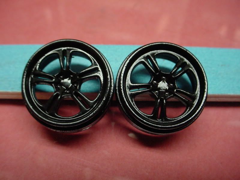

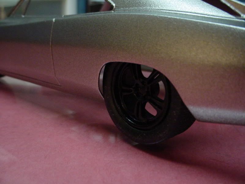

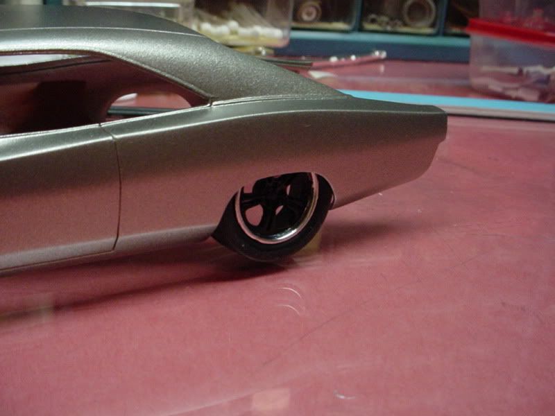

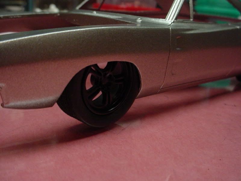

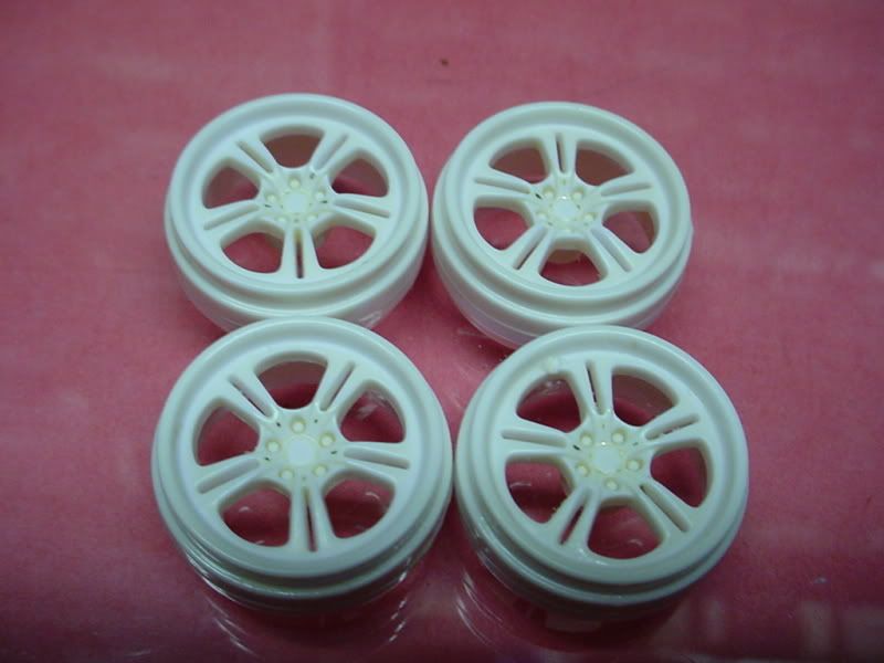

bryan_m Posted July 13, 2012 Author Share Posted July 13, 2012 stripped and painted the wheels! let me know what ya think guys.......i will detail them a little, maybe some valve stems, and definetely a chrome outer lip just to break it up a little, or maybe a red lip? here they are stripped Painted.... tires mounted, and mocked up on the body.... lemme know that ya think guys. stay tuned more to come...... cheers bryan Quote Link to comment Share on other sites More sharing options...

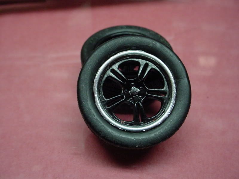

bryan_m Posted July 13, 2012 Author Share Posted July 13, 2012 what a mess! the last time i went to the LHS, i grabbed a sheet of BMF, and i didnt notice that it was "ultra bright chrome" that stuff is the worst! its too thick, and it doesnt stick very well, or it sticks too well, and its too hard to get off........so needless to say, i scratched one of the wheels, and the foil looks like poop! ok, photobucket is bein stupid again........or i would post a horrifying PIC! so its on to the next plan of attack, ill do the wheels in black again, after i strip them, then mask them and shoot the edge of the wheel with alclad chrome............oh no wait, cant do that, my compressor is out of commission.....bummer. stay tuned, more anger to come! LOL bryan Quote Link to comment Share on other sites More sharing options...
bryan_m Posted July 13, 2012 Author Share Posted July 13, 2012 ok, photobucket working again.........heres a wheel pic. it would have looked good, but like i said, terrible foil, and the fact that i was a little impatient and didnt give them long enuff to dry they got messed up....... totally unacceptable! ok, now its on to plan "B" thanks for lookin guys. more to come cheers bryan Quote Link to comment Share on other sites More sharing options...

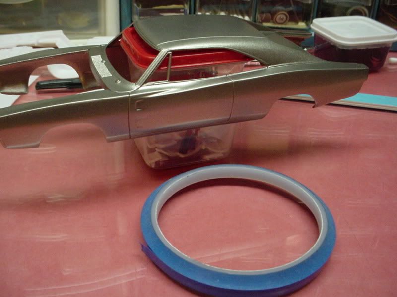

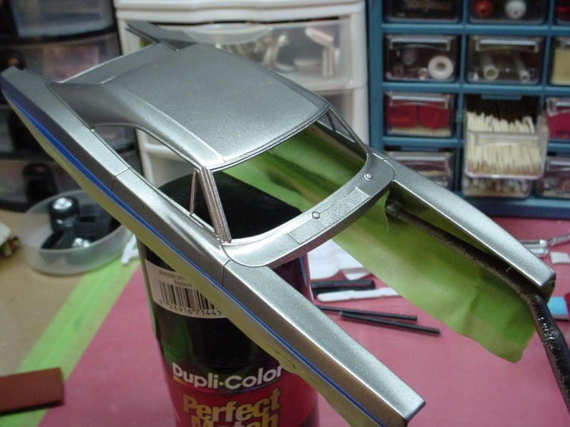

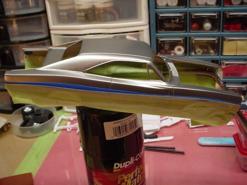

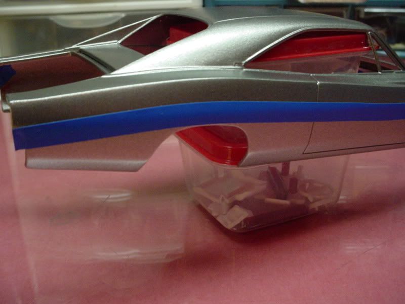

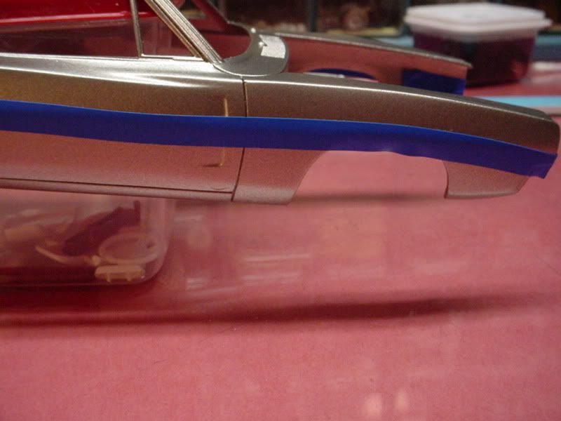

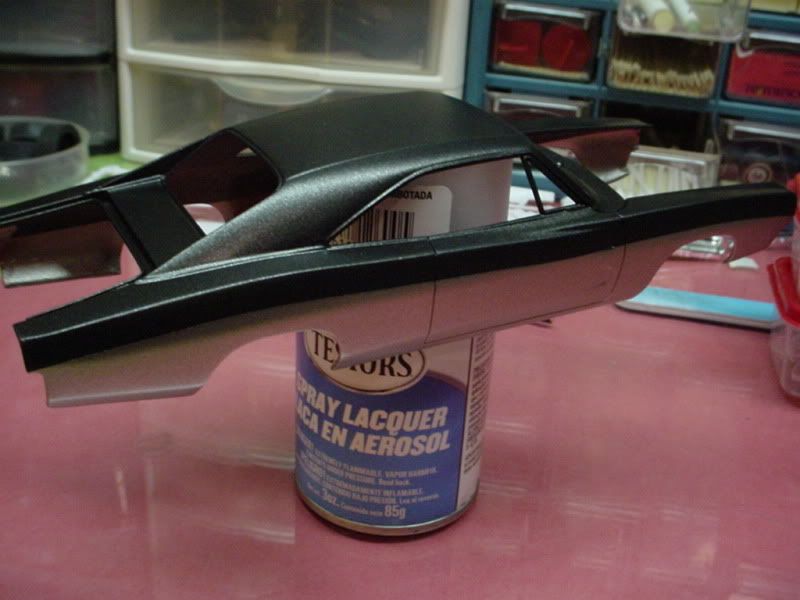

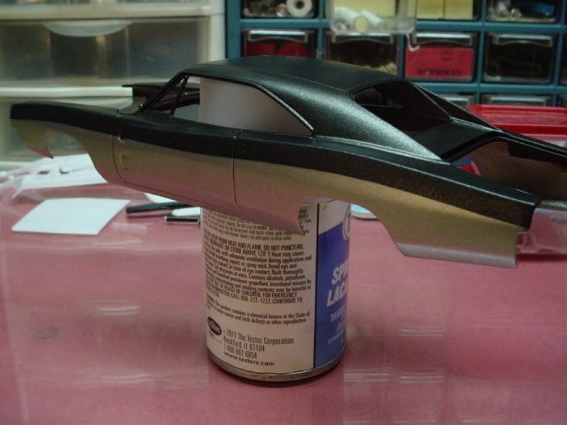

bryan_m Posted July 13, 2012 Author Share Posted July 13, 2012 ok, i`ve started tapin the body for the second color..... i didnt want a straight line down the body, so i mirrored the upper body line 6 scale inches below it. i like it, its not straight, and it follows the curve nicely. im using 3M blue fineline tape, i hope i dont get any "bleed through" heres the line 6 scale inches below the upper one.... a straight line would have been boring, unless the body was straight...... more to come guys, im on a roll tonight.......i didnt realize it is 2am! LOL thanks for lookin bryan Quote Link to comment Share on other sites More sharing options...
bryan_m Posted July 13, 2012 Author Share Posted July 13, 2012 ok guys, we are taped and ready to shoot the second color! wish me luck....... more to come! cheers bryan Quote Link to comment Share on other sites More sharing options...
bryan_m Posted July 13, 2012 Author Share Posted July 13, 2012 ok the second color has been shot on the body, and i shot the decklid as well......stay tuned for the "unveiling" cheers bryan Quote Link to comment Share on other sites More sharing options...

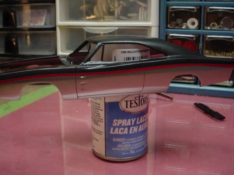

bryan_m Posted July 13, 2012 Author Share Posted July 13, 2012 ok, here she is, unmasked. the paintline came out really sharp, now all i have to do is let it dry and shoot on a very thin red stripe to seperate them. here we are with the tape still on her..... and now unmasked! a couple more, a little closer... let me know what ya think guys.... my workbench is a catastrophe! so its time for a little clean up while this thing is drying for the next color! thanks for lookin bryan Quote Link to comment Share on other sites More sharing options...

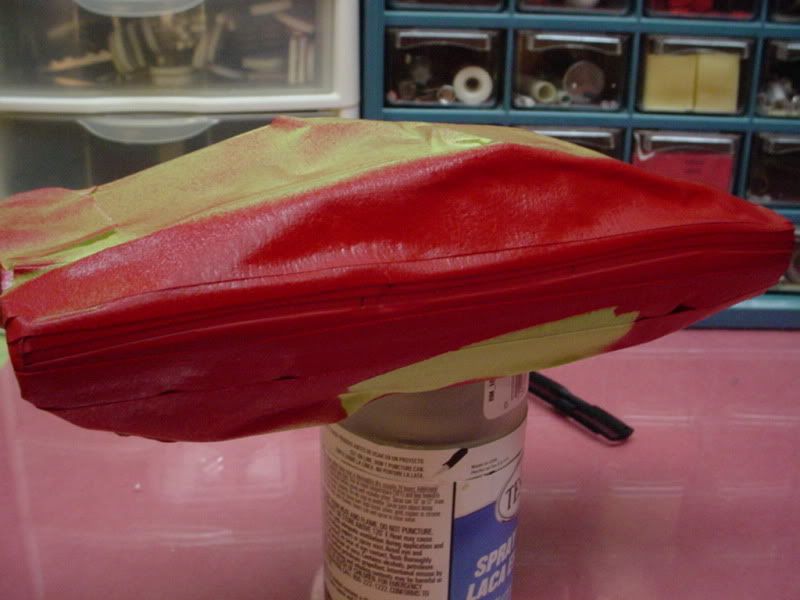

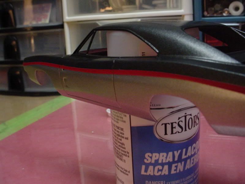

bryan_m Posted July 13, 2012 Author Share Posted July 13, 2012 finally shot the thin red stripe..... that was alot of masking for such a tiny stripe! its a scale 2" wide.......i had it maked off once, but didnt like it, it was way too wide, then i thought about doing a stripe like the cudas used to have with the slashes in them.....i was worried about it bleeding through so i didnt do it...... here is shot red, ill let it dry a bit and then unmask it..... oh and heres the tail light panel in place...... more to come, stay tuned bryan Quote Link to comment Share on other sites More sharing options...

Timeline Posted July 13, 2012 Share Posted July 13, 2012 Nice progress man! What kind of tape are you using for masking? Quote Link to comment Share on other sites More sharing options...
bryan_m Posted July 13, 2012 Author Share Posted July 13, 2012 thanks Karl! im using 3m blue fineline tape, and 3m green 3/4, and 1 1/2 tape. cheers bryan Quote Link to comment Share on other sites More sharing options...

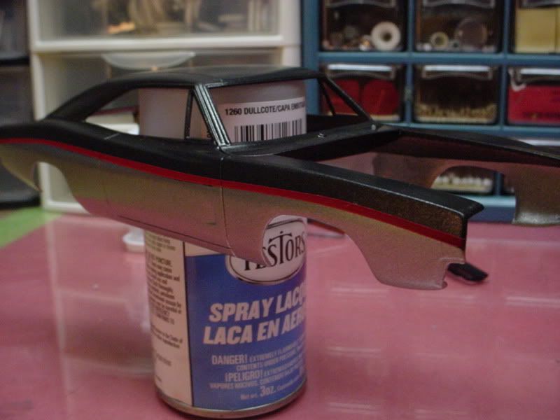

bryan_m Posted July 13, 2012 Author Share Posted July 13, 2012 ok, ive removed the tape, and this is what i ended up with. i think it came out ok, it got a little wide on me on the rear of the left quarter panel, but thats ok, you cant look at both sides at the same time! LOL thanks for lookin guys, ill wait a couple hours and start shootin clear on it, after i sand it very lightly with some 3000 grit paper to thin out the stripe so it wont take 3 gallons of clear to bury it..... more to come, thanks again for lookin! cheers bryan Quote Link to comment Share on other sites More sharing options...
