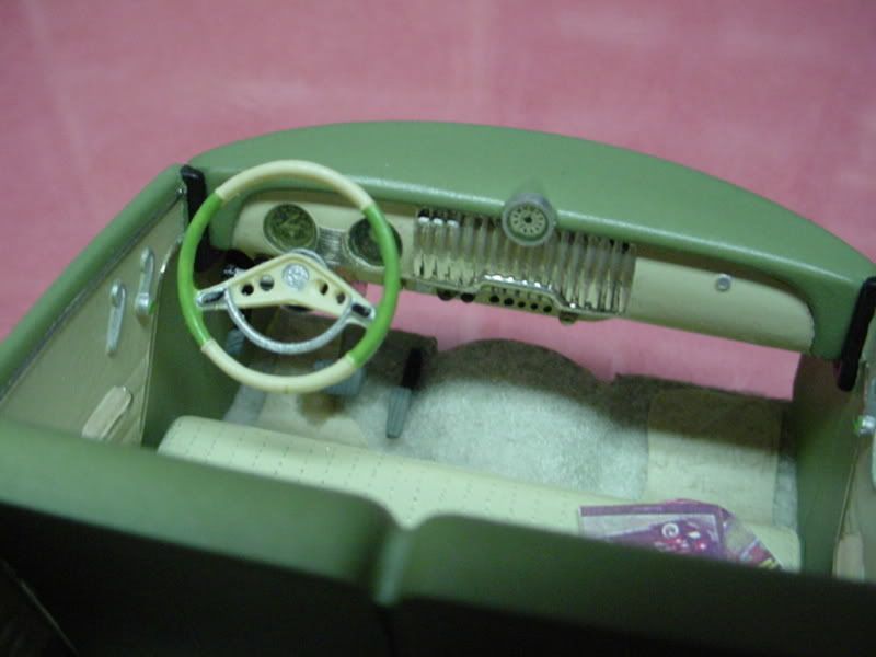

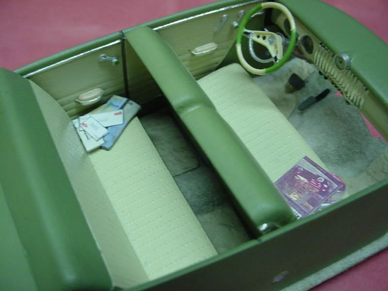

heres the completed interior, i may have to get back on this one.
im gonna have to look further and see what else i had done on this, but i might get back to it.....
lemme know what ya think about the interior guys

the interior colors are krylon "ivy leaf" and "almond"

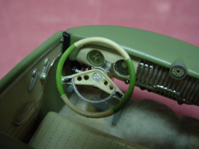

i flocked the carpet, used some photoreduced gauges and made lenses for them from crystal clear 5 min epoxy, the clock in the center got the same treatment, but it got an aluminum trim ring. i also added gas and brake pedals...along with some mail on the rear seat, and a couple hot rod mags on the front seat.
oh, and i made the "stitchin" on the seats stand out by gently rubbing it with a fingernail file.. and i made the steering column from a couple different sizes of aluminum tubing, with the end flared out where the wheel mounts on......

Bryan that interior looks great ! Yes, please finish it.
thanks Ray! im thinkin about it..........i totally forgot about this one. im lookin in the box, and i am missin all of the suspension parts tho, but i have some vette stuff i could cram under there! LOL

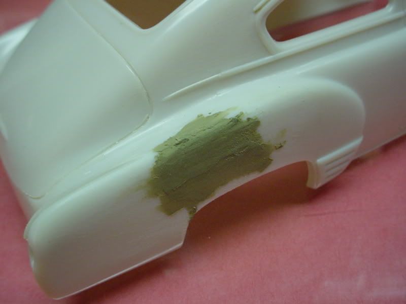

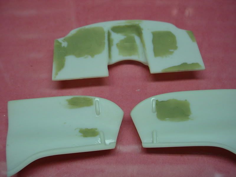

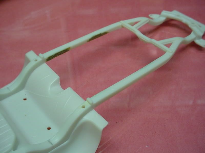

looks like i smothed the firewall, and inner fenders.....
and smoothed out the frame too......

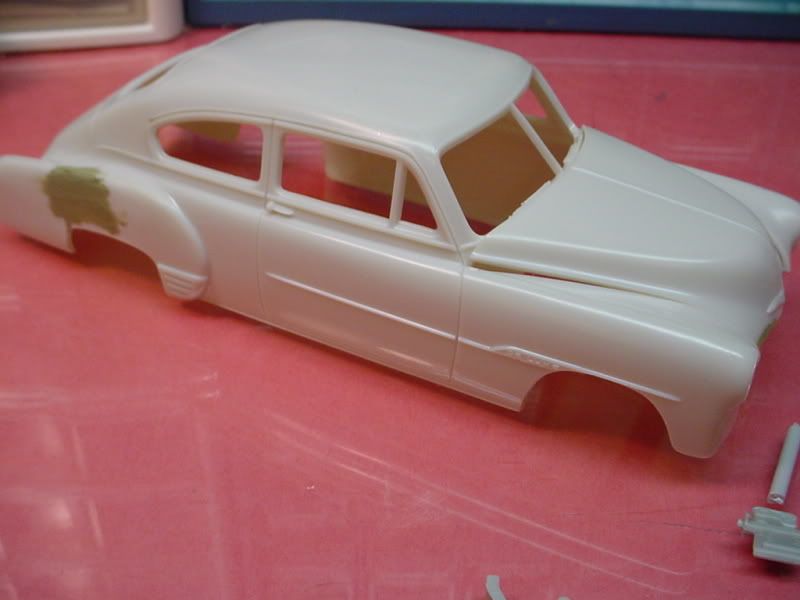

heres the culprit that may have made me stop on it...........a failed attempt to install frenched antennae!!

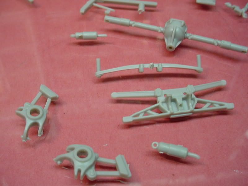

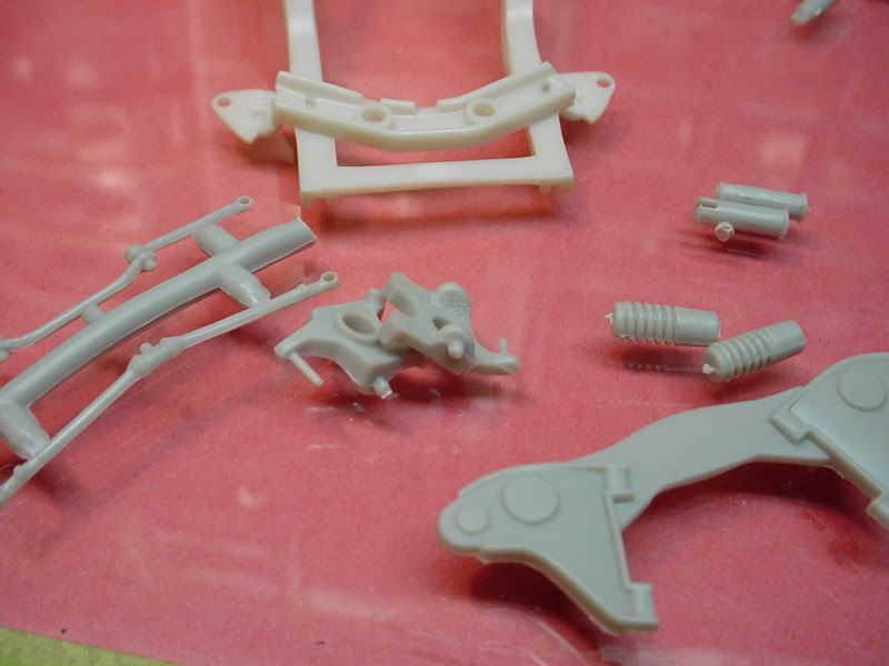

well i was going to start cleaning up my workbench, and i did get it a little straightened out............and then of course, something stopped me!
im going to take this........
and this.........
and cram it all under this.............
man i love it when an idea just leaps up and punches me square in the face!! LOL........stay tuned for more, my brain is stuck on this so i have to do something, even if its wrong! LOL

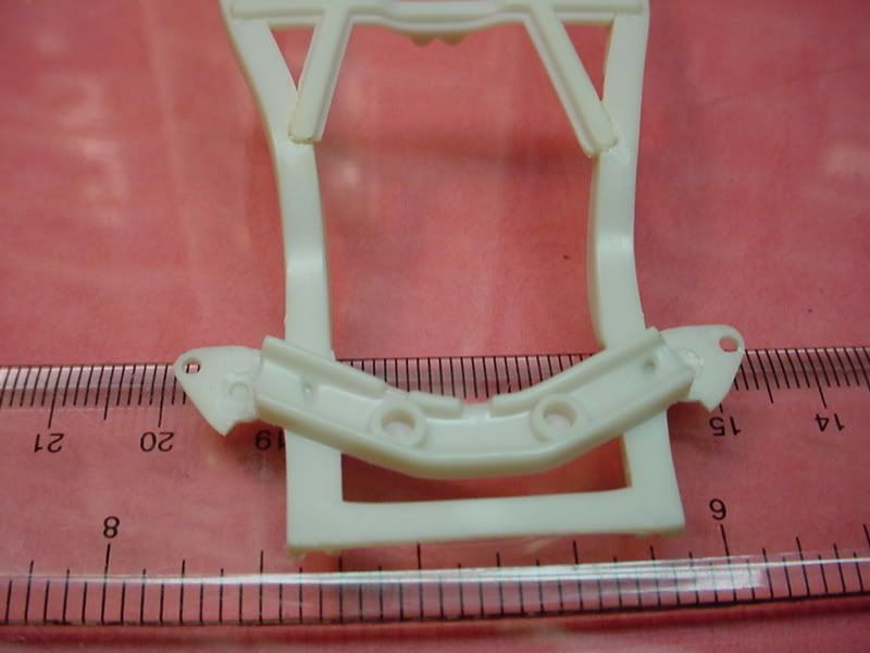

so heres what i have cobbled together so far......

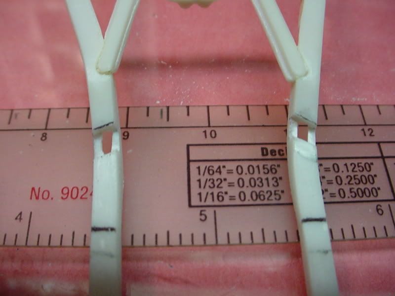

i had to establish a forward centerline, and then the center of the wheel well.......
heres the center of the frame (mark on front crossmember) and the center of the wheel well.......

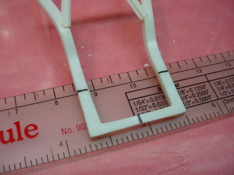

then i had to notch the frame to fit the new lower control arms....
heres the new control arms, and front crossmember in place...
i had to reinforce the frame after the notching.......it was really weak, a couple pieces of strip styrene took care of that!
