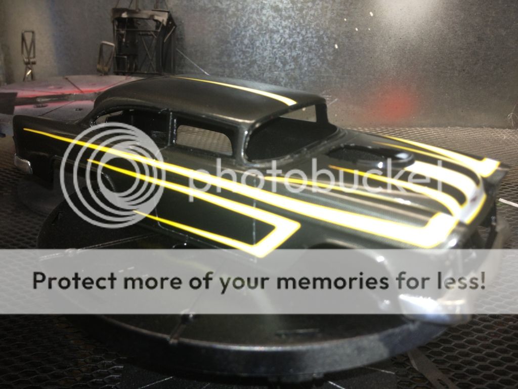

lanesteele240 Posted October 14, 2012 Posted October 14, 2012 Just sprayed testors wet look lacer over a model covered with carbon decals. Be careful. Light coats especially on old decals. Test with any decal not used like kit name/manufacture. Hard to tell in the pics but the black is carbon fiber sheet decal.
