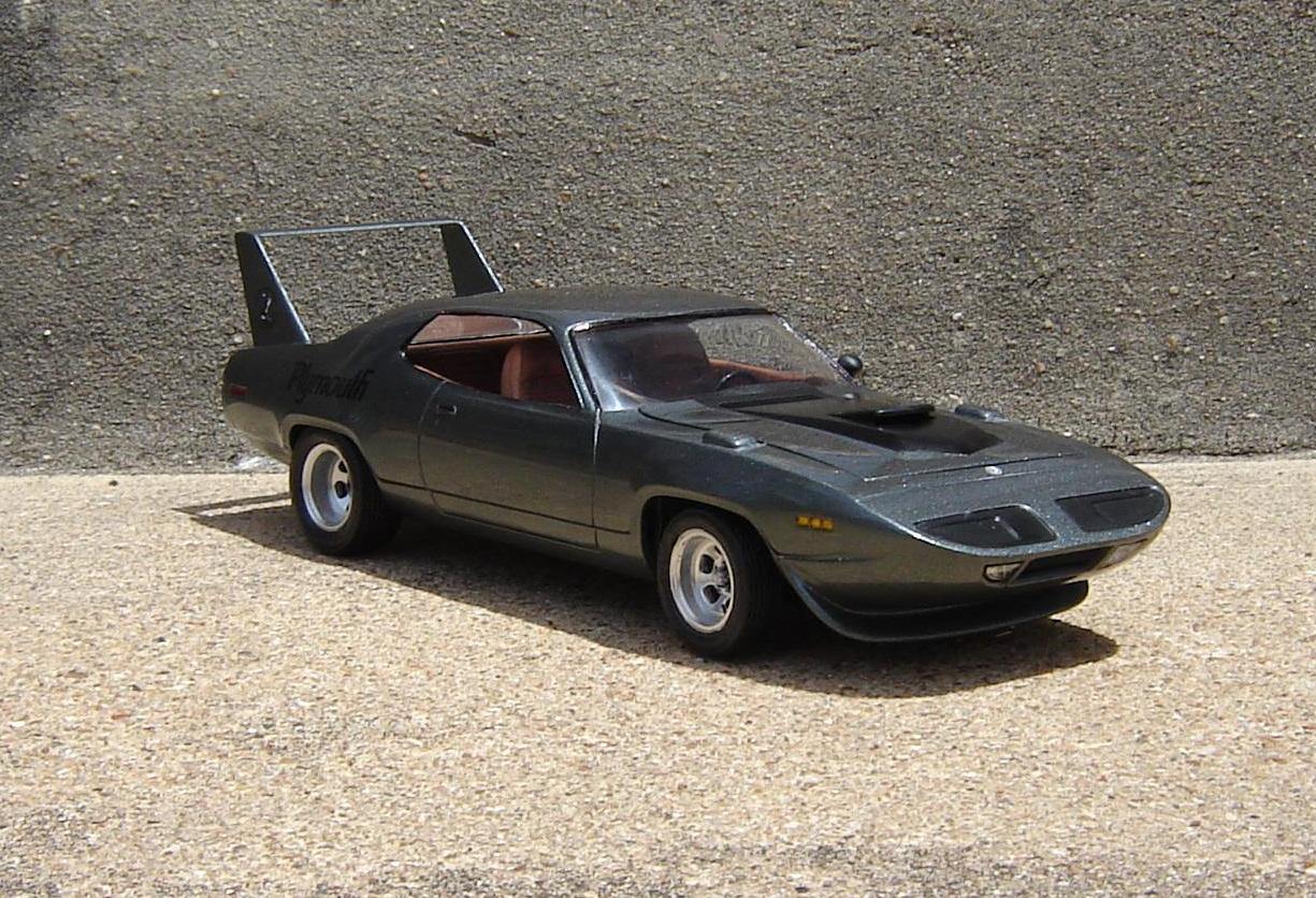

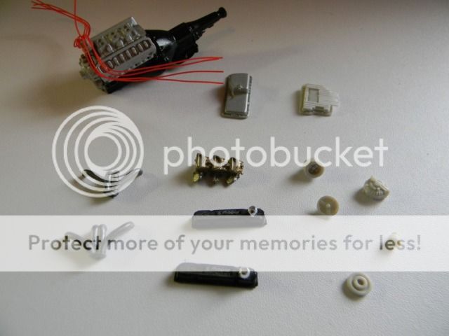

dougp Posted October 20, 2012 Posted October 20, 2012 (edited) This is my 2nd WIP behind the Topkick I started in Pickups, Vans, SUVs and Light Commercial. It is actually further along than the Topkick, but decided to post it too. I'm terrible at remembering to take pictures, so bare with me. The build is 71 Daytona based on the AMT 71 Dodge Charger R/T kit. Parts are supplied from the AMT 69 Daytona, Revell 70 Superbird and 71 Plymouth GTX. The nose and side filler panels came from the 69 Daytona and actually fit easier than I expected. I straightened the front edge of the fenders and hood to line up and attach the nose cone. The wing was from the 70 Superbird and the top of the rear fenders and mounting points had to be reworked for a cleaner fit. The rear bumper was dechromed and the badges removed. I plan to use the 5 spoke oem wheels with a set of Fireball Modelworks Goodyear Eagle GT's. Here is what I have so far: Engine is based on a Mopar Performance equipped 440 6pack pictures found on the web. I made custom decals to duplicate the finned Mopar Performance valve covers. The shorty headers were scratch built. The finned transmission pan and pulleys are works in progress. Enjoy, comments, suggestions and ideas welcome. Edited August 2, 2013 by dougp

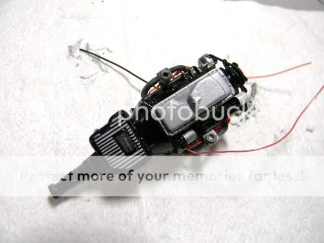

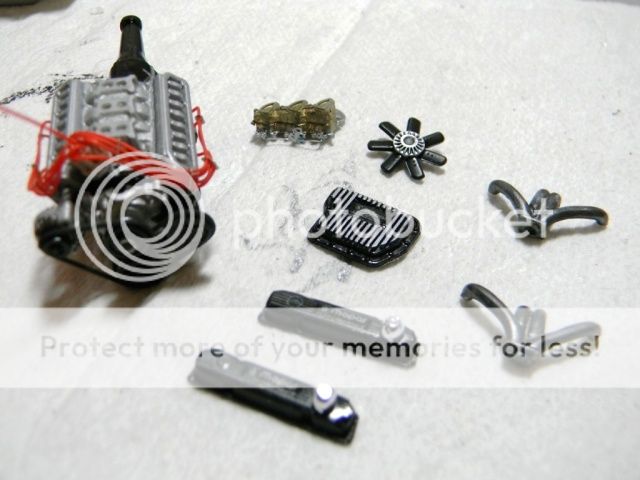

dougp Posted October 23, 2012 Author Posted October 23, 2012 Might I suggest a paint scheme? Great pic Jacen, I'm a big Nascar fan but not on this build. The color I've selected is Duplicolor GM Autumn Maple Met. Haven't decided on the interior color(s) yet. very cool! where did the mopar performance valve covers come from? cheers bryan I used a pic for the mopar performance catalog to make decals. I painted the valve covers flat black and sanded the top service so the gray plastic would show through the lettering and fins of the decals. I used some chrome parts box breather caps to top them off. For the mopar performance finned tranmission pan I used strip styrene to create the fins and dry bushed silver over the top of the ribs. I used another decal for the mopar perf. logo. I'll be posting pics of the basic engine/trans assembly in the next couple of days. Waiting on parts to finish it. Hopefully they'll be here tomorrow.

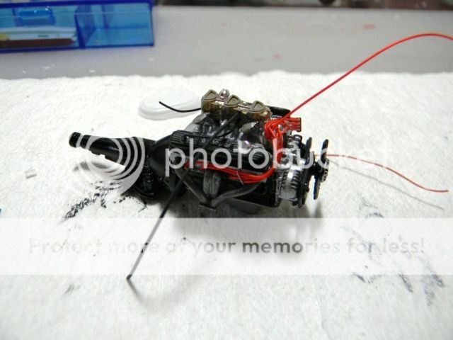

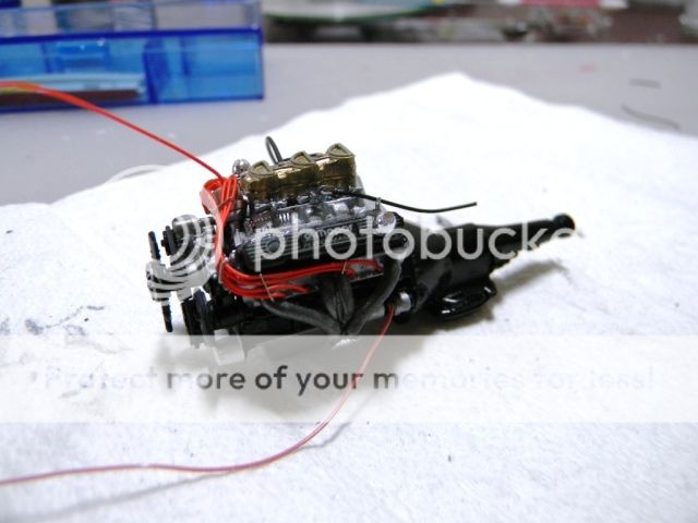

dougp Posted October 30, 2012 Author Posted October 30, 2012 Update 10/29/12 The engine is complete. The air cleaner is drying, It was painted hemi orange and still needs to be cleared and buffed. Also noticed I forgot the dipstick, so I'll have to add it too. The trans pan turned out better than I expected. Block is gloss black, heads gloss aluminum, water pump and oil pan sliver, headers are magnesium and the carbs are a combination of silver, brass and gold with a black wash. Distributor by SMBC. This week I plan to get the chassis started and the ride height set. If the weather ever clears up I hope to do the final prime and prep on the body. Thanks for looking.

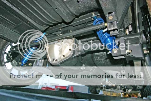

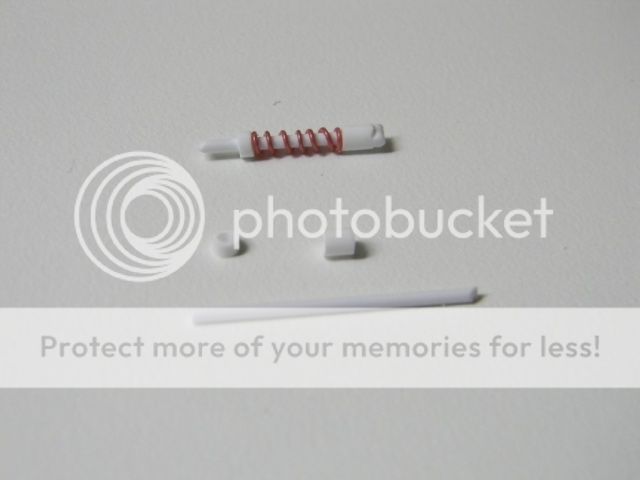

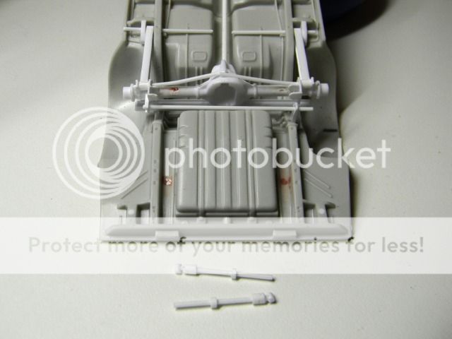

dougp Posted December 11, 2012 Author Posted December 11, 2012 Update 12/10/12 Well it has been a while since I’ve updated the Daytona. I’ve been busy on the Topkick WIP, but decided to give it a rest to work on the Daytona. I like doing modern upgrades to older cars and wanted to do something different on the Daytona. I built a modern 440 for it so it needed a modern suspension. After a couple hours of research on the web I found the Alterkation suspension upgrades for Mopars. It was a challenge working with such small pieces but after several attempts I think I finally got something close. The 1:1 The kit differential appeared wimpy so I swapped it out for one in the parts box. Haven’t decided whether to fin the cover or try and reinforce like the one in the 1:1. The Daytona's new rear suspension. I used styrene channel and strip to make the trailing arms, axle, coilover and panhard bar mounts. Rod and tube styrene was used for the coilover shocks, different bolt attachments (to be shortened later) and panhard bar. The shocks will be painted silver and red clear then wrapped with red wire. Still need to add the stabilizer bar, add a reinforcement cross member for the coilovers and clean up and shape/shorten the parts. Next I am going to attempt replicating Alterkation’s K frame coil over replacement for the front suspension. I've been a little hesitant about cutting out the K frame but I’ll never get it done unless I try. Anyone got an AMT 71 Charger in case I screw it up Thanks for looking...
