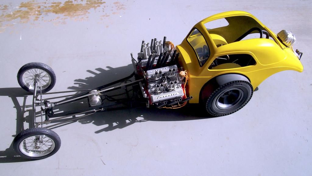

I didn't realize it had been so long since I posted in this thread. I have almost finished another car besides this one.
The rubber molds I made for the fiat body were intended for a brush on urethane but the material wouldn't play.
I ended up using vinyl ester tooling gelcoat and VE resin for the layup. Minimal shrinkage with maximum cost. :)
The body is just placed on atm. It won't be green, that's the gelcoat color.

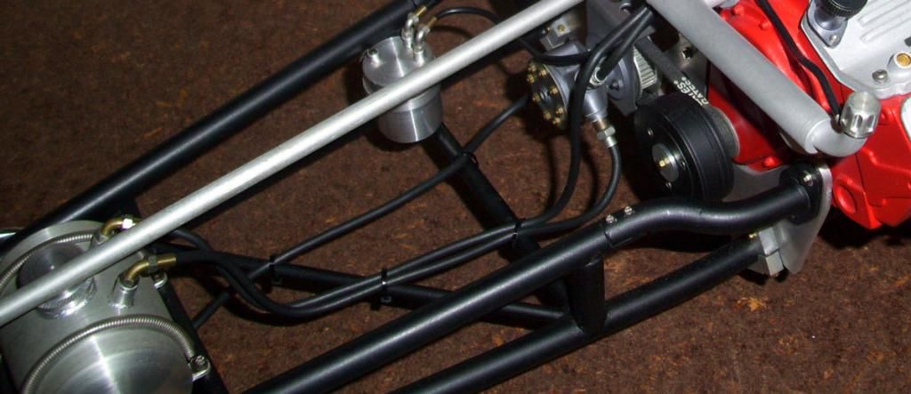

It's been a while since I posted updates on this car. I have been building two cars concurrently and will finish both about the time.
A shot of the engines. No oil stains yet.

pharoah, the body was made from styrene profiles and styrene sheet in all the areas I could bend without compound
forming. The compound shapes were done with styrene foam and Bondo to blend to the profiles.. Silicone rubber mold
and vinyl ester tooling gelcoat and VE laminating resin for the finished body. VE resin are low shrink and didn't warp the thin mold.
