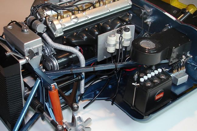

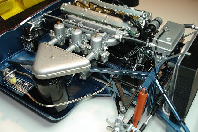

This is the mid-70s kit release, molded in bright yellow, but otherwise identical to the original, red plastic release from the early 60s. I'm doing a replica of a very early first year car...one of the first few hundred produced, with the external bonnet locks and the road draft tube (which was eliminated early on in the production run.) I've added a lot of details, like hose clamps, battery caps, coolong fan, various linkages and mechanical bits and pieces that were not part of the kit (however, no aftermarket stuff used...it's all scratchbuilt) using photos of restored cars I found on the internet, and a few books I have on Jaguar restoration. Still a few wires laying loose, but otherwise the engine is done.

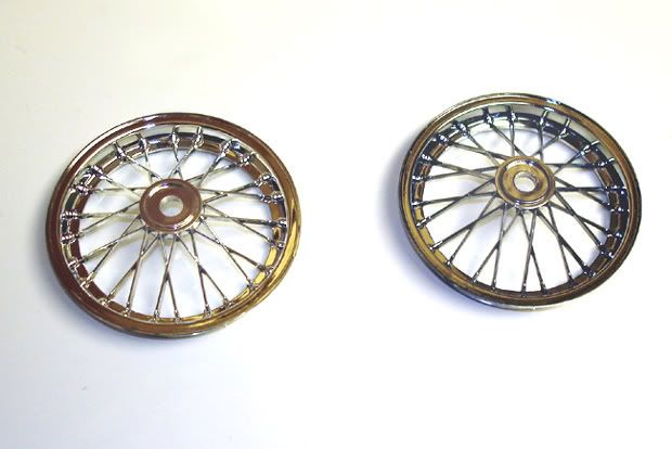

And the wheels.
I sprayed a coat of Testor's transparent black window tint on them to add a little depth ("before" on the left..."after" on the right)...

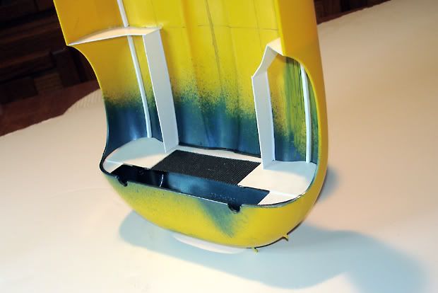

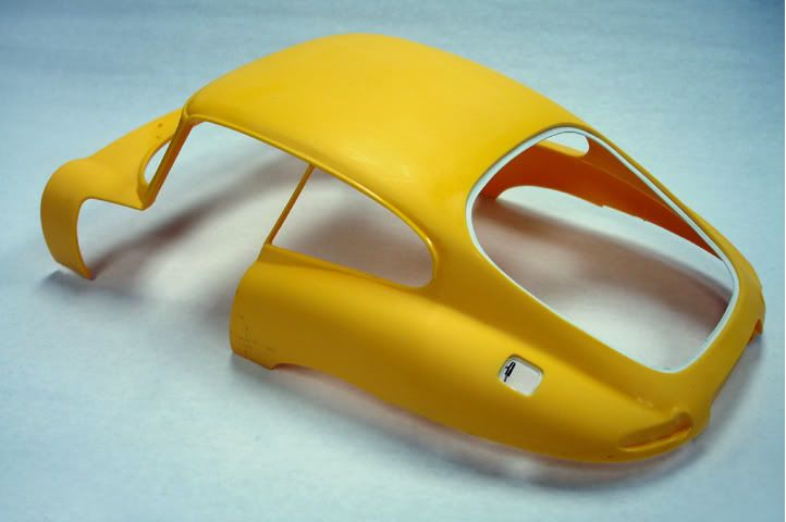

I removed the molded-in rear side window frames because I'm going to make them operable (swing-out). I also removed the gas filler door and rear hatch door so I can hinge them...

However, I noticed something you missed; the carb flanges should have two bolts each, where the air cleaner is attached. I have an old friend who specializes in SU carbs, in fact he has a business called SU Service not too far away from where I have the summer house. Since you have added so many other details, I think you need to add some more. Check your reference photos..... and if you want, Google SU Service. Sorry, all the text is in swedish. Not sure if he's got an english version.
