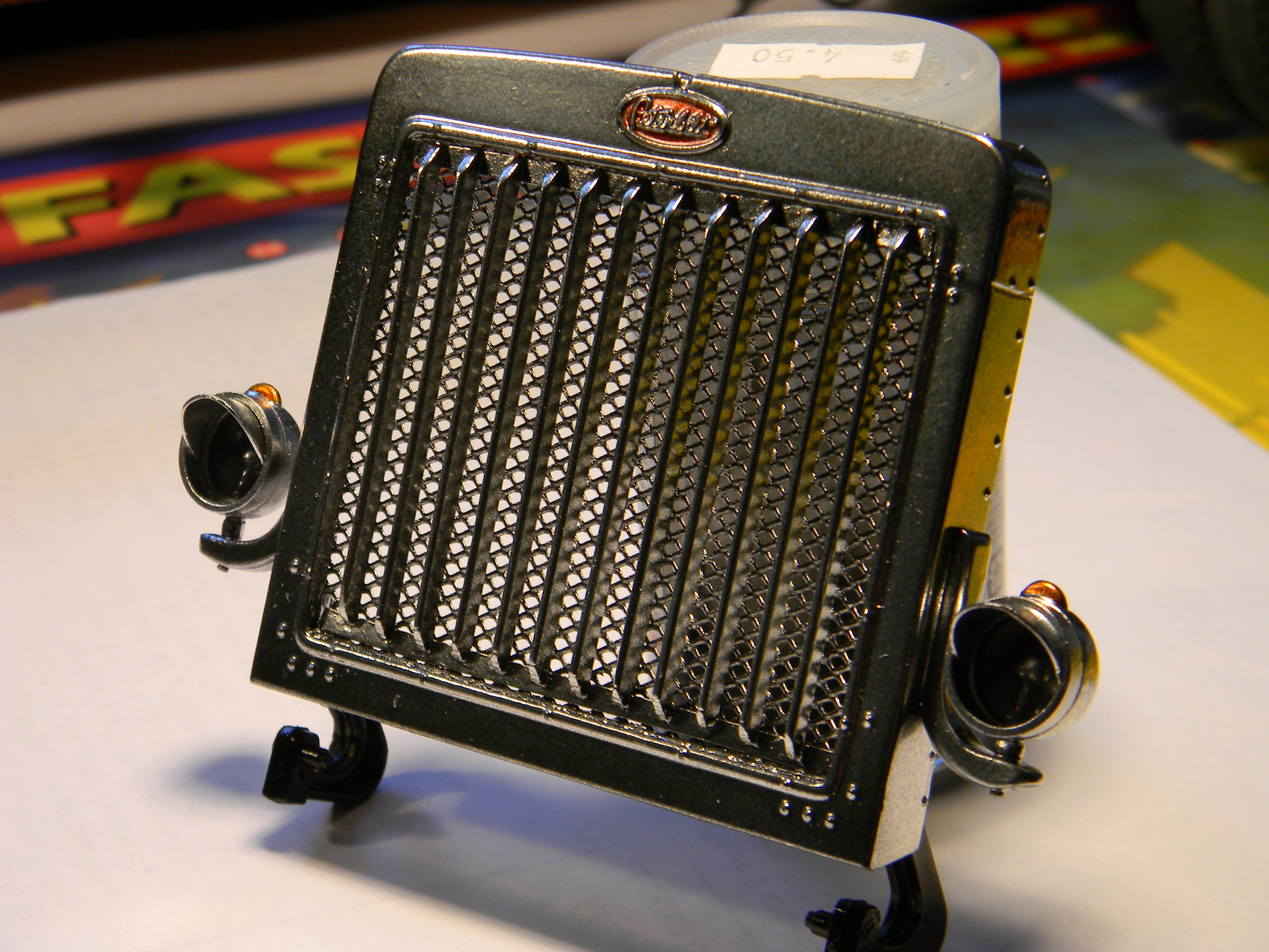

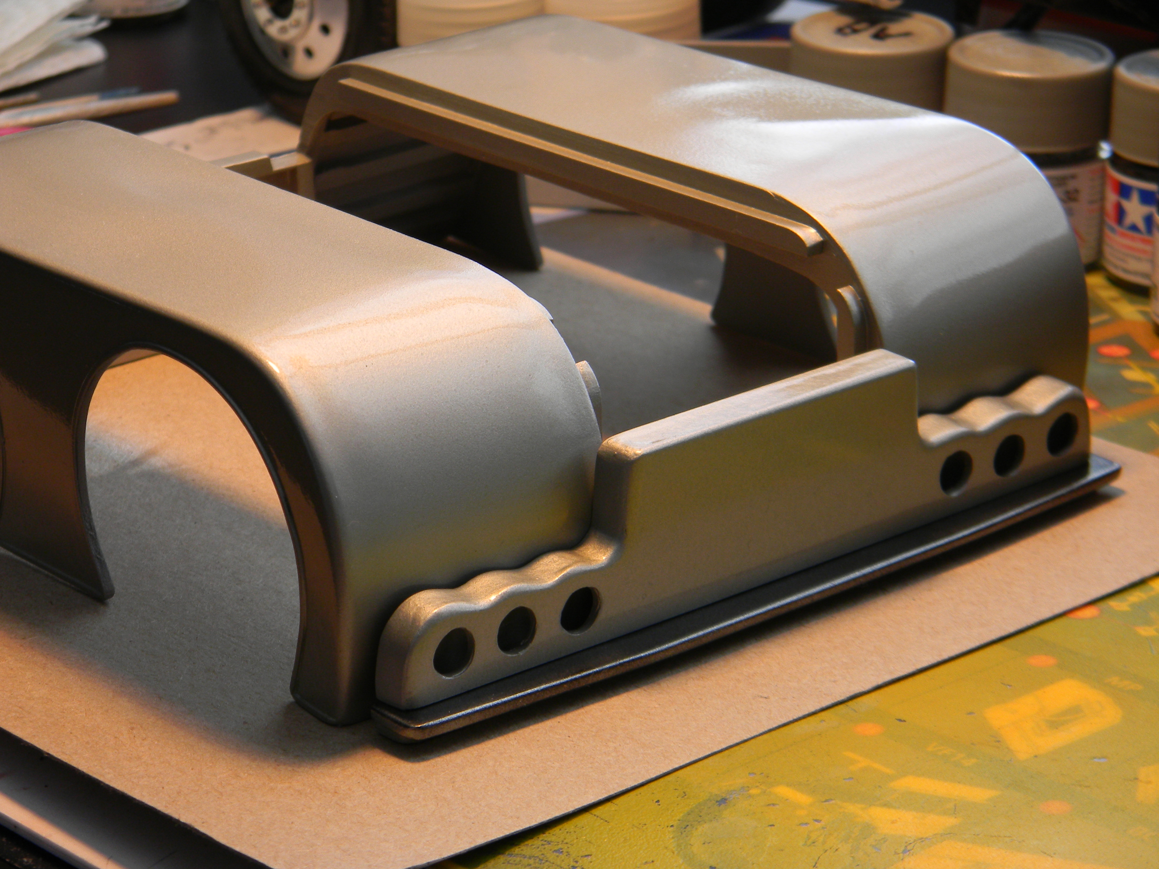

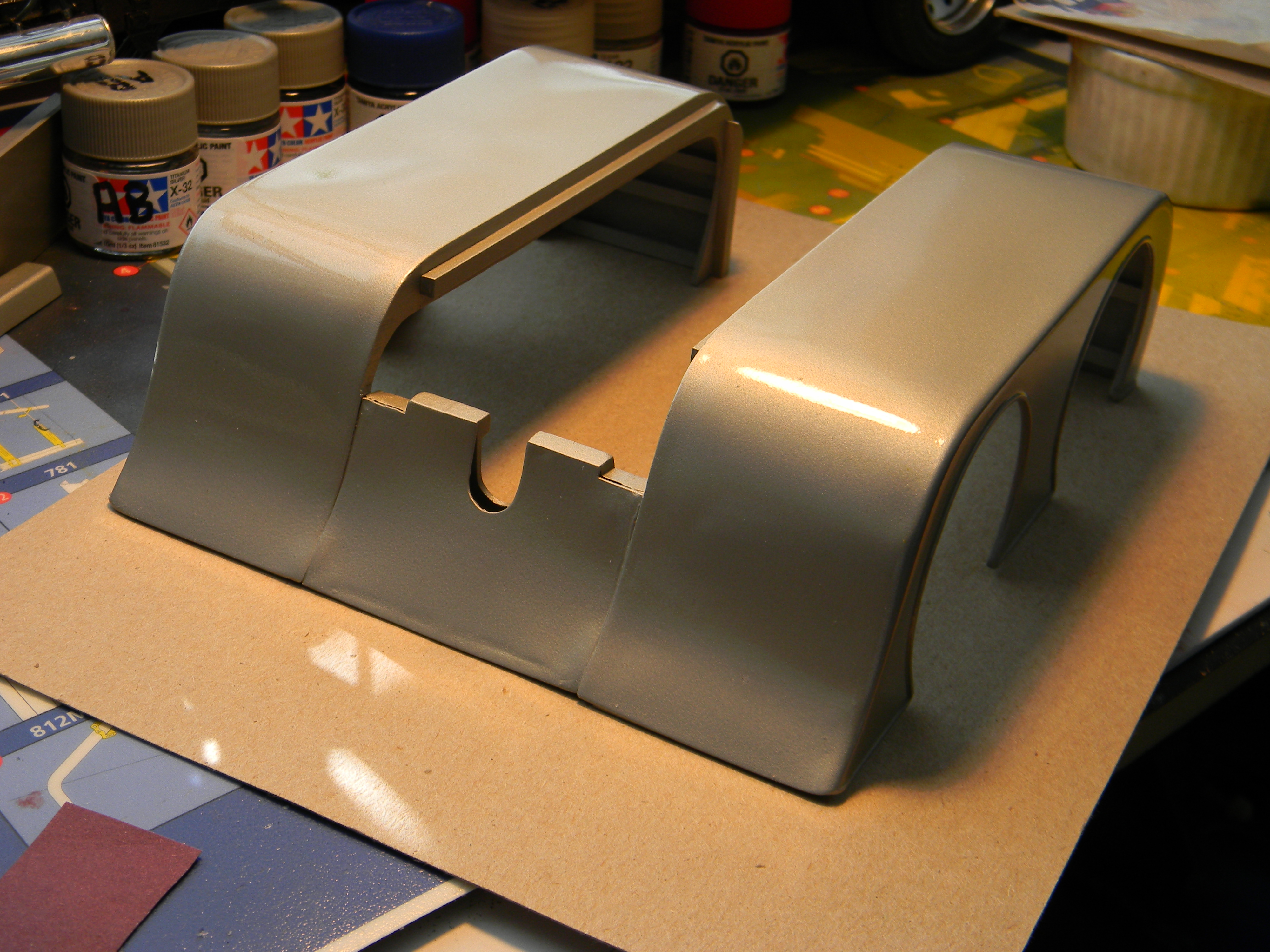

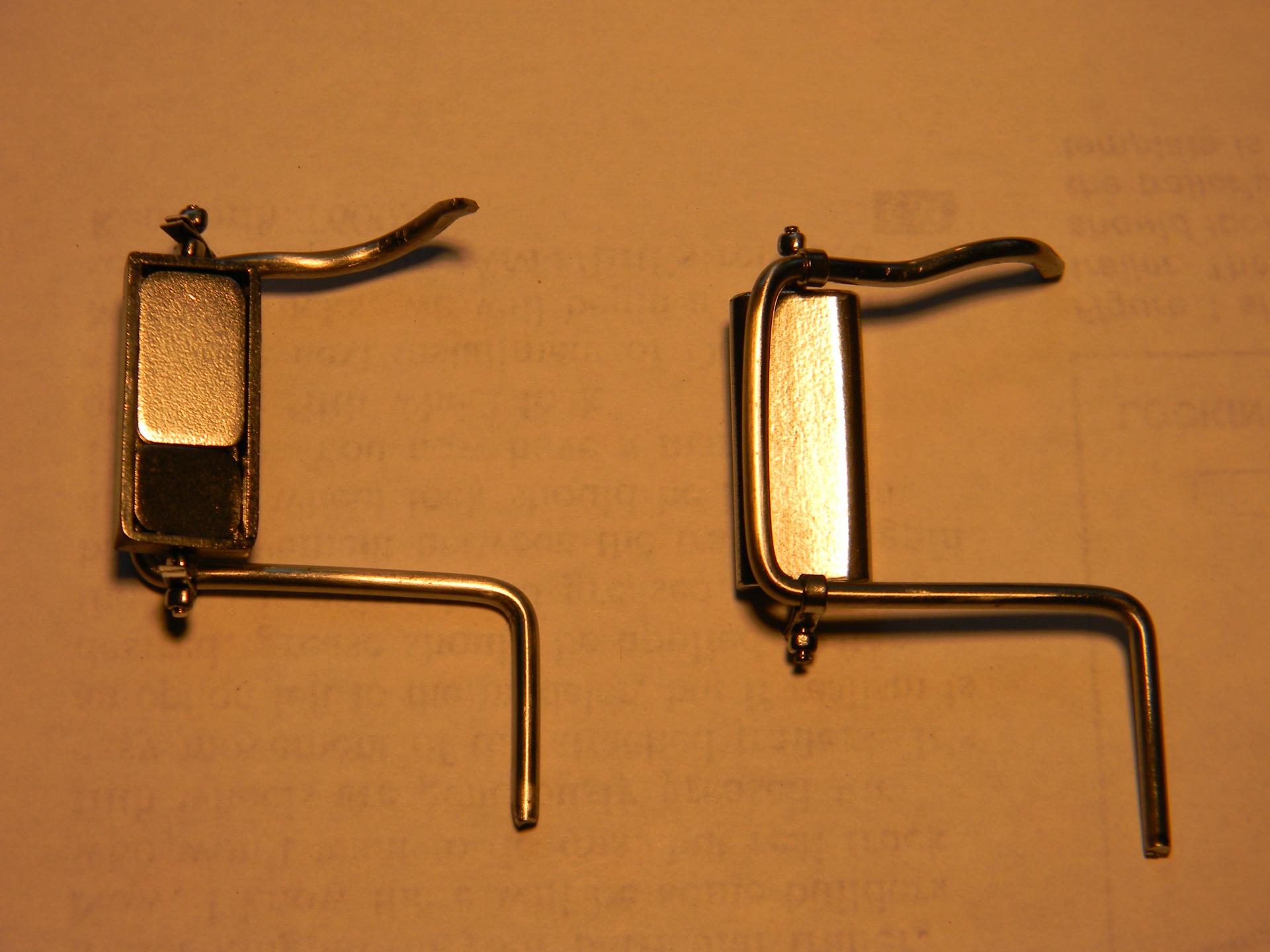

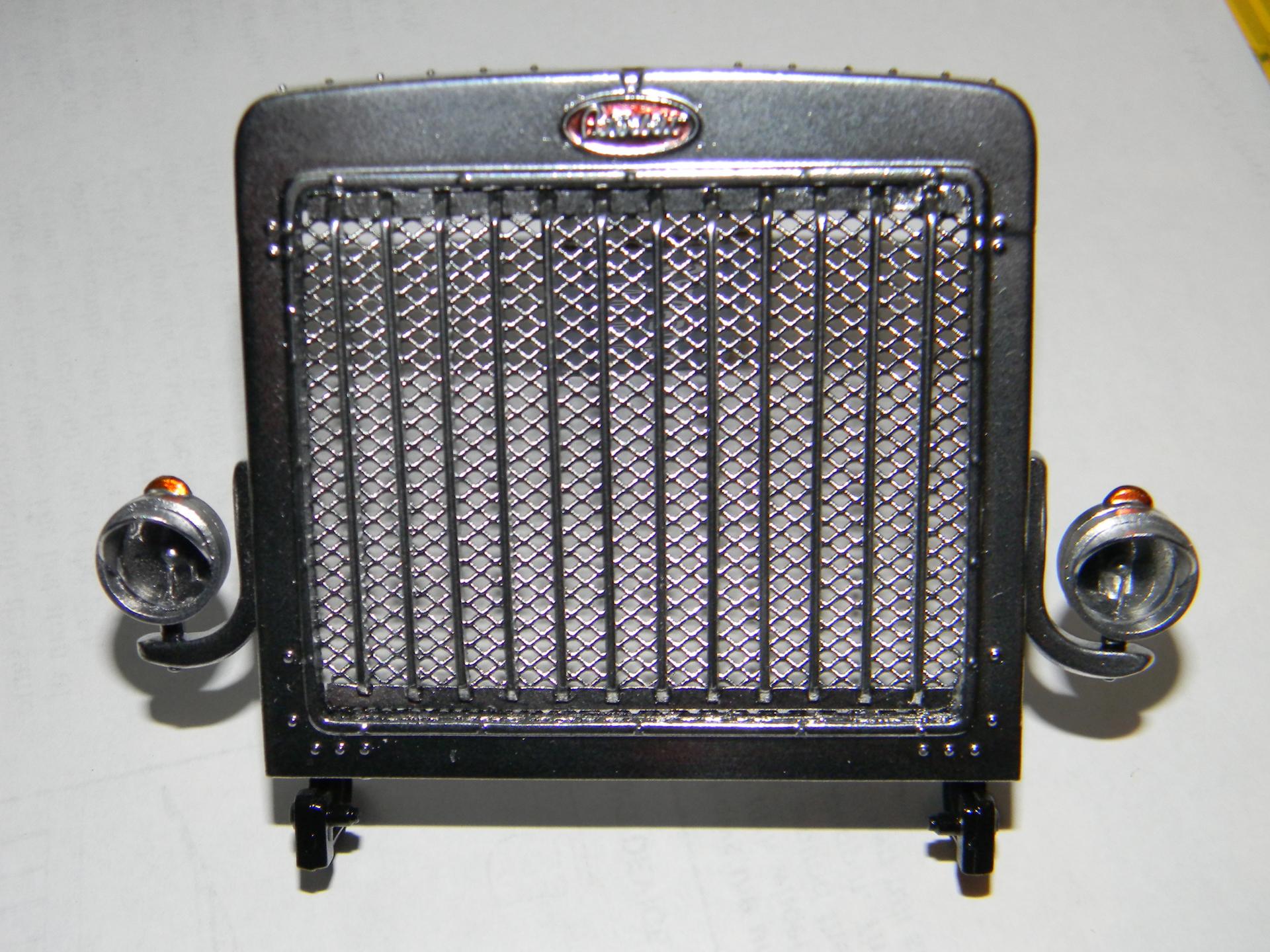

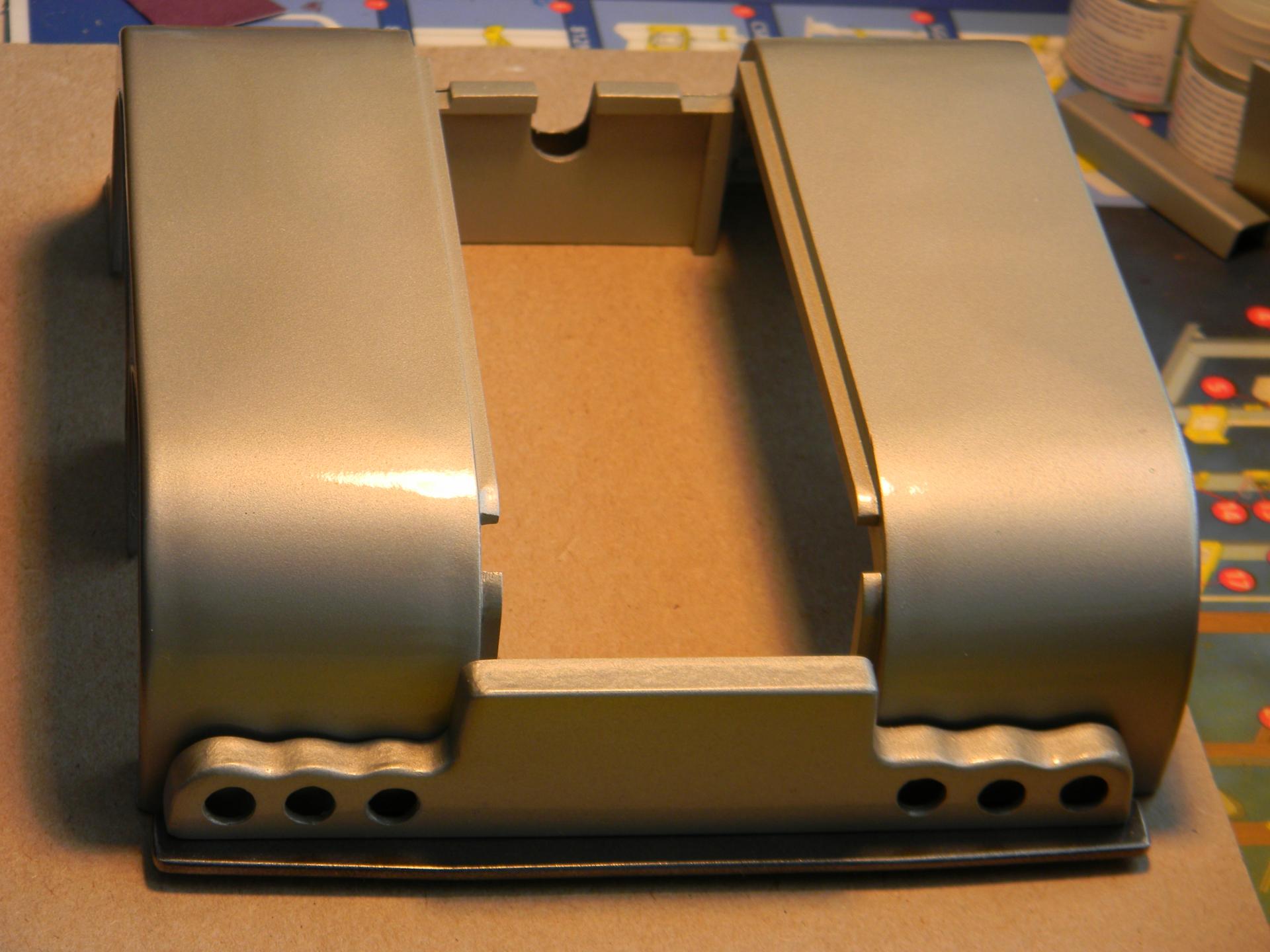

Kenny B Posted December 13, 2014 Author Posted December 13, 2014 (edited) I'm reposting the pictures that were lost. I have all the chrome painted and have started painting the truck. Mirrors are done. Â Grill is finished added the turn signals. The rear fenders and bumper are painted and cleared but still needs to be wet sanded and polished. I also have the front fenders done. I will be posting more soon. thanks Ken. Edited February 4, 2018 by Kenny B

youngtiger1 Posted December 16, 2014 Posted December 16, 2014 Ken, that front grill of yours looks awesome. Also, the fenders looks shiney. Mind I ask, what is your painting/polishing process? Thank you kindly Mike

Kenny B Posted December 16, 2014 Author Posted December 16, 2014 Ken, that front grill of yours looks awesome. Also, the fenders looks shiney. Mind I ask, what is your painting/polishing process? Thank you kindly Mike Mike, I like to use all Tamiya products on my models. I like the easy cleanup and no smell. Once all the body work is all done I spray Tamiya primer then wet sand it with about 1800 and look for flaws.Wash with soap and water,then repeat several times until perfect. Then I sprayed Tamiya titanium sliver mixed with some titanium gold (using an airbrush). It was lightly wet sanded with 3600 washed with soap and water and sprayed again. Wet sand again if needed. Then I spray on Tamiya clear,Wet sand lightly with 4000 washed with soap and water and spray another thicker coat. Wet sand with 4000 once more to remove any dust marks or orange peel and let sit for a couple of weeks before polishing with Maguiers car wax. Hope this helps. The important thing is to make sure that you wash it well to remove fingerprints and specks of dust. Be careful not to sand through the paint or clear coat. A dust free room is important. I made my own spray booth using a plastic tote with a small fan and a dryer hose to vent outside. It works well and is dust free. A lot of guys may not agree with all the steps I do, but it works for me and looks flawless when finished. Ken.

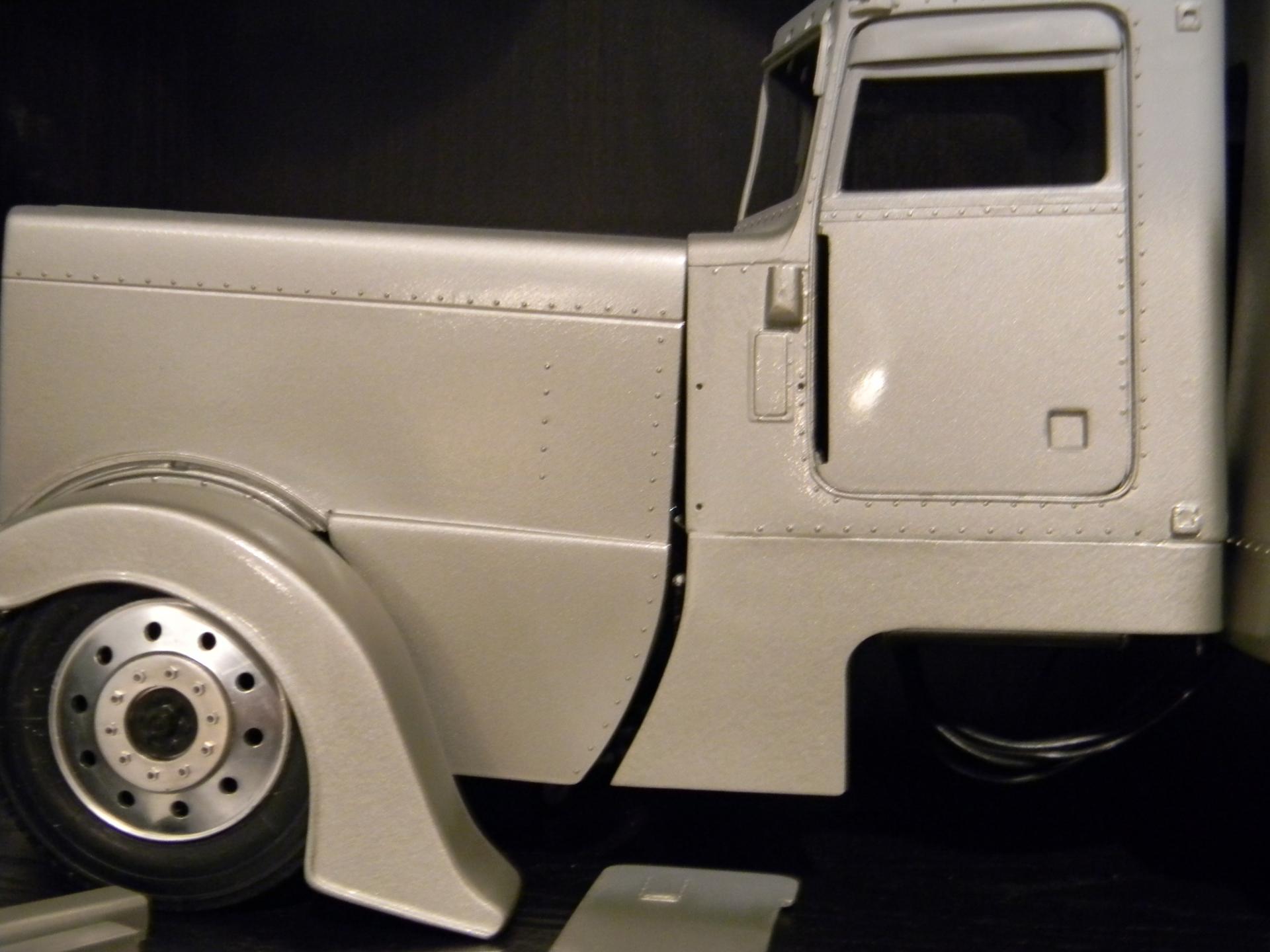

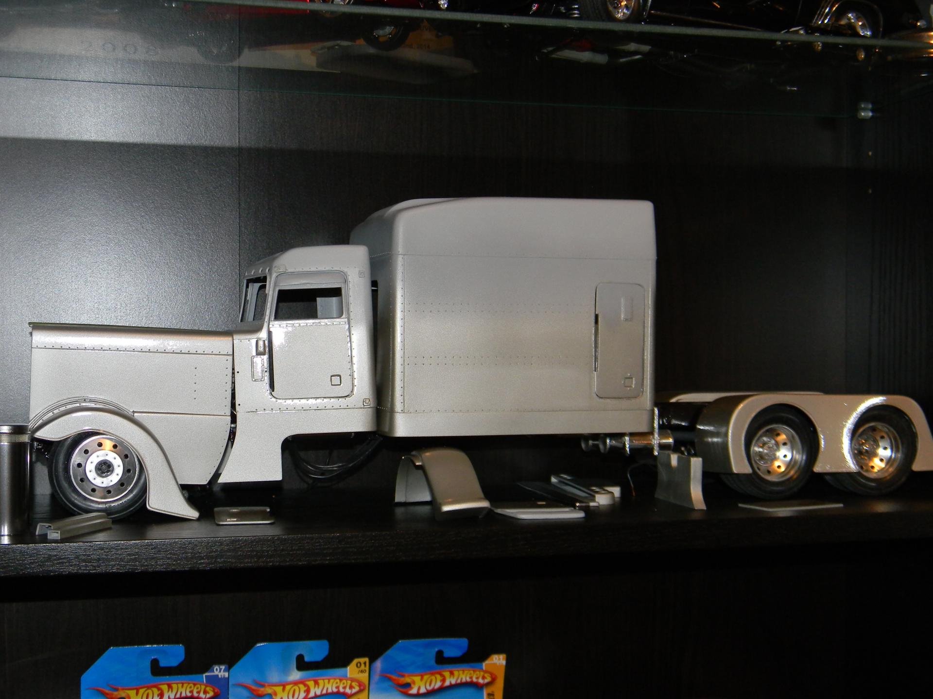

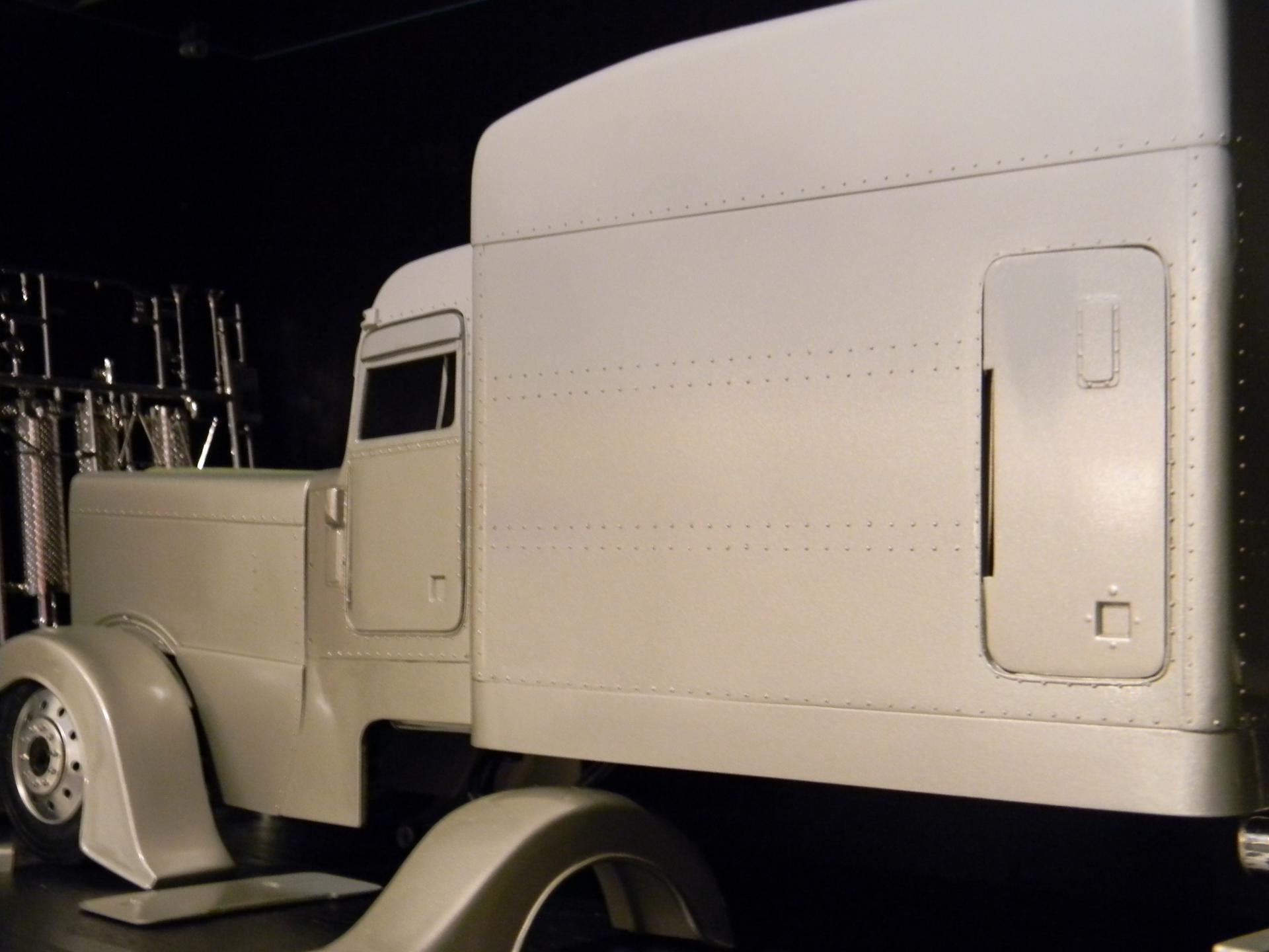

Kenny B Posted January 15, 2015 Author Posted January 15, 2015 (edited) Thanks for the comments. More up dated pics. I have all the silver painted now but still needs to be wet sanded and cleared. I'm ready to start on the other colour now, stay tuned. Kenny B. Edited February 4, 2018 by Kenny B
kilrathy10 Posted January 15, 2015 Posted January 15, 2015 Stunning work, Man.....Beautiful job on all of it.....Gotta love the patience and perseverance you have with this stuff.....Can't say I'd take this long with ANY model.....Great job.....
olsbooks Posted January 15, 2015 Posted January 15, 2015 Kenny, one of these days I hope to get somewhere in the same ballpark (even if just in the parking lot) as this level of true craftsmanship. A true work of art and demonstration of talent. Peace
youngtiger1 Posted January 16, 2015 Posted January 16, 2015 Kenny, thanks for the info on painting. This monster is looking awesome with every update. Hope you have room for it in your showcase, but if not...well, I'm just saying...brothers here to help..lol j/k. Mike

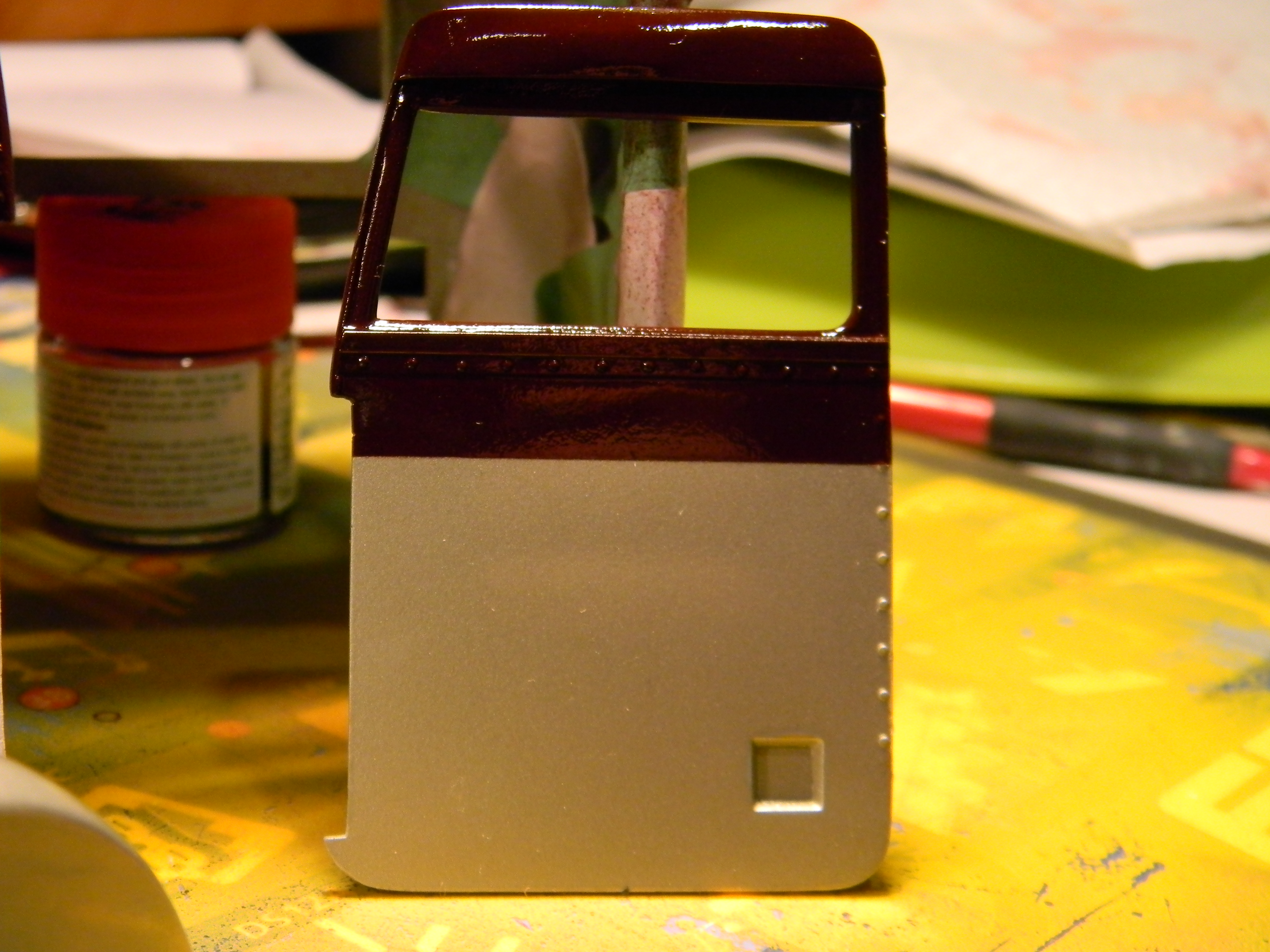

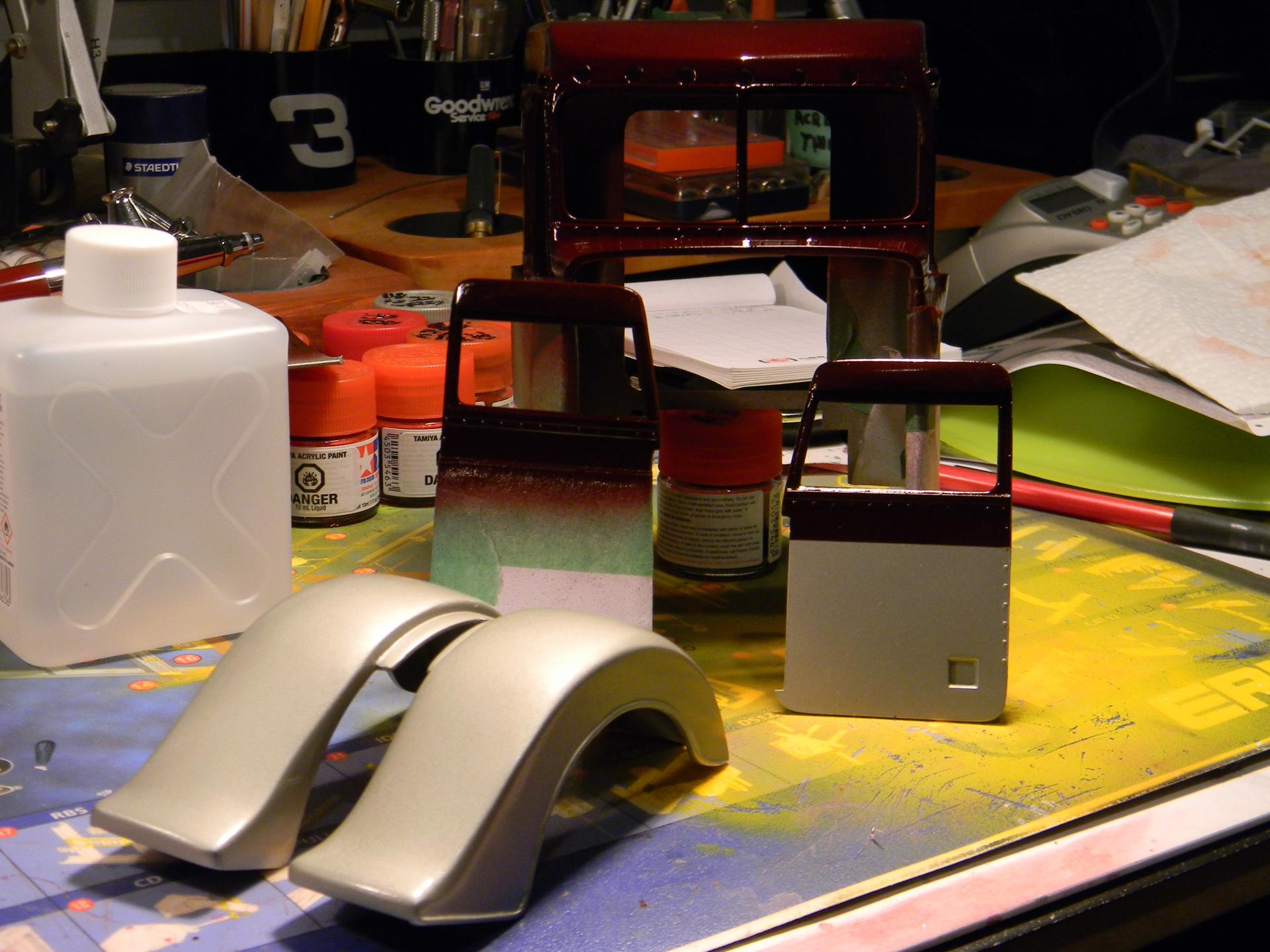

Kenny B Posted February 18, 2015 Author Posted February 18, 2015 (edited) Thanks for all the comments. My second colour is almost done. It still needs to be wet sanded and clear coated. Slowly but surely shes coming along. Â Â Will post more once I have her all clear coated and wet sanded. Kenny B Edited February 4, 2018 by Kenny B
72 Charger Posted February 19, 2015 Posted February 19, 2015 Dat's gunna be sweeeeeet ;)Im really likin the paint so far . Nice red !

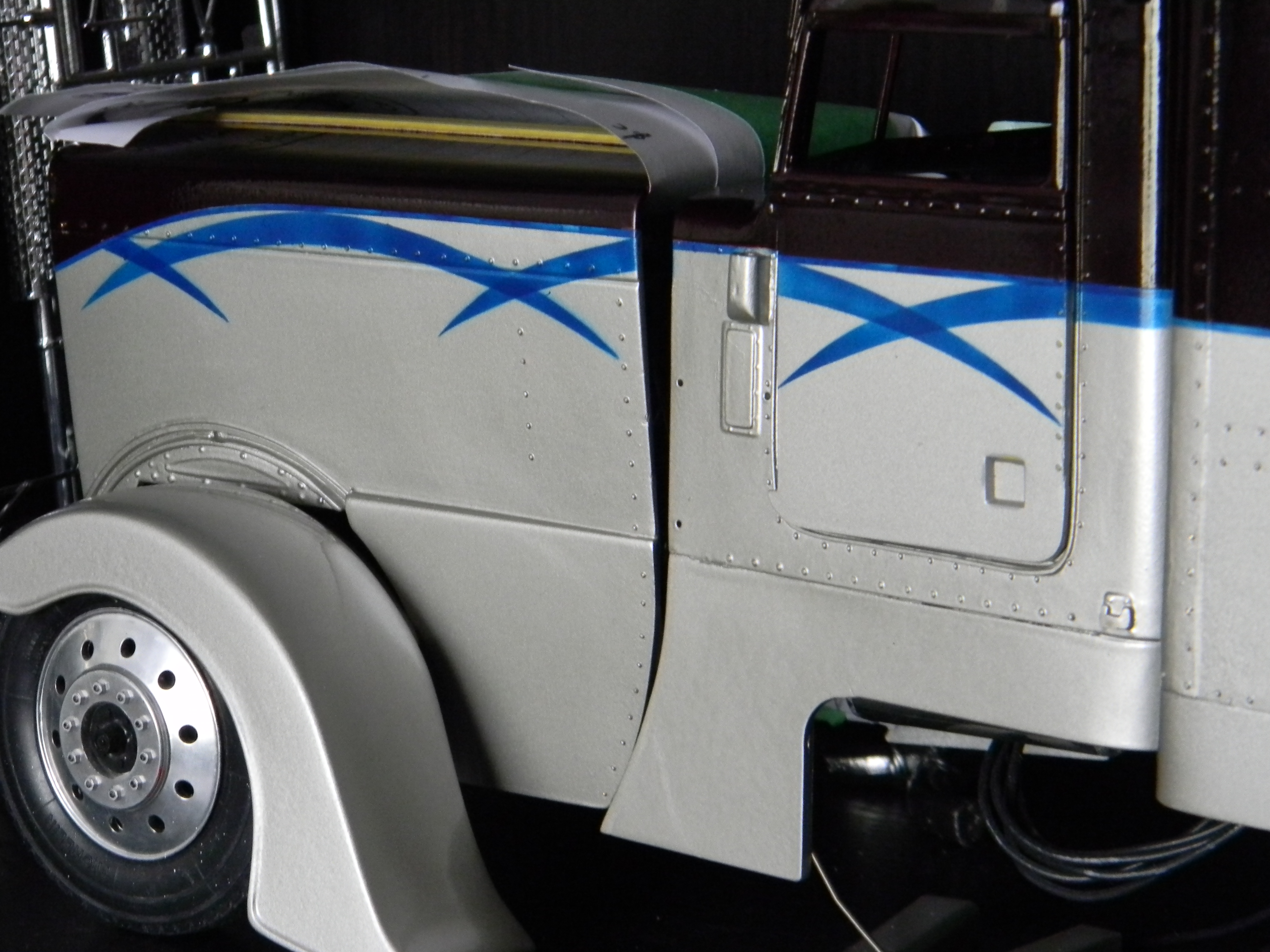

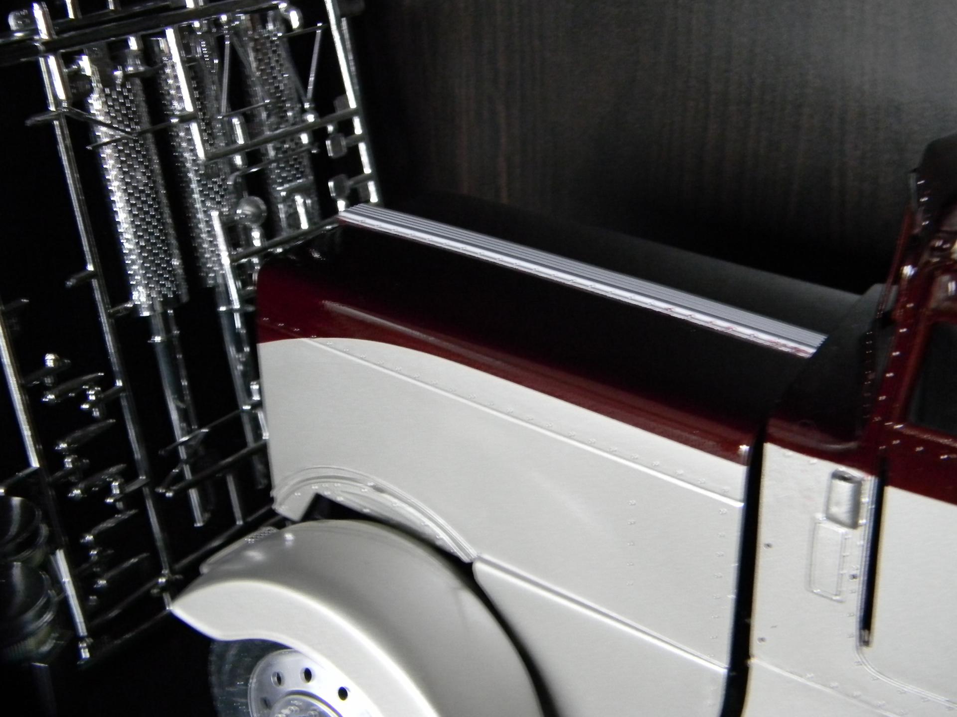

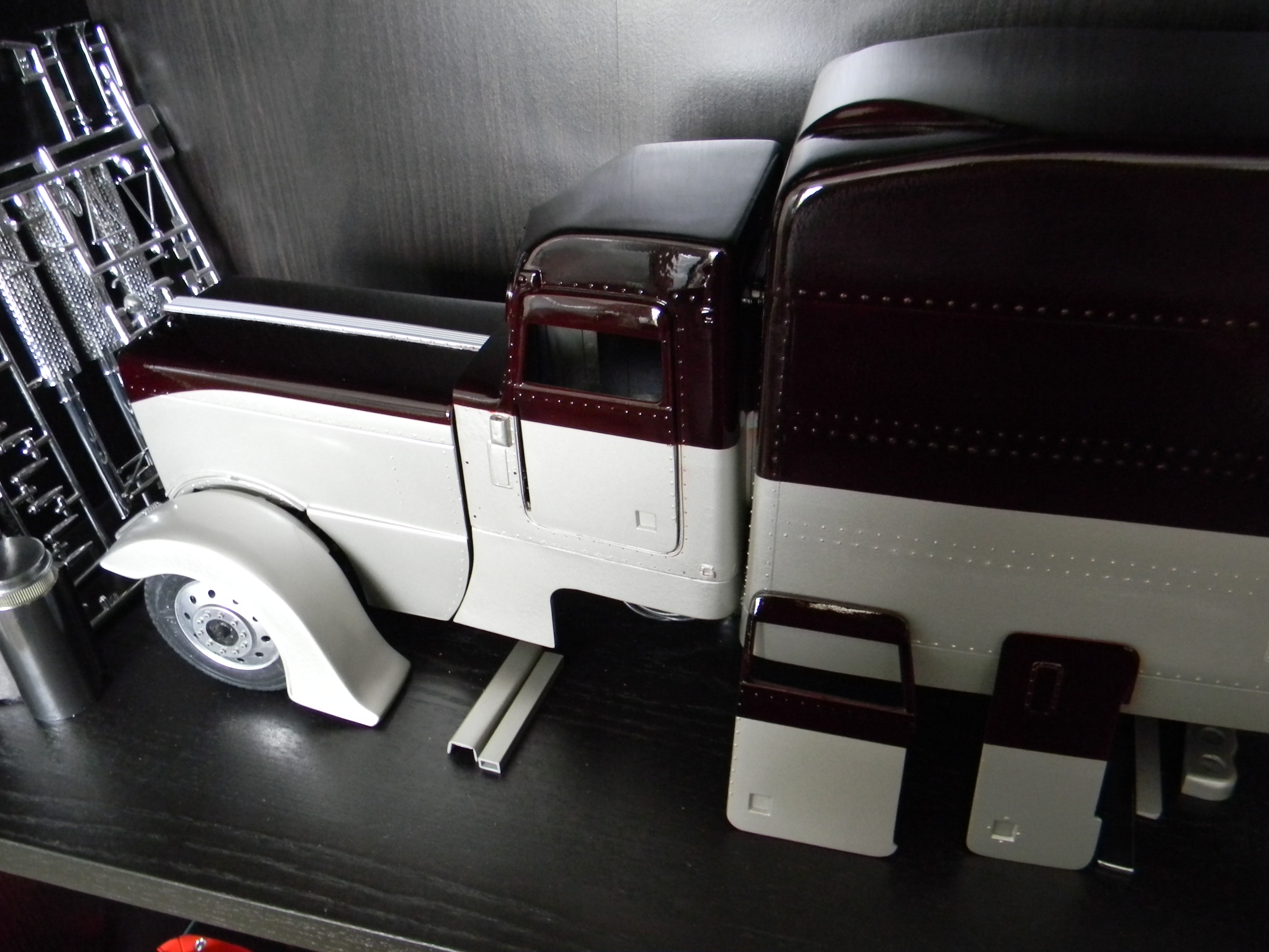

Kenny B Posted March 22, 2015 Author Posted March 22, 2015 (edited) Thanks for the comments. I think that I'm ready to start clear coating. Still working on the strips idea,but she's starting to come to life. Just a little teaser for you.... Thanks, Ken. Edited February 4, 2018 by Kenny B
codie27 Posted March 22, 2015 Posted March 22, 2015 What a beauty, cant wait to see this one finished up.
kilrathy10 Posted March 23, 2015 Posted March 23, 2015 She's definitely coming to life.....This thing is brilliant.....
Ken Gilkeson Posted March 25, 2015 Posted March 25, 2015 there you go lap dancing with the images. ;-P
williamchevelleman1972 Posted March 26, 2015 Posted March 26, 2015 (edited) It looks amazing! The paint sceme and the colors along with all the custom work done to it just is stunning! very nice work and cant wait to see it finished!! Edited March 26, 2015 by williamchevelleman1972
