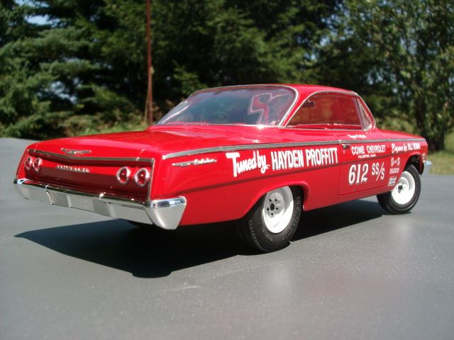

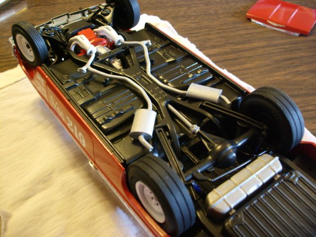

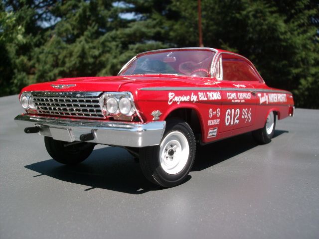

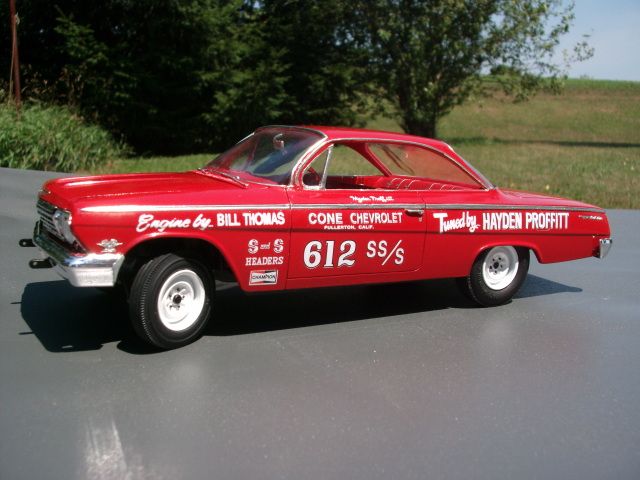

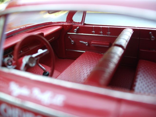

Finished this one up this past summer. I added some 7" M&H cheater slicks from Speed City Resin, and fabbed up a somewhat accurate exhaust. Other than that, it's oob. Exterior is Dupli-Color Cardinal Red and the interior is, also Dupli-Color, Bright Red. Looking back on it now, I wish I would have picked up a set of Slixx decals for it, but oh well.
MCW has the correct decals for this kit. AMT kit did the decals in all white Nick and it had white with yellow lettering done on the cars.
That's beautiful , Bogger44 !

Lots of history represented here ! Excellent job , Bogger !
You did a very beautiful job of what was given to you in a kit that was made for more for the Dyno Don car release then Hayden's car. If you are ever wanting to do another one but more correct on some stuff let me know and I will personaly help you as I have a lot of stuff for this car from Hayden and Brad Proffitt on the detail stuff that not a lot of people knew about.

You're right Chas, it was MCW that had the correct decals. Slixx are all white as well.

GTX, The changes to the car is the decal sheet from MCW, Also from them get the early 1960s cheater slick. When you do the rims and tires you will have to sand the edge of the inner part of the tire just a little. When putting them in just lay them in and make sure the back does not push in to the point of touching the rim it self. The rim will be to replicate the true 11" rim and how the tire stay'ed flush from tread down to the rim. (Hayden cut the rim and widen the stock rim by 2inch) Also for the headers, The kit comes with Jardane headers (Dyno Don's sponser) Hayden ran Sanderson from Ronnie Sanderson headers and they was a fenderwall header. When doing the drivers side the first to pipes piston 1 and 3 go over the steering shaft and the back to go under and up between the steering and frame. Exhaust pipe is not connected to the headers as this was not needed to be in NHRA but the pipe with a muffler had to be in some what of a stock location and back to the front of the rear axle. He ran a straight pipe with a muffler at the end of it for looks. Also for the interior the dash was reworked and only had three gagues in it plus the tach move from the steering colum to the upper dash so he could see it. ( For extra little details you can also add the cloth pins to the fuel line just before the carbs)
Can't go wrong with Bubbletop Chevy Super Stocker, or 409. :wub: That looks fantastic to me, paint and detail is really nice. It looks very clean build overall, one of my favorites I've seen in a while. Really nice one.

Chas, thanks for sharing all of that info. I knew about the Sanderson fenderwell headers, but none of the other mods done to the car. Good stuff to know.
