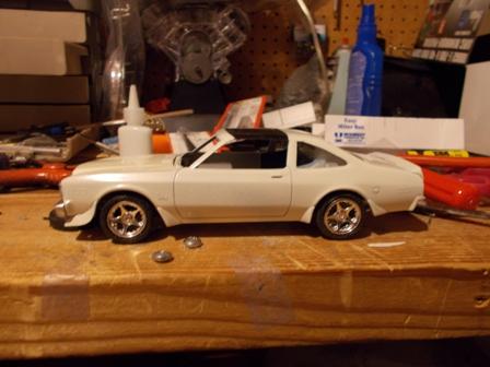

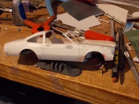

80mirada Posted December 29, 2012 Posted December 29, 2012 I have the remains of an original MPC Super Pak 77 Volare Roadrunner Kit. I am modifying a 71 duster street machine chassis and recreating the interior from modified duster parts, and some of the original parts. The plan is to have a fairly acurate front end under it, transverse torsion bars and all, when it is done. The body looks far better in my blurry pictures than in real life, as this will be the 4th paint job, after it is stripped. The louvers and the original front spoiler are missing, but The T-tops are intact, as are the flares and the rear spoiler.

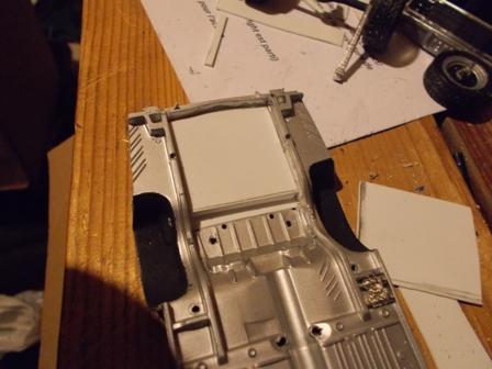

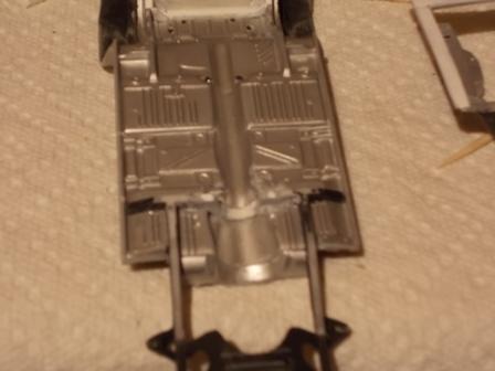

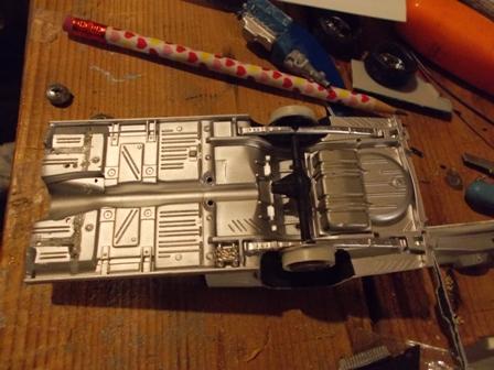

80mirada Posted December 30, 2012 Author Posted December 30, 2012 Some work going into the duster parts. and after a little work Fuel tank from the original chassis being fitted.

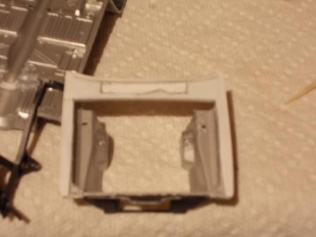

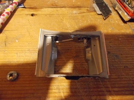

80mirada Posted December 30, 2012 Author Posted December 30, 2012 Adding material to raise the front to sit on the chassis right, and add a cowling. cowl vent is cut Engine bay installed, with the shock mount removed.

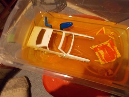

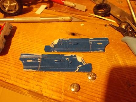

80mirada Posted December 30, 2012 Author Posted December 30, 2012 Some more work on the chassis. Started the door panels Body went in the bath (brake fluid)

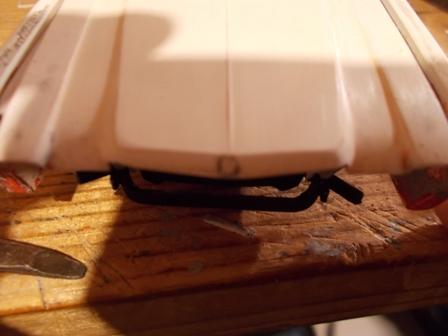

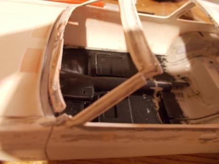

80mirada Posted December 30, 2012 Author Posted December 30, 2012 Some serious body isues. Body is broken at the A-pillar in two places Trunk lid charactor line is mostly missing, with some of the window trim. and a strange faint hood ornament.
80mirada Posted December 31, 2012 Author Posted December 31, 2012 The white paint hid a lot of trouble. Can't wait to get this in primer, but I am not going to rush it.

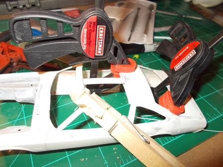

80mirada Posted January 2, 2013 Author Posted January 2, 2013 I glued some .030 Styrene square stock down the middle of the trunk lid, and into the broken out trim. Cleaning up the glue damage on the sides repaired the cowl at the A-pilllar and re glued the top

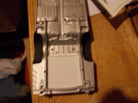

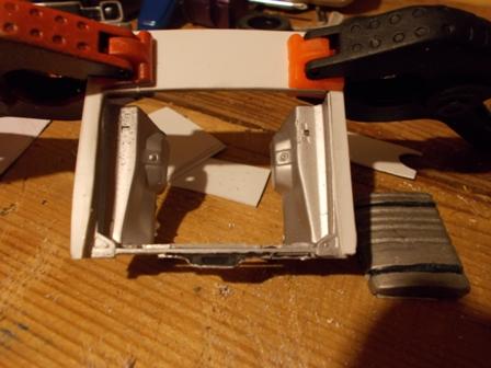

80mirada Posted January 2, 2013 Author Posted January 2, 2013 I added the lower section off of the Duster rear seat, and the made filler panels to hold the seat in place. The rear seat sits back further in the Volare, so I had to take the locator rib for the Duster seat off the floor. Fortunately I have a good source for reference photos on this one.
Casey Posted January 3, 2013 Posted January 3, 2013 That darn mid-'77 model year fuel tank change really messes with things in the trunk area, doesn't it?: I have a ton of reference pics from my F-body days if you need any.
80mirada Posted January 5, 2013 Author Posted January 5, 2013 SWEET! That early tank causes so many problems for guys. Is that your car Casey, if it is it is awful nice underneath. I still need to move the rear of the frame rails outboard, and move the tank over a bit more, after I get the body straightened out.

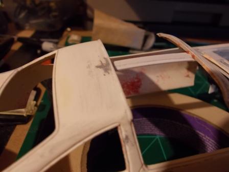

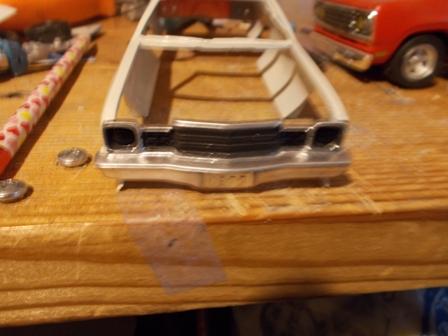

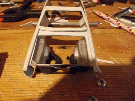

80mirada Posted January 11, 2013 Author Posted January 11, 2013 Time for some updates. First off, the Hood wasn't fitting well, so i have been building up its edges with .010" styrene sheet. The trunk Ridge is coming along New "T-bar", and trim for the roof. The plan is to have a small flange for the T-tops to sit on.
