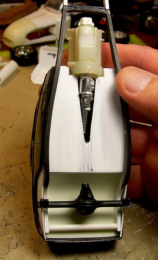

I'm extremely critical of stance and proportion on my own builds, literally to just a few one-thousandths of an inch, and I'll mock up the ride height with temporary fixtures made of styrene strip, like this...
...and then build fixtures to support the axles relative to the body, and build the suspension in place so it fits exactly, and maintains the exact ride heigtht that I started with, like this...
In this case, the fixture holding the rear axle is the new rear inner-fenders that will be trimmed to the final contours after the springs, shocks and driveshaft are fitted.
I'll sometimes mock-up plated parts, or painted valve covers with rubber cement. I also use the pinning technique extensively, but alignment of the holes is critical.

A very small amount of liquid glue applied with a Touch N Flow pipette applicator works best for me. After everything fits to my satisfaction, I just break the joints and do my paint prep.
Genius! I've seen this done on real 1:1 builds and never thought to use it on the models. This is gonna save me tons of aggravation of trying to get everything mocked and sitting the same height every time.
Just one thing, how do you go about building the rear suspension once the rear is in position? I had a lot of trouble with that building the Mercs air suspension.
