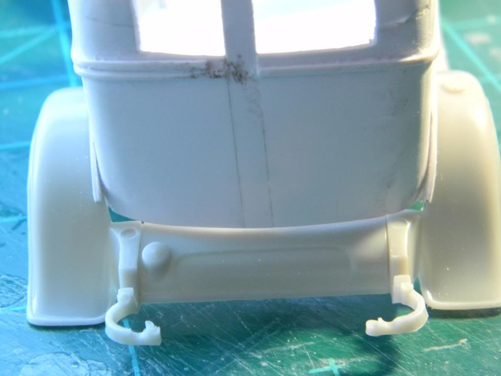

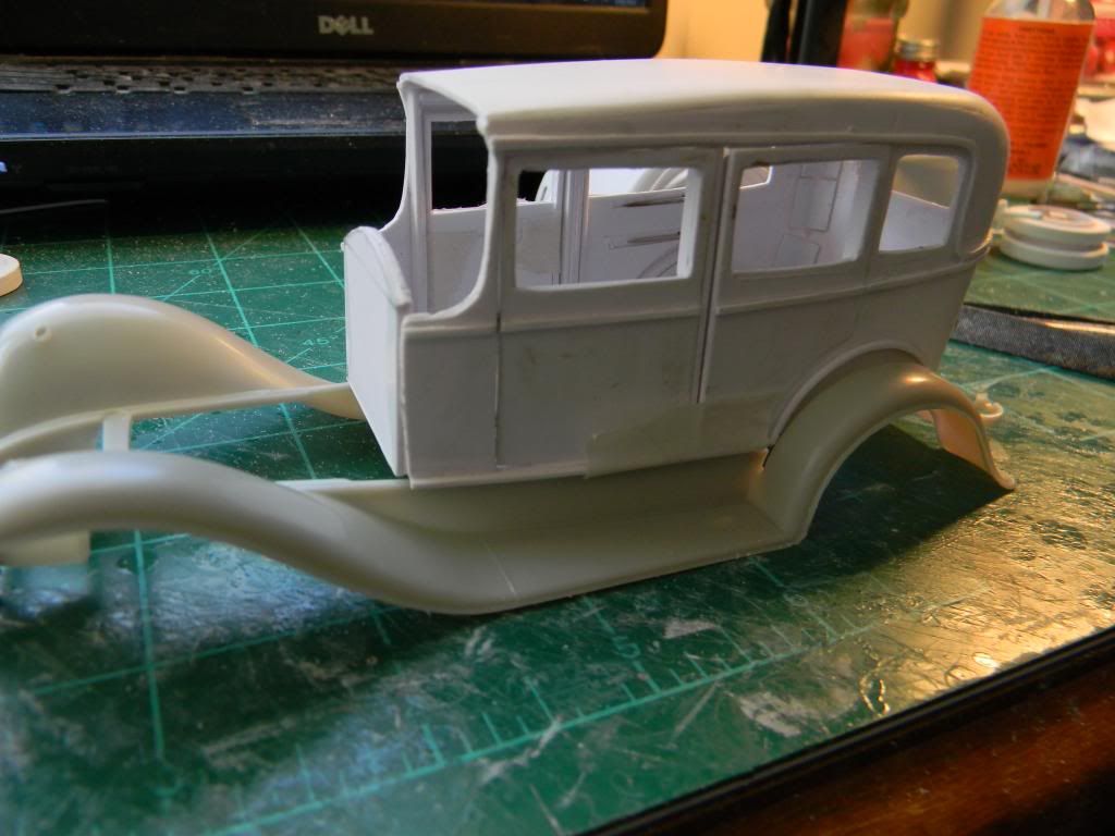

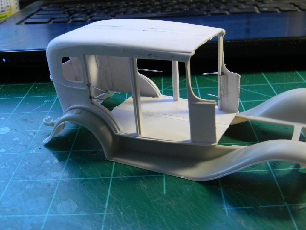

Got the 32's in the mail today for checking the 30 body,,,,,,,,,,,,,,,,,seems that the body is .40 thsds off on the rear cutouts,,,otherwise it is dead on.............. :) this is on the AMT fenders.
:P
The Revel does not fit as good,,,,,but close...I will make a few modifications to make it fit the AMT perfect.....about 20 minutes worth of work. Then I will finish the trim on the body and procced ahead on it. B)

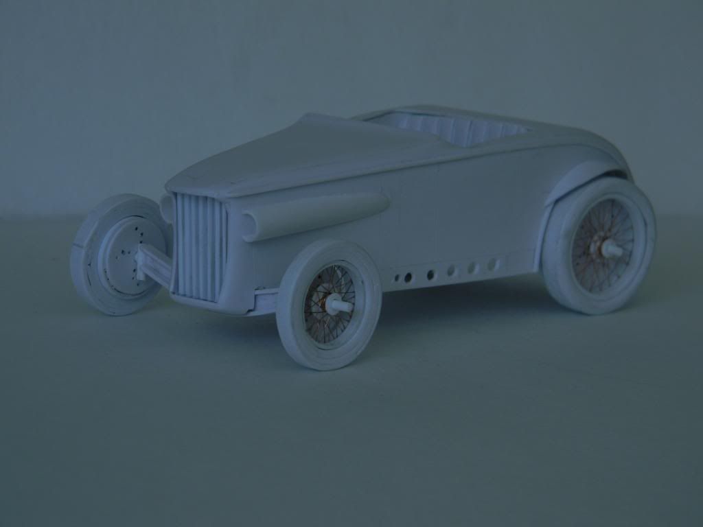

A little ditty I have been working on the last 2 days going to the paint shop and the electrical shop.............................under glass next week when the paint is dry. :rolleyes:
totally scratch,,,of course with no fillers............................. B)

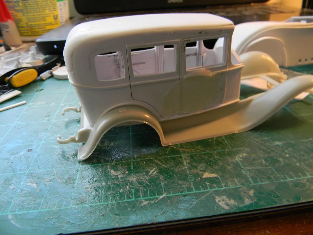

The ford got sliced in half and 3mm added down the middle to fit the AMT fenders.
A little more sanding and some filler will be neededd to make it perfect...but getting closer :rolleyes:

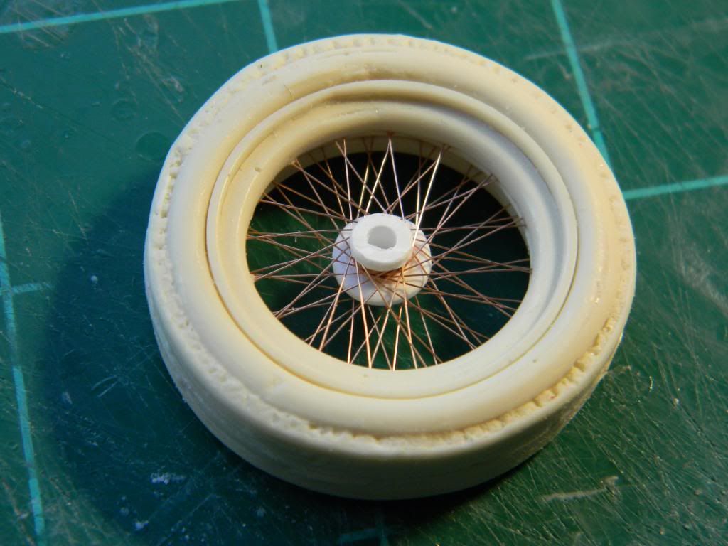

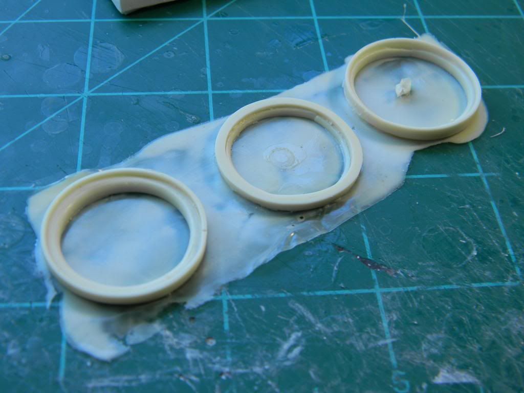

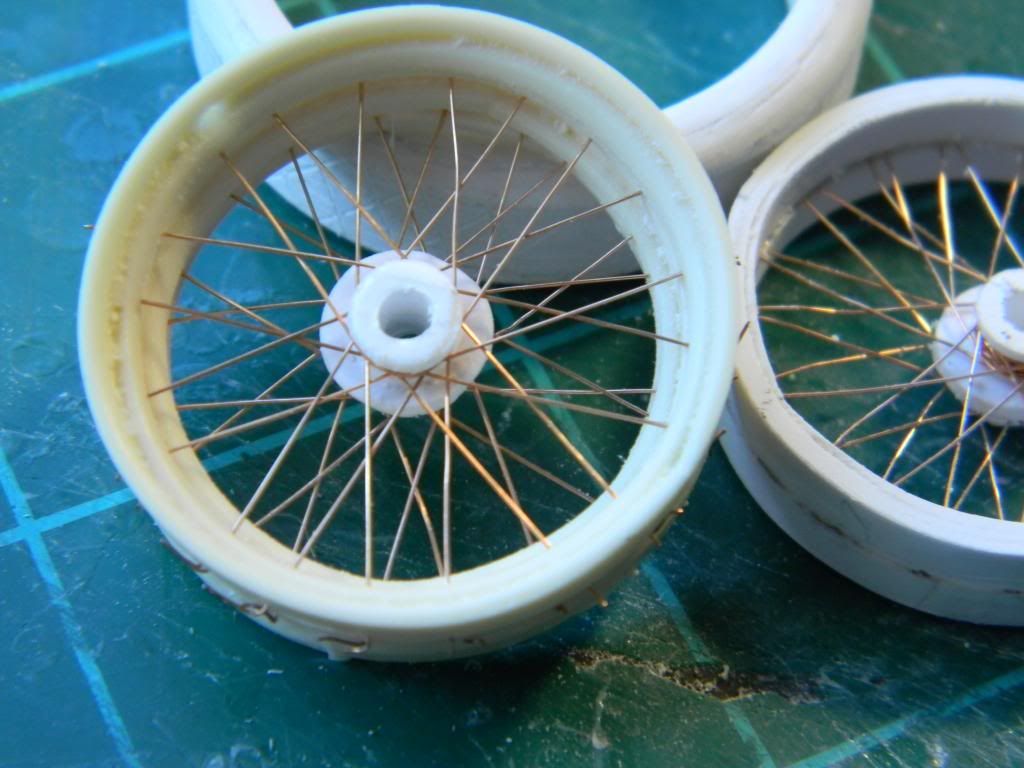

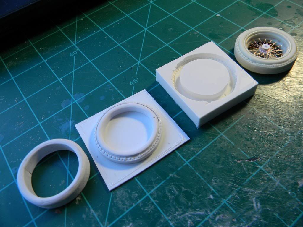

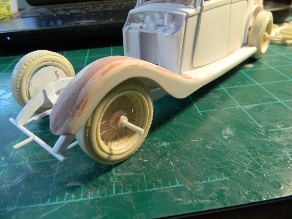

Going back to the Bentlel,,,,I have been toying with the cincept of making ribber tires and more accurate wires for it. In this vain I made up a new 3 piece rim assembly and am going to case the rims and hubs then make up a better wire....Also I will make up a nice tire and case that.....I am wondering it I couls use the RTV for them,,,,if anyone casts their own rubber tires I would appreciate any ideas on that. :huh:

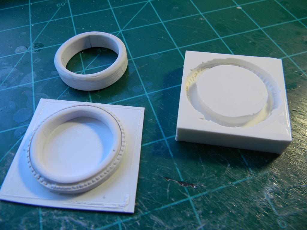

here is the frame for the mold and the RTV poured in place....I made a seperate mold for the hub since is is deeper than the rims...a conservation move so I dont use so much RTV material. ;)
I will now set that aside to set up and do a few pulls and make up a few trial wires with the new materials.......Then post them side by side so you can see where I am going with this process.
I decided to cast some parts since I have a few larger projects coming up and will need a few dozen wires and I can cast them instead of making them 1 by 1...................also If I cast the rims and tires they will be more consistent. :D

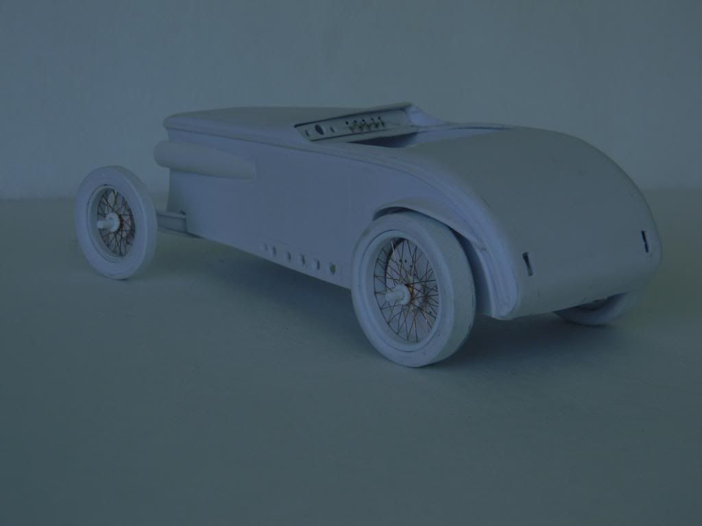

the layered look is actually closer to the real article. I have TR4 wire wheels in 48, 60 and 72 spoke configs, naturally the 72 spoke wheels were the strongest and most likely used for racing.
I haven't researched Bentley wires but I expect they're at least 60 spoke and have a very recognizable pattern that can be duplicated in scale.
It may require a new lacing jig or a new style of lacing.
Link to comment
64 it is...............thank you,,,it was my choice too....... I might try on one car 72.......................... :P

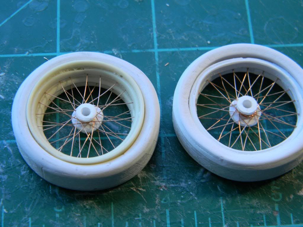

Tire test,,,,,,quick tire resin casting.......it is split in the center front and back casting glued together............not sure if I can get rubber or not......................I will make up a better tire for the final product.
:rolleyes:
Edited by kennb
Link to comment
For the 30's they had a little narrower look to them,,,,,I also have some comstraints that I have to take into consideration for the bentley.....I can have several types of tires for the wire rims too....I do apprecaite comments of all types because I know it is just to make a better model........................... :rolleyes:

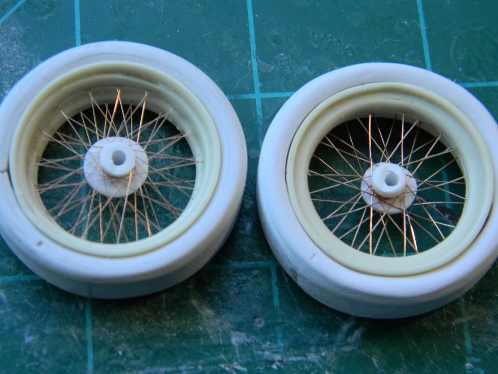

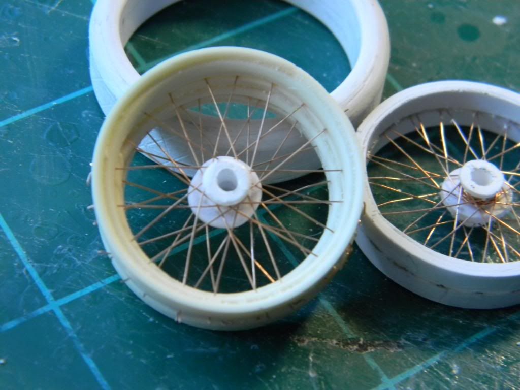

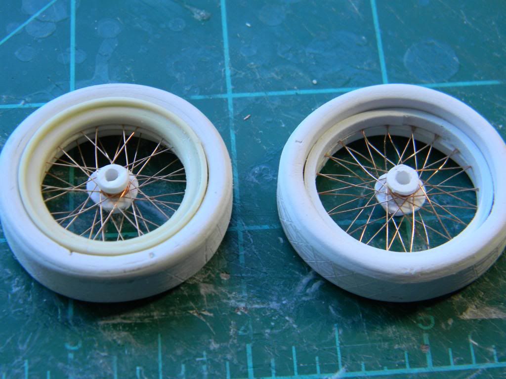

One to new tires....I think the picture will tell the story here.

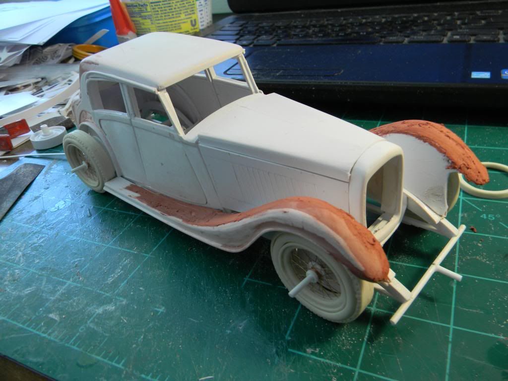

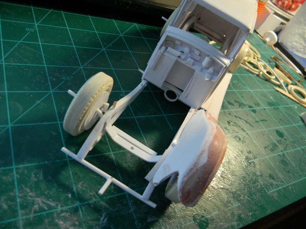

I had to rework the front fenders so they fit better and looked better,also got the running board fit to the body correctly now,,,,,,, :rolleyes: just a little transition to fit.
Thanks for the comments and suggestions,,,they are always welcome.. :P

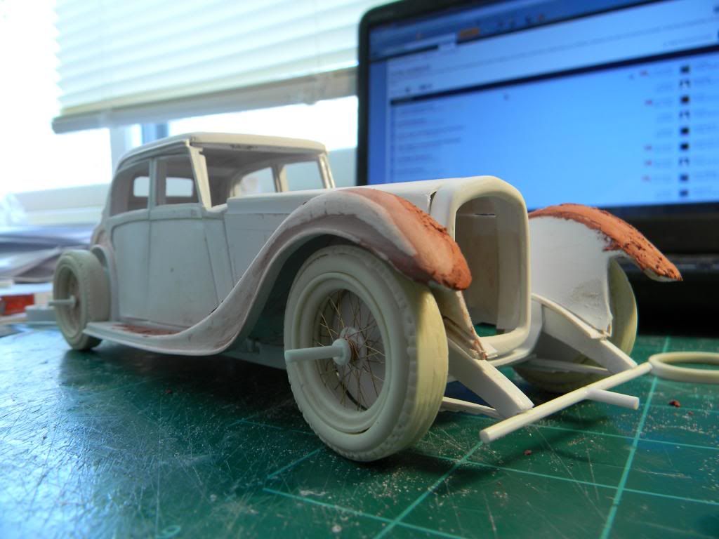

the front end is done except for some sanding and final adjustments to the hood.....Might get the bug sprayer out and blast on some primer on the fenders this week end yet. :P
I have some more work to do on the rear fenders to get them fitting right.........................
