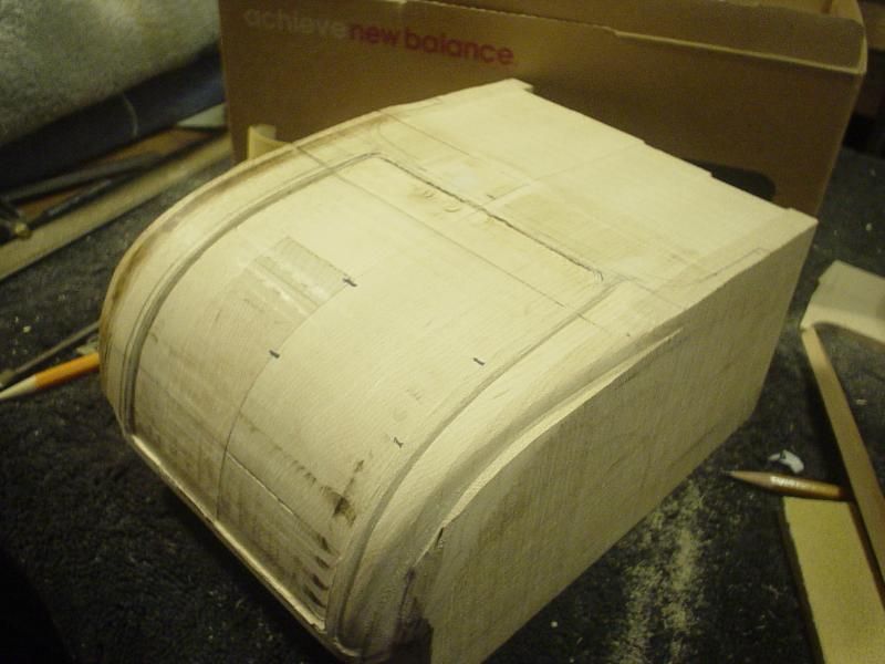

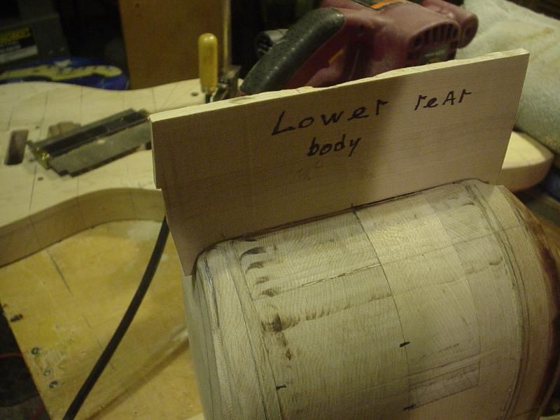

Ognib Posted February 13, 2015 Author Posted February 13, 2015 The shape is beginning to reveal itself...knew it was in there. Slow going here, working by hand with files & sanding sticks loaded with 80 grit.

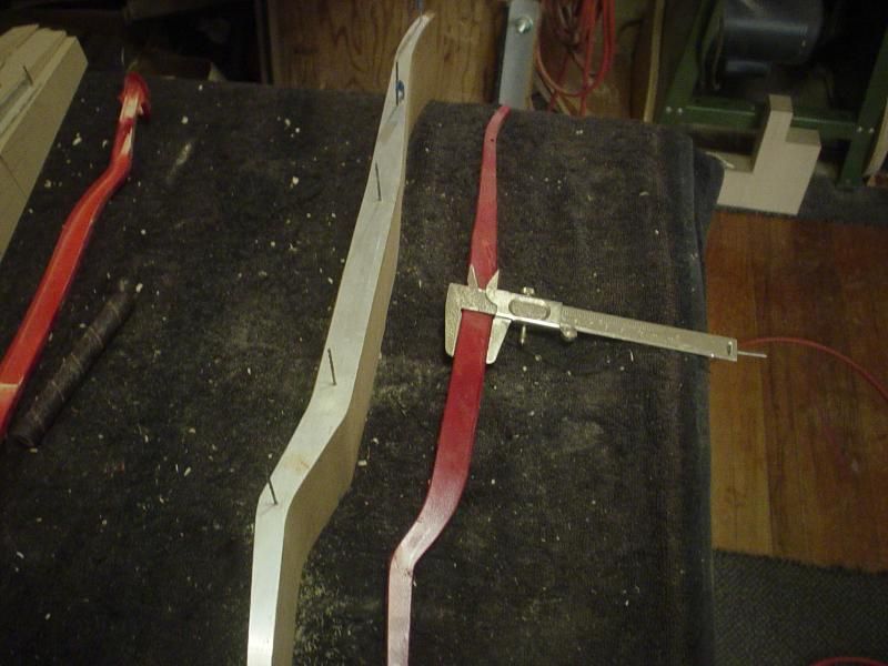

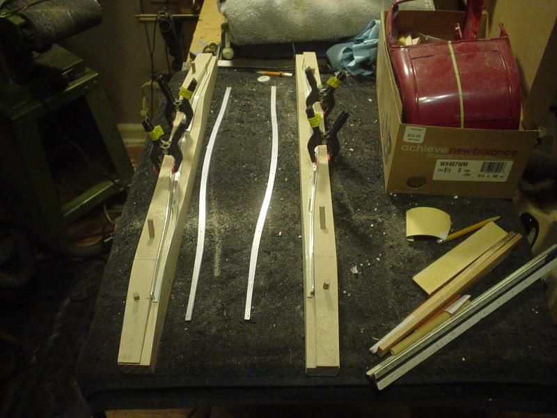

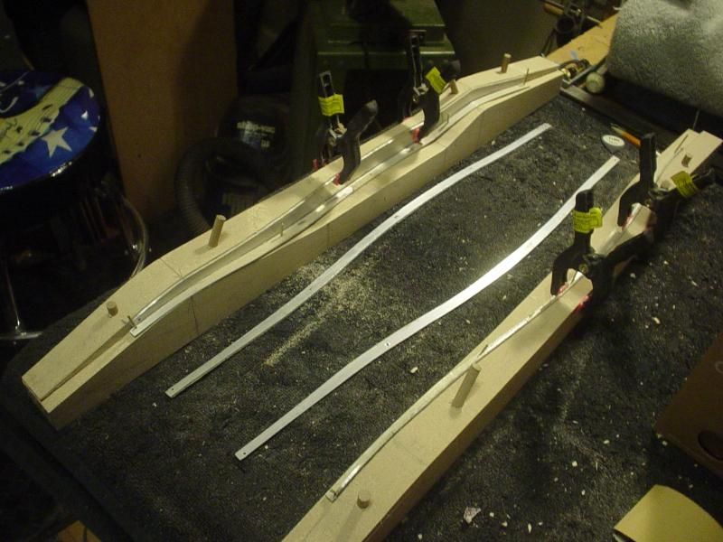

Ognib Posted February 14, 2015 Author Posted February 14, 2015 (edited) This project is a worthy challenge & that's what attracts me to it....to take on a difficult task & see if I can figure out how to do it well. As such, at times, it consumes my mind with thoughts of, "what's the best way to do this?". Found myself thinking about the frame this morning. Got my jigs & pieces down for the first time in over a year. The rails are long pieces & I'm thinking about what's the best way to join the sides with the tops & bottoms. I'm thinking about the heat required to join & wondering about controlling distortion & whether or not I'm going to ignite my forms in the process. It occurred to me that perhaps it would be easier to build a male forming die & bend/shape the rails over it with a hammer & caulking tools. It's the weekend & I'm off for a couple of days, so going to spend some time checking this idea out, since it's on my mind. I Need to have a frame on which to assemble the body pieces as they are completed. Edited February 14, 2015 by Ognib
Ognib Posted February 14, 2015 Author Posted February 14, 2015 Lovely dense, hard mahogany for the frame rail forming die. Excellent guitar neck wood & had been set back for that purpose, but this is important here, now today, so it's being used for this worthy project instead. It occurred to me that my aluminum side pieces are the same width as the overall width of the kit pieces & when I bend material down the sides of the die, I'd end up with an oversized frame rail, on the outside dimensions. My plan has been to do the frame with 1/16" thick material for strength, even though that scales up to 1/2". I'm willing to make that concession, because I don't know how much this thing is going to weigh when it's all said & done. I'm not, however, willing to have visual dimensions that far oversized, when viewing the car from the side. So I still have to shave it down 1/16 on each side.

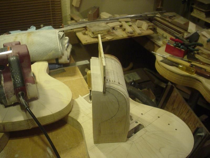

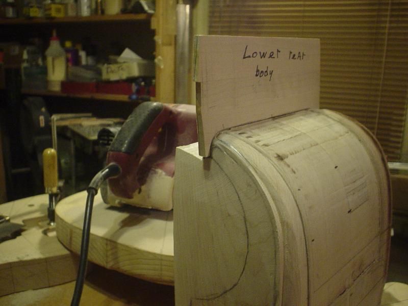

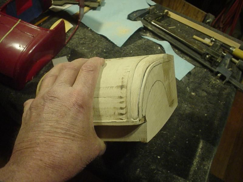

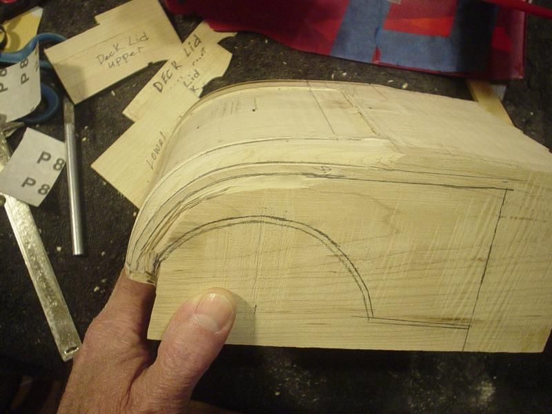

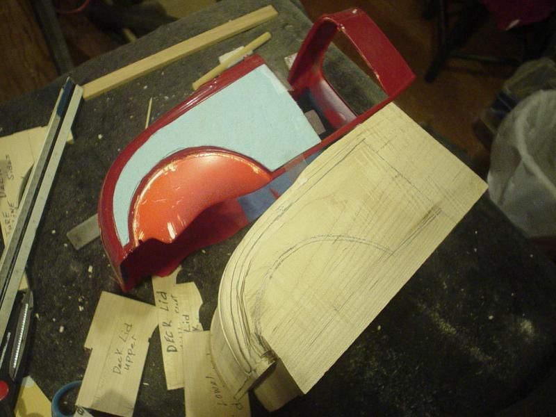

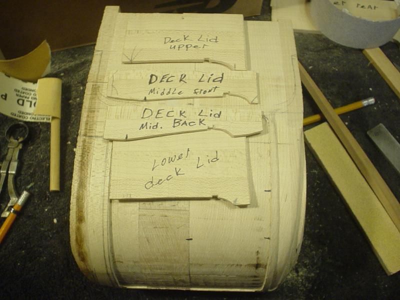

Ognib Posted February 16, 2015 Author Posted February 16, 2015 I have the frame die figured out. All that's left is some shaping. I'm hot to see some progress down on to the side of the body. To help my visualization process, I pulled a pattern of the kit body & drew it up on the buck. Still way too fat on the side, back half of the wheel opening.

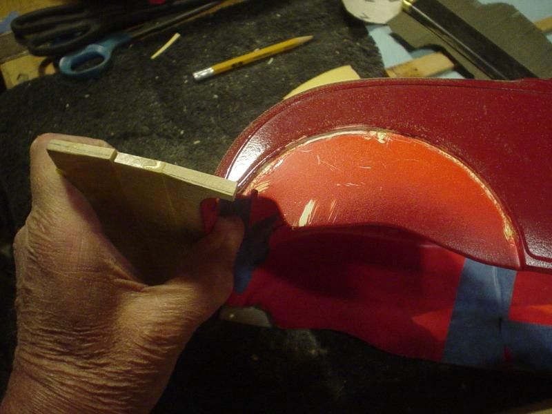

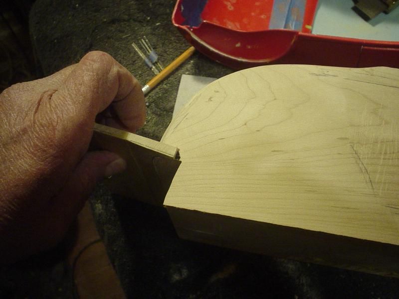

Ognib Posted February 17, 2015 Author Posted February 17, 2015 The tip of the lower body panel template locates the back point of the wheel arch feature line. Cut the excess material from the rear of the quarter panel. That's more like it. Re-drew the feature lines. Still quite a bit to do, but the basic shape is getting closer.

Ognib Posted February 19, 2015 Author Posted February 19, 2015 Thanks, Scott. Did some refinement around the corner. Still some waver in the lines in a couple of spots. All in all, happy with it at this point.

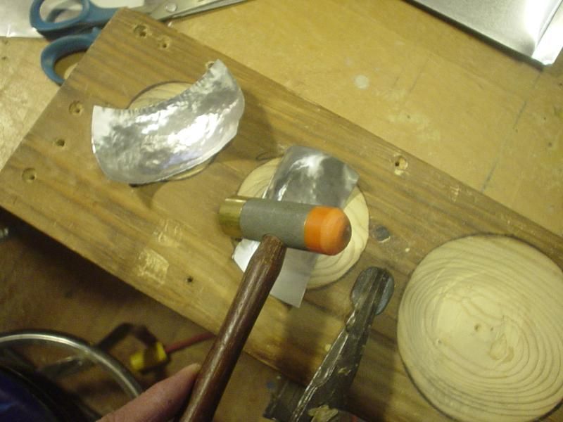

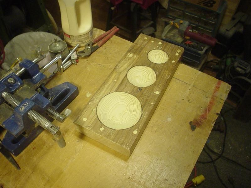

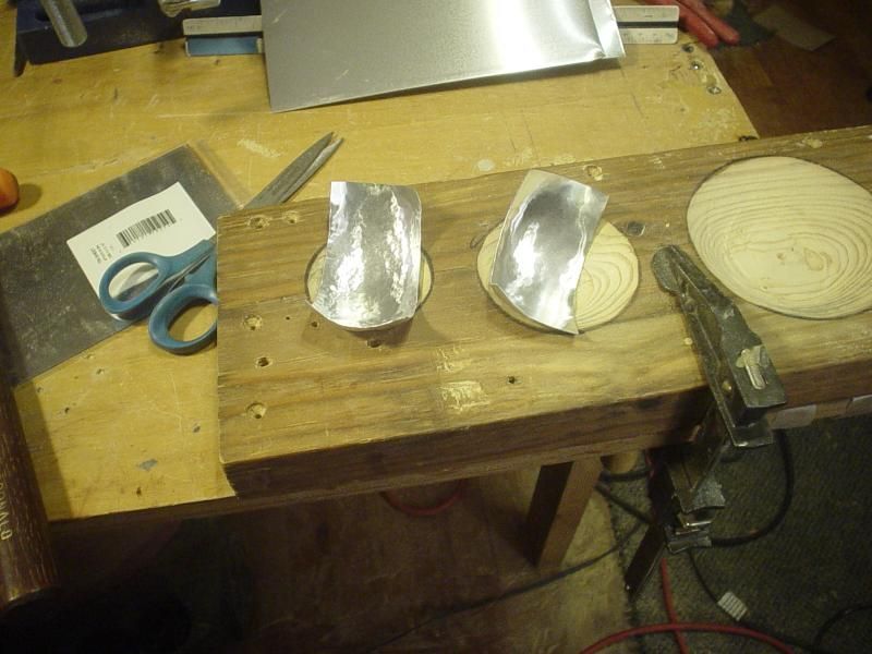

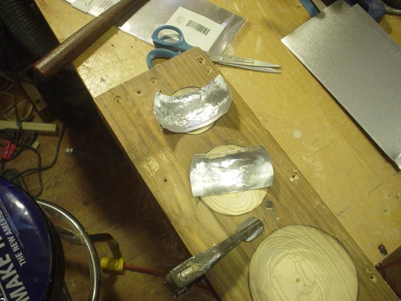

Ognib Posted February 22, 2015 Author Posted February 22, 2015 Want to start practicing hammer work on sheet material while the buck is still in development. So I hollowed out some bowls for shrinking. Heading to the ace hdwre store now to see if they have anything there that I can use. .

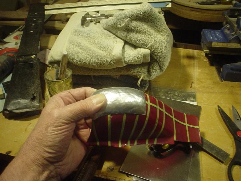

Ognib Posted February 22, 2015 Author Posted February 22, 2015 (edited) Got some .008", .016" & .032" aluminum. Domed the plastic face on a small hammer & just started emulating the techniques demonstrated in the vids I've been watching on stump shrinking. The .008 is too light....moved too easily & was not controllable. The .016 worked nicely, as did the .032 with heavier hammer blows & both pieces took a lot shape in a short amount of time. About 20 min to form both. Initial impression is that the .032 may be too thick for this project, as I'm going to have to be able to crisply define my raised feature lines in the panels, working directly on the buck with hammer & caulking tools. The .016 has surprisingly good strength in the piece I formed with it. This will be necessary so I can handle the model without damaging the body, later on. The .016 piece is the one with the most shape, laying in the smallest bowl. Time will work it all out. Edited February 22, 2015 by Ognib

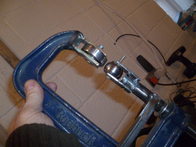

Ognib Posted February 22, 2015 Author Posted February 22, 2015 (edited) I gotta have something like this for planishing out hammer work. This thing is just way too cool! Flat roller bearing for the top wheel & the ball out of a small rod end on the other side. Edited February 22, 2015 by Ognib

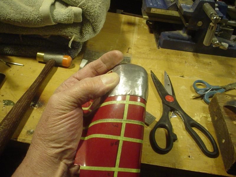

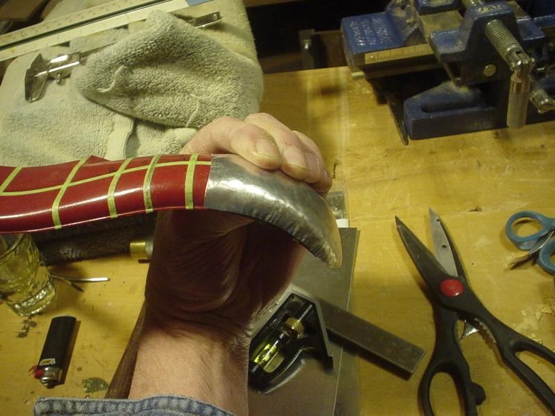

Ognib Posted February 23, 2015 Author Posted February 23, 2015 (edited) Spent some more time on the first piece of .016 from earlier. After the hardwood bucks are complete, I will be able to work a roughed in piece like this on to the buck for final accurate shape. Edited February 23, 2015 by Ognib
