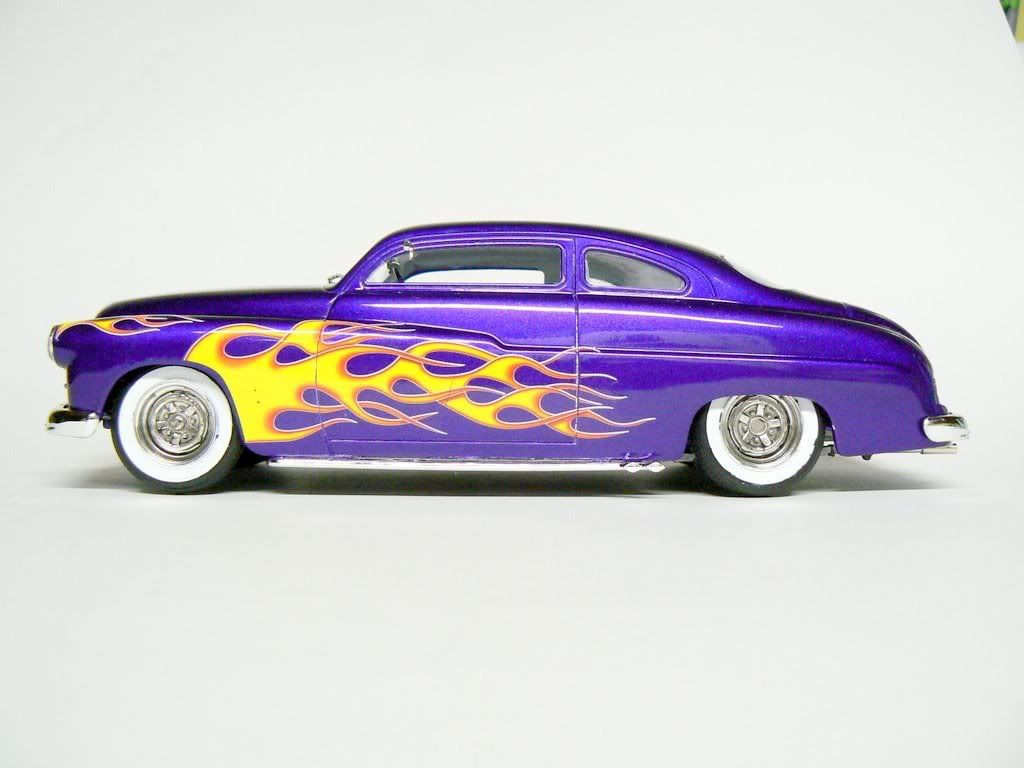

I still use Pactra (yes, you read that right!) flat white acrylic paint. I don't know how old that bottle is but it works every time! The first time I ever saw those new-fangled acrylic paints in the LHS I wondered if they would work on tires since I knew that enamels didn't. I bought some and haven't looked back. Here's some I did this past year with the same Pactra paint.

Dave, your black beetle, with a little work to the background would have made a great "is it real or model" subject. Very clean look there.
DO NOT DO NOT give harry any more help I would like to get 1 correct!!
(Yes it's sweet dave!!!)
