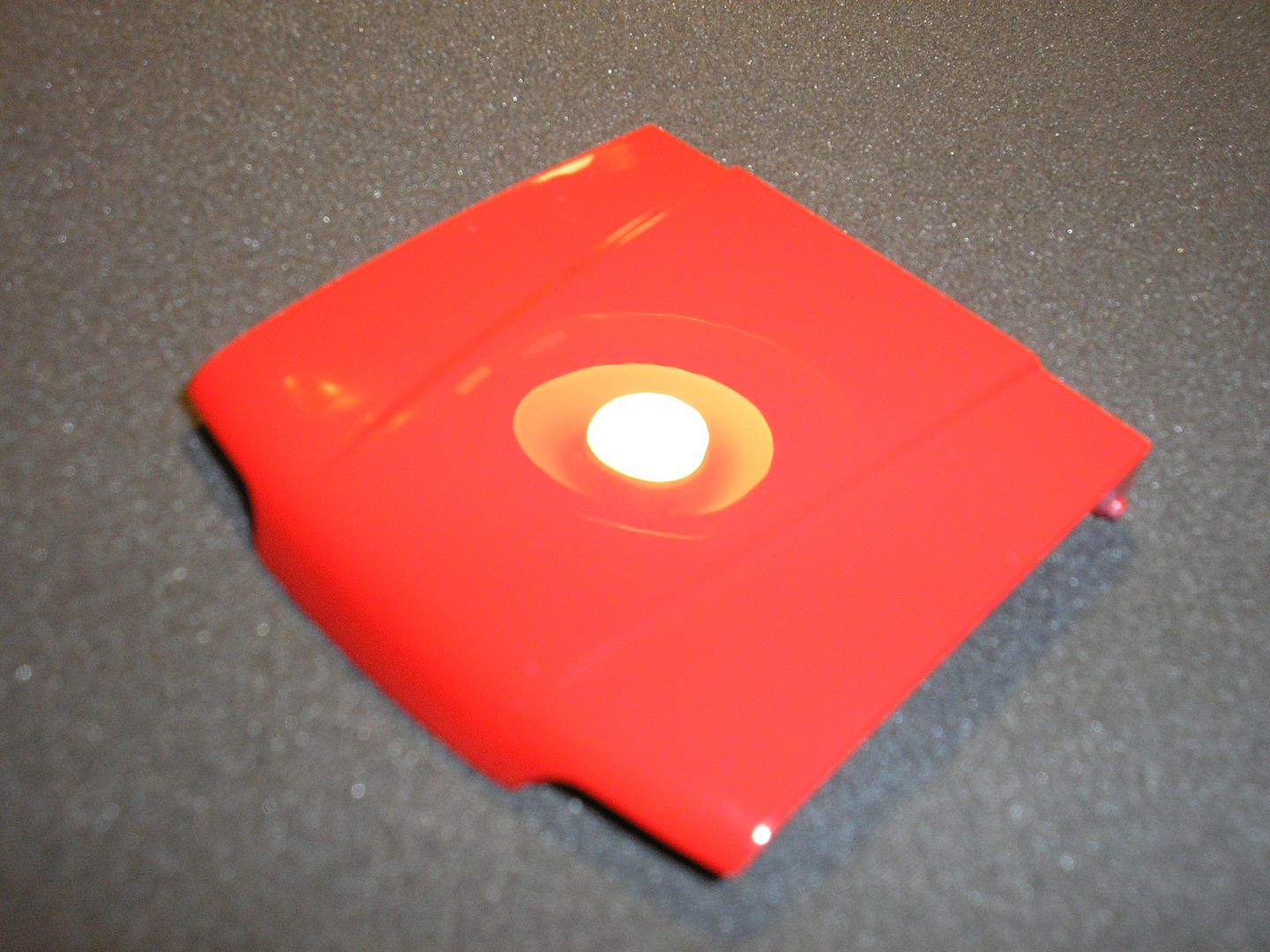

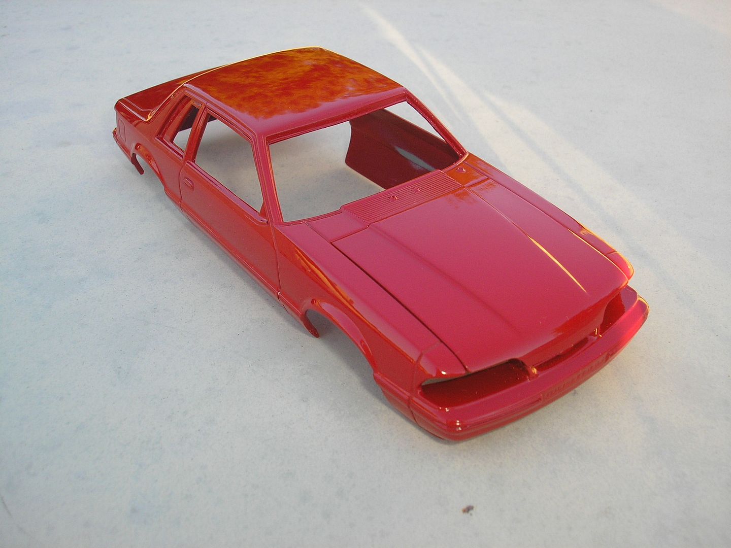

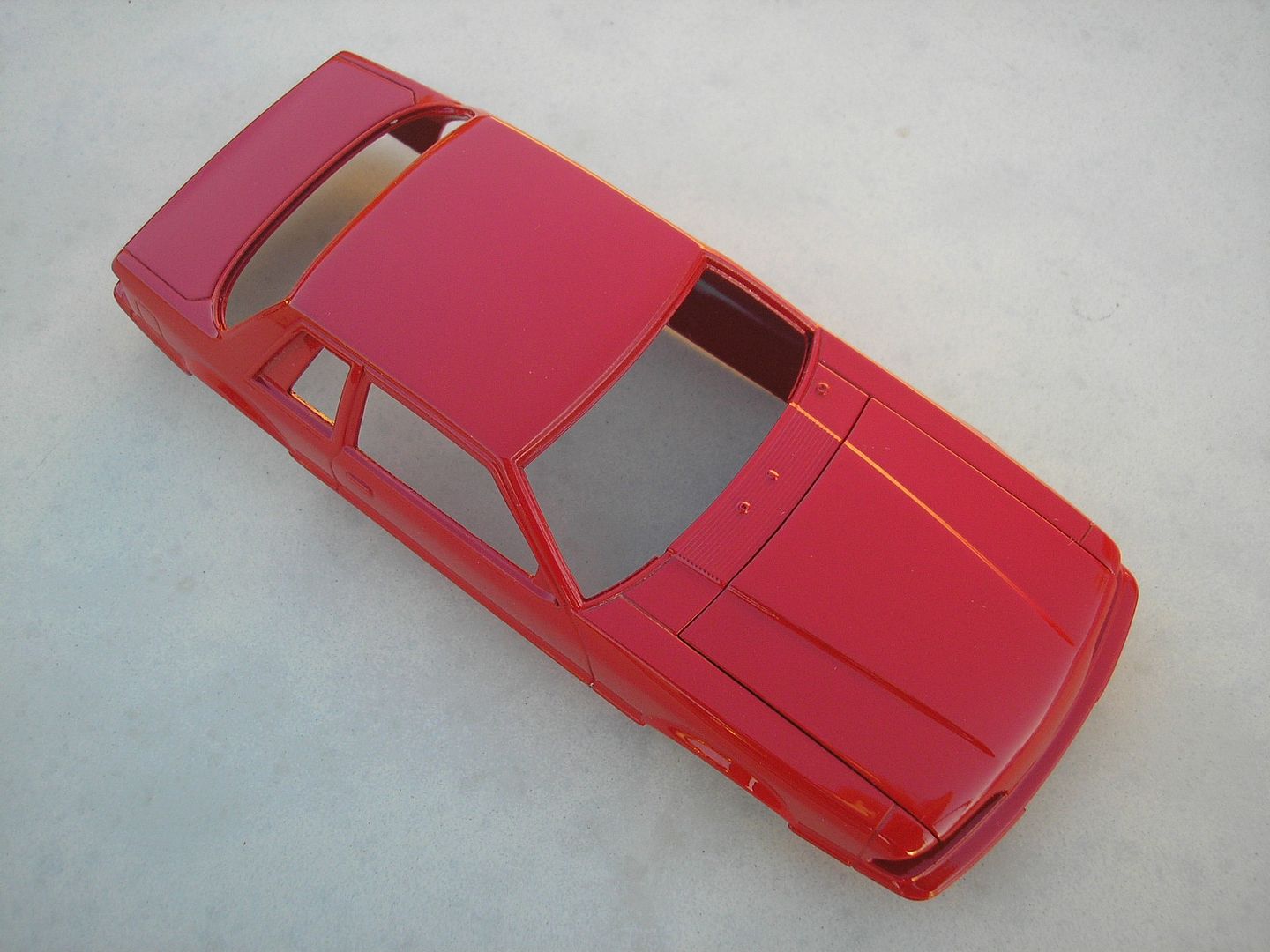

Maindrian Pace Posted December 5, 2013 Author Posted December 5, 2013 Body and hood painted, Plastikote gray primer, Duplicolor code EP red, MM clear. Sneak peak at the hood, cut and buffed: Wish me luck on the body. So. Many. Corners. -MJS

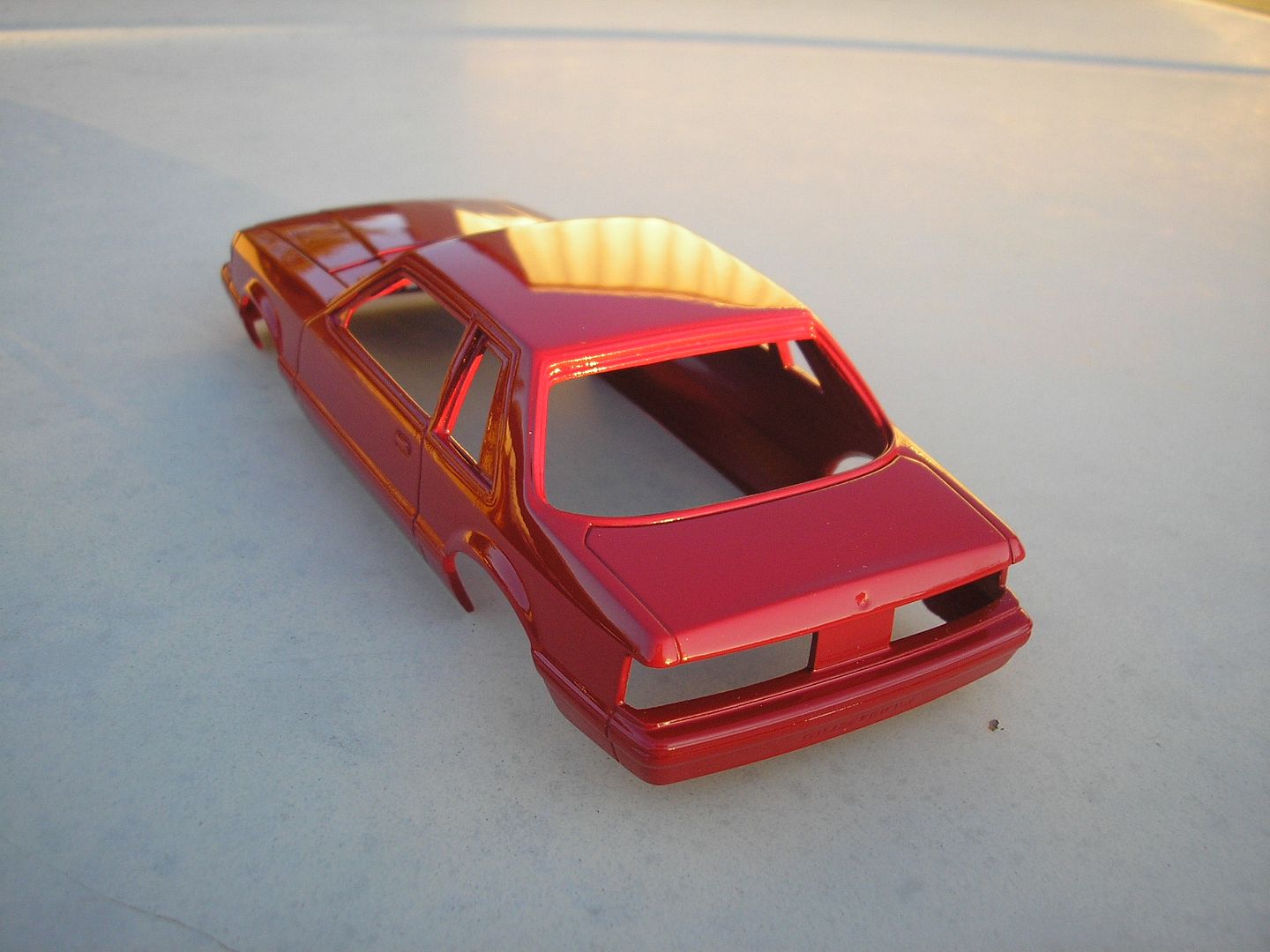

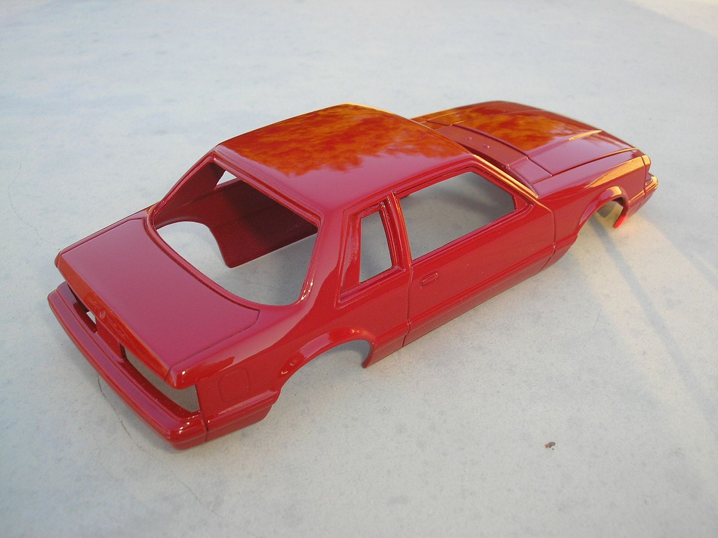

Maindrian Pace Posted December 7, 2013 Author Posted December 7, 2013 The whole body, cut and buffed. Incredibly, I didn't go through a single corner or edge - by being careful to not sand near any of them. That may be a first. -MJS

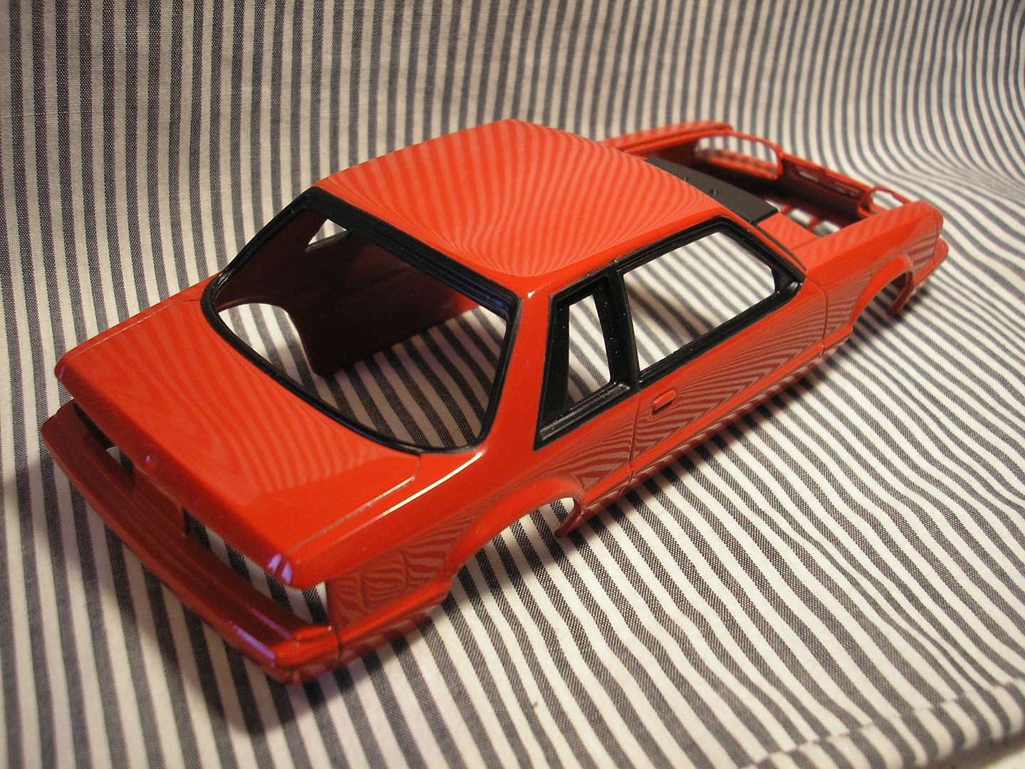

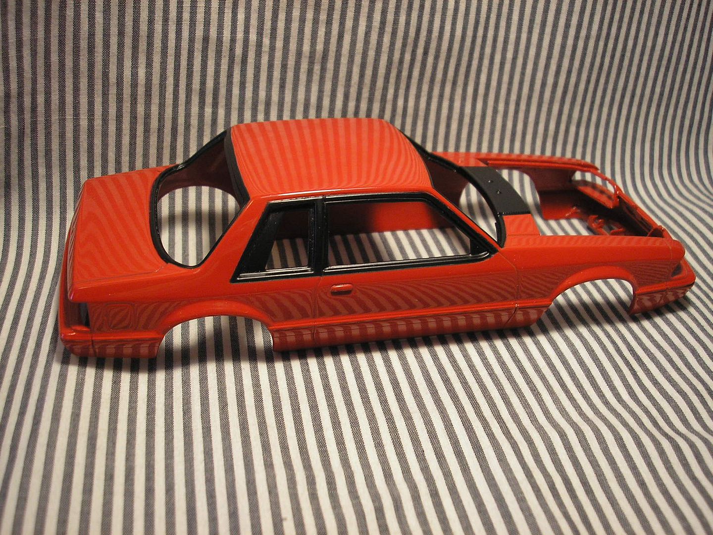

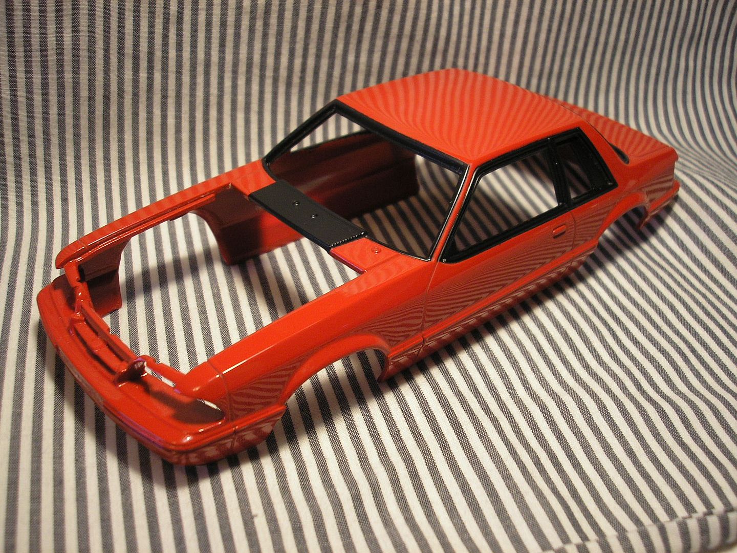

Maindrian Pace Posted December 10, 2013 Author Posted December 10, 2013 Black trim is done, taped off with Tamiya masking tape, sprayed with Tamiya semi-gloss black. Background is to trick the camera into focusing on the body, which mostly worked. -MJS
freakshow12 Posted December 10, 2013 Posted December 10, 2013 That looks awesome!! Door handles should be black as well. I can't wait to get a couple of these. I just can't bring myself to do anything with the box of kits I have until I get this body
mademan Posted December 10, 2013 Posted December 10, 2013 That looks awesome!! Door handles should be black as well. I can't wait to get a couple of these. I just can't bring myself to do anything with the box of kits I have until I get this body same, I started on one.... and put it away. My 3 should be here next week.
Maindrian Pace Posted December 10, 2013 Author Posted December 10, 2013 That looks awesome!! Door handles should be black as well. I can't wait to get a couple of these. I just can't bring myself to do anything with the box of kits I have until I get this body Thanks Fred. The door handles will be painted as part of the final assembly. -Mike

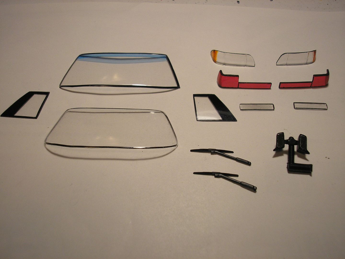

Maindrian Pace Posted December 12, 2013 Author Posted December 12, 2013 A few detailed items waiting for the glue: -MJS

Austin T Posted December 13, 2013 Posted December 13, 2013 Very nice so far. What did you do for the blue band a long the top of the windshield. ( Can't place the name right now)
Maindrian Pace Posted December 13, 2013 Author Posted December 13, 2013 I masked it with automotive tape stripe and sprayed it with Testors clear blue. -MJS
