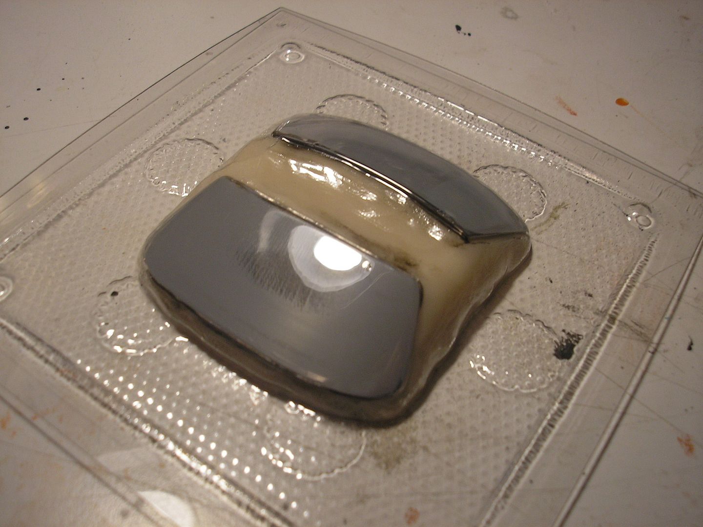

Maindrian Pace Posted September 16, 2013 Author Posted September 16, 2013 (edited) Yes,but it should be able to provide a viable "buck" if nothing else. My buck fits perfect, the problem thus far is the material and process. But... Here is the latest version in .030" butyrate: Much nicer! Dare I say Modelhaus nice? Thicker than what they use, harder to de-buck than the thinner stuff. I'll have to modify the buck so there are no undercuts. Getting there... -MJS Edited November 3, 2013 by Maindrian Pace

1930fordpickup Posted September 16, 2013 Posted September 16, 2013 Mike if you lay the windows down flatter they will form easier . Unless you intend the back and side windows stay in one piece. You will get less webbing forming on the sides while the plastic folds while it is sucked down over your buck. This will give you less height to over come with the forming.

Maindrian Pace Posted September 17, 2013 Author Posted September 17, 2013 I have no intention of criticizing anyone, but I have been following the evolution of opinions on this kit, roof height, etc., and I am having a hard time trying to understand why any of this is of particular importance. This 1:1 Mustang almost destroyed the Mustang brand for many reasons including weak, lousy styling, and I just don't get it. That's why they make chocolate and vanilla. Mike if you lay the windows down flatter they will form easier . Unless you intend the back and side windows stay in one piece. You will get less webbing forming on the sides while the plastic folds while it is sucked down over your buck. This will give you less height to over come with the forming. Andy, that's the direction that I'm going in right now. I'm getting tired of wasting butyrate, so I am redoing the buck with less slope, and I'll include a sheet of material to make the 1/4 windows rather than forming them - because the material curves nicely so there is no reason to do that. Also, I was using resin copies of the masters, and I glued them to the sculpy with JB Quick. As it turns out, the heat and suction warped the resin where it wasn't reinforced, so now I'm back to using the kit plastic masters on the new form; this time with lots of reinforcement so they won't buckle. I will then pull a clean mold, fill that with epoxy or resin to make it a solid block, pop it out, and use that for the buck. -Mike

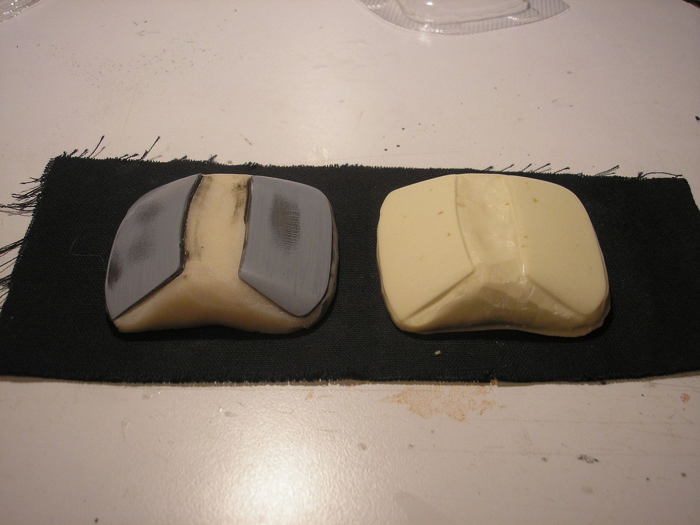

1930fordpickup Posted September 17, 2013 Posted September 17, 2013 That's why they make chocolate and vanilla. Andy, that's the direction that I'm going in right now. I'm getting tired of wasting butyrate, so I am redoing the buck with less slope, and I'll include a sheet of material to make the 1/4 windows rather than forming them - because the material curves nicely so there is no reason to do that. Also, I was using resin copies of the masters, and I glued them to the sculpy with JB Quick. As it turns out, the heat and suction warped the resin where it wasn't reinforced, so now I'm back to using the kit plastic masters on the new form; this time with lots of reinforcement so they won't buckle. I will then pull a clean mold, fill that with epoxy or resin to make it a solid block, pop it out, and use that for the buck. -Mike Mike, at work we used two part epoxy to cast our vaccuform molds. Granted these were all for shipping trays for GM truck fuel pumps . Same process but they were 4 foot square molds. The epoxy is what we had to use for it to hold up to the abuse. We never ran the mold, just made them for a customer.

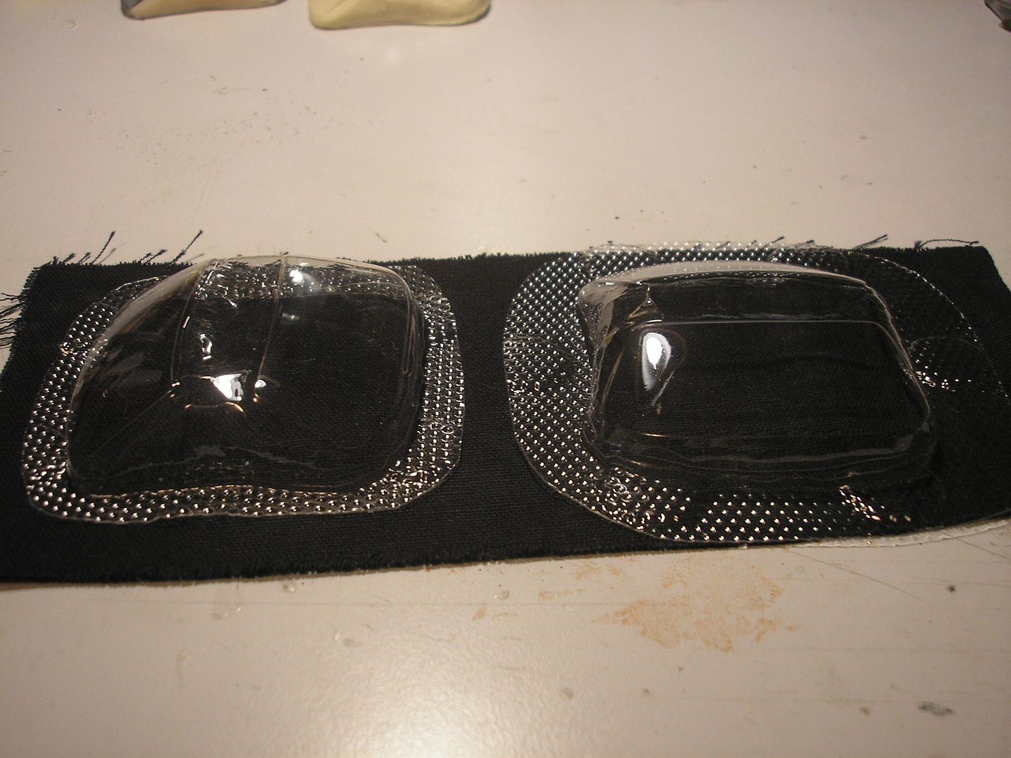

Maindrian Pace Posted September 20, 2013 Author Posted September 20, 2013 (edited) I've finally got the glass worked out. The sculpy mold was not strong enough to live through more than a few pulls, the resin glass masters were warping under the heat and suction, and the primer surfacer on the glass masters was out-gassing onto the plastic - partially clouding it. The solution was to make a new lower profile sculpy master, reinforce the kit glass masters by JB-Welding the resin copies behind them, pulling a good thick .030 sheet down over them, and having Greg fill that new mold with resin. The resin was then popped out, the new rock-hard master was blocked and polished, and sheets of .015" PETG plastic sheet were tried. Result: Perfect. It's hard to photograph clear parts, but they are very nice. So now that I have this figured out, it's time to find a supplier of .015" PET plastic sheet to get it more economically than going through K&S. Then, the body kits will be ready to go. -MJS Edited November 3, 2013 by Maindrian Pace
