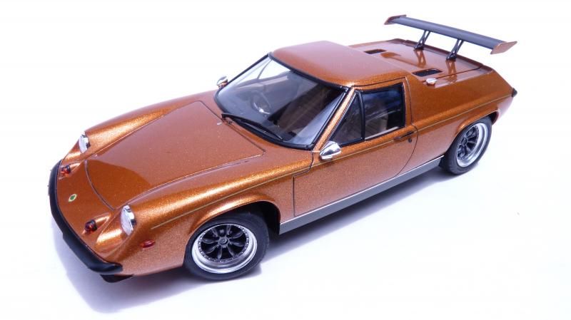

Modelbuilder Mark Posted August 19, 2013 Posted August 19, 2013 Mitch, that roof above is after a single coat of clear automotive lacquer, then polished out and buffed. Mark: to me, this top looks beautiful with none of the slight orange peel I've got on my 1st attempt with the product (I have to start researching that subject next; I'm returning to modeling after 45 years off) and it's plenty shiny. So what I'm hearing from you is that despite the name, multi-coats are mandatory as Cruz advises, but must there be a 2-3 week wait to polish it out and if so, what polishing system did you use? Did you ever apply their "one coat" clear glosscoat as well? I'm preparing to spend $30 on an aerosol propelled kit which will allow me to get to acrylic paints which I understand are more forgiving and it also contains what appears to be a variety of spray nozels for different situations or perhaps paints. I would prefer cans I suppose as they are a one piece apparatus, but I'm tired of stripping bodies (2 so far from the same kit). I realize there is a learning curve for me, but I really enjoy the build process with the innovative techniques I'm learning here (cutting a syringe for creating spark plugs, using parts from donor kits, etc) more than struggling with paints. Thanks for any info.
Eshaver Posted August 19, 2013 Posted August 19, 2013 Generally, since I do exhibit work, I use the High Build Duplicolor Grey Primer. As to testor's One Coat colors , I have no problems with them what so ever . Just watch out using it over most Model master paints . I have had some problems in the "Wet Look " Clear . If you shoot it LIGHT for a couple of coats , no problems .
Skydime Posted August 22, 2013 Posted August 22, 2013 (edited) I love all the One Coat paints except Fiery Orange, just because I can never get it to come out right. When used in conjunction with wet look clear, I think they look amazing even without polishing. Are the metal flakes large? Of coarse they are. But honestly, the cans originally came out with flames on them. So, what else would you expect? I love how quickly they dry. And a person has to spray the heck out of it to get it to run. Ease of use and super shiny/flakey make things really encouraging for a novice coming into this hobby as well as someone who just has a hard time with sitting down and polishing out a car by hand. Edited August 22, 2013 by Skydime
jaymcminn Posted August 23, 2013 Posted August 23, 2013 Love 'em for those applications where you want something with a big flake. I use the One-Coat paints over either Duplicolor or Tamiya primers with no issues. Not for replica-stock applications, but the results can be excellent. One-Coat Fiery Orange over Tamiya white primer Root Beer Brown over Duplicolor Red Oxide Primer White Lightning and Inca Gold with airbrushed fades I also use the One-Coat clear exclusively over Testors and Tamiya lacquers. Never had a problem with compatibility.
Skydime Posted August 24, 2013 Posted August 24, 2013 (edited) Root Beer Brown over Duplicolor Red Oxide Primer Thanks for sharing that with the group. I have seen the Root Beer look like this before and the red oxide would explain the tone being more red than brown. I kind of thought that but, wasn't 100% sure. Edited August 24, 2013 by Skydime
