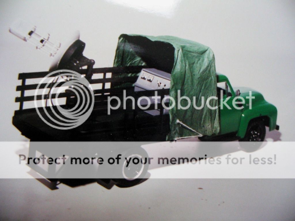

Ira Posted October 3, 2013 Author Posted October 3, 2013 Great work Ira! One of my favorite movies. But I have bad news. Here's come the truck to shoot down the saucers! And it's 1/25th scale!!!! Thanks John! Just saw the movie, Great job on the Truck...
