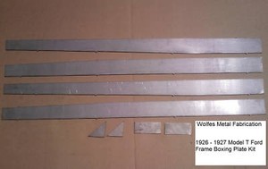

southpier Posted October 2, 2013 Posted October 2, 2013 where would the frame reinforcements begin? heavier rails & crossmembers? then what happens to the suspension? (teenager got cheerleader "in trouble", has to quit school, go to work, make payments, and can't afford another ride)
Art Anderson Posted October 2, 2013 Posted October 2, 2013 where would the frame reinforcements begin? heavier rails & crossmembers? then what happens to the suspension? (teenager got cheerleader "in trouble", has to quit school, go to work, make payments, and can't afford another ride) There really aren't any logical places in a Model T Ford frame to add reinforcements--but then given the light weight of a T (stock touring car from the factory weighed in at about 1900lbs) and small size (a Model T road on 100" wheelbase with a 4' 8" track--same basic length and width as a VW Beetle) the frame really didn't need much added stiffening. As for reinforcement in mid-chassis, Ford pretty much took care of that by bolting the engine directly to the frame rails at the flywheel housing, a setup that carried through the Model T years, Model A and the very earliest V8 cars having their engines mounted thus. The front of the Model T engine was solidily fixed into the front crossmember at the centerpoint of the crankshaft. Model A and Model B engines mounted in a very similar layout, but with a spring-cushioned motor mount at the front (but still a single point of contact with the front crossmember). Model T frames were actually designed to twist a good bit in service--given the rather horrible roads of the time, but frame twisting was both limited by the use of center-anchored transverse leaf springs and the short overall frame length between the rear, solid engine mountings and the rear crossmember. About the only thing early rodders did with a T frame was to weld the joints between rails and crossmembers (they were riveted together at these points by Ford factory practice). Art
Ace-Garageguy Posted October 2, 2013 Posted October 2, 2013 The Riley 2-port cylinder head came only in Revell's '31 Model A Station Wagon/Tudor Sedan kit. Their '29 Model A pickup kit had an aluminum high-compression flat cylinder head (which would be more in keeping with what a high school kid back then could have afforded to buy. Art This is interesting. The '31 sedan delivery kit also has the Riley, and ONE of the '29 pickup kits I have on the shelf has the Riley setup...though it's not shown on the instructions. I guess someone switched the chrome tree, 'cause the OTHER Revell '29 pickup I have on the shelf has a Winfield high-compression flathead, as Art correctly states.
Ace-Garageguy Posted October 2, 2013 Posted October 2, 2013 (edited) where would the frame reinforcements begin? heavier rails & crossmembers? then what happens to the suspension? "Boxing' is the hot-rodder's tried-and-true method of dealing with floppy channel-section (C-section) frames, which includes the T, the A and the '32, among many many others. The process is simple...a flat section ("boxing plate") is welded on the open side of the frame rail, making it essentially a rectangular tube, rather than a channel-section frame rail. This contributes mightily to rigidity. Folks who do nice clean work remove the crossmembers first, to make a nice clean full-length run on the inside of the rail. Then the crossmembers are modified to fit back in, or replaced entirely. Hackers tend to scab plates between the crossmembers without removing them, which is better than nothing, but still allows a lot of local flexing where the boxing-plates are interrupted. This is a typical C-section frame rail, with a section of boxing plate being welded in. (Photos used under "fair use" definition in copyright law) And this is a nekkid model A frame, clearly chowing the C-section side rails. Model T frame boxing-plate kit... Because the T kit frame has rectangular-section rails, they LOOK like boxed rails. The major work is already done. Edited October 2, 2013 by Ace-Garageguy

Art Anderson Posted October 29, 2013 Posted October 29, 2013 Vern Tardell, in his excellent book "Building a Traditional Ford V8 Hot Rod" points out that in actual practice, boxing the frame rails alone didn't work very well in the long run, due to the tendency of any Model T through 1932 Ford frame to twist (a problem common to just about any car frame prior to the introduction of a chassis X member in the middle, which Auburn Automobile Company pioneered with the 1929 Cord L-29 series. As for an engine for the T, a Chevy 6, while it could be hopped up, probably would have required some frame reinforcement of the T chassis--considering that any inline 6 of the 50's was considerably heavier (by 150lbs or so) than a comparable V8, certainly a lot heavier than a Ford flathead V8. This was due to any inline engine of more than 4 cylinders requiring not only a longer and heavier crankshaft, but the block had to be heavier as well, in order to counteract any tendency to flex or twist (yeah, cast iron can still flex and twist, however slightly, and in an engine block, that's detrimental to such as main bearings). Not only that, but consider the sheer length of the Chevy 6 vs a T four-banger, or even a flathead V8: To install a 6 in a T will require either moving the body back (not difficult to do on a T, recessing the rear of the inline 6 back into the front of the body (a T bucket ain't all that long front to rear--where to put your feet?) or lengthening the frame rails themselves (which will increase the twisting action of the frame itself). Art
Ace-Garageguy Posted October 29, 2013 Posted October 29, 2013 Vern Tardell, in his excellent book "Building a Traditional Ford V8 Hot Rod" points out that in actual practice, boxing the frame rails alone didn't work very well in the long run, due to the tendency of any Model T through 1932 Ford frame to twist (a problem common to just about any car frame prior to the introduction of a chassis X member in the middle, which Auburn Automobile Company pioneered with the 1929 Cord L-29 series. Art Yup, and that's why anyone knowledgeable, when swapping higher-output engines into early chassis (an A-V8 for instance) will use an X-member from some other donor chassis (if building a really traditional, period-style car). The '34 Ford X-member was one of the recommended pieces to do an A-V8, back in the day. Just about any engine swap will get beefed-up, re-worked crossmembers, if it's done by anyone with a functioning brain, for just the reason Art mentions...ladder frames TWIST, but boxing is way better than nothing.
