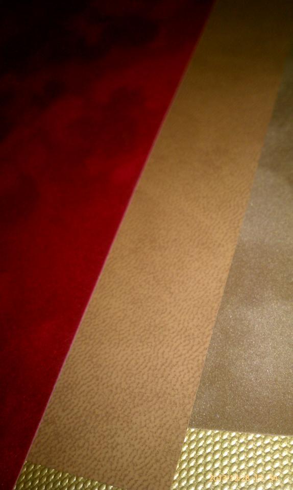

kratvmnd Posted October 28, 2013 Posted October 28, 2013 (edited) It should work fine with a little practice. Check the fancy paper displays also,as they often have a selection of velvety paper that works great(it's similar in texture to the red velvet Christmas bows,for example). I've used cheap wallet linings,fake leather handbags,etc.-those can always be found cheap at thrift stores. Most of these materials can be painted also,so look for a light color. Here's a couple examples... Edited October 28, 2013 by kratvmnd
