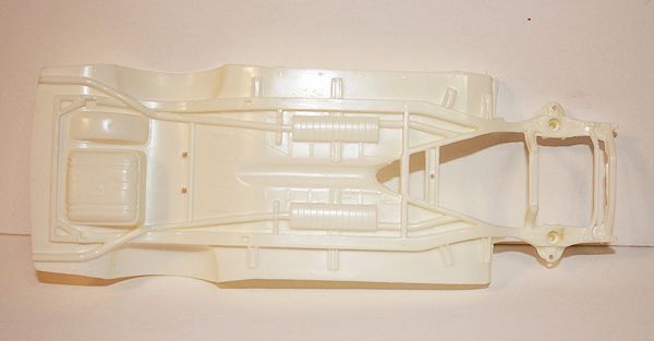

1956 Ford Victoria gasser, first pic is the kit box as always the second shows the chassis with the molded on exhaust system that must be removed. The last pic shows the interior bucket with seat mounting posts removed as well as the exhaust system. All comments welcome.
Hey Robert, I've had my eye on this kit for awhile. I love '56 Fords and I love gassers. What did you use to remove the exhaust? Dremel? What's your impression of the kit overall? And would love to see the body. Thanks.
Hi Gene, to removed the exhaust I used a combination of sprue cutters and a set of mini chisels.

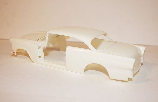

Time for an update, the first 2 pics show the body mods.
1. opened up the wheel wells for the slicks
2. removed the windshield wipers
3. filled in the hood hinge area
4. installed the splash pan, and added the point to the front fenders just below the splash pan
5. added the eyebrows for the head lights

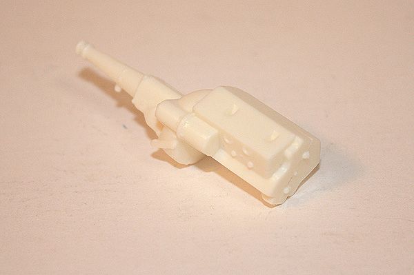

Last 2 pics show the basic engine and the molded on starter ( I hate those) I removed the starter and filled in the hole, added the intake, front cover and water pump. All comments welcome.

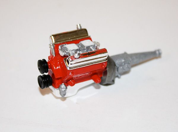

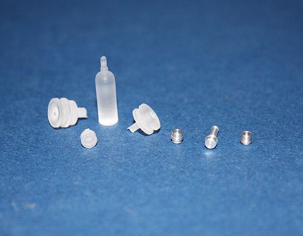

Update time, I got some work done on the engine.
To the left are the fan, generator, crank pulley and fire extinguisher all done in acrylic, to the right are the 2 valve cover breathers and the oil filler tube and cap done in Aluminum, all parts were turned on my lathe. I think these parts should add a little detail to the engine. All comments welcome
Update time, I did some basic work on the engine, installed some of the scratch built parts I made. All comments welcome.
Thanks Gene, no molds I turned all the clear parts from 1/4 inch acrylic rod.

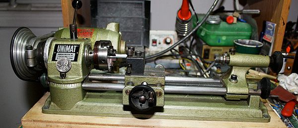

I use an old Unimat lathe from the 1960's works pretty good, I will post a pic of it so you can see it.
It's very small and lite, there is a quarter in the pic to give it some scale.
Robert, thanks for the pic/info on the lathe.

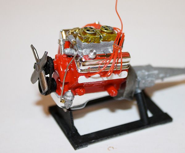

Time for an update, got some detail work done on the motor, plug wires, fuel lines, starter motor, fan belt and generator. I replaced the carbs with some from the parts box, the white plates on the heads are the header flanges. All comments welcome.
