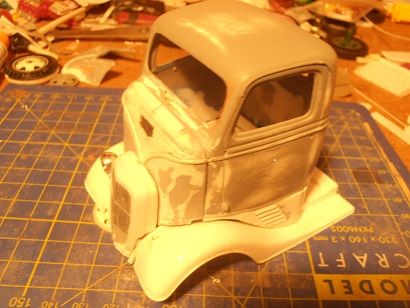

fractalign Posted November 18, 2015 Author Posted November 18, 2015 (edited) http:// Hey Guys ! It has been months since I have posted anything, but I have a major announcement. I can confirm the first official releases will be a range of mid thirties Ford and Dearborn based trucks. Dearborn specialised in converting conventional trucks into cab overs and did various between 1935 and 1937. The one on the left is the 37 version, the one on the right is the master I have been working on for almost 18 months of the 35/36 version. These were true cab over trucks unlike the factory Ford versions that followed. The Dearborn C.O.E actually had more in common with later cab overs in that they sat higher up over the engine allowing more cabin space with a flat floor. The reason I am focussing on these over the earlier AA and BB versions is simply because these are closer to completion. I am still working on the AA and BB kits but they will be released a little further on. Another important optional component I will be adding with these kits is a range of vintage trailers. These trailers will be designed to adapt to the trucks with their own turntable that can be added to the truck. I was not originally planning to release semi trailers but I figured it made perfect sense as sourcing correct vintage era trailers for these kits would be next to impossible. For the moment though I can say the first truck release will be based on the 131 inch wheelbase type chassis. This chassis will also be shortened to 112 inch wheelbase for the Dearborn C.O.E versions. I will still be doing the carry bodies as planned but the first releases will be the cab chassis trucks. Edited November 18, 2015 by fractalign

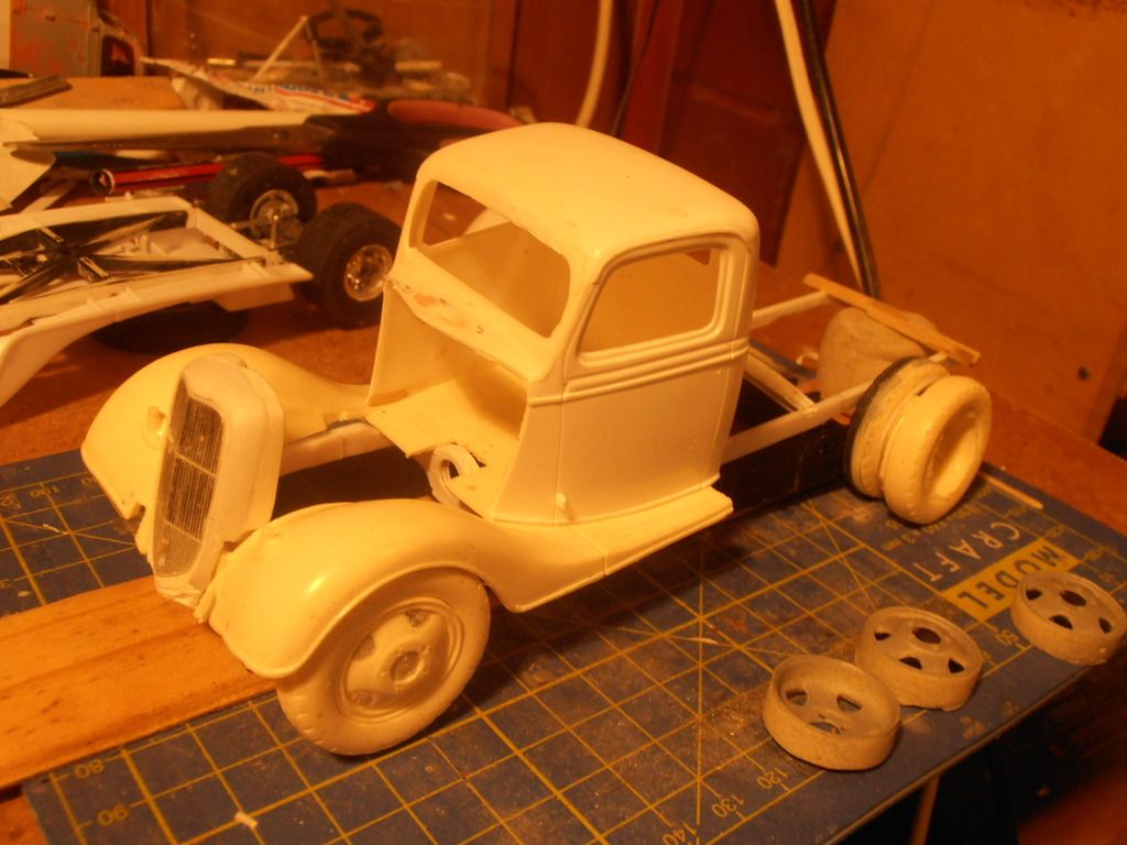

fractalign Posted November 18, 2015 Author Posted November 18, 2015 (edited) Here is the master for the conventional Ford truck. The chassis for this one and the Dearborn C.O.E above it will be based on the 131 inch version. The fenders, wheels and tyres in this image are the resin versions. I have cast up various wheels and I am undercoating the wheels for a build I am doing to test out the quality of the components. The first release will actually be the wheels themselves along with the brakes, differential and rear leaf springs. These were similar from the BB Ford right through to the 1937 Fords. The wheels them selves will feature separate lugs, hubs and caps. This is to allow the separate parts to be painted in the appropriate colours with out the need to mask parts. http:// Edited November 18, 2015 by fractalign

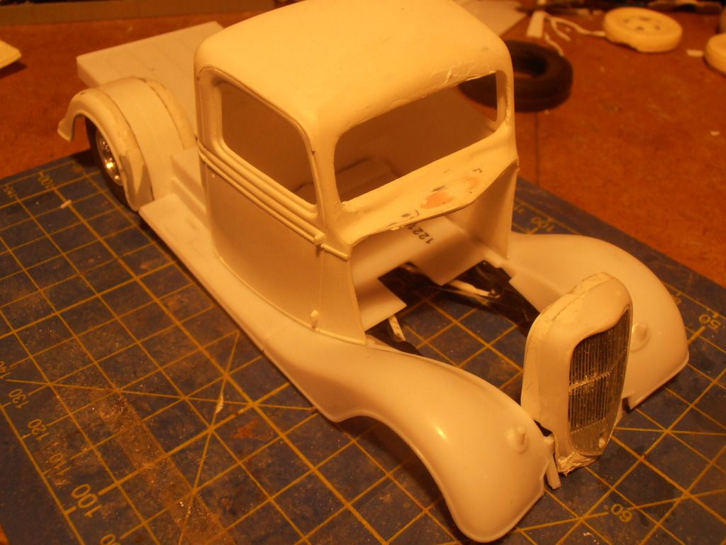

fractalign Posted November 18, 2015 Author Posted November 18, 2015 (edited) Another major change I have undertaken is to include pickups in the range. These will not overlap in anyway with the existing factory based versions from Revell Monogram. I was originally going to focus on medium to heavy trucks, but I realised I could do some pickup versions as well that corresponded with the oddball years that the majors had ignored in their light commercial range. Unlike the trucks, the pickups will be rod based versions, featuring their own updated chassis, suspension and interiors. The image above is of the 35/36 Ford Pickup. The 36 will feature the same cab and hood as the truck, but the 35 version will feature a smoothed hood and chopped cab. There will also be several 35-37 Dearborn C.O.E versions well including some car carrier versions. All the pickups will be pro street versions designed to adapt to the running gear from the Revell 41 Willys Street Rod kit. The Car carrier versions will use standard truck chassis with upgraded wheels and suspension options. Edited November 18, 2015 by fractalign

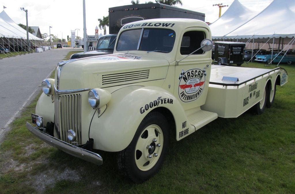

fractalign Posted December 4, 2015 Author Posted December 4, 2015 (edited) Hey Guys ! Thanks for all the encouragement, I thought I should update you on the progress of the trucks. I mentioned in the previous post that the first trucks to be released would be the 35-37 Fords and Dearborn C.O.E. That is still the plan but I decided to add something else into the mix. Originally The full size trucks were going to be cab chassis, with bodies to be created later on but I have been toying with a idea. The image below is of a 48 to 52 Chev C.O.E converted into a single car hauler. I know these types of trucks did not really start appearing until the late fifties, early sixties. I also know this type of rig was popular with racing enthusiasts. Sprint Cars, drag cars, stock cars in particular were often transported on the back of these. Last year I purchased a sheet of checker plate styrene to make the floor of a rollback that I want to create. I soon realised there was enough checker plate to do the roll back tray and to create one of these versions as well. This was a relatively easy build. Two days in and its three quarters finished already. My intention is to offer this option with the first Dearborn I release. I have also redesigned the chassis so that the wheel base is adjustable. The chassis will be extended to the standard 157 inch Wheel base. However the leaf springs will be able to moved back to allow a longer wheel base should the builder decide he or she wants to create a car hauler similar to the one below. http:// Edited December 4, 2015 by fractalign

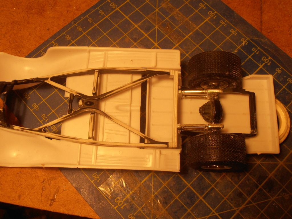

fractalign Posted December 4, 2015 Author Posted December 4, 2015 (edited) The 40 Ford below has a similar set up only with a bogie drive. The version I have constructed looks more like the one below minus the twin wheel arches. In the previous post I mentioned I would be releasing the wheels and tyres before tooling up for the complete kit. I am hoping the lag time between the wheels and tyres and the complete kit is shortened now that I have ironed out all the bugs. Sorry for the lack of progress photos, trouble with my uploader it seems. Once that is sorted out I can post of up photos of the car hauler body and fingers crossed actually have a full kit completed in the next couple of months. Anyway let me know what you think of the car hauler idea or if you have any suggestions for any other configurations, Cheers ! th Anyway Edited December 4, 2015 by fractalign
