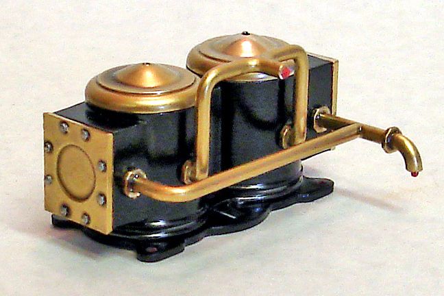

Harry P. Posted December 15, 2013 Author Posted December 15, 2013 This is the cylinder head assembly (the cylinders are driven by the pressurized steam from the boiler, and transfer their motion to the pump). All of these parts were chrome plated, but in my attempt to "de-bling" this thing and make it look less like a museum restoration and more like a workaday vehicle, I lost all the chrome and went with what I think is a more "1890s" look. I like the contrast between the semigloss black and the brass. All of the "brass" parts were blackwashed with my custom mix of Future/acrylic black after being painted Rustoleum Metallic Brass. The nuts on the side plates were brush painted Testors Silver, then a black wash applied to highlight them.The upside-down "U" shaped pipe is the steam intake from the boiler, the other pipe is the exhaust (which in this case would be nothing more than water vapor). BTW... all of the chrome-plated parts in this kit are actually molded in red plastic, as you can see by the area on the intake pipe where I scraped the paint away to be able to glue it to the boiler.

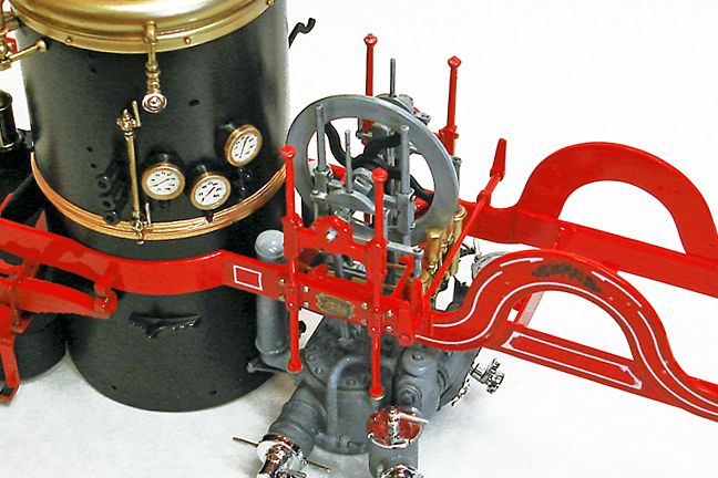

Harry P. Posted December 15, 2013 Author Posted December 15, 2013 And here is where I'm at as of today. As you can see, the main frame has been assembled, along with the pump mechanism. The various components that make up the moving parts of the pump are very spindly and thin, with very little surface area between glue joints. Also, all of the various levers and arms and supports have to be kept parallel to each other while assembling. The best way I could figure to build this mechanism and keep all the components lined up correctly was to start on one side by cementing the outer support arms in place. Once these were parallel and plumb and the cement dry, I added the inner structure, then the crankshaft and flywheel, then the other side inner structure, and finally the other side outer support arms... always letting the previous assembly dry before adding the next one:
Harry P. Posted December 15, 2013 Author Posted December 15, 2013 In this photo you can see the cylinders installed at the top of the pump drive mechanism. Still to be installed are the drive arms that connect from the cylinders and rotate the crankshaft (you can see the end of the crankshaft where these drive arms will attach, sticking out in the middle of the crosspiece of the red vertical support arms: Those red vertical supports were also chrome plated; I went with red instead. The nuts where the verical supports are connected to the frame rails were brush painted Testors Silver, and the small "brass" nameplate between the vertical supports was brush painted a mix of Testors Silver and Brass, then blackwashed to bring out the engraved detail.

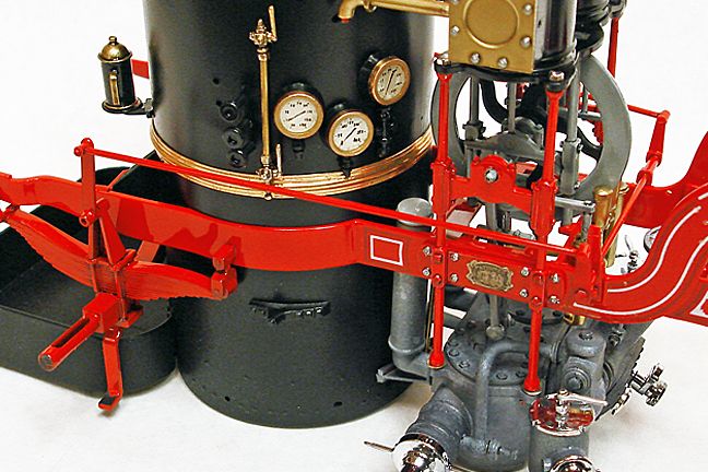

Harry P. Posted December 15, 2013 Author Posted December 15, 2013 Here's a better view of the rear axle and leaf springs. That big "tray" in back held the coal that fired the boiler. There is a small door on the back of the boiler where the coal was shoveled in; it's hidden in this photo by the righthand side frame rail and leaf springs.

Harry P. Posted December 15, 2013 Author Posted December 15, 2013 I think it is gorgeous. One does not need hundreds of dollars worth of gee-gaws and doo-dads to make a beautiful build. You are proving my point . Right! There isn't anything in the photos that didn't come in the kit box. I changed up the appearance of a lot of it... but nothing here is aftermarket. It's a nice kit, very well detailed right out of the box. The pinstriping decals you see on the frame rails were a huge PITA to apply, and I mean HUGE. The problem is first, the decals are incredibly thin and "floppy," and second, the clear carrier layer extends only a little bit past the stripes themselves. For example, that set of stripes that goes up and around the arch on the frame rail is all one decal, which would be fine... but the problem is that there is no clear film between the inner and outer stripes! There is no clear film in the area "inside" the stripes–the decal is sort of a "loop" of stripes. Trying to slide that decal off the backing sheet in one piece and into place, and then trying to get the stripes straight and to follow the curve of the arch, was nearly impossible. I still don't know how I managed to do it, not once but twice (the other side, too!). Somehow I managed to get everything lined up correctly without tearing the decal. So far the decals are by far the most difficult part of this model.

Harry P. Posted December 16, 2013 Author Posted December 16, 2013 Remember, this rig began life as a horse-drawn pumper, so the "brakes" were the horses themselves (as in "Whoa!"). Once the pumper was converted to Christie power, my guess is that some sort of braking system had to be retrofitted to make up for the loss of the original "brakes." The model has a simple rod-actuated rear brake system (remember, this was long before hydraulic brakes were invented). The kit-supplied brake actuator rods were a mess... too much flash, mold seams all along the length... so instead of trying to make the kit parts presentable, in this case I scratchbuilt new actuator rods of brass with styrene rod connector ends, to replace the sub-par kit pieces. Brake rods installed (but not the actual brakes...yet):
