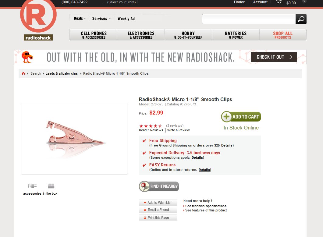

935k3 Posted February 6, 2014 Share Posted February 6, 2014 Radio Shack sells very small copper alligator clips that have no teeth and are just flat. I mount them on the end of bamboo skewers. Quote Link to comment Share on other sites More sharing options...
