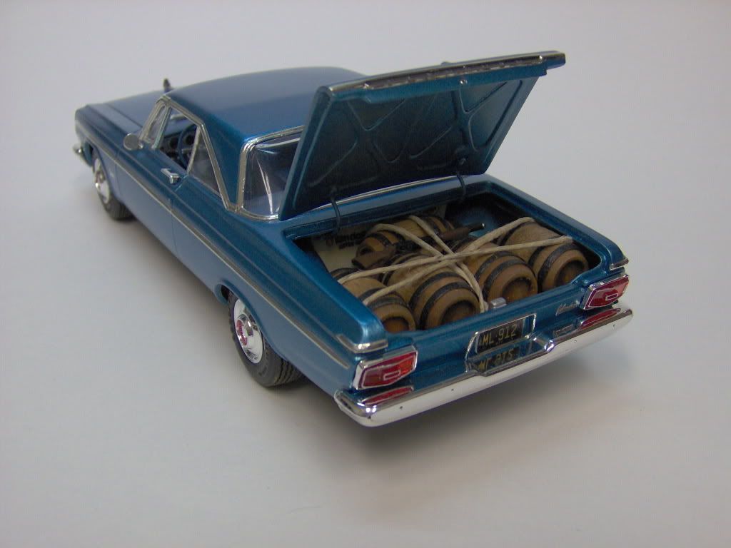

mr moto Posted December 14, 2007 Posted December 14, 2007 A question came up in On the Workbench about using magnets to hold doors tightly closed. I've never done it for doors but I've done hoods and trunks. Here's a '64 Plymouth moonshine runner that I did a couple of years ago. That little silver-gray rectangle that you can see sticking up just above the license plate is a rare earth magnet. It works great and the trunk closes with a satisfying "click" sound. What you can't see is that the trunk is also being held open by magnets. There is one superglued to one of the hinges and it mates to another magnet glued under the body when the trunk lid is raised so it doesn't need to be propped open. The magnets I used are 1/8"x1/8"x1/16" rare earth magnets from a place called Amazing Magnets. These things are STRONG! http://www.amazingmagnets.com/ This is fun to play with and you can probably think of more uses for them.

mr moto Posted December 14, 2007 Author Posted December 14, 2007 These magnets won't be slowed down by a few layers of paint! I'll try to get a picture of the magnets holding the trunk but they might be too well hidden and my camera doesn't do very good close-ups anyway.

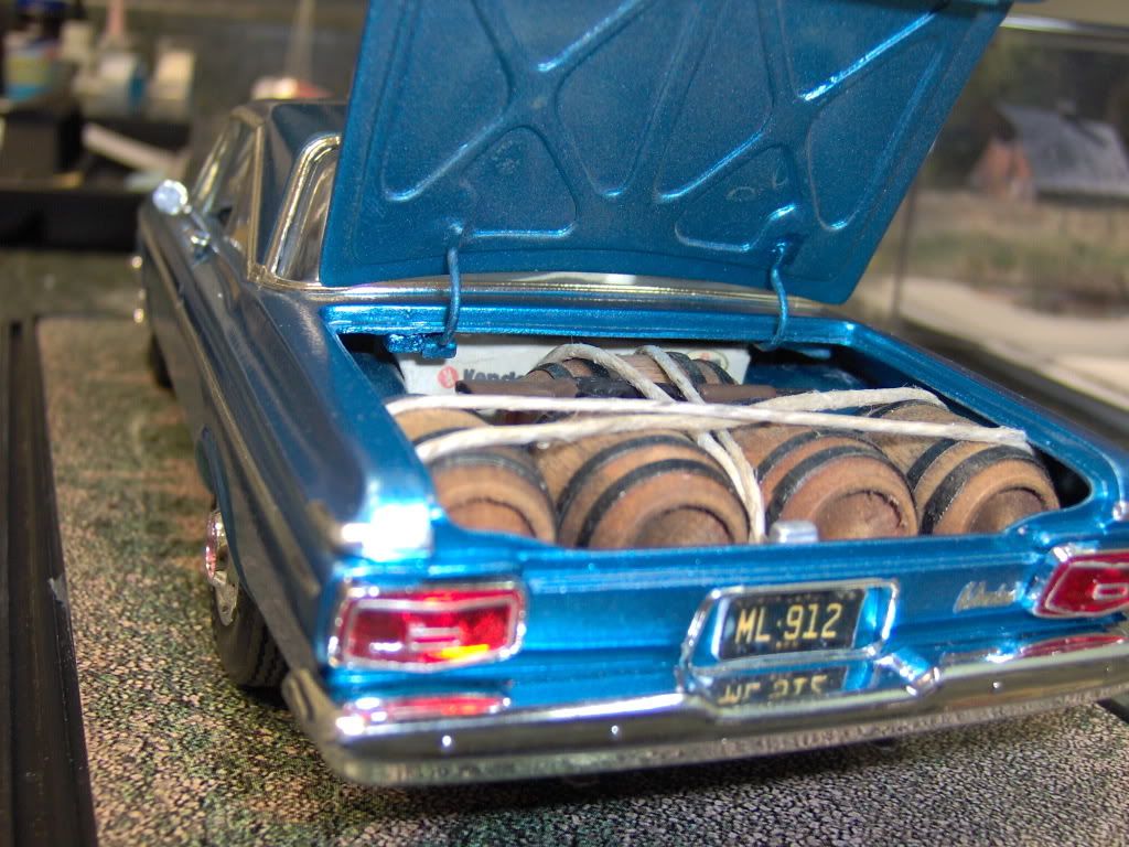

mr moto Posted December 15, 2007 Author Posted December 15, 2007 This pic didn't come out too bad. You can see the magnets side by side at the left hinge. The mag on the left is attached to the body. The one on the right is attached to the hinge. BTW, on this model the hood is only held shut by magnets but has to be propped open. Hoods are harder to do than trunks. Because the hinges have to pass thru narrow slots in the firewall as the hood opens I couldn't find room to attach a magnet to the hinge.

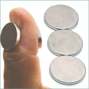

jbwelda Posted December 18, 2007 Posted December 18, 2007 (edited) yes i was just going to add that ive been using those magnets on slot cars for the past few years and there are some incredibly strong, small magnets available. like mr moto says, ive just seen some very tiny, maybe 1/8 diameter by about 1/16 or less deep circular magnets that would be perfect for this application. they are strong enough to go through a finger like the photo above, but they are about 1/10th the size. im going to have to remember this tip! seems like it would be useful for a lot of things including keeping a removable body fixed down to its chassis. Edited December 18, 2007 by jbwelda
