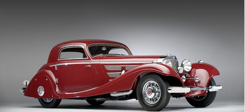

As a regular visitor to the AACA forum, I get what you say that European classics shouldn't have whitewalls, but I'm not as fussy about that as a lot of AACA members. As for chrome wire wheels, I believe the only Mercedes of the old days to have standard chromed factory wire wheels was the 540K coupe that was introduced at the 1936 Paris Salon (available as a somewhat inaccurate Monogram kit). However, they were available on special order.
My first thought is that the production crew put the wires on the car for the commercial. Black car, black wheels, it cannot be seen on film well.
