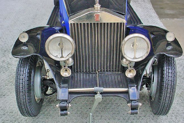

Cato Posted May 16, 2014 Author Posted May 16, 2014 (edited) Yes they are. The whitewall side is smooth all the way from the rim to nearly the tread.They have a slight bulge. The black side has the four circumferential rings plus the radiating sipes outward. That side is bulged right where the rings start. Two different sidewall contours. I assembled the wheels without the screws in the outer rims to avoid the tires 'standing off' the rims. They fit fine and look good with the chassis sitting on them. Plus they go on and off the rims easily without getting chewed up. Very supple. You can only see the two different contours from dead ahead or behind and low down. You don't like 'em?? Edit-I took pains to get the rims exactly 18mm wide between the beads; as narrow as I could get them. But all 5 are the same. Edited May 16, 2014 by Cato
Harry P. Posted May 16, 2014 Posted May 16, 2014 The sidewalls seem to "bulge" way too much, as if the tires are too narrow for the rims (and of course, if so, not your fault). Here's a photo from the Koo CD with the kit tires. See how the sidewalls aren't bulged out like yours are? Marvin's tires may be dimensionally correct and Pocher's wheels may be too wide, I don't know. But to my eye those sidewalls look "off." Again, not your fault at all. But to me it looks like the tires are stretched too far to fit over the rims. Edit: it might be the fact that yours are whitewalls and that makes the bulge more visually pronounced. No big deal in any case... but for whatever reason, your tires just look "off" to me.
Cato Posted May 16, 2014 Author Posted May 16, 2014 (edited) Fair enough and good illustration. I could not get the rims any slimmer-and I sanded every one of the seven rings' mating surfaces. But look carefully at the inners on both sides and you can see that the contour of the black swells where mine does and hangs a bit over the rim. I think what makes it pronounced on mine is the white side is very smooth from rim to tread-molded that way. The black side on mine has a different, bulged arc from rim to tread. I'm weighing, if I make them blackwalls (your vinyl paint I guess), I'll have the smooth (white) side out. Jury's still out on that. But I do love the tires and can live with them as is. And-it may be the camera lens but I have near zero positive camber on mine as opposed to what's seen on Paul's. Worked darned hard on that too. EDIT-Hey, I just noticed that the left front brake drum on Paul's car is standing off the backing plate! Just like I illustrated with mine in this post. Should I share my secret with Paul?? Edited May 16, 2014 by Cato
