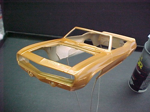

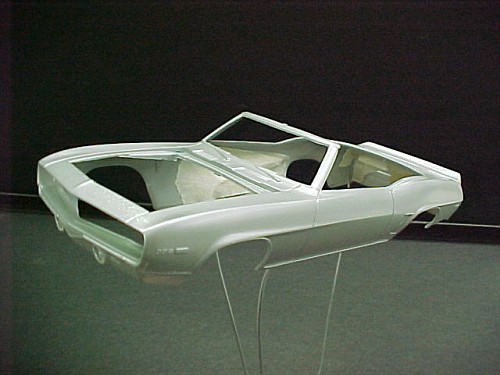

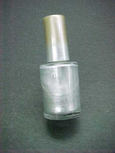

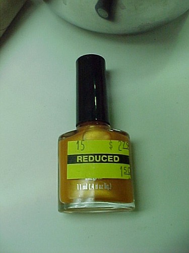

Buy a BLAH_BLAH_BLAH_BLAH load of nail polish... I use it almost exclusively now! Mixes the same as the old laquer and there are some INCREDIBLE colors out there! One bottle will cover a car with three or four coats. I get this stuff cheap at Big Lots and the big box stores. Mix it with your choice of laquer thinner. Sprays about the same as laquer also. Get some plastic spoons to practice on, they are cheap also. :)

Yes, totally serious. This stuff sprays just like laquer. Buy a few bottles (at least three) if you are planning to do total repaints with translucents. Mix the bottles into one container to get the color consistant. Spraying opaques can be done with one or two bottles for a complete model.
I use Dupont or Plasti-Kote gray primer under it just like automotive laquer.
Go crazy! The colors that are available will blow your mind. Right down to flip-flops and camelions!
