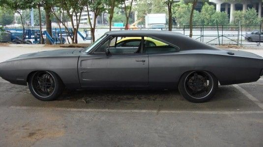

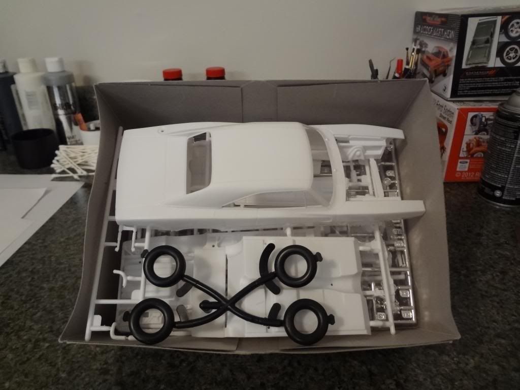

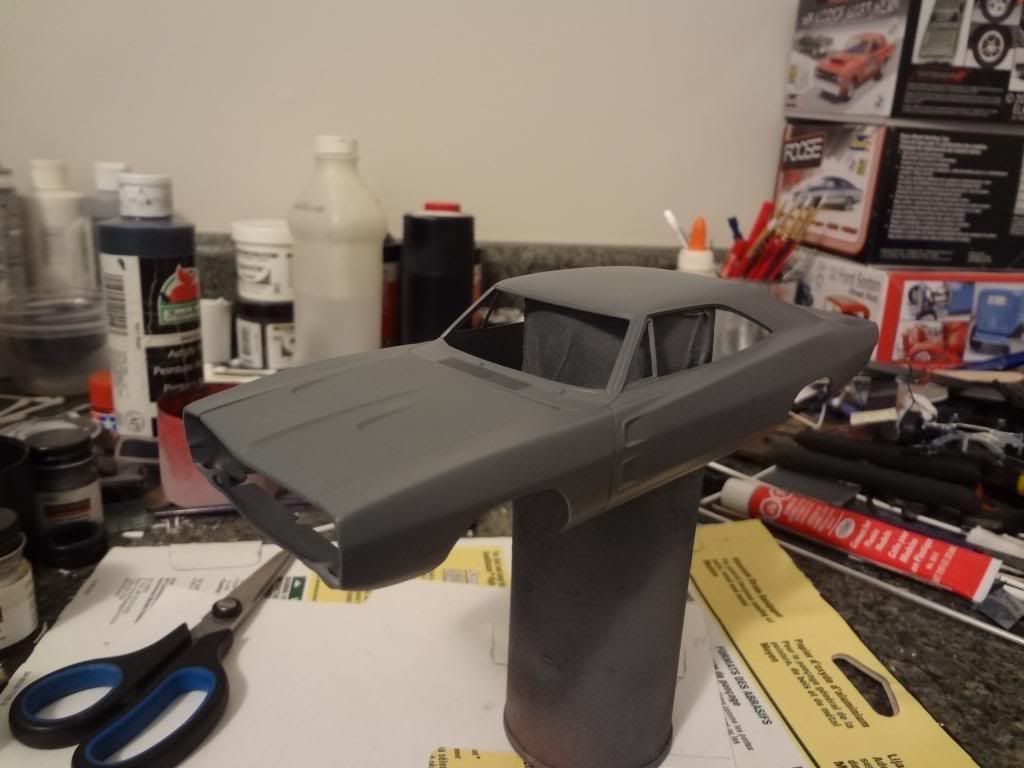

Hey guys, this here is my second build of the year and it's a replica of Dom's Charger from Fast Five. It's being built for the Fast and Furious cbp. Starting out as a Revell 69' Charger it's going to be re worked to look like the 70' charger.
Here's the start, small update and end result.

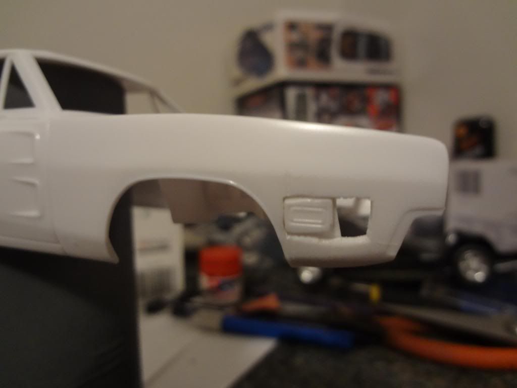

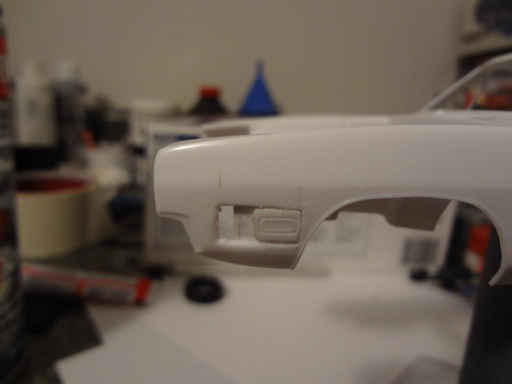

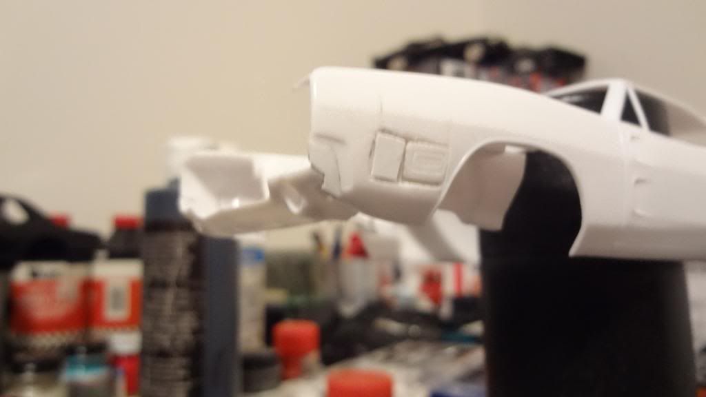

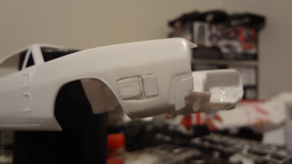

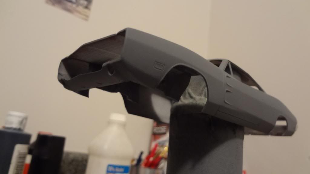

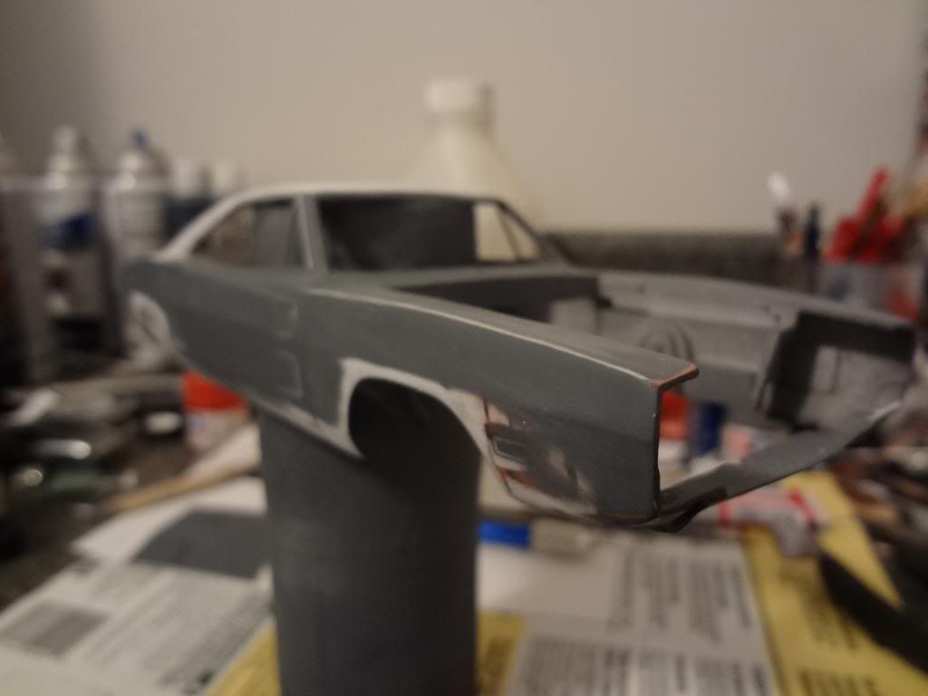

First order of business is moving the front reflectors back a bit.
Here is what the end result will look like, give or take.
Fast--Furious-5--70er-Dodge-Charger--Bil

interesting. seems like a lot of work just to move the indicators
Thanks, I'm trying to it as close to a '70 as my skill level will let me, moving them wasn't really that hard.

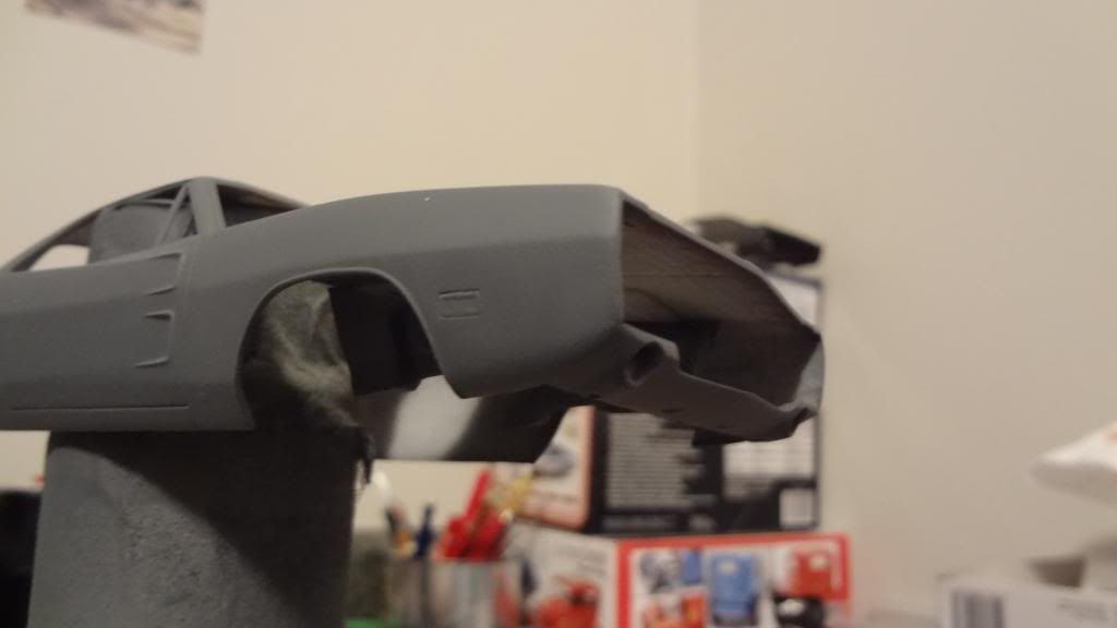

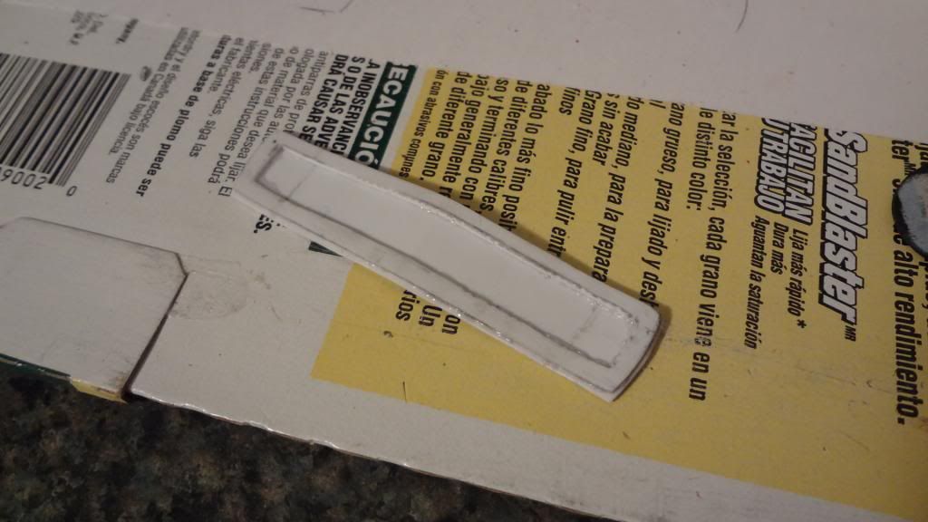

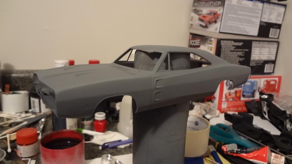

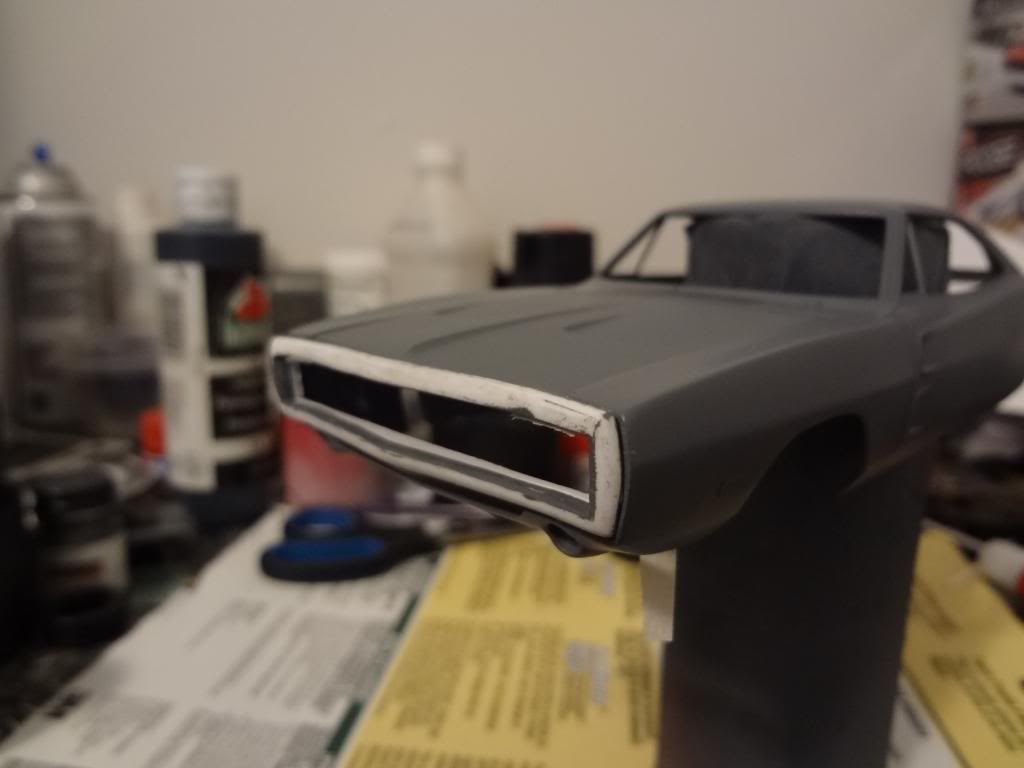

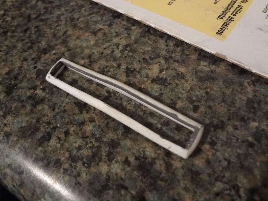

Got the front end done, well I still got to run the lines for the front clip. Also started to the Grille, next will be smoothing up the roof and interior work.
Thanks for looking!
Nice work on the marker lights Jonathan. Looking forward how you do your front grill. I picked up one of those kits just to keep. Like you i should have picked up a few....
:rolleyes: Hi looking good the sidelights came out great. I'm not shure if you know but modelhause has all replacement parts for the 70 Charger there the old amt/mpc parts but they are 1/25 so they do fit it may save you time on trying to make them.
Thanks Carl!

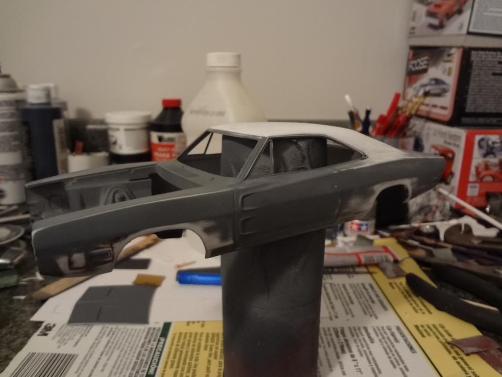

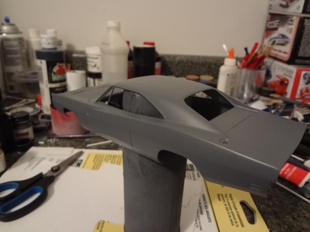

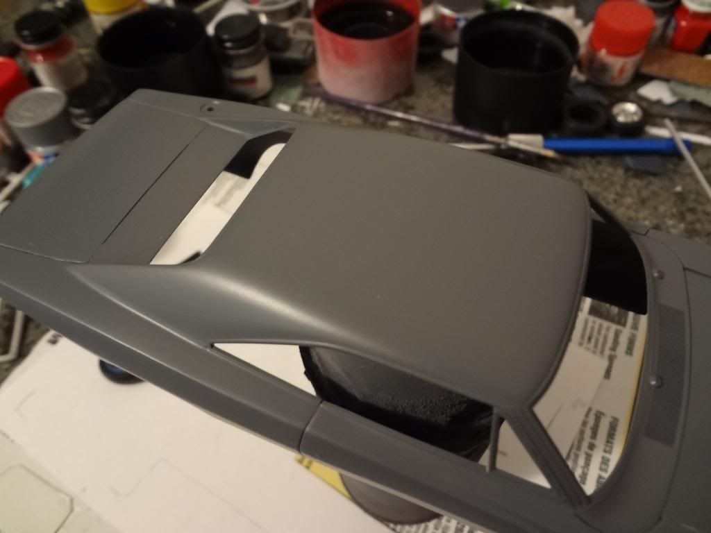

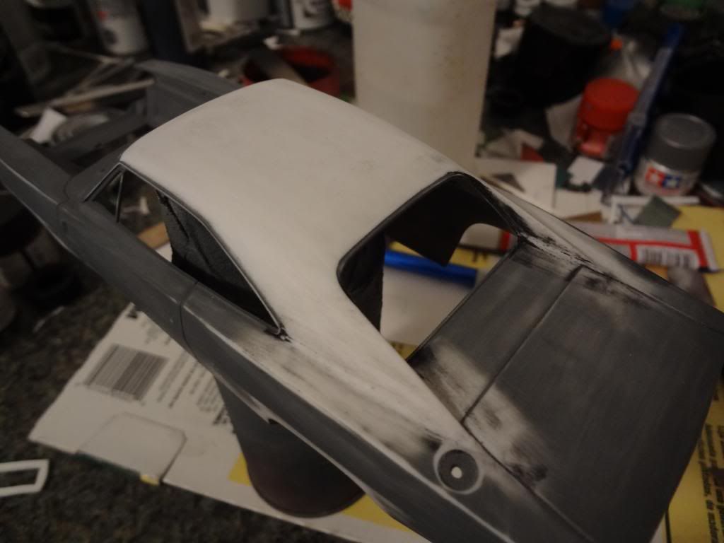

Quick update, finished up the body work (I think). Sanded off the vinyl top and fender trim, also got some more work done to the grille.
More pics to follow, thanks for looking!
Second set of pictures, body re-painted and grille mock up.
The grille is sitting a little off in the picture, it'll look right when it's permanently mounted. :)
Thank you for looking!

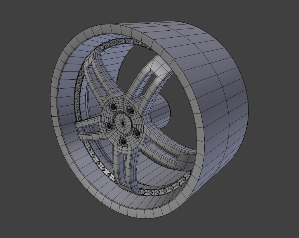

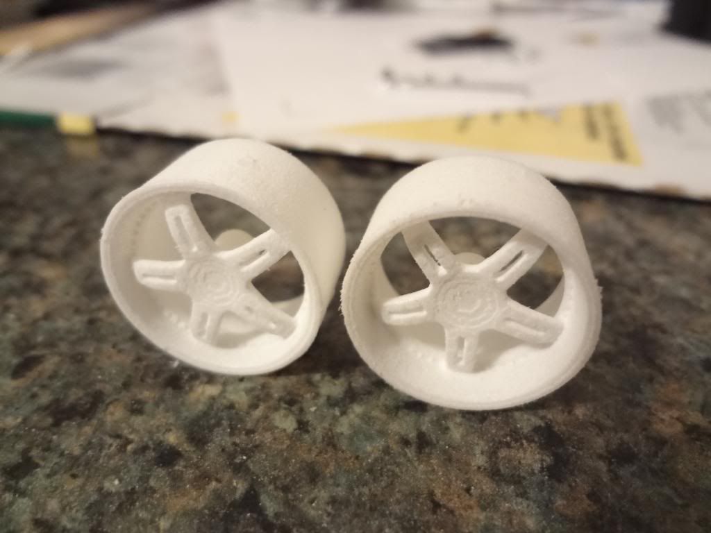

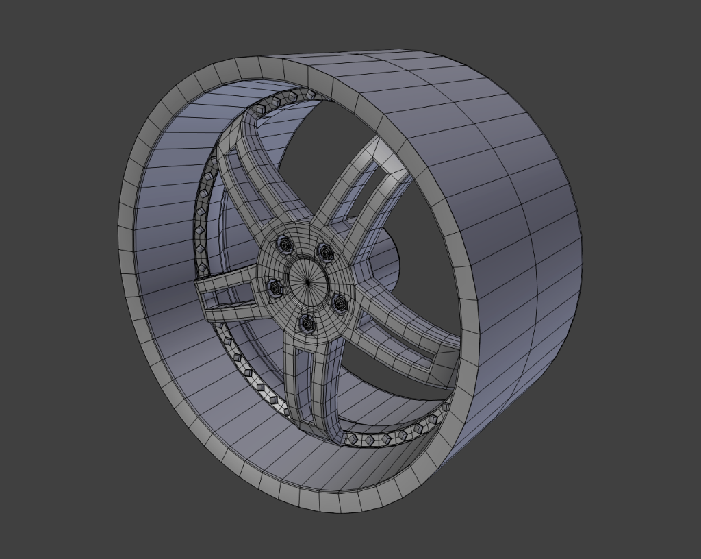

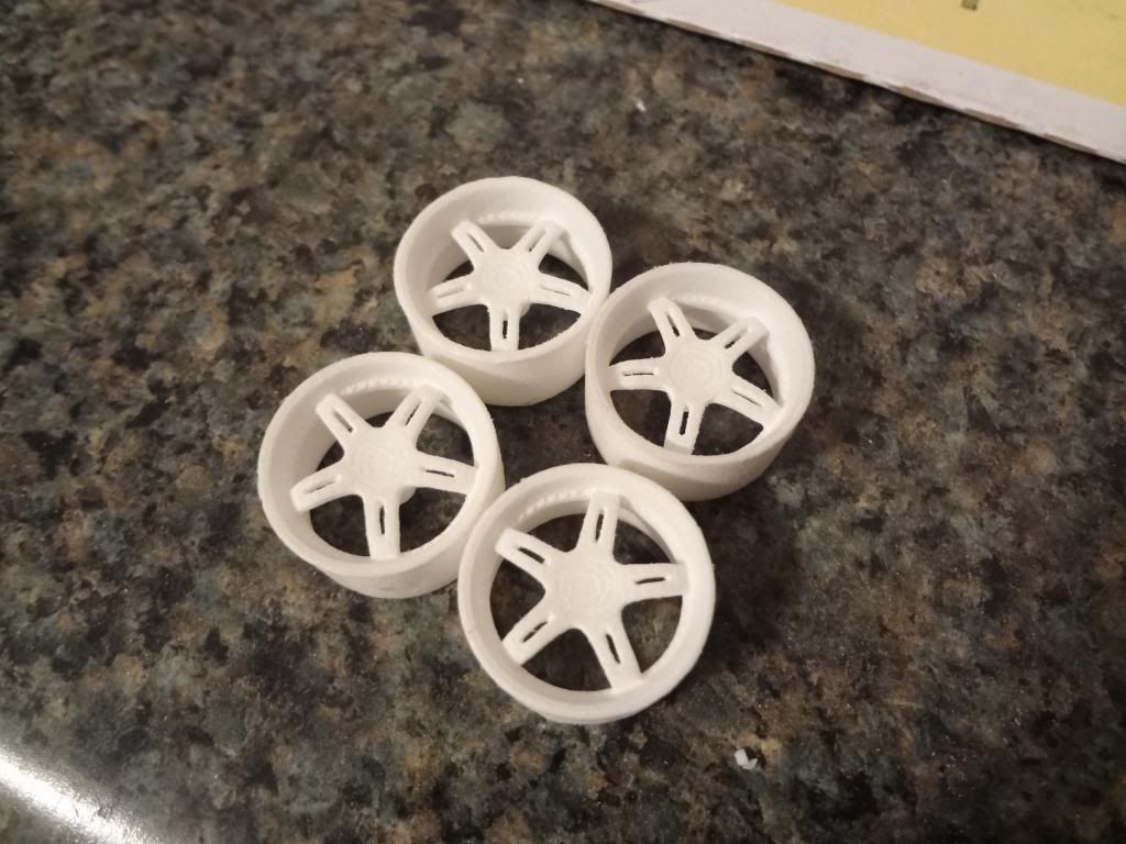

Another small but exciting update for me. It's also one of the biggest selling points of the build and that is the rims. Without knowing exactly what rims were used, I looked as best I could via Yahoo, Google, and Wiki search but wasn't able to find anything on the rims. So I just decided to model them out as best I could in 3D and had Shapeways print them along with a few other goodies that will be used later on in the year for another build.
Viewport render of the front rim modeled in Blender 3D.
Rear rim viewport
Printed product, Strong & Flexible Plastic, Polished
And the end result after some sanding and painting.
Thanks for looking!
This 3D printing technology is some pretty cool stuff!
I agree Jason, it's awesome stuff. Can't wait for the day when 3d printers become common household items. I know I'll put one to good use. :D
Thanks Carl!

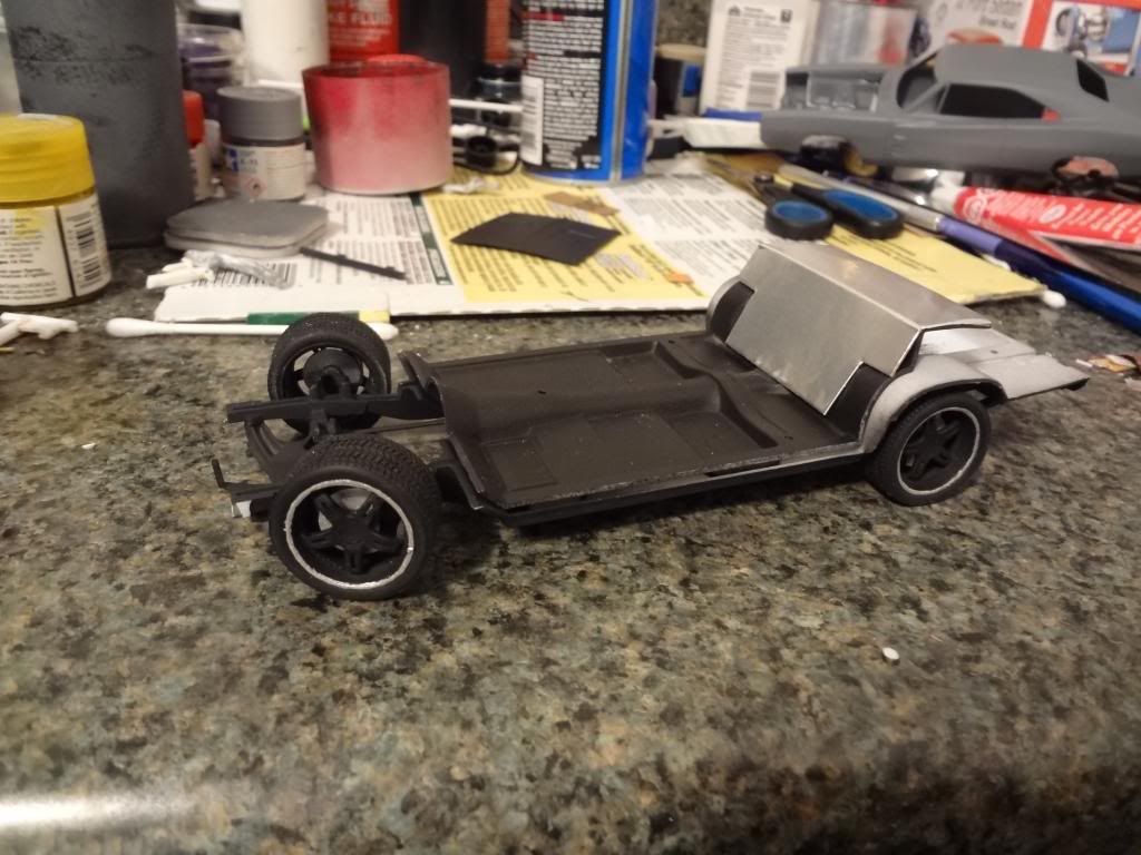

Sorry for no recent updates, I've been sick since Friday the 18th. Finaly got better and started working on it again. I need to get a move on, it's gotta be done by the end of the month.

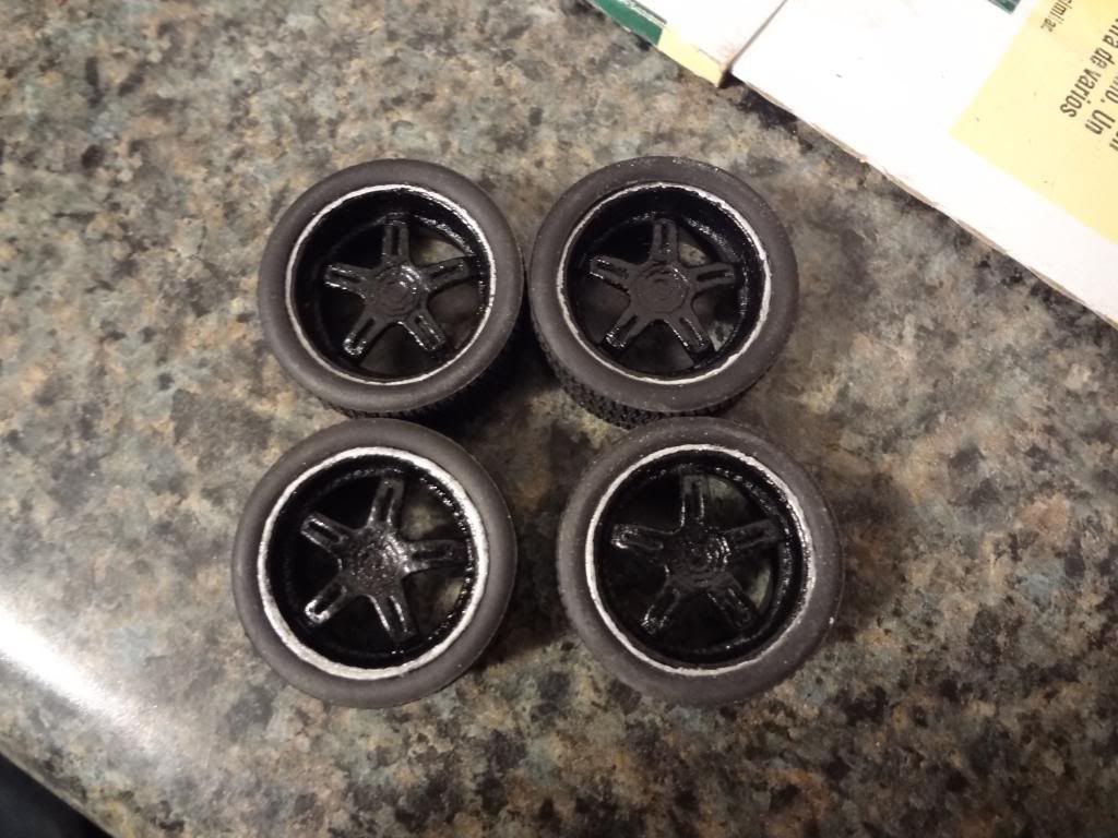

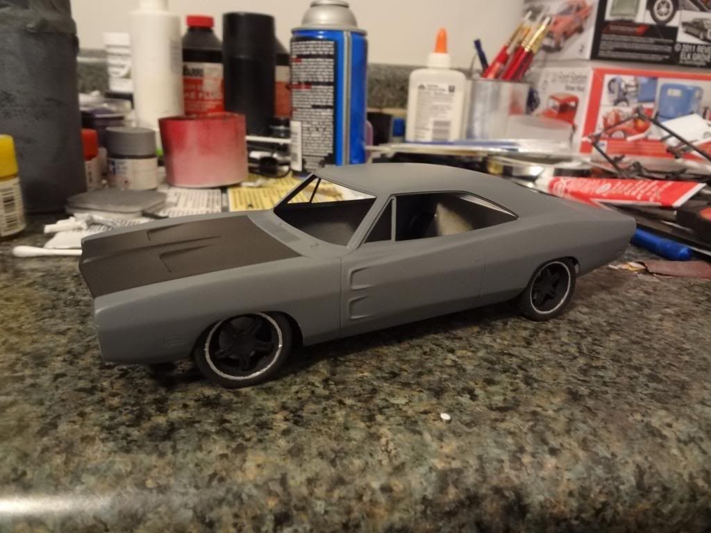

Started on the interior, got the wheels set and got the grille done, just need to do something for headlights.
Pics!

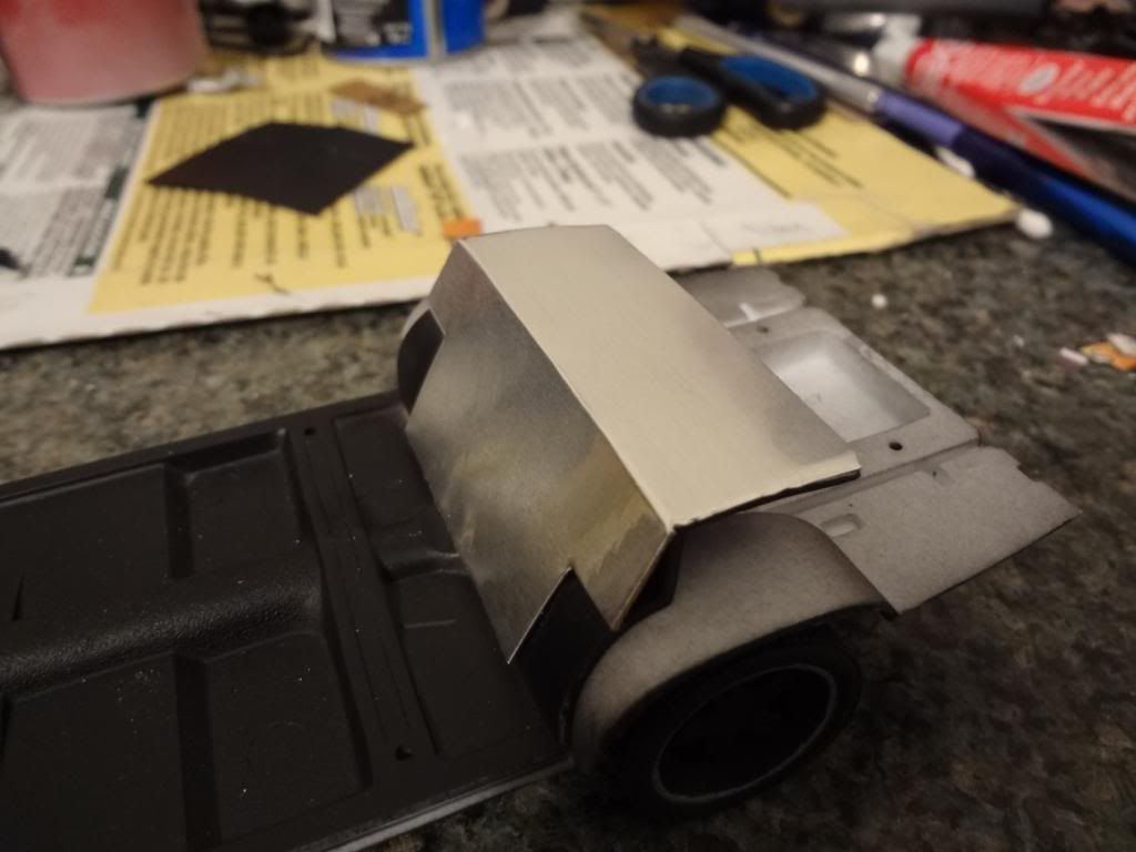

This back peice is covered with heat and air duct tape to replicate the sheet aluminum used for the movie cars.

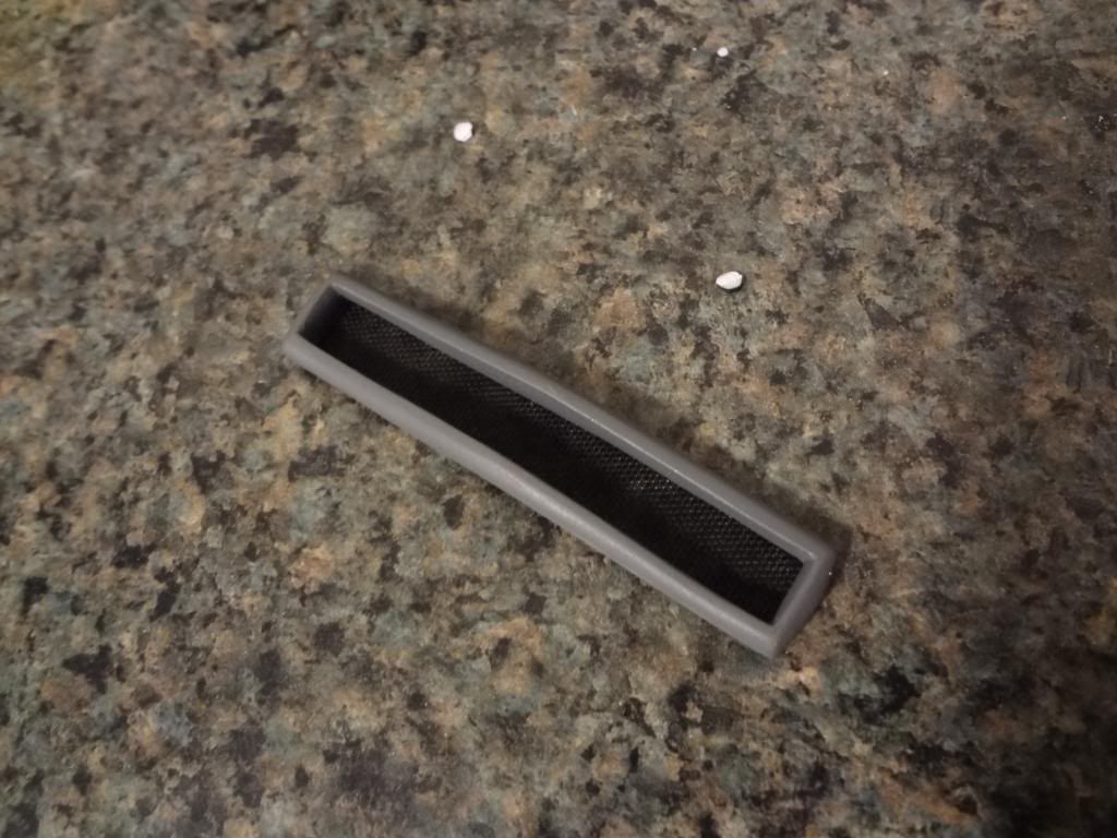

The grille is wire mesh, some of you might remember it from the '67 GTX I did for last years cannonball cbp.

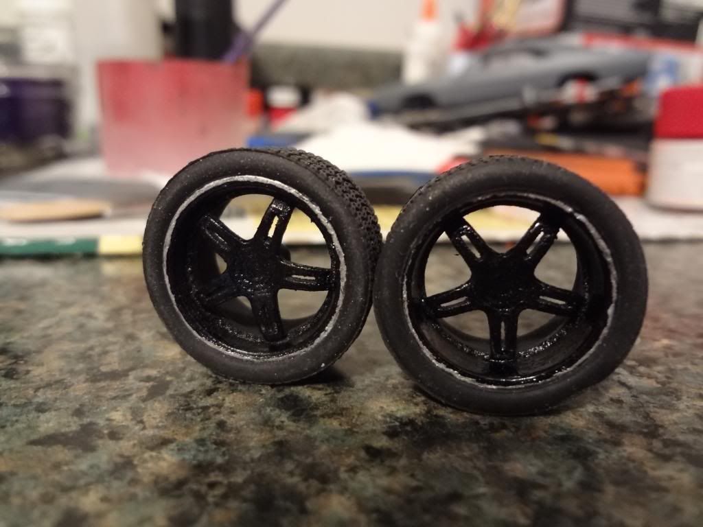

And Finally, a quick little mock up test with the rims.
Thanks for looking, more to come, within the next few days hopefully. :)
Man, I love the fact you can move the turn indicators back, primer it and it looks like it was made that way.
