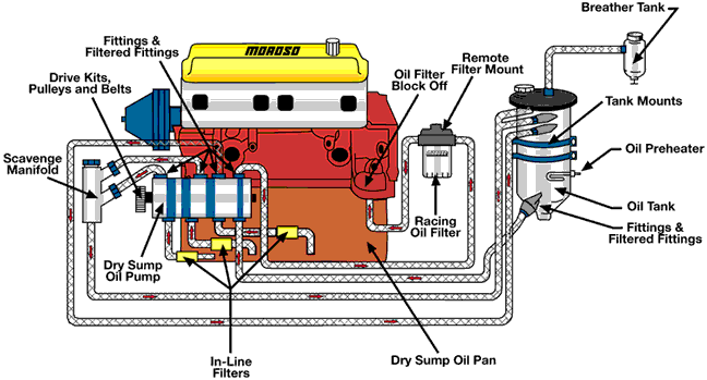

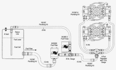

John Pol Posted April 14, 2014 Posted April 14, 2014 anybody have drawings they can send me of where the oil lines go,brake lines etc. on a 80`s Pro Stock car

John Pol Posted April 15, 2014 Author Posted April 15, 2014 Thanks guys for the diagrams they will help alot
