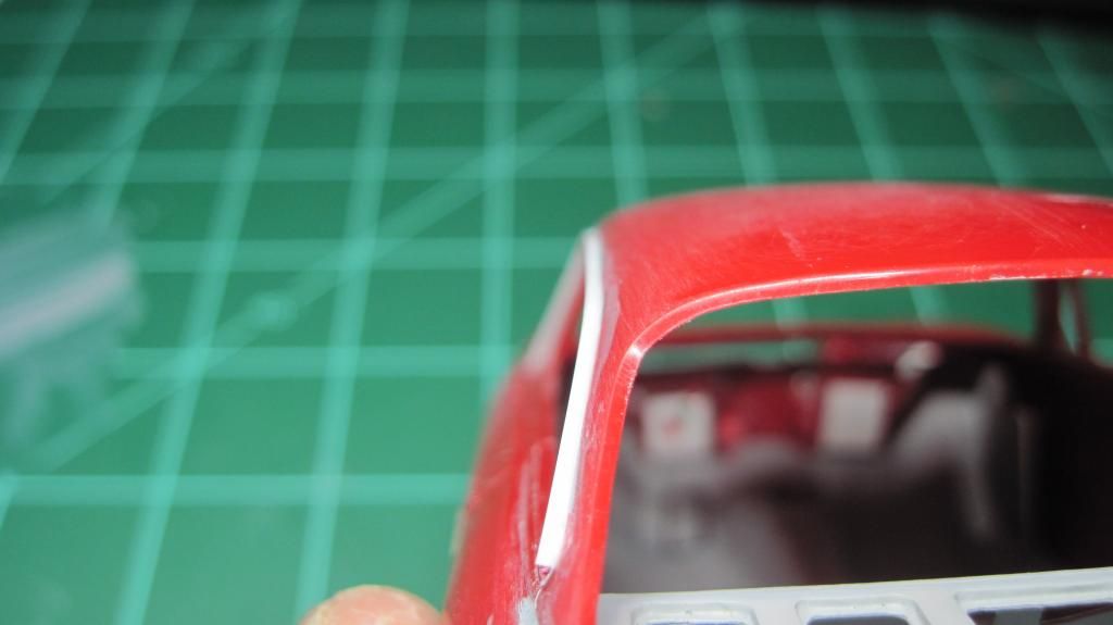

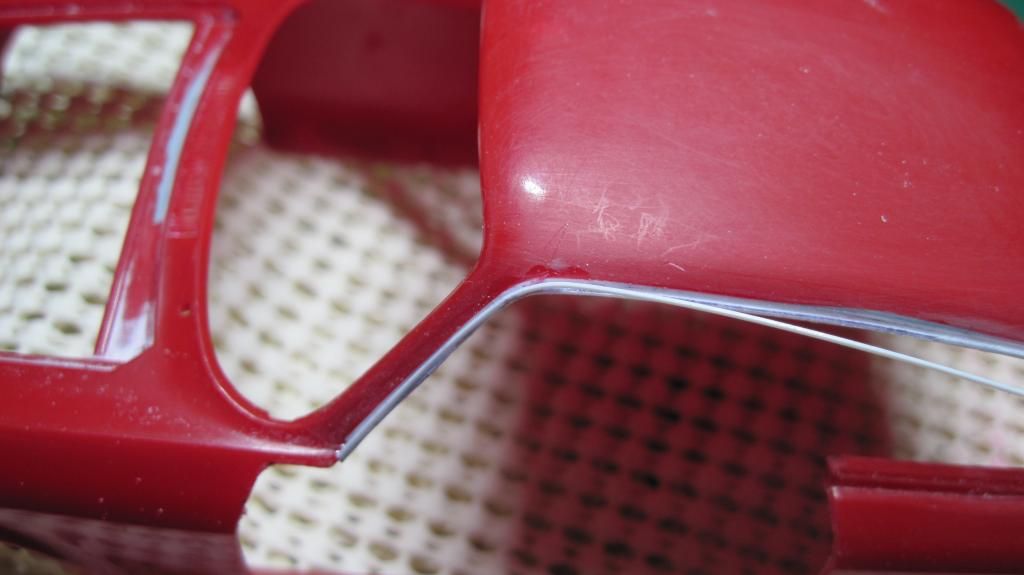

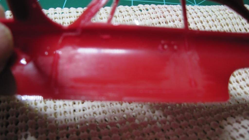

Turns out I got a little too enthusiastic with my grinding so I had to use the applied gutter as a "repair". After trimming and applying another stip over the repair:

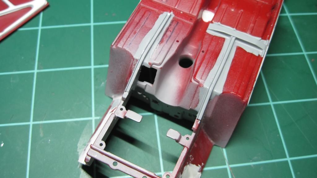

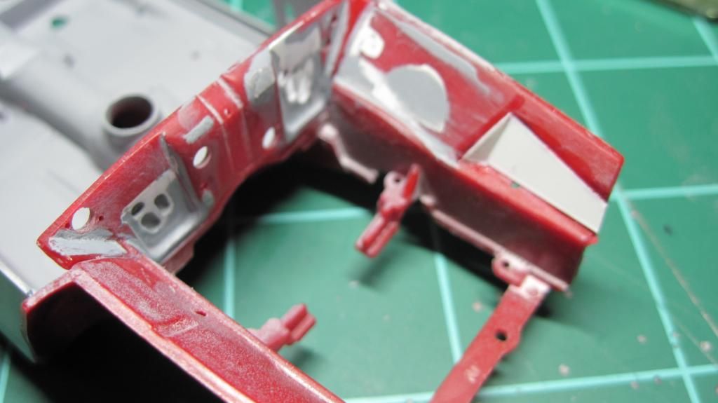

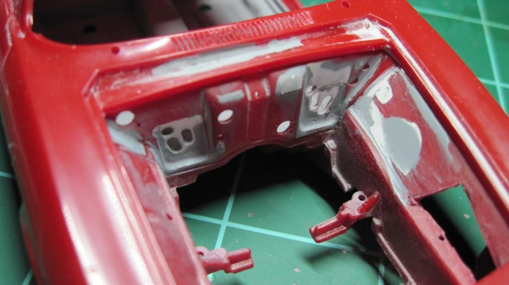

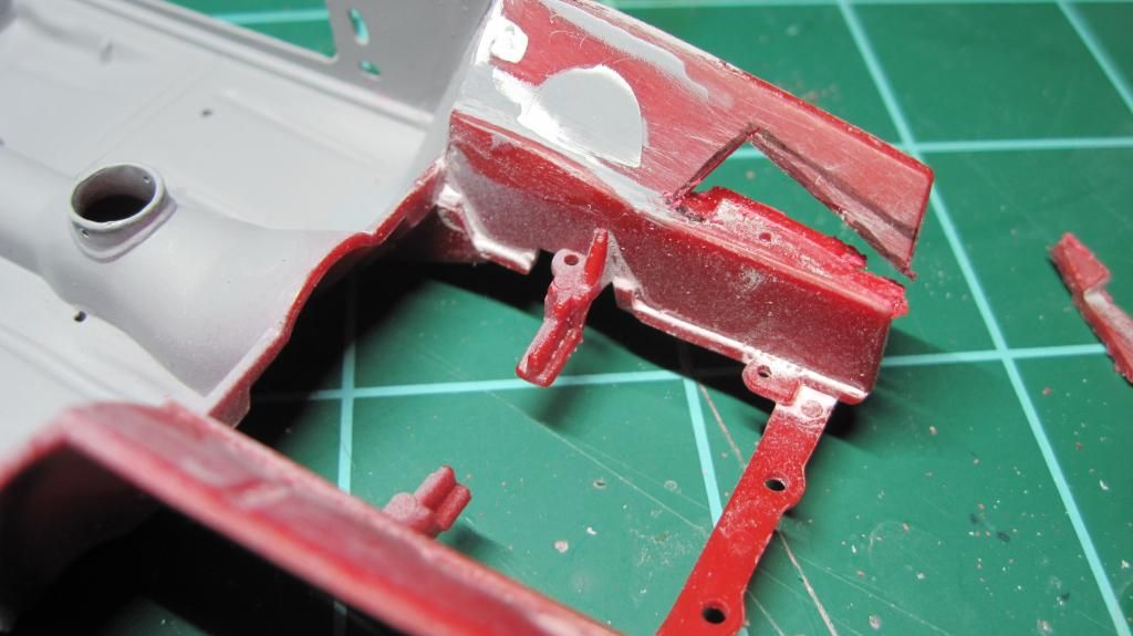

Turned my attention to the engine bay. Modified the battery shelf and finished the firewall:

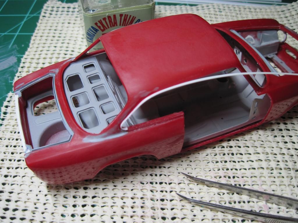

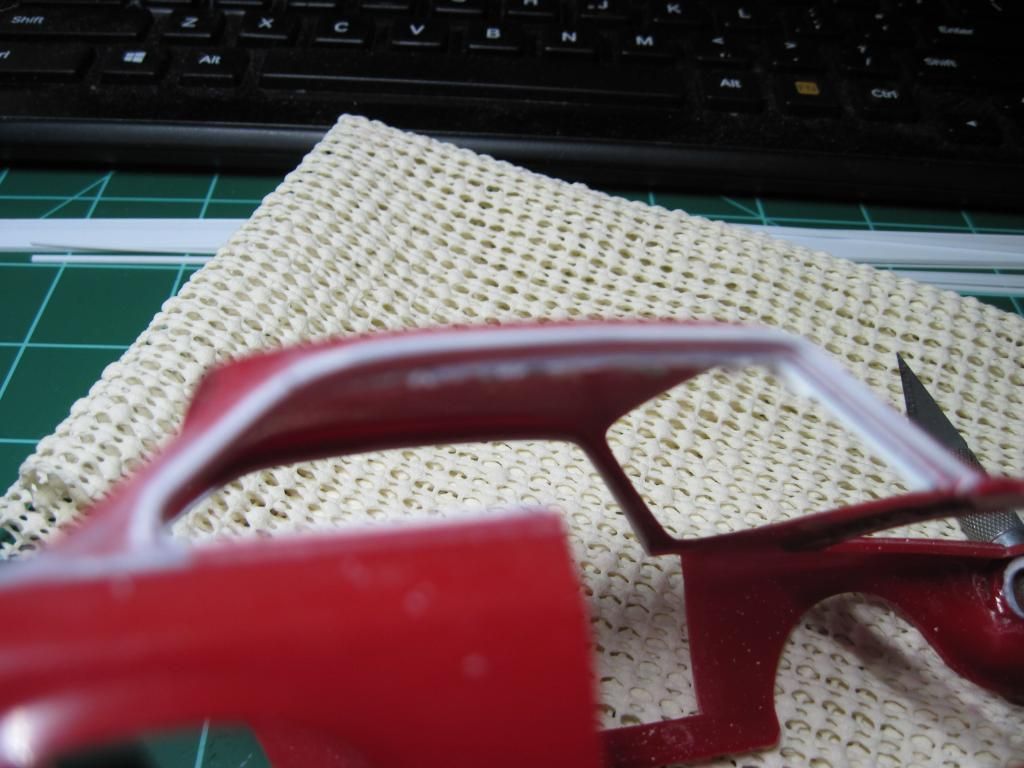

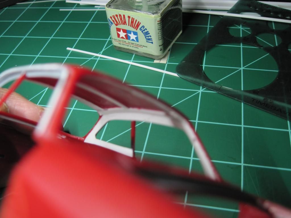

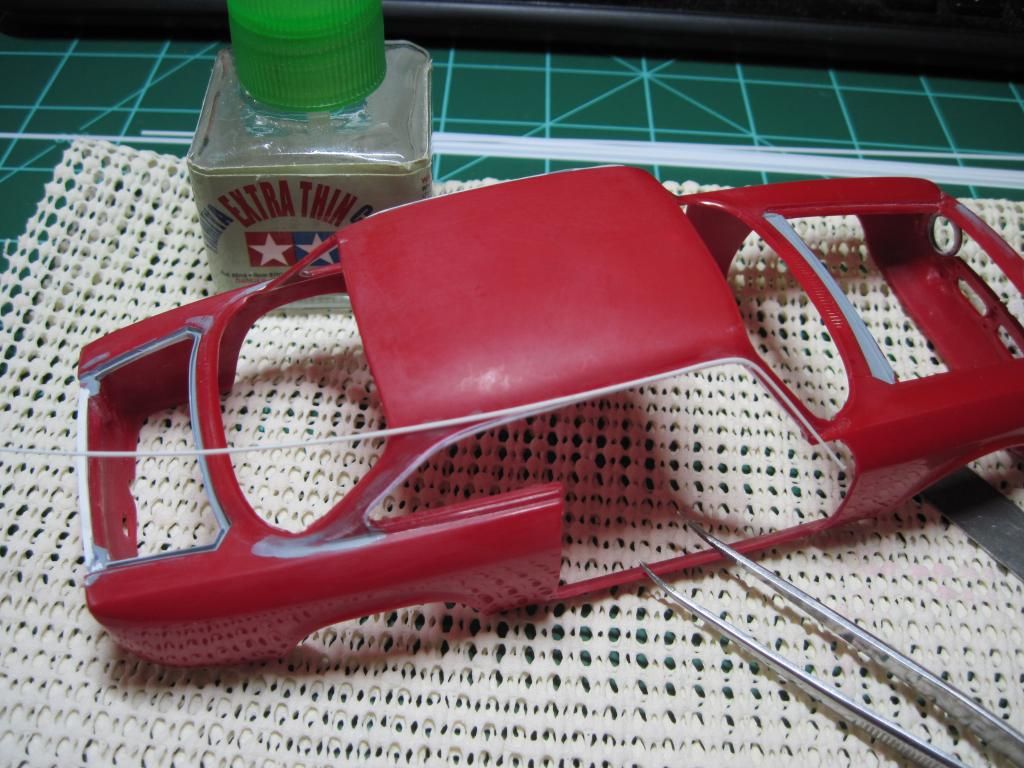

Popped down to the local hobby shop. Turns out Evergreen doesn't make .005 x .005 strips. Had to settle for .010 x .020 Should be a challenge getting the .020 side to take a bend camber. Also picked up a Squadron Precision Putty Applicator to make life a little easier. I really love Tamiya's Extra Thin Cement as the tiny applicator brush makes precision application a breeze:

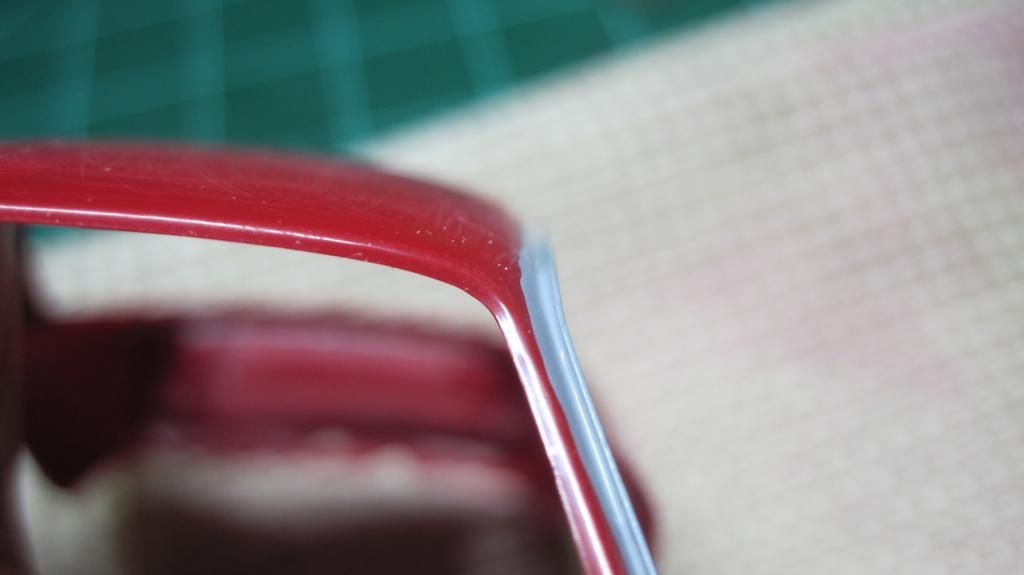

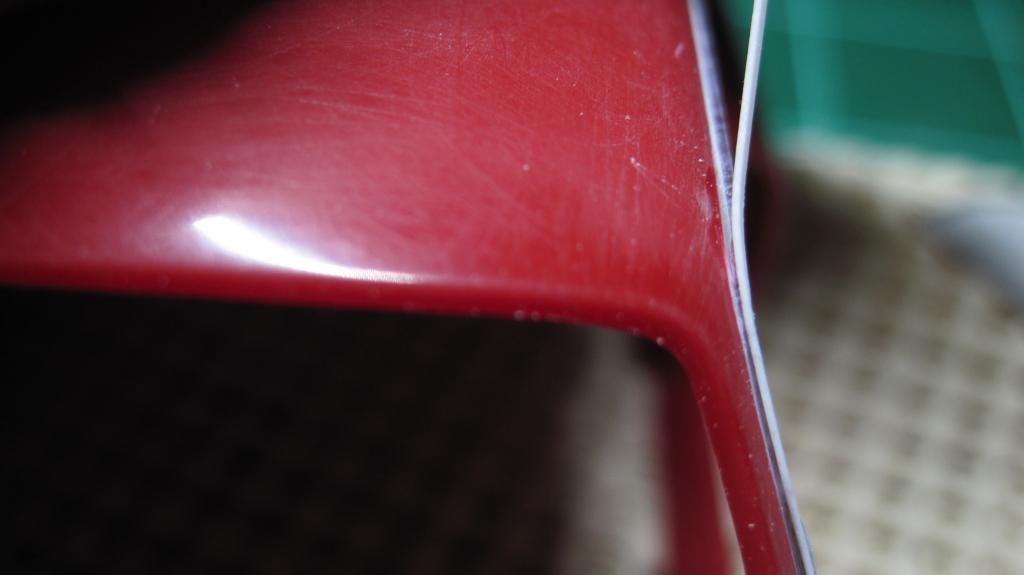

I cemented the strip in short segements while allowing for the joint to cure before moving onto the next as things are very fragile. Brushed on some spot primer to see how things are shaping. Proof of concept:
Vast improvement over the shapeless and incorrect blob of a rain gutter in the stock version. Should really stand out with BMF at the finish.

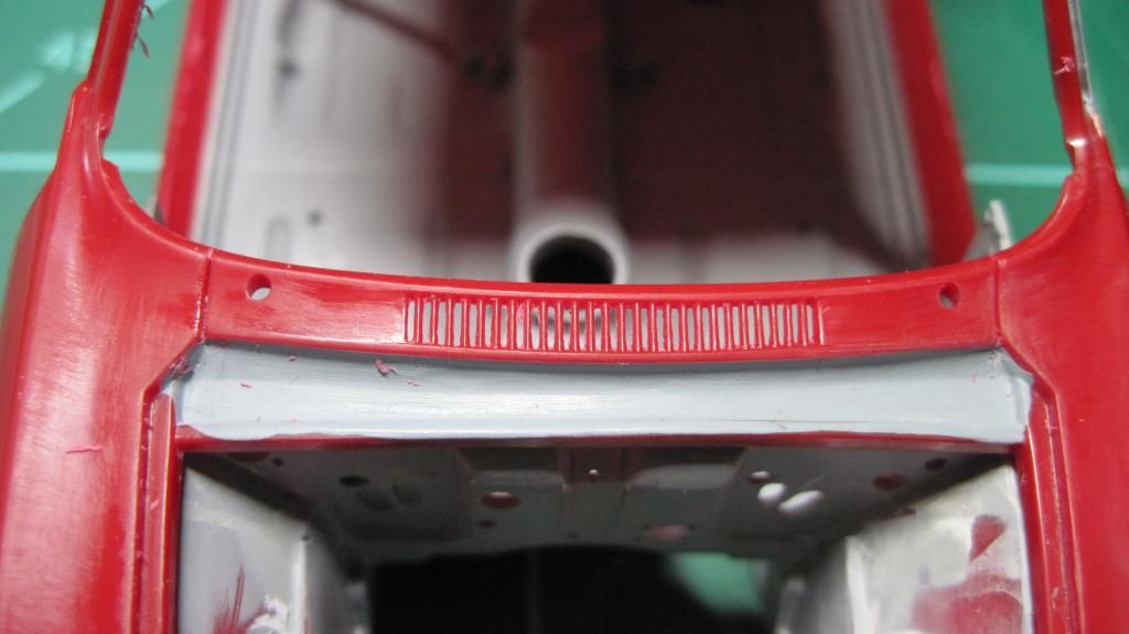

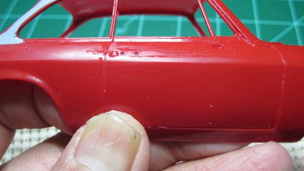

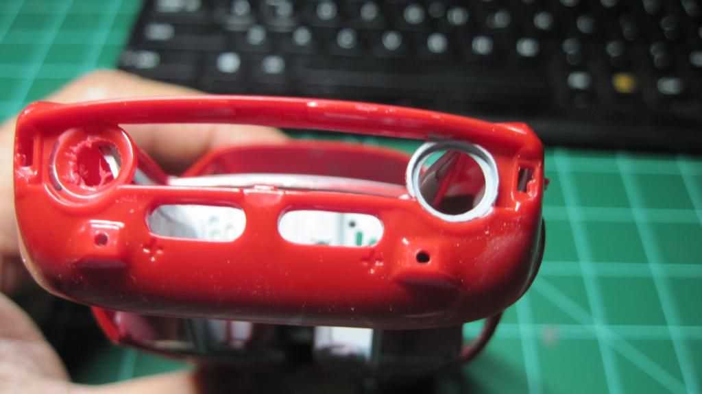

Also plugged the two license plate mounting holes with some stretched sprue:

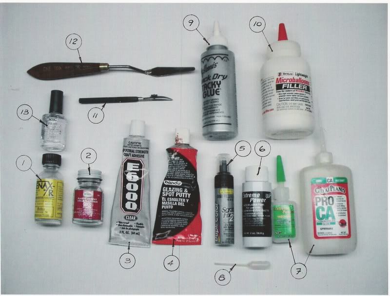

The build is looking good Mike. Two questions, can you post a pic of your grey scratch filler, so I can know what I'm getting at my LHS, or on line, and I've got to know who your avatar is can you tell me?
Joe, it's just plain old automotive scratch filler and primer:
(Item no. 5 in the photo)
You can get it at any auto parts store. It's essentially grey primer (lacquer) with a little more filler in it. It's useful for filling small gaps too. I like the 2 in 1 applicator because it has a brush built into the cap. It's expensive but I simply decant more scratch filler/primer from the large rattlecan by spraying directly into the bottle.

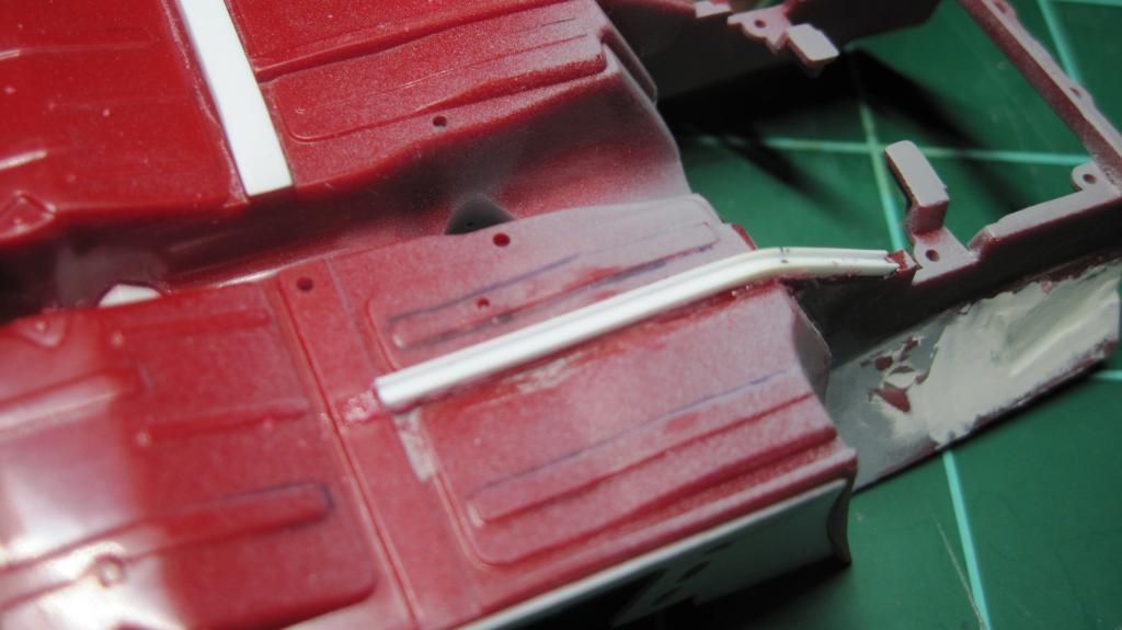

While the repairs and modifications on the bodyshell are curing, I returned to the chassis. Replaced the incorrect front rails with some channel:

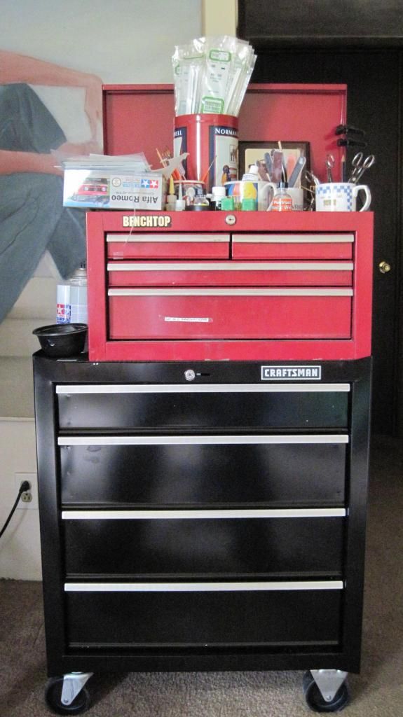

I also took a break and went down to Sears because they had a four drawer tool storage cabinet with casters for 85 bucks. I have patiently waited for a cheap and used one to show up at the local Salvation Army but none ever did. Anyway, I can now organize my hobby tools and materials:
BTW, it's lightly built and wouldn't be able to hold heavy things in the drawers but is perfect for hobby use. Also, the fasteners (for attaching the casters) that come with it are garbage. Throw them away and use real ones. :lol:
Thanks Mike, I so appreciate the picks. I often forget the stuff you get at a hobby shop is just over priced, repackaged with less of an amount than what is at your NAPA store. Shoot for that matter I have an account there. As far as Duncan goes I'll go to your link and read it. Many thanks again Mike, you are a great help.
I also use the Bondo Glazing and Spot Putty as it cures quickly and sands very easily. However, it is somewhat fragile and readily chips if used for fender flares. For extensive bodywork that is sculpted (like fender flares) I used to use DAP Plastic Wood from the hardware store. It's essentially cellulose fibers in an acetone base. It dries slowly and shrinks a little but it's very versatile. I have yet to try Tamiya's Epoxy Putty so I'll let you know.

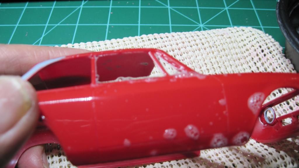

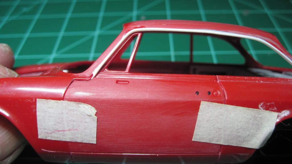

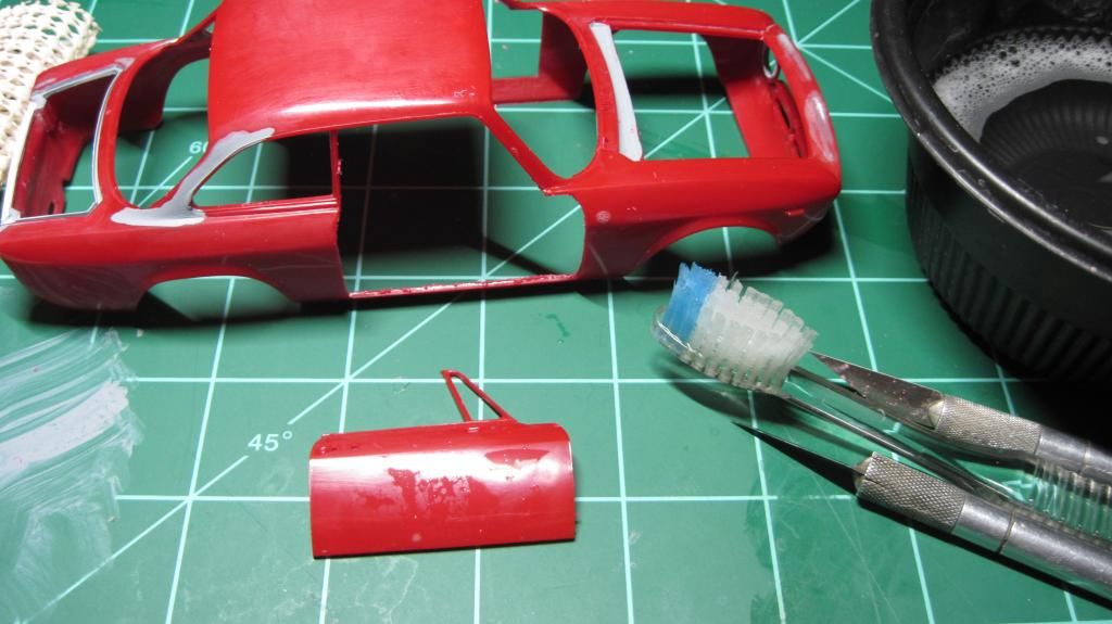

Used a large ball cutter with my flex shaft tool (el cheapo knock off of Foredom) set to almost stalling to thin out the door area:
Lots of soapy water to keep the area clean as I started to cut out the passenger door:

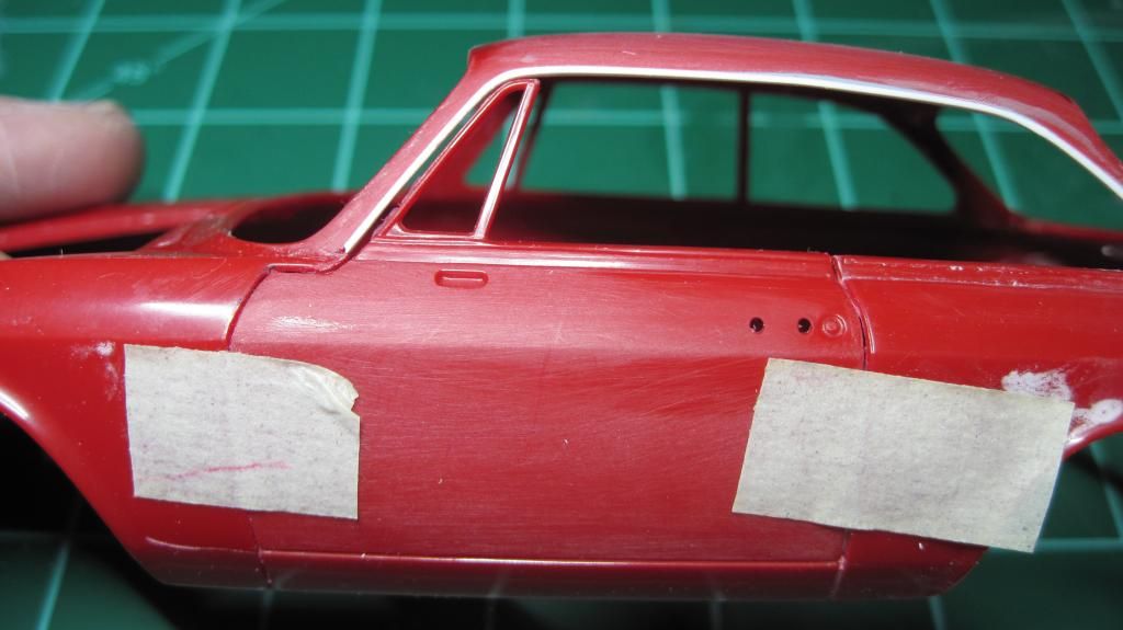

Door almost free save for three corners:
Got the job done with minimal waste and no errant cuts:
Also scribed some panel lines that were missing on the Tamiya model:

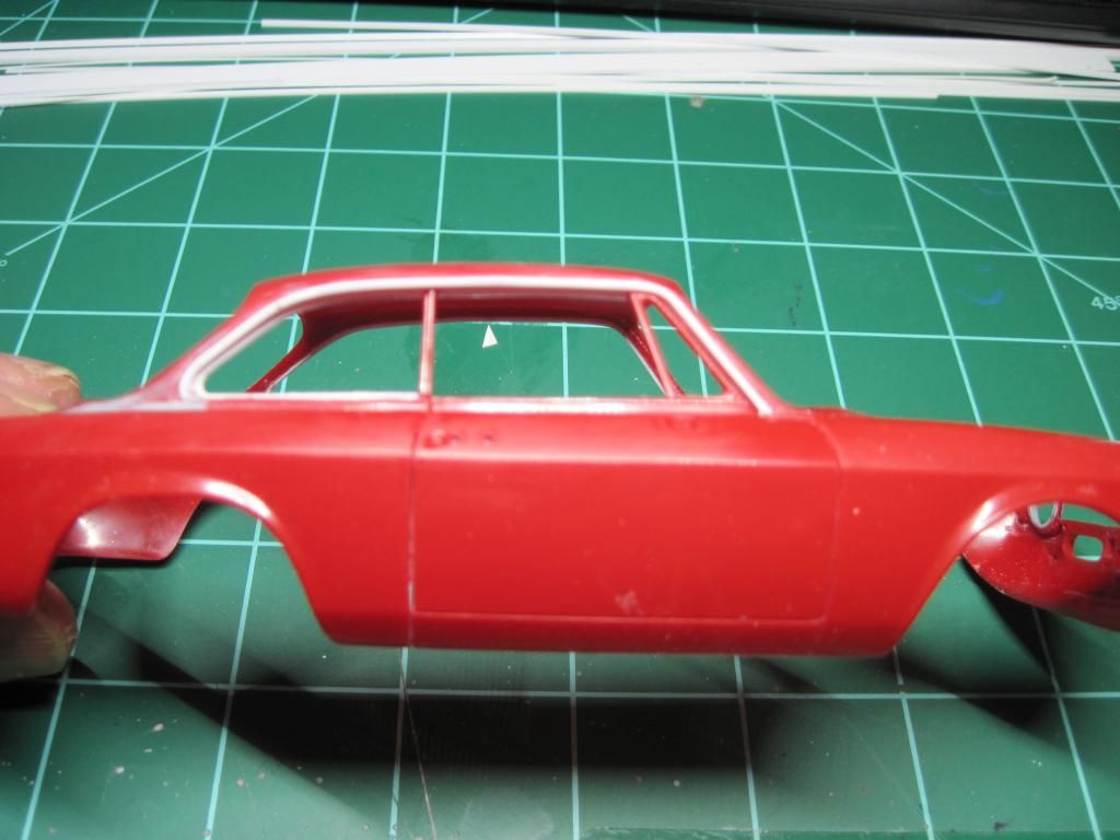

Attaching the base part of the passenger side rain gutter:

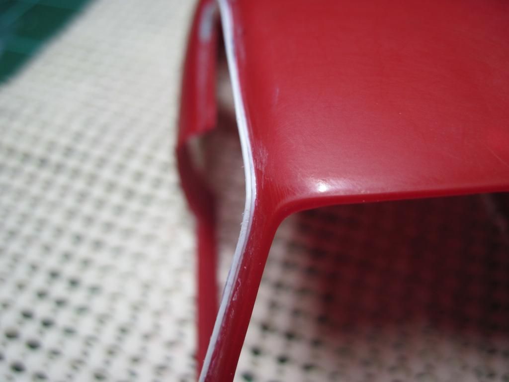

After the base part cured and got trimmed, it was time to glue on the .010 x .020 strip to complete the rain gutter:
Did a much cleaner job this time:

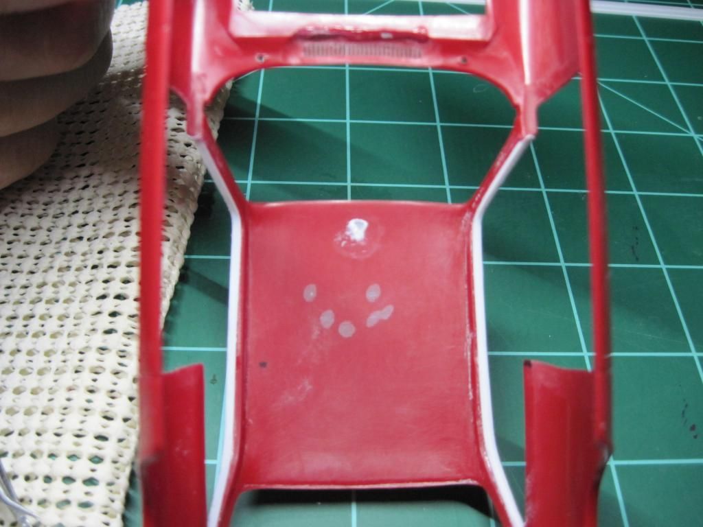

Also took the time to grind off the manufacturer's raised markings on the underside of the roof and filled in the rear view mirror mounting cavity:

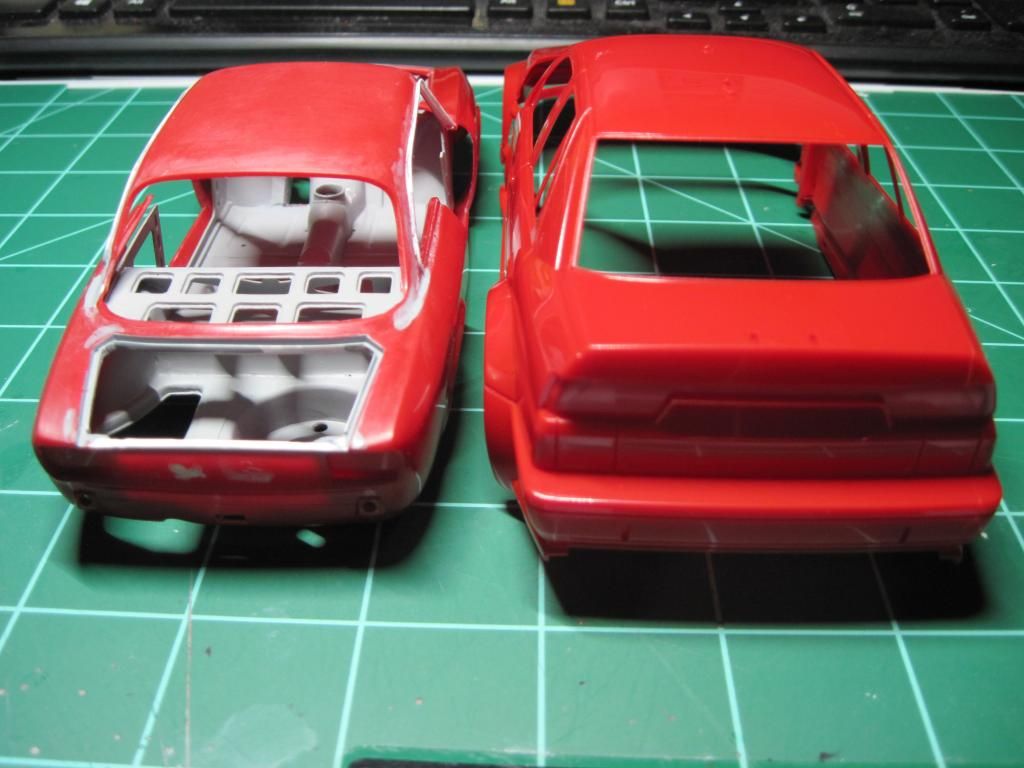

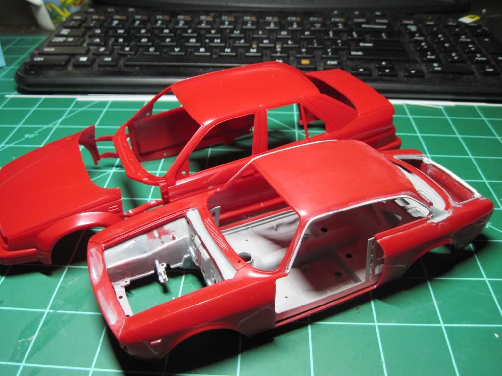

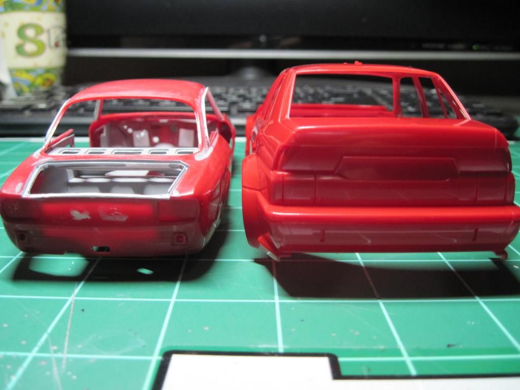

I forgot how dimunitive the full sized car actually is.... For fun, I broke out the body for my 155 V6 TI (same manufacturer, same scale):

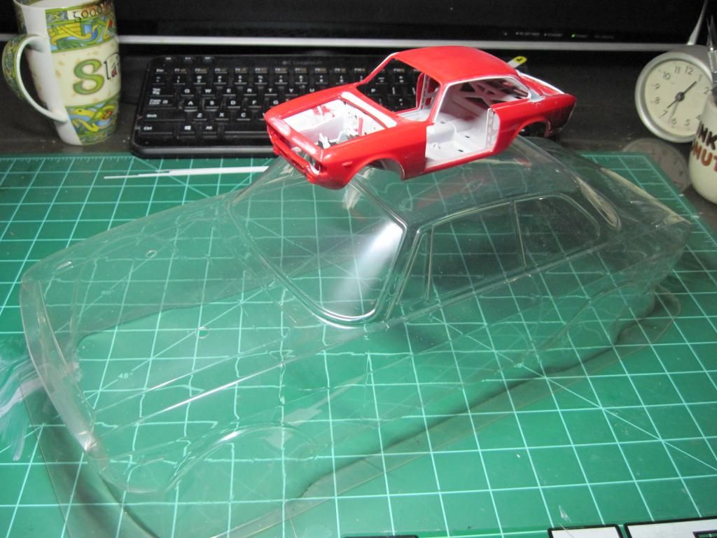

For bigger laughs, here's the project car sitting atop an unpainted 1/10th scale Giulia GTA r/c bodyshell:

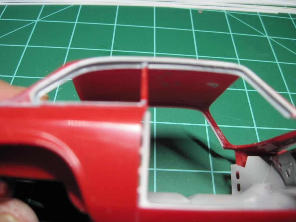

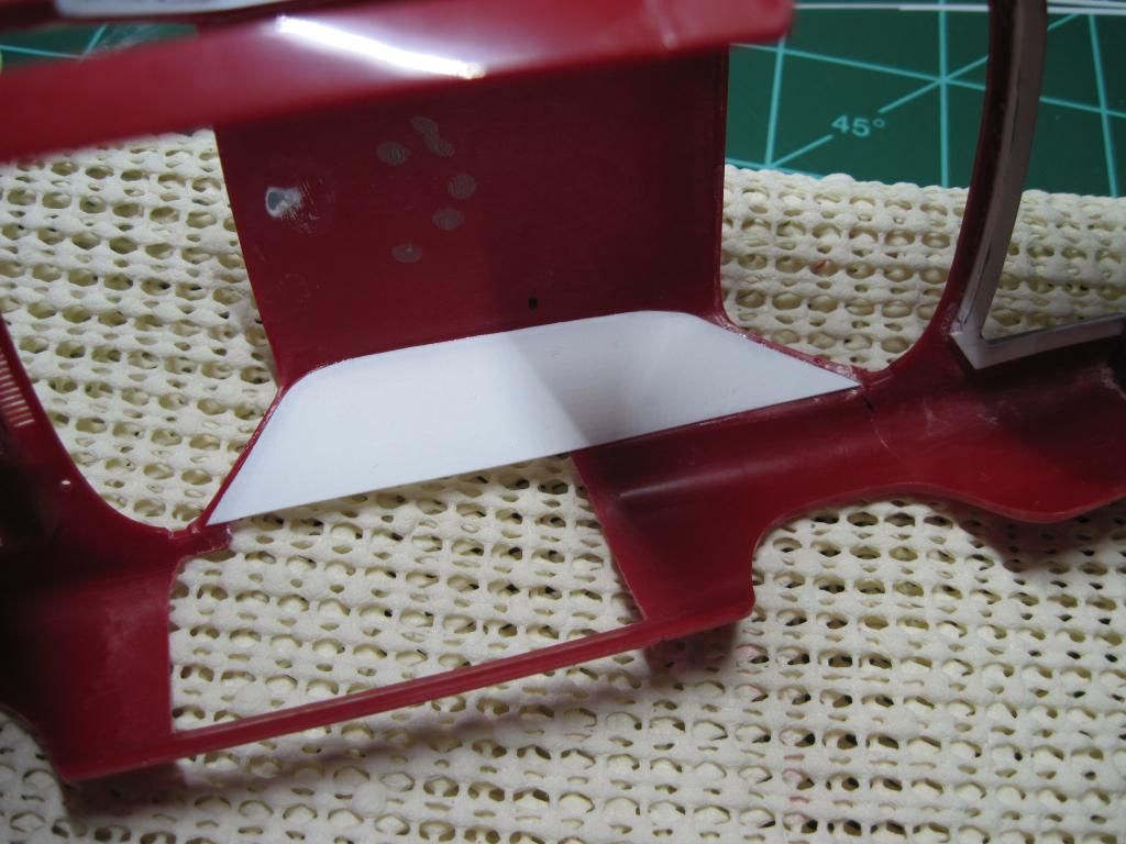

Side window structure using .010 styrene sheet:
Rough trimming:
Finshed trimming and re-installed the kit's "B" pillar. Popped the door in to check for any misalingment or warpage:
Brushed on some filler/primer to help blend things:

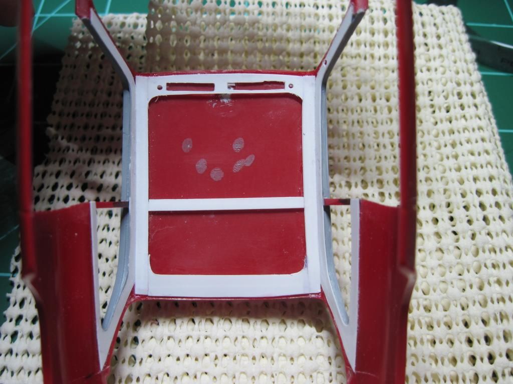

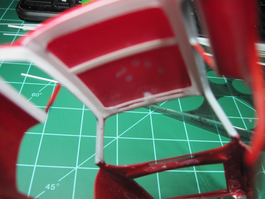

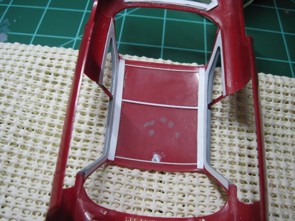

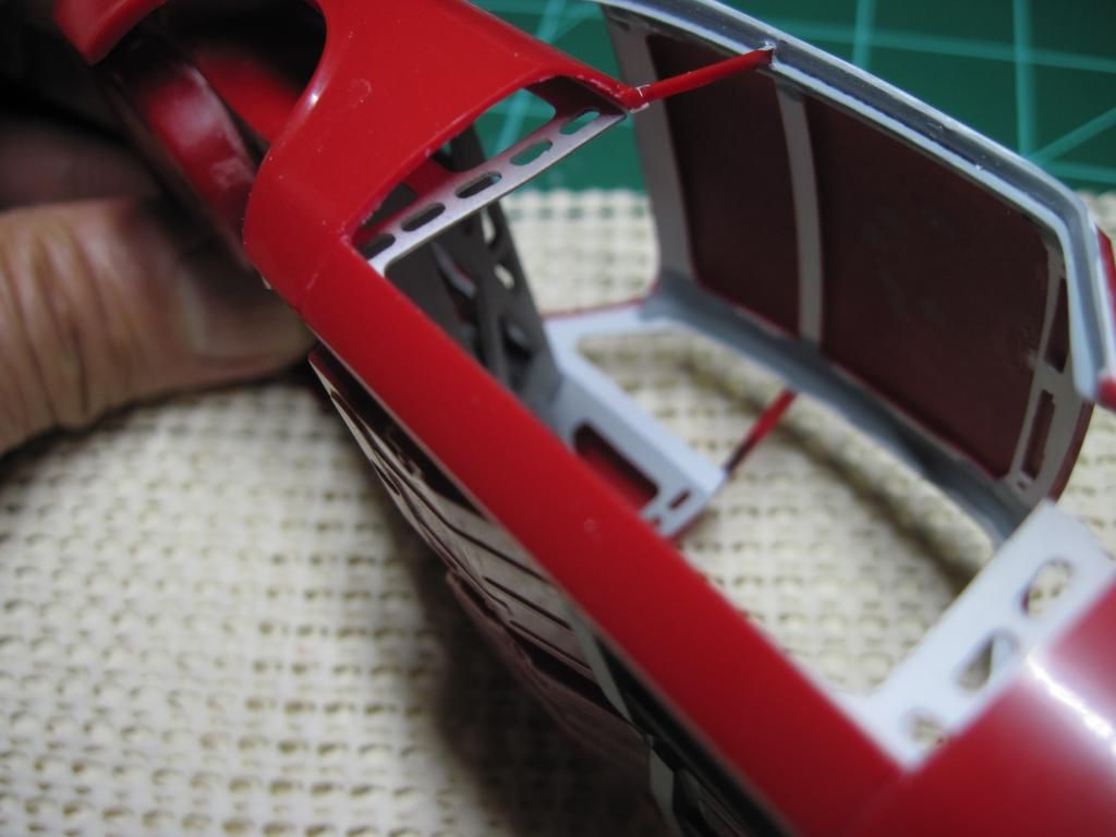

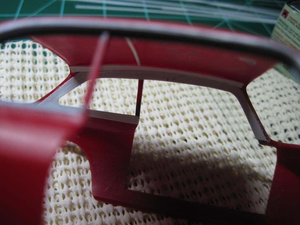

Started fabricating the roof structures. The .020 x .020 strips are to provide a gap between the fabricated stampings and the actual roof skin.
The cut-out is a little wonky but will be cleaned up later. Working with .010 thk sheet is a little tricky for me at this point and should have been photoetched for a crisper effect. Oh well, I work with what I have.
Proof of concept:
I need to let the cement and filler primer to cure before I sand and blend everthing together. Afterwhich a few more pieces to add and the roof will have been finished.
