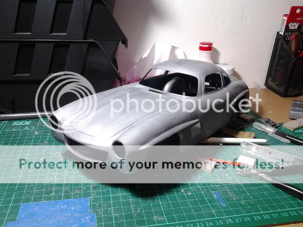

Cien1986 Posted April 29, 2014 Posted April 29, 2014 Hi all MCM friends I want to share my new project which is Monogram 1/12 Mercedes 300SL Gullwing the box can tell this is real old plastic model kit... i buy this kit from ebay and unfortunately this kit don't come with instruction manual when it shipped... but i manage to get the instruction manual from scalemotorcars friends DominiqueBeerts many thanks for the help... what i find when iam unboxing this kit is... the part organization is real mess... some part comes pre-cut from spruce it makes real difficult to identify the product... the molding is rough too.... but its usual problem with old injection kit ... then i try to snap fit the body, under panel, door, trunk and hood... and what surprise me... it not fit well... the door is like bending so there is a large gap between part.... the same condition apply to hood and other panel too..... so i preheat it with a candle and bend it slowly to achieve the shape that will fit... but on some place its not bendable.. the conclusion is this nightmare in car modelling... this is the picture of the kit when i try to snap fit it i use transparent tape to hold it in position and try to press it for minimal the gap this is the scale compare to my other model... after snap fit the kit i start working on trimming the front fender and lowererd the upper body part to make the kit fit properly, and then sanding the sink mark and mold line..... here is some progress on sanding

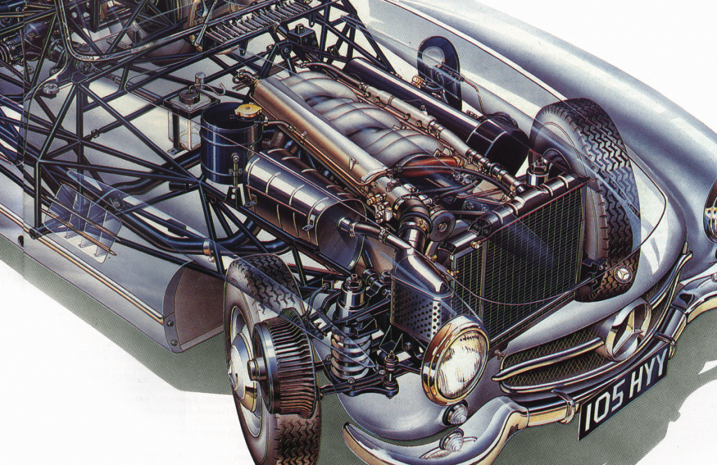

sjordan2 Posted May 2, 2014 Posted May 2, 2014 (edited) I just picked up one at the Desert scale classic in April....Mine also has no instruction sheet with it either...So I will be watching this thread to see how yours comes out. I think mine is a older release...not that that will make the fit any better.. FYI, the kit was originally issued by Renwal. The instructions that Henry is referring to can be found here... http://www.scalemotorcars.com/gallery/showgallery.php?cat=935 As you look at the instructions, you'll find one large error in the kit; they call for the water tank to be mounted to the radiator. This is wrong - it should be mounted just in front of the firewall on the passenger side. In the 1:1, it's attached to a portion of the spaceframe inside the right fender; since the kit doesn't replicate the spaceframe, other means will have to be improvised. Here's a closer look. Edited May 2, 2014 by sjordan2

sjordan2 Posted May 2, 2014 Posted May 2, 2014 (edited) Among the other errors and omissions, you'll notice that the shift lever is totally weird, The kit lever is snaky and should be totally straight in that position. I think the kit makers misunderstood that the first 50 Gullwings had a "gooseneck" shift lever mounted over the transmission under the dash, and coming back into the cockpit, but everything after that had a straight vertical shift lever on the tunnel. I would add that there is no particularly good Gullwing kit available. The best are in 1/16. The Minicraft version is the only one with a spaceframe, and the Italeri version has a more detailed engine and chrome parts, though the body shape needs work because the fenders are too bulbous and the doors don't fit well. It would be good to have both kits available as reference for the 1/12 build. Edited May 2, 2014 by sjordan2

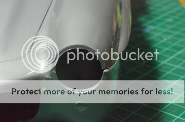

Cien1986 Posted May 3, 2014 Author Posted May 3, 2014 Here is some preview of the kit before i sand it you can see the door fit is teriible.. this is the fender

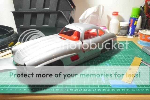

Cien1986 Posted May 3, 2014 Author Posted May 3, 2014 (edited) here is some progress that i made to the roof try to fit and sand it.. Edited May 3, 2014 by Cien1986

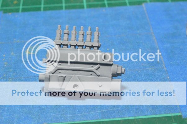

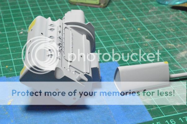

Cien1986 Posted May 3, 2014 Author Posted May 3, 2014 start to prime the engine and add putty to flatten the sink mark i usually light sand the part then prime it to have a clear view to the defect area...
sjordan2 Posted May 3, 2014 Posted May 3, 2014 When the engine is mounted, it tilts over to the left. The fuel injection system is virtually invisible at that point, and I wouldn't bother with it - especially adding the injector lines - (except to feel satisfied with knowing it's there). With the belly pan in place, especially since it's molded on, you can't even see it from the underside.
Cien1986 Posted May 4, 2014 Author Posted May 4, 2014 When the engine is mounted, it tilts over to the left. The fuel injection system is virtually invisible at that point, and I wouldn't bother with it - especially adding the injector lines - (except to feel satisfied with knowing it's there). With the belly pan in place, especially since it's molded on, you can't even see it from the underside. Yeah i just realize it too the engine tilt abit.. haha... at first i want to add injector line to it using thin brass line... but it seems it will stuck with steering shaft, because there is a cutting curve at the left side of the engine block near the fuel line for the shaft to pass through so i change my mind... its invincible no one can see it after assembly.,

Cien1986 Posted May 5, 2014 Author Posted May 5, 2014 Anyway, notwithstanding some carping, this tutorial on fixing the notorious body seam on the 1/8 XK-E may be helpful in fixing the fender seam on the Gullwing: http://www.modelcarsmag.com/forums/index.php?showtopic=64075 do you have a better idea how to fix the door? i bend it using candle light.....
sjordan2 Posted May 5, 2014 Posted May 5, 2014 do you have a better idea how to fix the door? i bend it using candle light..... I've never found a Gullwing kit with a particularly good door fit - most of these kits are decades old. You could try soaking the doors in hot water (not boiling). You could try a test fit with the interior door panels in place, which may affect the outer doors. Also, the door handle/lock actually works and closes the door in a slot in the door sill; (however, the parts are plastic and that might create a bit too much stress).
