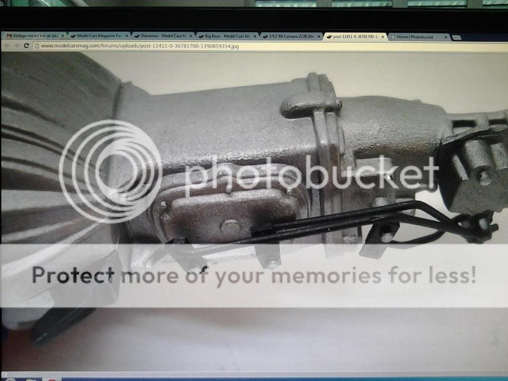

Cien1986 Posted May 3, 2014 Posted May 3, 2014 Dear MCM friends i really like the wrinkle effect on this painted engine.. i think this picture is from one of MCM member too, which i capture using phone cam.. i wonder how to do this paint effect.. anyone share the magic trick? thanks...
ImpalaBoy Posted May 3, 2014 Posted May 3, 2014 Seeing as how that's the transmission from my 1/12 '69 Camaro, I guess I might as well answer this There really is no paint effect there; it's just the molded texture of the plastic, which I assume is replicating sand casting. All I did was paint it with Testor's aluminum enamel. I realize this doesn't exactly answer your question, as this is just the case with this particular kit. However, there are tricks and special types of paint that I'm sure other members, more experienced than myself, can tell you about.
Ace-Garageguy Posted May 3, 2014 Posted May 3, 2014 You can achieve similar effects by shooting a fast-drying paint or primer, like lacquer, from farther away that you usually would. What you're trying to get is an exaggerated "orange-peel" texture. It takes experimentation to get just the right look you're after, and sometimes you may have to shoot a dry, pebbly primer, sand off just a little of the tops of the bumps, and then spray a flow-coat of enamel to get something that looks exactly like what's pictured.

Cien1986 Posted May 3, 2014 Author Posted May 3, 2014 On 5/3/2014 at 5:03 PM, ImpalaBoy said: Seeing as how that's the transmission from my 1/12 '69 Camaro, I guess I might as well answer this There really is no paint effect there; it's just the molded texture of the plastic, which I assume is replicating sand casting. All I did was paint it with Testor's aluminum enamel. I realize this doesn't exactly answer your question, as this is just the case with this particular kit. However, there are tricks and special types of paint that I'm sure other members, more experienced than myself, can tell you about. Yeah i know its from mcm member but dont remember which one hahaha... by the way its real great job there

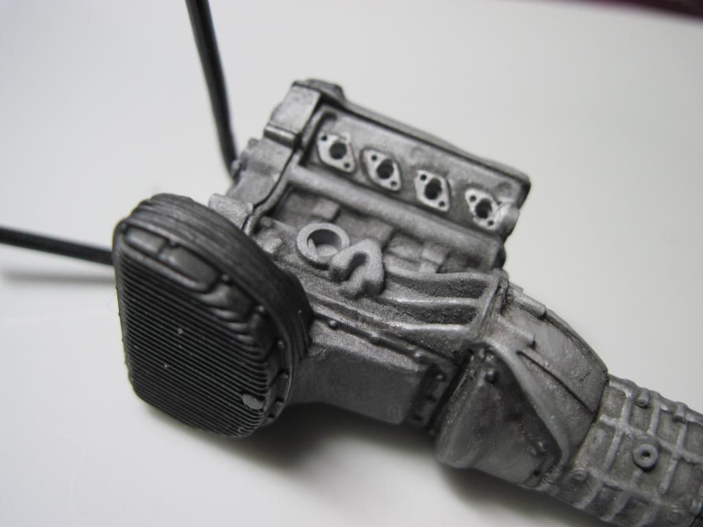

mikevillena Posted May 4, 2014 Posted May 4, 2014 (edited) When replicating a rough cast texture I use a technique that I learned 30 years ago from an AVF (armoured fighting vehicle) modeller who uses this technique a lot on 1/35th scale cast tank turrets.... I apply a liberal wash of slow evaporating liquid cement (Testor's Liquid) over the surface and then I use a small brass bristle brush and rapidly tap the softened plastic. Takes a bit of practice to get the feel for this so grab some scrap plastic and practice. If there is too much texture, I carefully brush on another thin coat of the liquid cement to knock down the peaks a little. Hope this helps. Edited May 4, 2014 by mikevillena

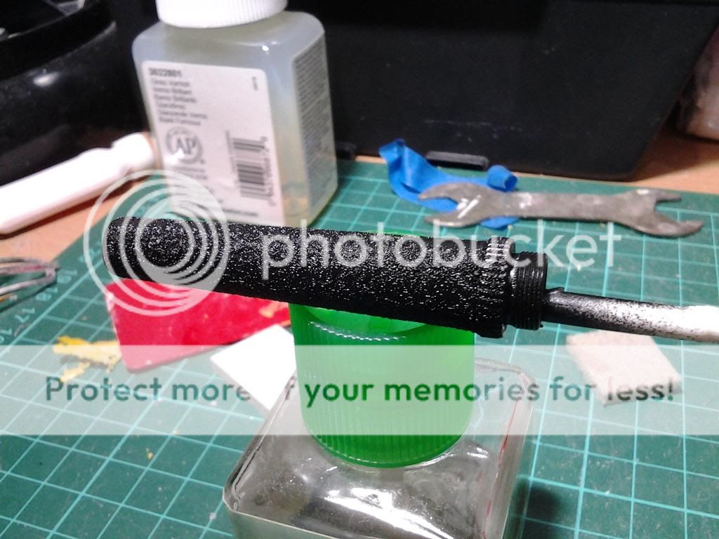

Cien1986 Posted May 5, 2014 Author Posted May 5, 2014 found this on ace hardware Special creating wrinkle effect on engine head cover I believe it will work well now the problem is... will the wrinkle scale enough... so i spray on small test part... will update soon...
soldier0829 Posted May 5, 2014 Posted May 5, 2014 On 5/4/2014 at 4:02 PM, mikevillena said: When replicating a rough cast texture I use a technique that I learned 30 years ago from an AVF (armoured fighting vehicle) modeller who uses this technique a lot on 1/35th scale cast tank turrets.... I apply a liberal wash of slow evaporating liquid cement (Testor's Liquid) over the surface and then I use a small brass bristle brush and rapidly tap the softened plastic. Takes a bit of practice to get the feel for this so grab some scrap plastic and practice. If there is too much texture, I carefully brush on another thin coat of the liquid cement to knock down the peaks a little. Hope this helps. This is the technique I use as well. I think I got the idea from a Verlinden book.
Cato Posted May 5, 2014 Posted May 5, 2014 On 5/5/2014 at 1:49 PM, Cien1986 said: found this on ace hardware Special creating wrinkle effect on engine head cover I believe it will work well now the problem is... will the wrinkle scale enough... so i spray on small test part... will update soon... Most of the wrinkle and high heat coatings rely on 1:1 engine heat to 'activate' them. May not work on plastic models. Test on spoons first.
Cien1986 Posted May 6, 2014 Author Posted May 6, 2014 On 5/4/2014 at 4:02 PM, mikevillena said: When replicating a rough cast texture I use a technique that I learned 30 years ago from an AVF (armoured fighting vehicle) modeller who uses this technique a lot on 1/35th scale cast tank turrets.... I apply a liberal wash of slow evaporating liquid cement (Testor's Liquid) over the surface and then I use a small brass bristle brush and rapidly tap the softened plastic. Takes a bit of practice to get the feel for this so grab some scrap plastic and practice. If there is too much texture, I carefully brush on another thin coat of the liquid cement to knock down the peaks a little. Hope this helps. Is this magic means we use slow dry cement to soften the plastic then use brush to add texture on it? many thanks for sharing

Cien1986 Posted May 13, 2014 Author Posted May 13, 2014 Here is what i get from spraying to the end part of penbrush.... and it takes quite long to air dry it... maybe it will dry faster when we heat it up abit with hair dryer but not too hot...
mikevillena Posted May 15, 2014 Posted May 15, 2014 What you have is a great example of "wrinkle" texture. I've used the VHT Wrinkle paint before on the dashboard of an old Revell 1/24th scale Ferrari 250 GTO. It took almost a week to cure fully. It looked okay but the texture was slightly too large for the scale. It might work okay if you are trying to replicate rustproofing on the underside of a road car. Otherwise you should try ModelSport's spray. For replicating "cast" texture, you need to experiment with other techniques. Sand cast texture is a lot finer. This is in 1/24th scale: You need to always keep the scale in mind otherwise it won't look right. Always check reference photos. You can find some here: https://www.google.com/search?q=cast+aluminum&source=lnms&tbm=isch&sa=X&ei=J9t0U_fKOIOtyASMvIKQDA&ved=0CAcQ_AUoAg&biw=1280&bih=662#q=cast+aluminum+engine&tbm=isch&facrc=_&imgdii=_&imgrc=r2CMYZGKhy40pM%253A%3BMYnI0SmmTqCfXM%3Bhttp%253A%252F%252Fwww.aftracingheads.com%252Fcylinder_head_repair%252Ffontana_cast_block%252FFontanaBlock012.JPG%3Bhttp%253A%252F%252Fwww.aftracingheads.com%252Fcylinder_head_repair_fontana_cast_block.html%3B1000%3B750
