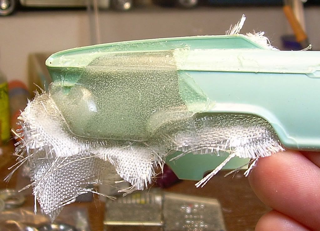

Ace-Garageguy Posted May 23, 2014 Posted May 23, 2014 First off, the 5-minute stuff has very little strength, though it is useful for attaching small parts and temporary work. As a filler with microballoon, 30-minute or longer epoxy gives good adhesion and ease of sanding, but you gotta be kinda careful with the mix ratios to get consistent results. You can use it as an extremely strong structural gap-filler by mixing a little cotton-flock (milled cotton fiber) into it. Decent (not 5-min) epoxy usually gives a stronger bond than CA, and it makes nice weld-fillets of you're doing any custom roll cage scratch-building. Along with everything else, I use it to make repair sections, molds, and reproduction parts. I made molds from the resin shell shown below, to replace missing areas on the old Johan body shell above it. Repair in progress... On the left is a mold made from the red body on the far right. A reproduction of the molded area is shown at center.
