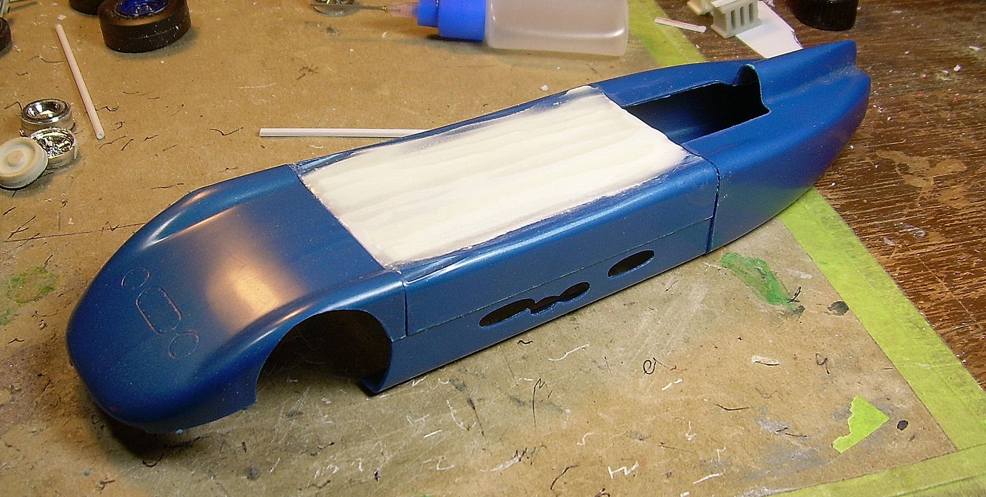

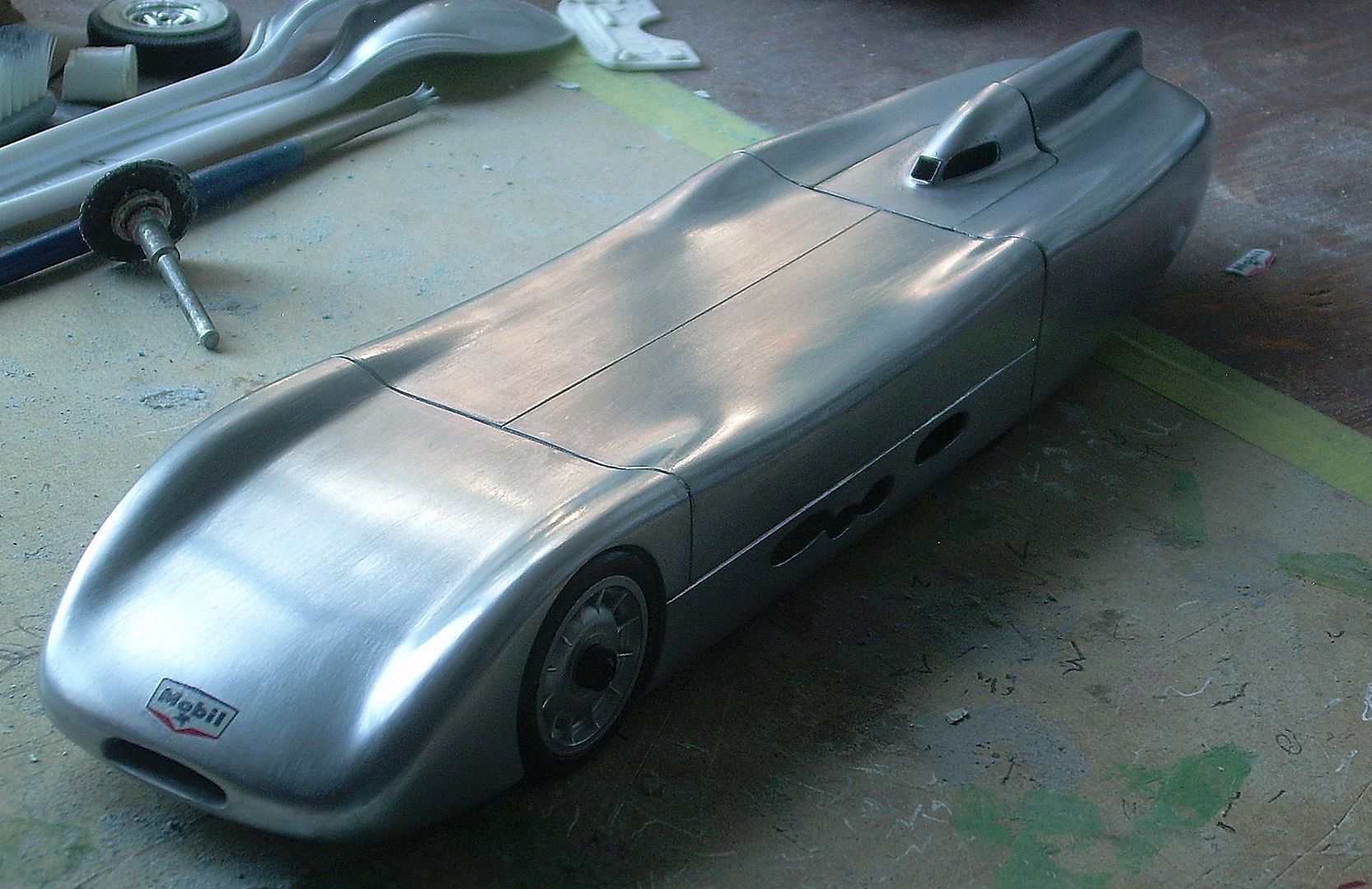

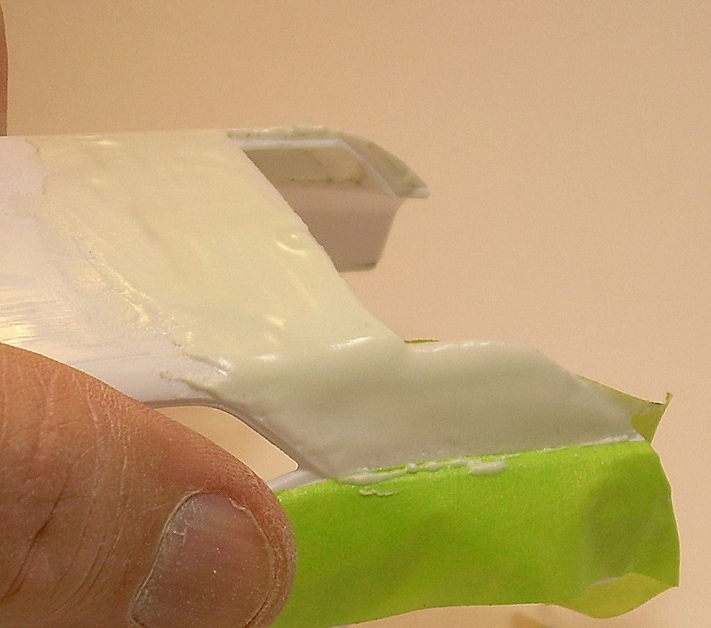

Ace-Garageguy Posted May 27, 2014 Posted May 27, 2014 (edited) These are thick fills done with epoxy / micro. Let's see you do this with super glue / baking soda, or just straight epoxy. It sands very well because it's relatively soft, but it also adheres to the substrate much better than bondo (but it takes longer to cure). It also doesn't shrink. A thin-bodied 2-part polyester filler like Bondo Professional glazing putty is helpful to put the final touches on the surface after the rough sculpture is done in epoxy / micro. The result, with a simulated bare-metal finish. Edited May 27, 2014 by Ace-Garageguy
