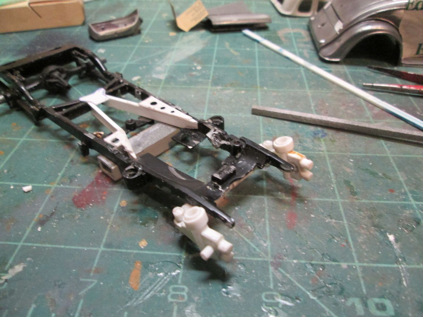

landman Posted October 5, 2014 Author Share Posted October 5, 2014 (edited) I didn't like the driver's side frame gusset, so I made another one. Drilled some holes in the suspension units for the king pins and the wheel support arms. Mocking it up I realized my crossmember is too short to allow the units to turn properly. Back to the drawing board.... Edited January 21, 2021 by landman Quote Link to comment Share on other sites More sharing options...
landman Posted October 5, 2014 Author Share Posted October 5, 2014 (edited) More work on the front suspension units. I find the wheel support arms too thick in the middle. Will have to whittle them down.....gingerly. At least you can see how it all goes together. Edited November 2, 2014 by landman Quote Link to comment Share on other sites More sharing options...

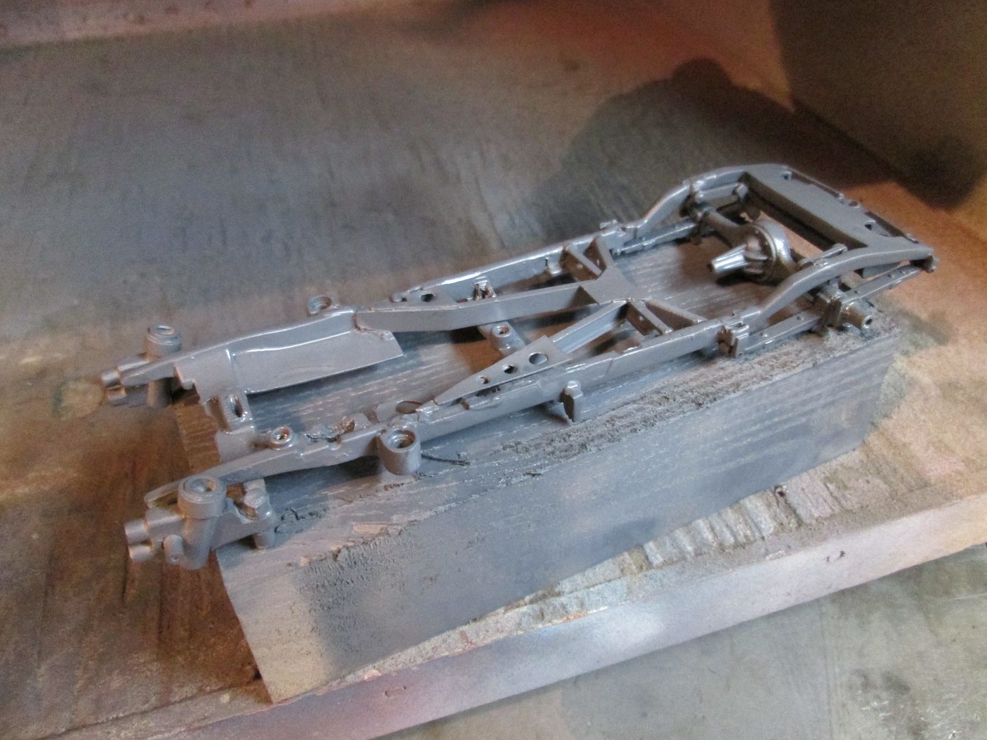

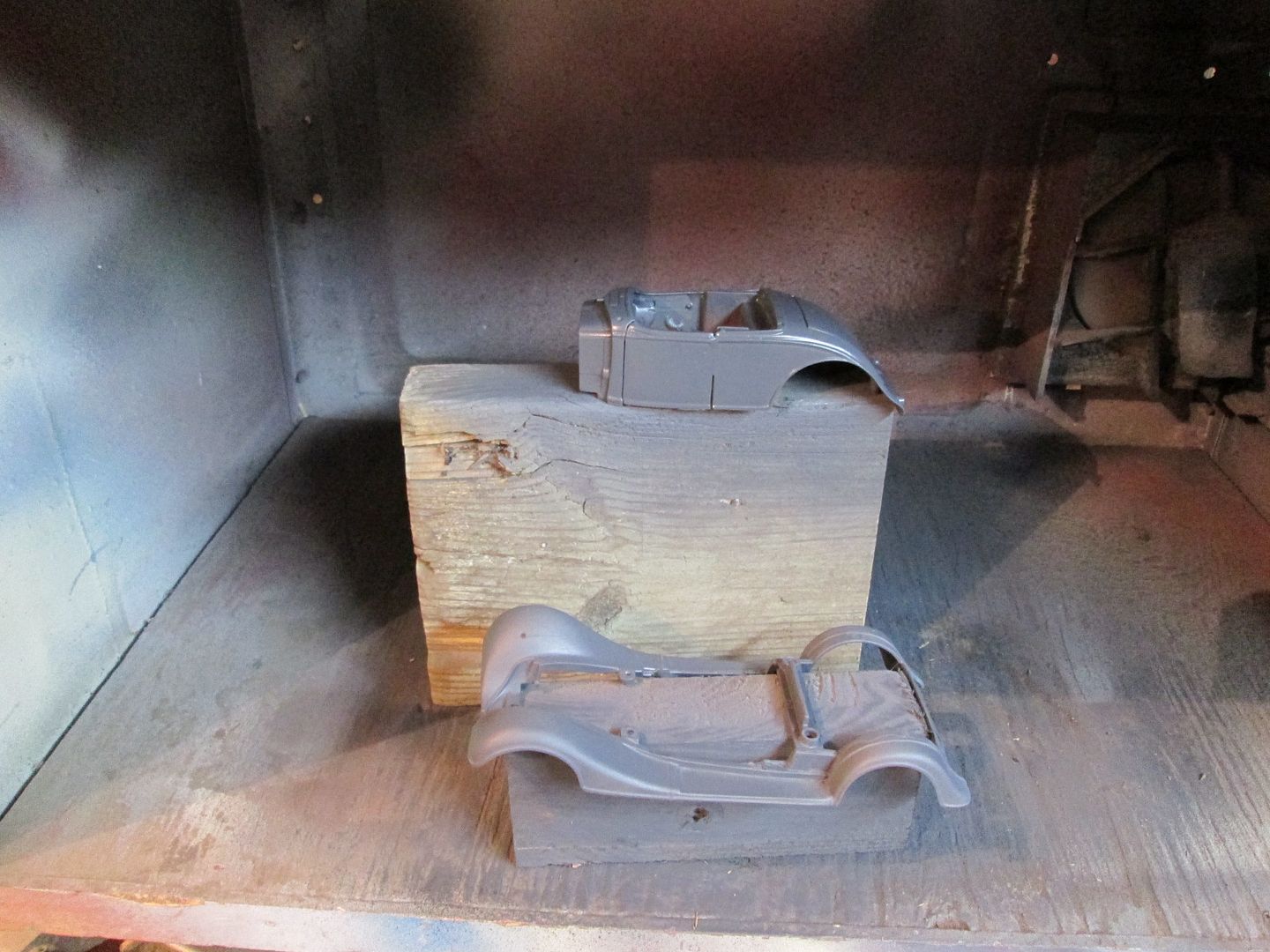

landman Posted October 7, 2014 Author Share Posted October 7, 2014 (edited) After a huge battle to create something that would allow poseable steering, I just gave up and glued the front suspension units in place. I retrieved my state of the art spray booth from the attic and gave a first coat of primer to some of the parts. Edited November 2, 2014 by landman Quote Link to comment Share on other sites More sharing options...

rsxse240 Posted October 9, 2014 Share Posted October 9, 2014 That's one heckuva spray booth! Does it work well? Just curious because I was just planning on a range hood turned up on its back and some cheap paneling for top/sides and floor. I love your work so far. I wish I had the ambition to tackle such a task. Quote Link to comment Share on other sites More sharing options...
landman Posted October 9, 2014 Author Share Posted October 9, 2014 That's one heckuva spray booth! Does it work well? It's an old microwave oven. I have a fuzzy cotton batting taped behind the fan. In theory it is supposed to catch the overspray. In practice, it does catch it but creates a blockage for the air and there is some blowback when using a spray can. Not as much when using an airbrush. Quote Link to comment Share on other sites More sharing options...

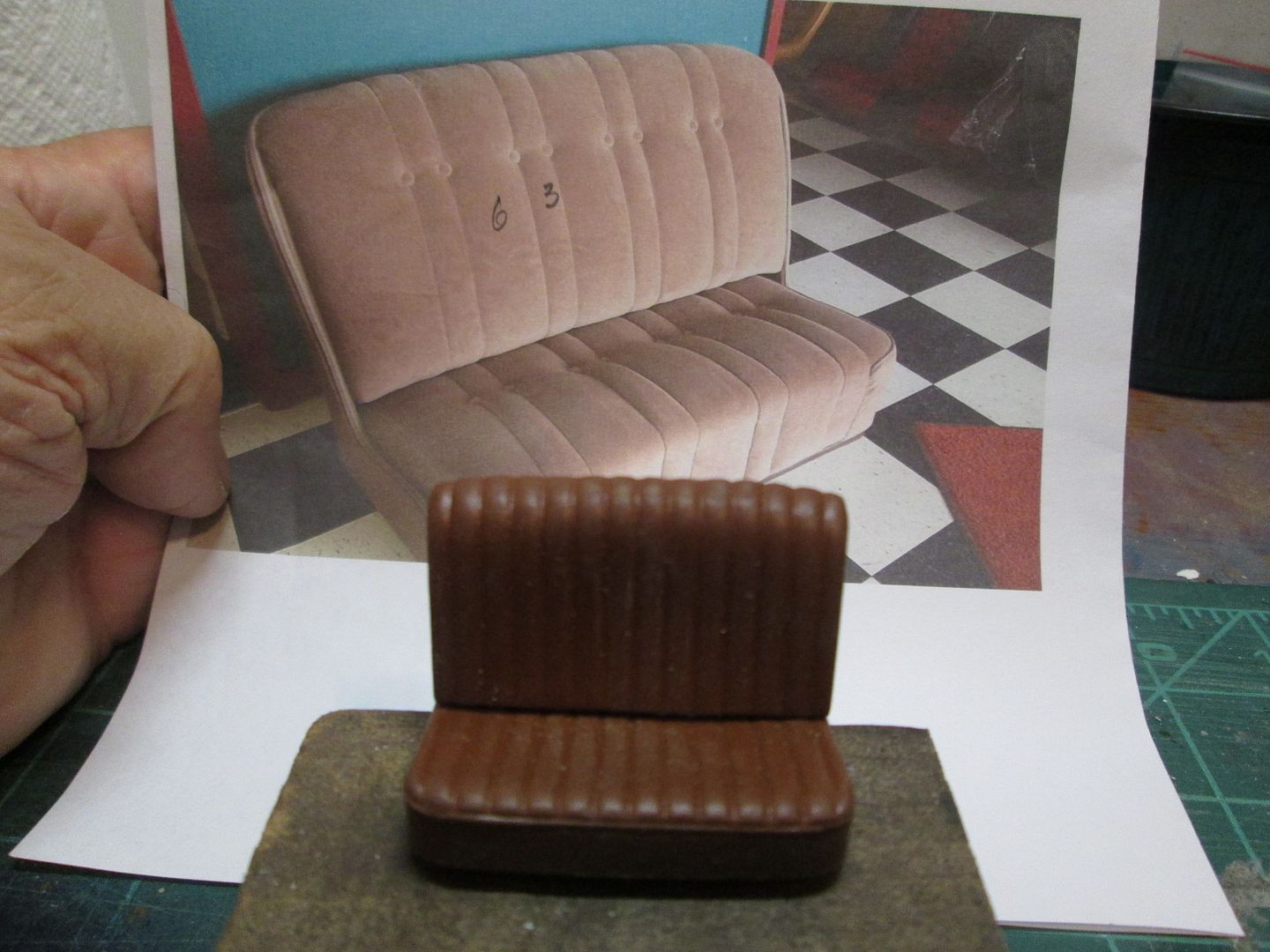

landman Posted October 19, 2014 Author Share Posted October 19, 2014 (edited) As a relief to the putty and sanding I took out the seat and compared it to the 1:1's. To approximate that look, I decided to fill some seams to create alternating narrow and wide pleats. Made a paper pattern of the Standard's dash surface and transferred it to styrene which I glued in place. A reduced photo of the Master dash will go there. Edited January 29, 2021 by landman Quote Link to comment Share on other sites More sharing options...
