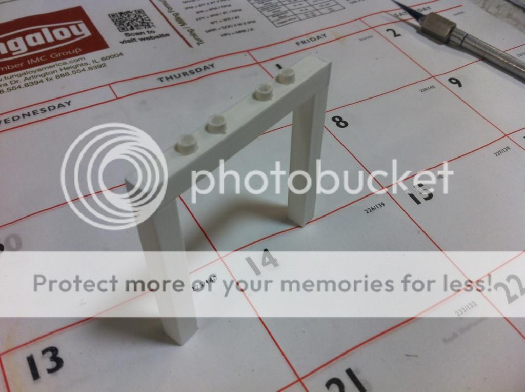

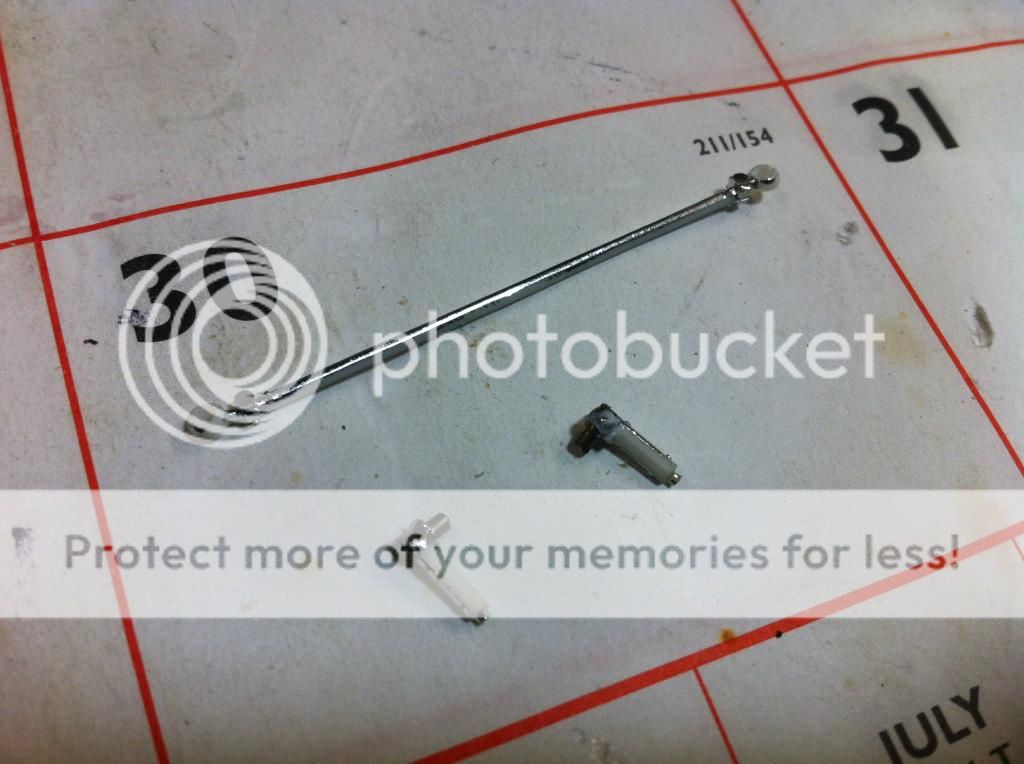

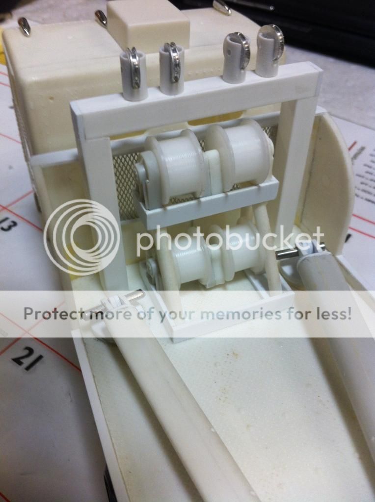

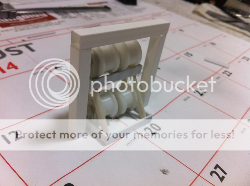

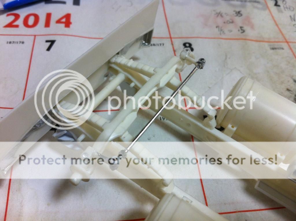

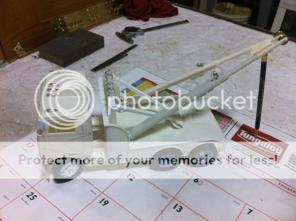

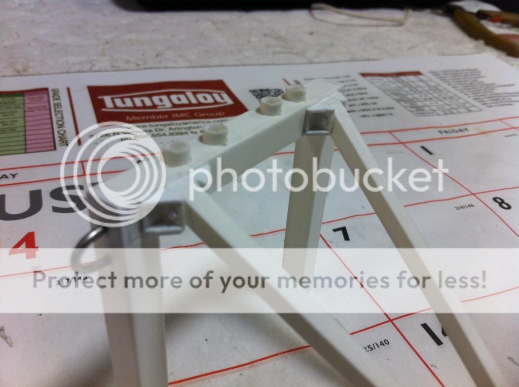

Superpeterbilt Posted July 17, 2014 Author Posted July 17, 2014 I got back on the cabover today. I started making the tower for the pulleys. I drilled and pinned the tie rods, mounted the brakes and air tanks and pre drilled the brake cans for air lines.
Petetrucker07 Posted July 17, 2014 Posted July 17, 2014 My goodness terry. Amazing work. Did you machine the cab lights?

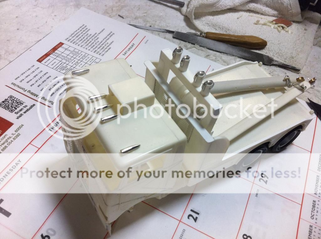

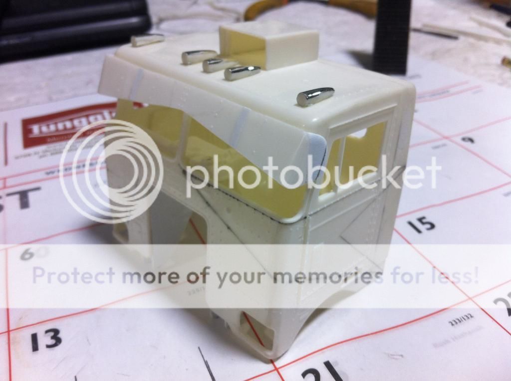

Superpeterbilt Posted July 18, 2014 Author Posted July 18, 2014 (edited) My goodness terry. Amazing work. Did you machine the cab lights?Thanks man, and no thats the chrome lights from the kit. Ive been in the habit of painting them with the cab because the flippin seam down the side makes the chrome unusable. I usually paint the mirror brackets for the same reason.I sand the seams and attach to the cab before paint. Edited July 18, 2014 by Superpeterbilt

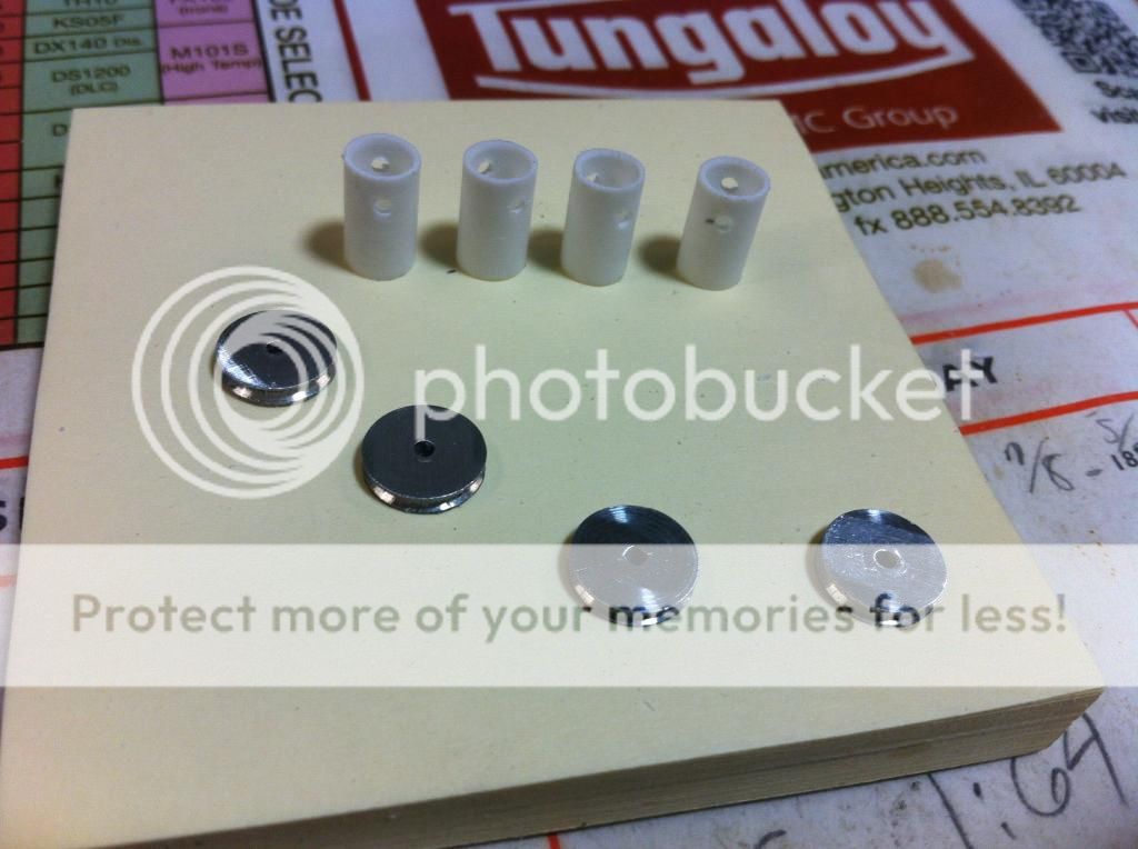

Petetrucker07 Posted July 18, 2014 Posted July 18, 2014 I hear ya on the seams. Besides being the size of the chips, the cab lights wouldnt be that hard to machine. Hhmmmmm...., maybe thatll be 1 of my 1st parts i make when i get a small lathe. This takin shape, lookin sharp, the pulleys look great. Are the pulleys a groove or a radius , hard to see in the pics
Superpeterbilt Posted July 18, 2014 Author Posted July 18, 2014 Its a V groove. I made them with a threading insert.

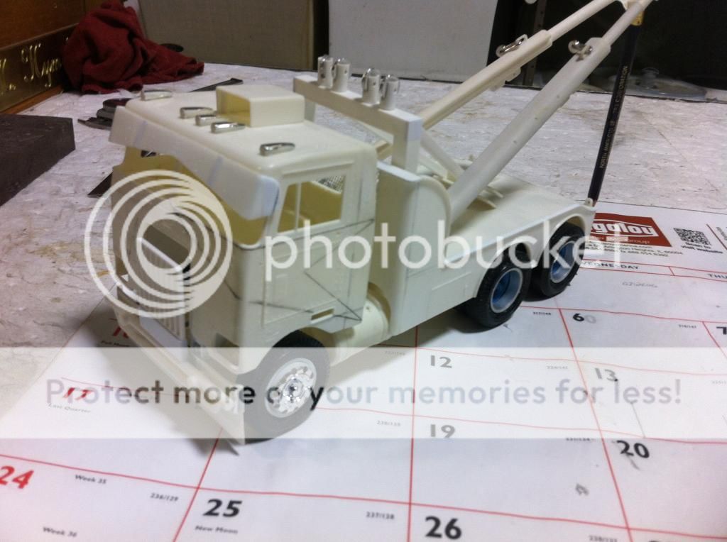

Superpeterbilt Posted July 18, 2014 Author Posted July 18, 2014 I modified the large Alcoa wheels from the big four kits. The big flaw with the steer rims is that the outer ring sits to far to the outside of the rim. The rim should protrude through the ring more. I locked my calipers to .075" and using the lip on the rim, I scribed a new line to file down the rim to allow the ring to sit lower. Here are the rims with the scribed lines. Using my trusty mill file, I filed the rim down and test fitted the ring further down. Then I cut the back lip off the rim and made a spacer from .060" styrene strip. Then I reglued the outer ring back on.

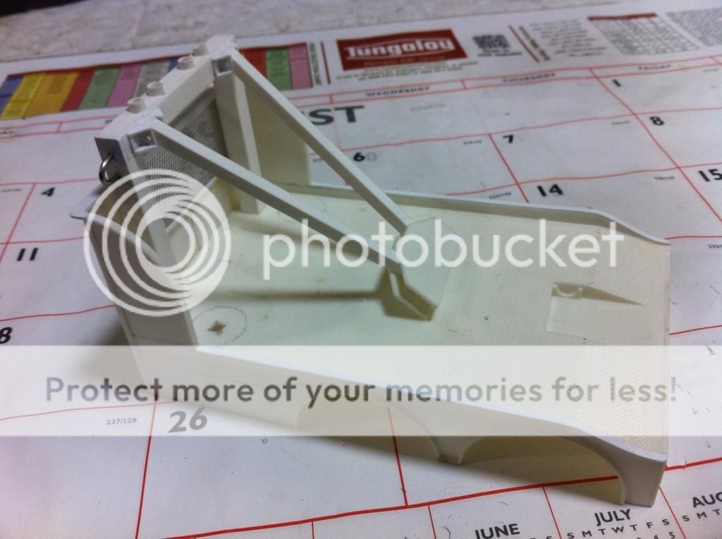

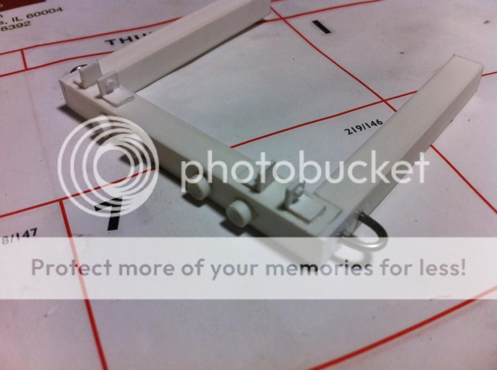

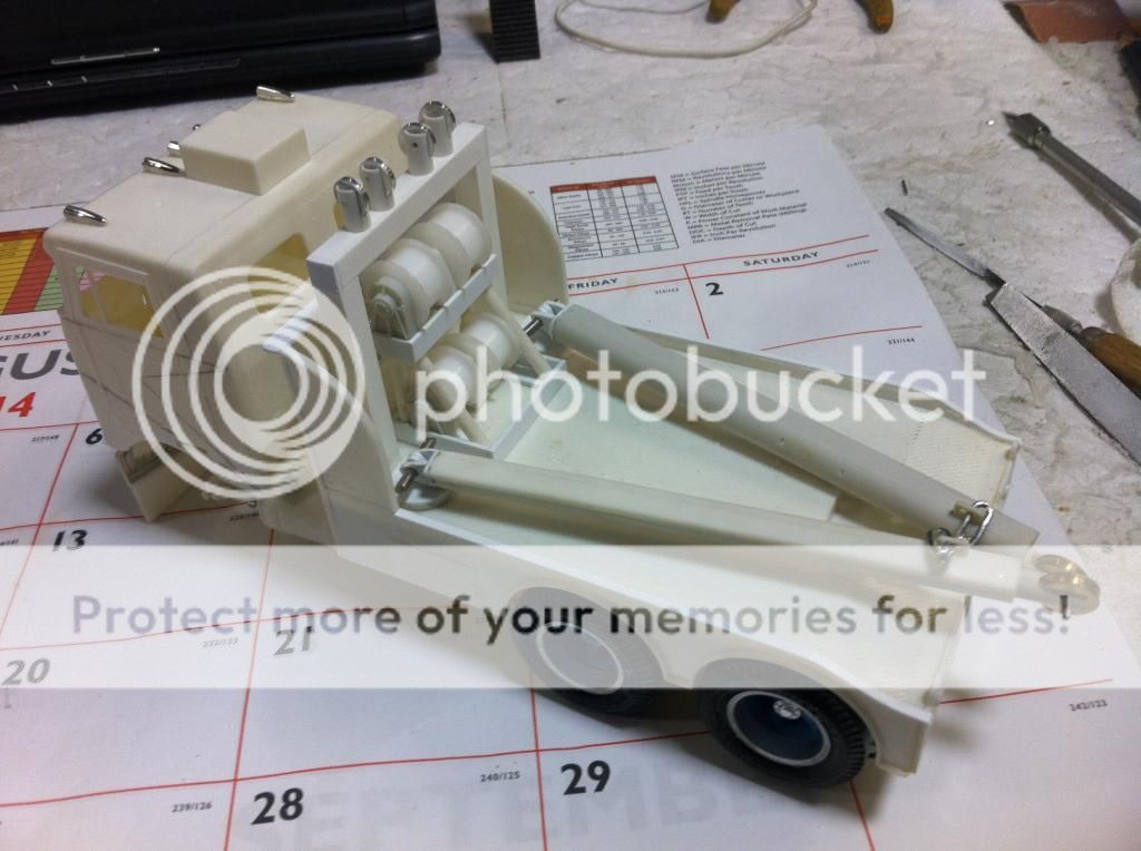

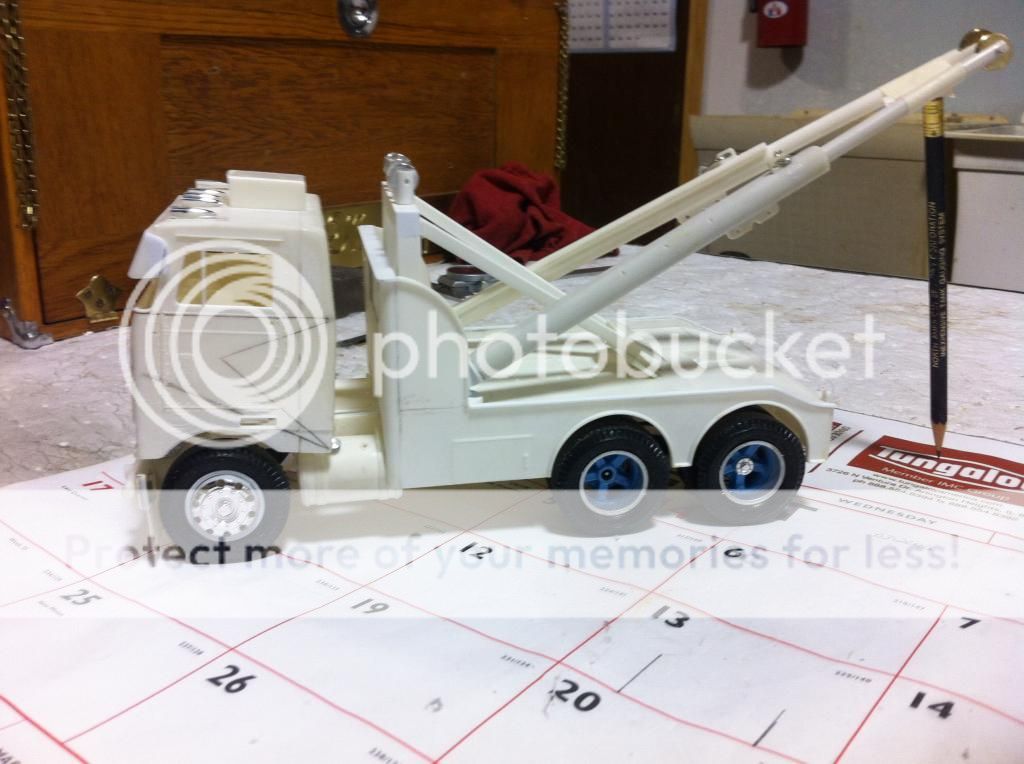

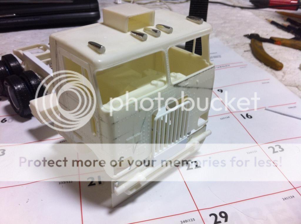

Superpeterbilt Posted July 18, 2014 Author Posted July 18, 2014 I discovered that the Autocar grill guard is the exact width of the 352 grill. Using the push bumper from the wrecker kit, I attached the grill guard and attached it to the bumper. I modified a Freightliner sunvisor by adding two .060" strips to the width, and .250" to the sides. After some file shaping, it was ready to install. I added a few braces to the winch tower, and thats all for now.
