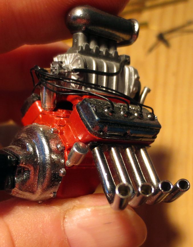

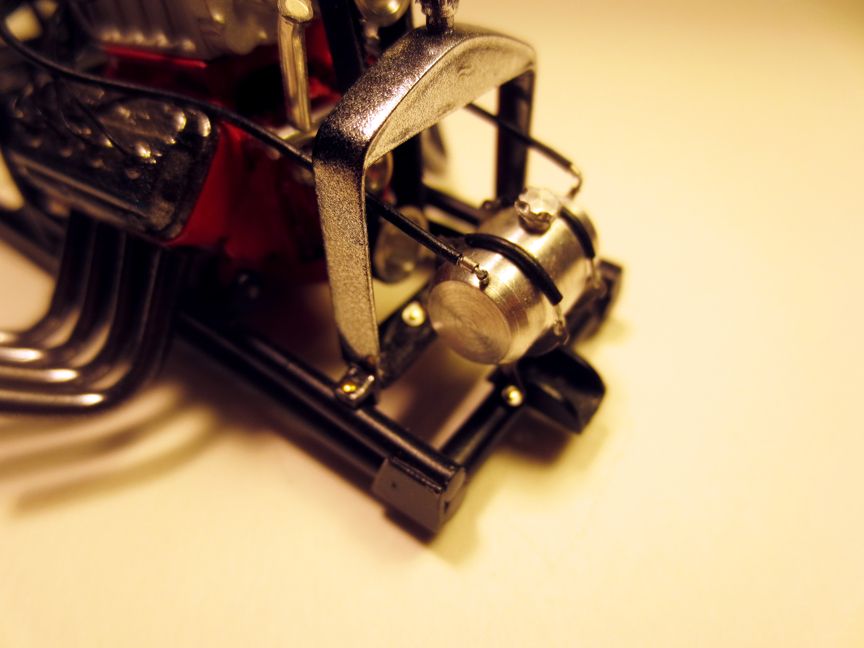

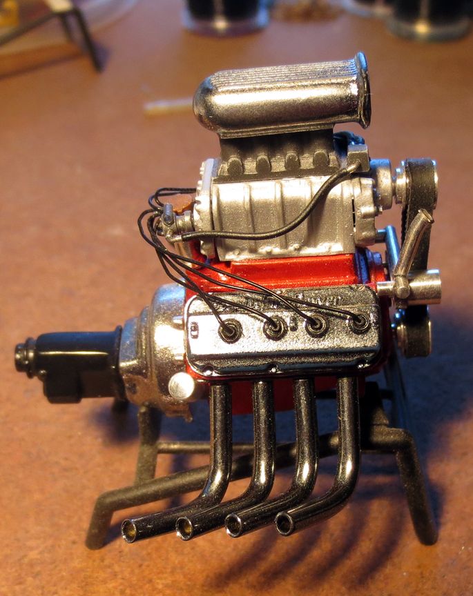

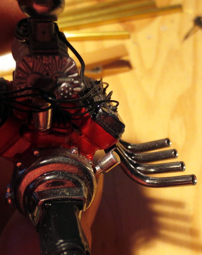

gasser59 Posted September 30, 2015 Author Posted September 30, 2015 OK...I know its not much of an update but for me, it is. Here's a few pics of the side mounted oil filter that I redid. Its all made of concentric aluminum tubing pieces and an aluminum rod for the center with the top ends polished. Much improved from the previous one.
John Teresi Posted September 30, 2015 Posted September 30, 2015 Brad......looking good......your getting pretty good with these engines
Art Laski Posted September 30, 2015 Posted September 30, 2015 Brad, The build is looking fantastic! Love the headers. The hard work you put inot those is really evident. Hope you feel better soon and can get back to the bench! Art

Mooneyzs Posted October 2, 2015 Posted October 2, 2015 Brad... That is some outstanding work on the oil filter. big fan of your work and enjoy seeing your updates. I am hoping that you are feeling better to be able to get some good bench time in this weekend.

10thumbs Posted October 3, 2015 Posted October 3, 2015 Hi Brad, the motor is shaping up nicely. Amazing to me every time, is how much a part in metal adds to the overall look. The headers for instance are really fine and compliment the 392 motor. Looking into those tubes just makes for a very realistic view, magneto and oil deal as well. Keep up the good work as lots of us enjoy your efforts.
Danno Posted October 4, 2015 Posted October 4, 2015 Brad! Wow! The engine is looking great and those headers are pure art! Glad you had a chance to get up to the San Juan & harass the trout. Sorry to hear you've been suffering. Nothing worse than pinched nerves and back pain. Good luck with the open.

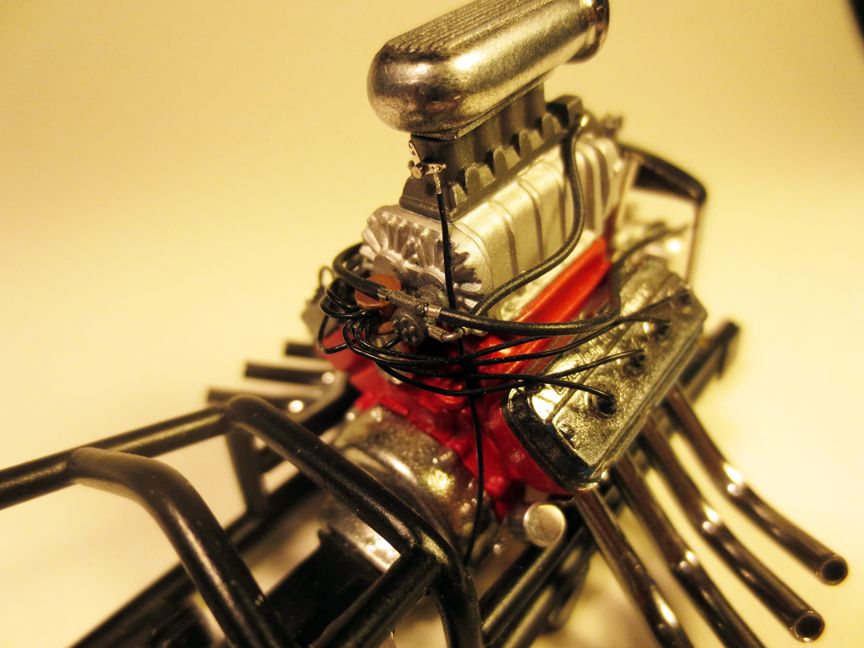

gasser59 Posted October 4, 2015 Author Posted October 4, 2015 Thanks Michael and Danno. A bit of bench time in yesterday and the motor is in, plumbing is done and currently working on the seat and belts along with the mounts. I'll post some pictures later today.

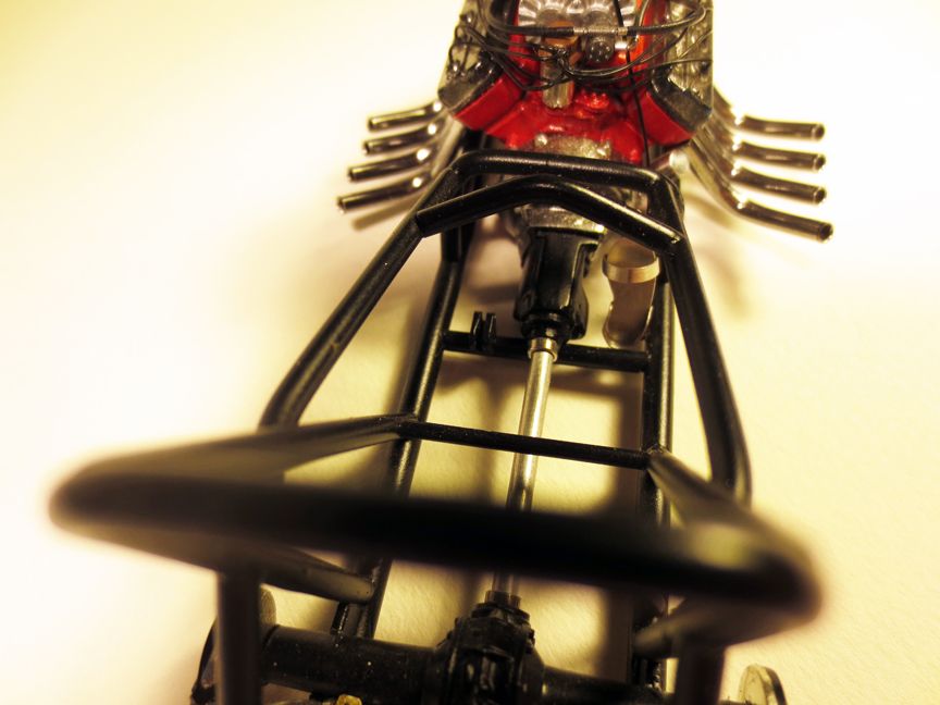

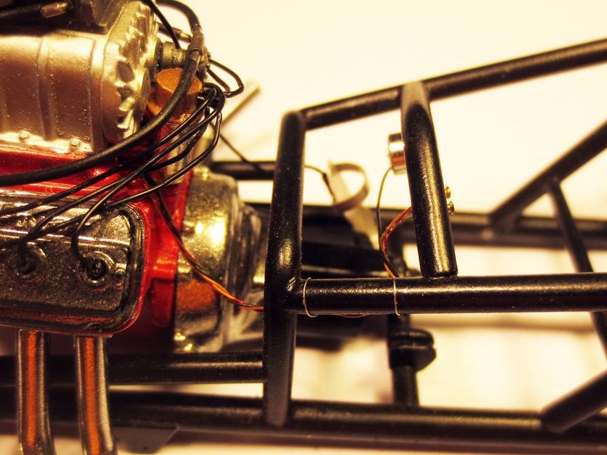

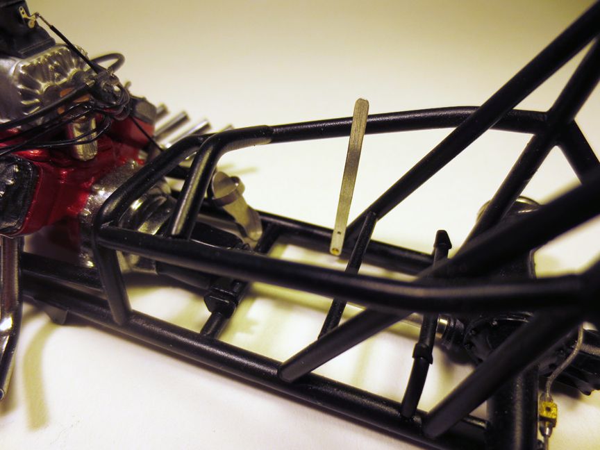

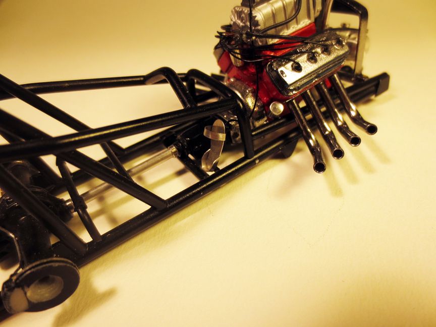

gasser59 Posted October 5, 2015 Author Posted October 5, 2015 Finally some concentrated bench time and a number of small things worked on and a few completed. First up is the gas pedal. I had made an extra when I build my Altered Ego project so all I had to do was mount it in place. As you can see, its made entirely from printing plate. I also wired up the linkage to the Holborn injectors. Still need to work on the return spring. Here's a couple of pictures. The first two show the pedal and the last one shows the linkage.

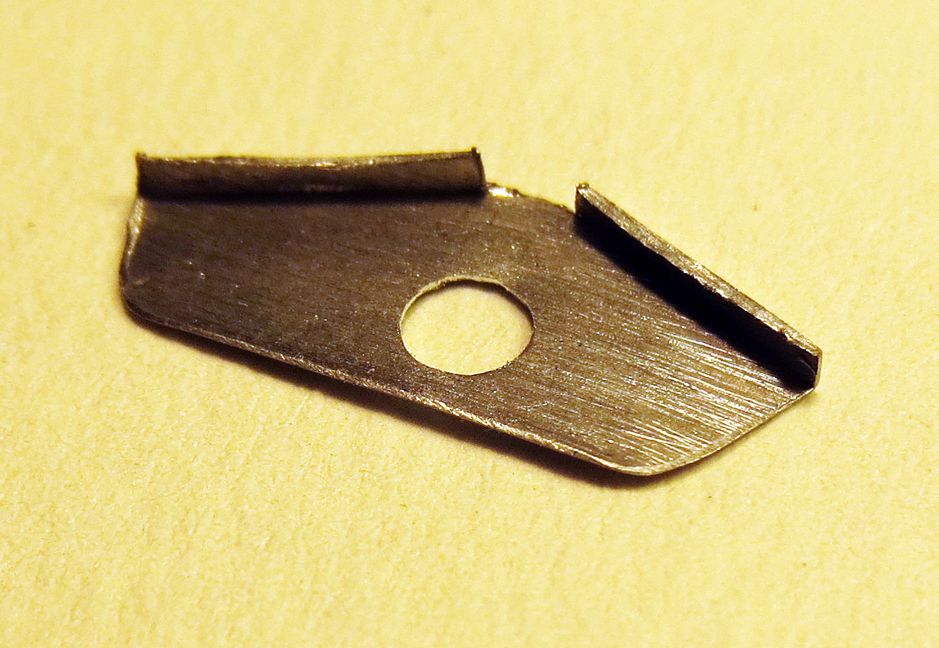

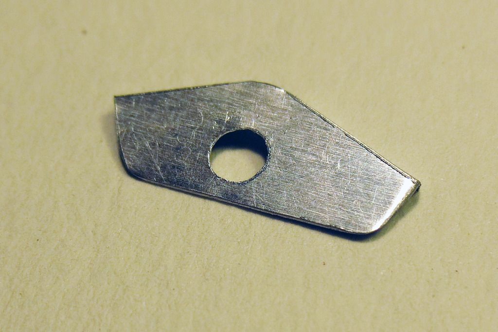

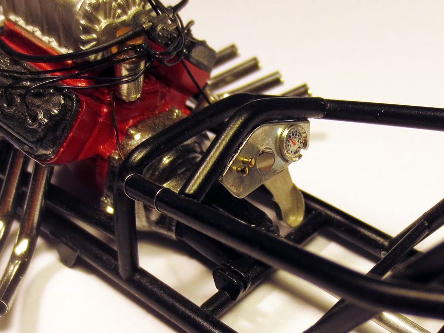

gasser59 Posted October 5, 2015 Author Posted October 5, 2015 (edited) And a few more progress pictures showing a few other items of interest. Since the engine is now mounted, I plumbed up the gas lines to the rear mounted fuel pump. Next up is the metal dash / bracket that will hold the steering box and tach. The center hole is for the steering box and the tach one is yet to be punched. Showing front and back. Tabs will be glued to the underside of the frame crossbar. This will get some cleaning up and removing the burrs. And finally I built a handle for the right side of the cockpit from a heavier gauge printing plate. That's all for now. I was planning on working on the seat belt but I see they were grey in the original so I need to see if I can find a grey Sharpie. The work continues. Thanks for following along. Edited October 5, 2015 by gasser59
John Teresi Posted October 5, 2015 Posted October 5, 2015 Brad......Dang buddy that looks killer......really really cool
Mooneyzs Posted October 5, 2015 Posted October 5, 2015 Brad... What an awesome update buddy. Man I am totally digging that gas pedal. It looks killer. Nice job on all of your other little details, its setting this one off really good.

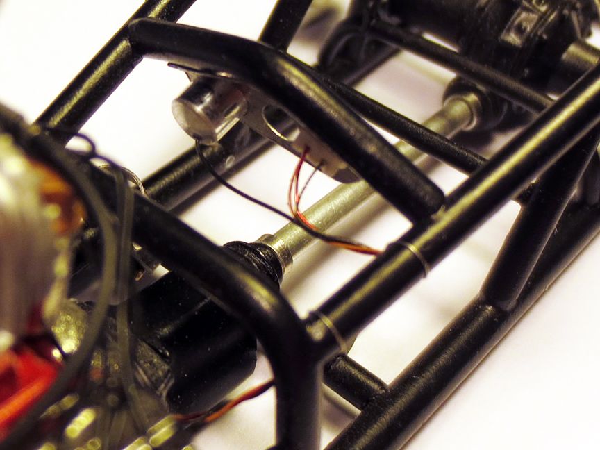

gasser59 Posted October 7, 2015 Author Posted October 7, 2015 (edited) Last night was spent on getting the dash complete and installed. On the right side is a '60s style tach from Detail Master. The left side has a couple of switches and all of these are twisted together and wired to the rear of the engine. The steering box is painted with metalizer and ready for install tonight. More tonight. Thanks fellas. Edited October 7, 2015 by gasser59
10thumbs Posted October 7, 2015 Posted October 7, 2015 Brad that looks really fine! Great looking scale sized too. I like!
gasser59 Posted October 7, 2015 Author Posted October 7, 2015 Thanks Michael. I'm not sure I've mentioned this to you before but I use a lot of really small wires that are intended for tying up flies for fishing. They come in a variety of colors and thicknesses and are fairly readily available. I would think you'd be able to source some locally over there, the birth of flyfishing.
