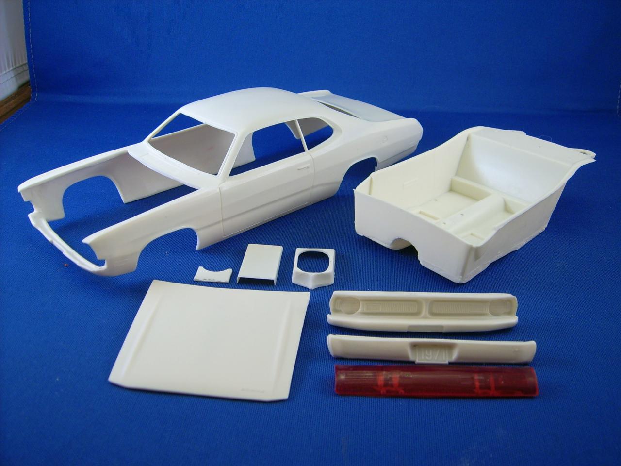

A while back, I bought a resin Pro Stock Demon body. To make it clear, it is NOT the one pictured above. I don't know who did the one I've got, but it turned out to be a mess. The front wheel openings were unchanged, the rears lengthened (all towards the front, effectively shortening the wheelbase). A tubbed chassis was included, but nobody was narrowing the frame at the rear in '71. A casting of the gutted interior from the later Sox & Martin kit was included, but the master had the rear wall shifted forward to clear the wheel tubs. The hood casting was awful. Out of the whole thing, I've salvaged the bumpers (nice chrome), taillight panel, and front pan. I might be able to use parts of the interior bucket and chassis for something. I've got the front pan grafted to a '75 Dart body, and am pretty far along in (re)fitting the taillight panel. Ironically, the '75 front wheel openings are closer to what is needed for the Demon. I might see if I can scrounge a started LA Dart or Hemi Hunter kit, and cut the front wheel openings and hood from it. I bought a Modelhaus hood, but being a perfect copy of the MPC kit piece it's also too flat.
Guys this is a direct repop for good or worse , the front gravel pan was white glued in the car to make it more stable . That's all we were allowed to do to the car since the car was loaned to us and was a mint kit . I wish we could have made some changes but were couldn't . I think everyone will unstand that a mint that was not ours could be altered. we have save the first 3 pulls so later on after this mold goes bad I will be able to do some changes to the car before it gets remolded.
