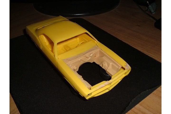

Bob Ellis Posted August 3, 2014 Posted August 3, 2014 Chrysler stopped selling convertibles in the end of the 1971 model year. At the time, Mannix was a very popular show and it featured a Cuda convertible. Chrysler still wanting to maintain a presence in the show, decided to update a 1971 Cuda with 1972 sheet metal. This car still exists. I used a ERTL MPC 1974 Cuda promo, and a ERTL AMT 70 Dodge Challenger. I could have used a Revell Don Johnson Cuda if it was 1/25. But I used it as a guide.

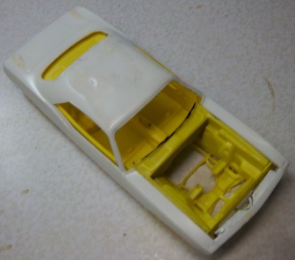

Bob Ellis Posted August 3, 2014 Author Posted August 3, 2014 Here the roof is cut off, hood from Revell Cuda, and sitting on a '70 Challenger chassis

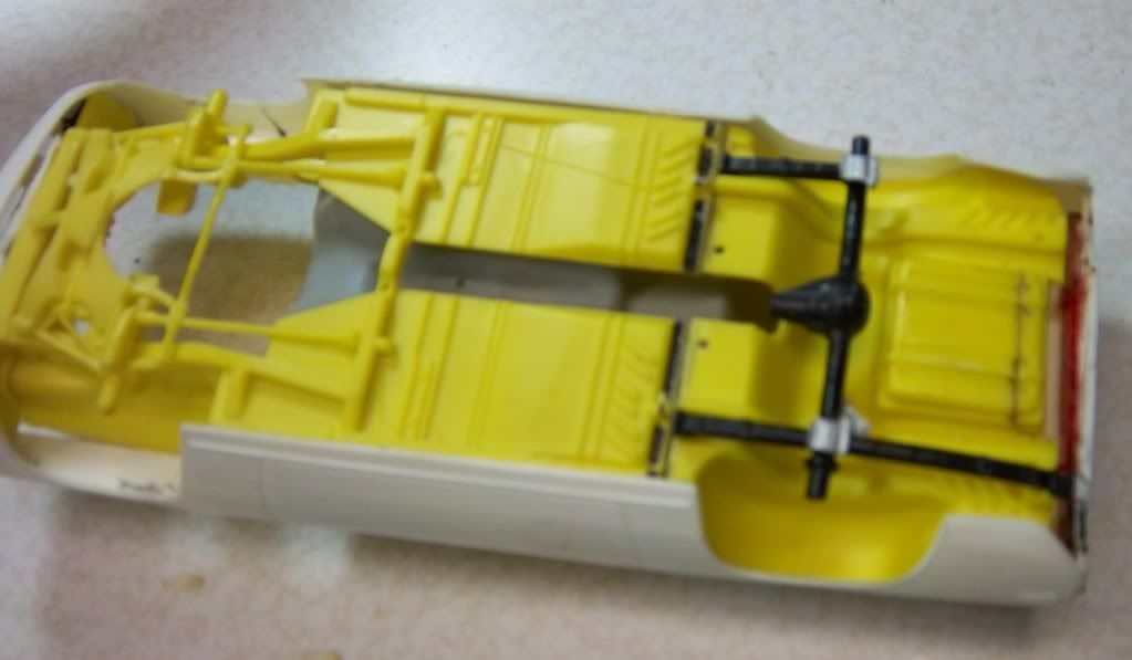

Bob Ellis Posted August 3, 2014 Author Posted August 3, 2014 (edited) When you make up your own models out of 2 or 3 kits, you find things don't fit. I spend a lot of time trying to get things to blend. The MPC Cuda kit and the AMT Challenger kit are fighting each other. But, I am winning as you can see here. Edited August 3, 2014 by Bob Ellis

kelson Posted August 5, 2014 Posted August 5, 2014 Nice work so far,why didn't you use the chassis from the new 70 cuda?if I remember correctly the challenger has a longer wheelbase than the cuda so the chassis is longer.
Bob Ellis Posted August 5, 2014 Author Posted August 5, 2014 (edited) I had a left over parts kit '70 Challenger, and a built up junk '70 Challenger. I have a feeling that even if I used the new Revell, fit issues woul hve ocurred since I needed to use the MPC '74 body. A Revell would be a great place to start '70 Cuda convertible. Not sure if Mannix had a '70 (think he had a '71). He had a '68 Dart convertible customized by Barris. Edited August 5, 2014 by Bob Ellis
ChrisPflug Posted August 6, 2014 Posted August 6, 2014 I put the AMT Challenger chassis under an old '72 MPC 'cuda annual- ended up shortening the wheelbase by taking a small section out of the rear seat floor pan area. Also had to shorten the gas tank and modified the back of the grille opening and cowl to finally get a decent fit
Bob Ellis Posted August 6, 2014 Author Posted August 6, 2014 Chris, I cut part of the chassis too. I failed to mention that, so it's good you did. The AMT chassis is not a drop in with a MPC body. I cut the chassis a little different, but the end result similar. The MPC 72 grille is a little tight in front where the chassis / radiator meets. Even if you build a hardtop, the model looks way better with a chassis up grade. I am curious what the Revell result would be. I used the AMT because they were incomplete kits and cost less. Maybe the result not as good as Revell, just don't know yet.

Bob Ellis Posted August 9, 2014 Author Posted August 9, 2014 (edited) I am taking the advice and removing about 1/8 " off the length of the frame; the AMT Challenger is a little long. I got the cowl to fit better. Cud promo glass drops in perfectly now over the Challenger cowl. Edited August 9, 2014 by Bob Ellis
