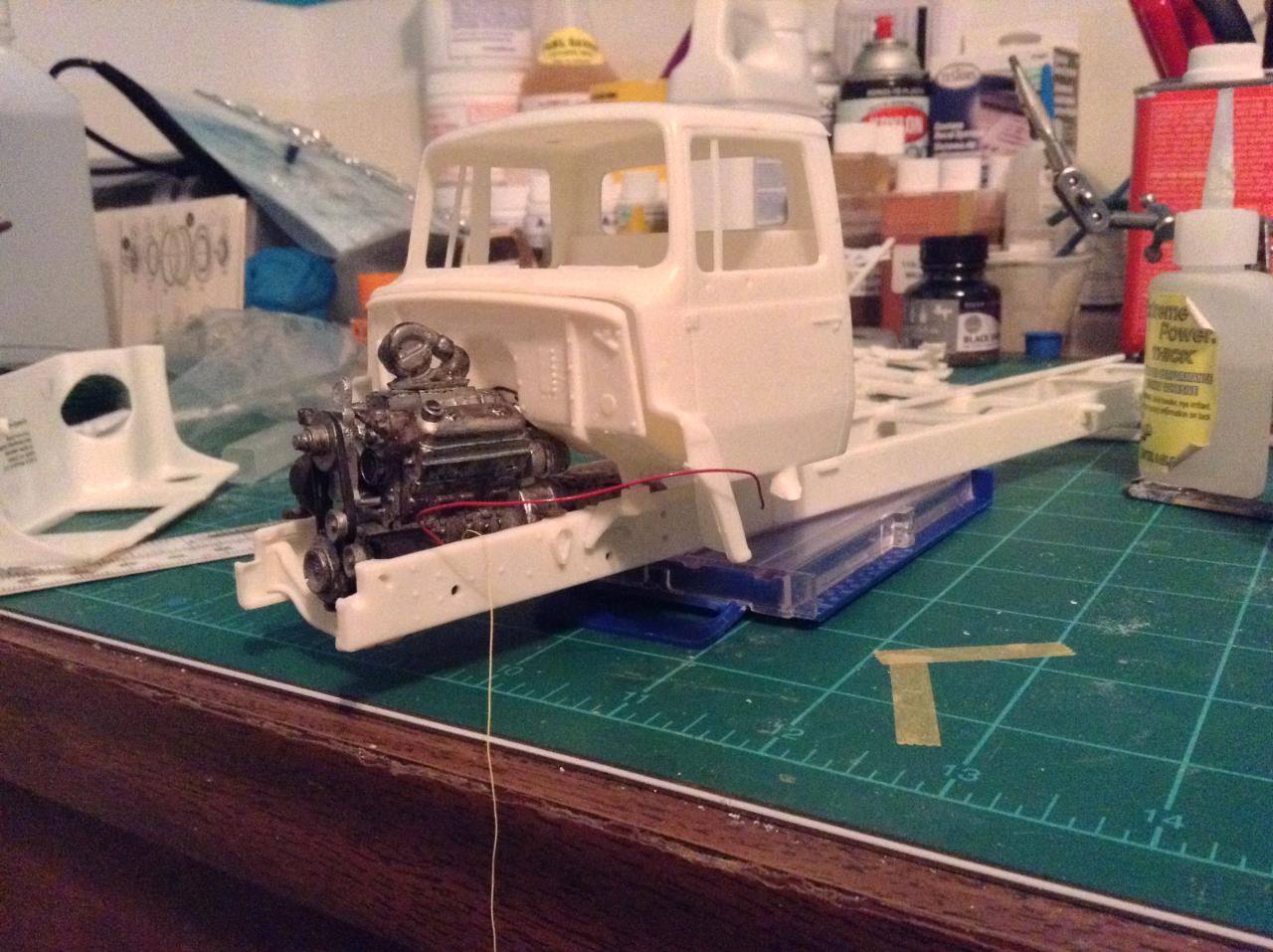

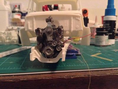

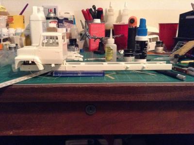

guitarsam326 Posted August 10, 2014 Posted August 10, 2014 (edited) I have the recently released Ln 8000 kit that i bought just for the cab and frame, not necessarily for the race hauler portion. not sure if I will use the V6 that i already built up for another project or if i will build a v8.so here's what i came up with, let me know what you think! Edited November 24, 2014 by guitarsam326
BigBad Posted August 10, 2014 Posted August 10, 2014 (edited) Nice 8V92T, but does it fit under that short kit Hood? The 6V92 likely will but the V8 might be a little tight. Edited August 10, 2014 by BigBad
Jim B Posted August 11, 2014 Posted August 11, 2014 Should be an intersting build. I agree with Robert; you're going to need to use the L hood instead of the LN hood. What rear suspension are you going to use?
guitarsam326 Posted August 11, 2014 Author Posted August 11, 2014 Thanks for posting guys, the engine in the pic is a v6, I'm probably gonna try a mock up with it first, as far as rear suspension, I'm not sure, I was gonna cast rhe suspension from the snow plow truck and use it but I'm not sure how accurate the would be, any suggestions?
Jim B Posted August 11, 2014 Posted August 11, 2014 I don't think the rear suspension from the LNT8000 snowplow wouldn't be strong enough for the mixer from the PayStar. Check with Daniel from Plaskit. He has a Neway air suspension & the L & LTS hoods.

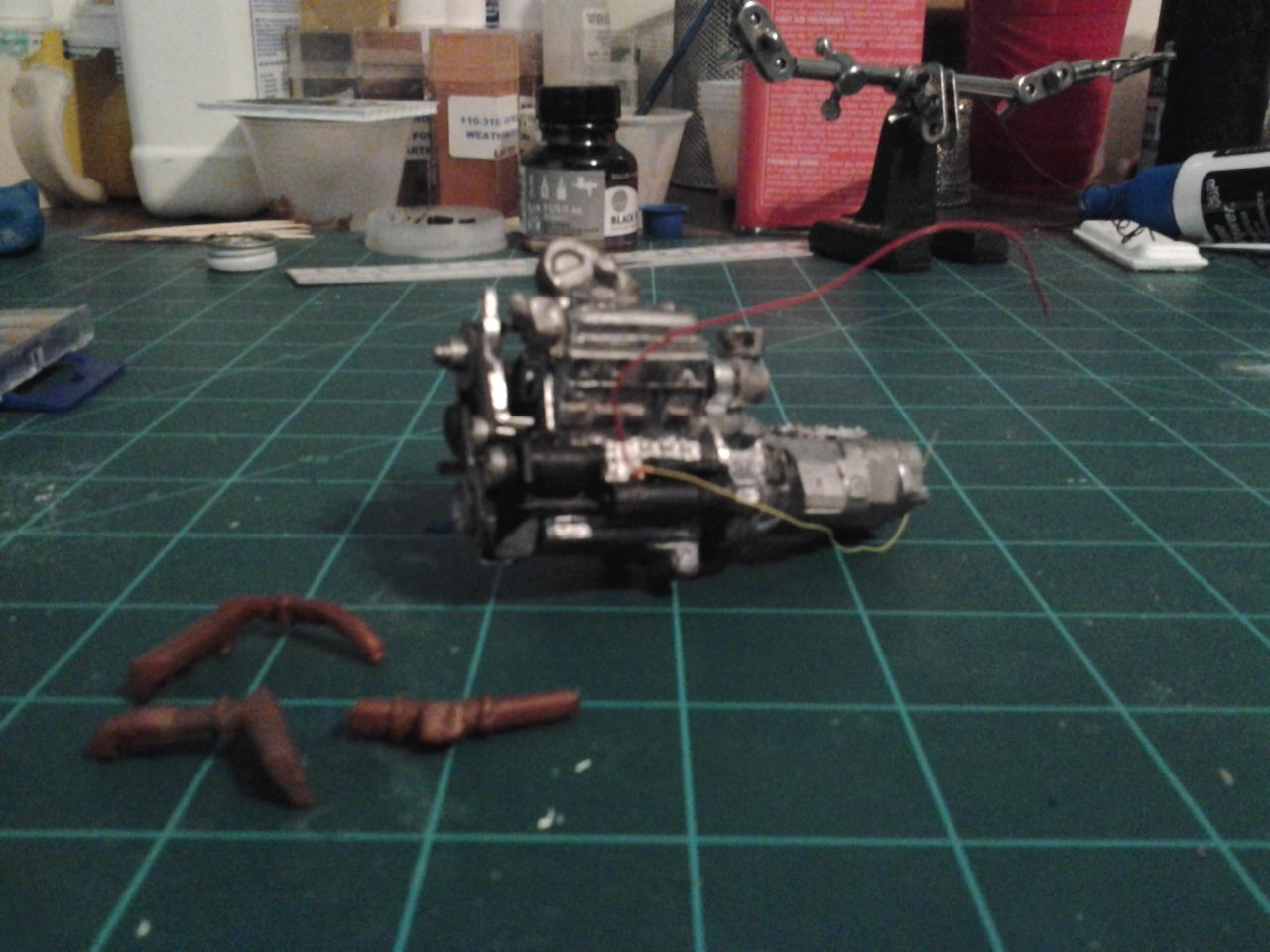

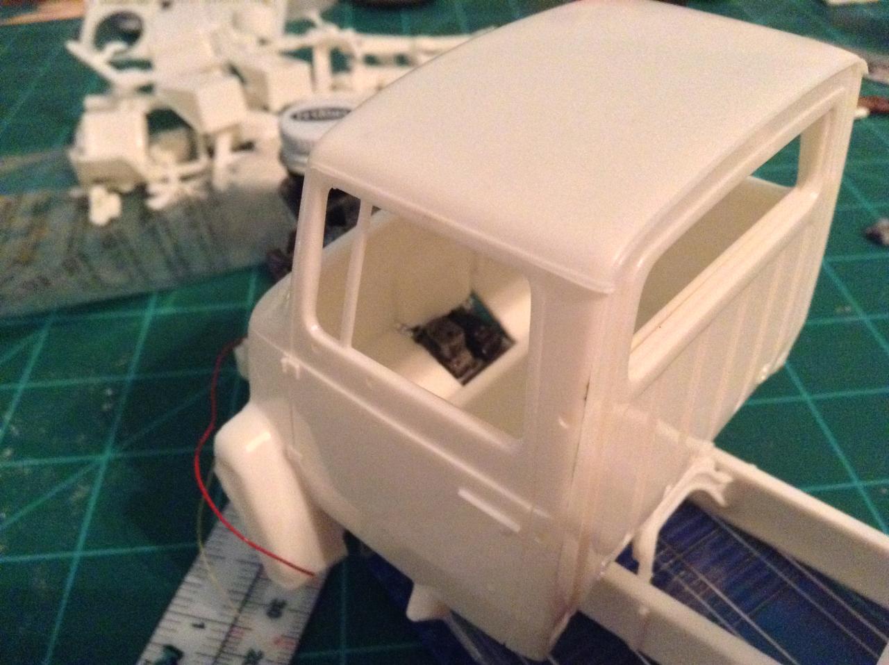

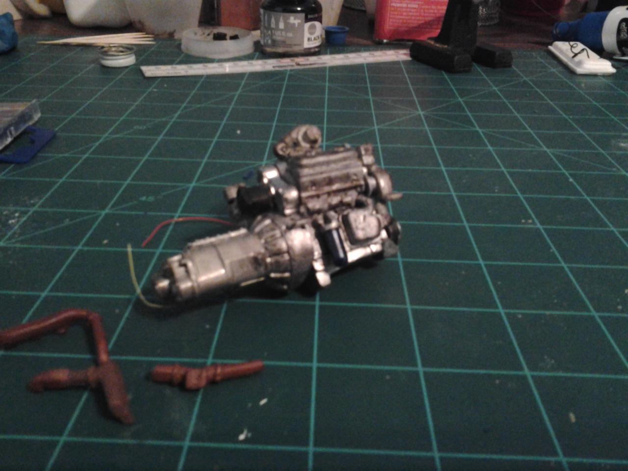

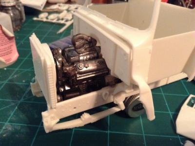

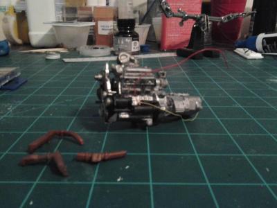

guitarsam326 Posted August 12, 2014 Author Posted August 12, 2014 (edited) thanks for the info guys, and thanks for correcting me james, i forgot to ad the T to make my truck a tandem! i would love to buy a lift axle and heavy duty suspension all together, but moneys is tight with our first little one on the way, so i kinda have to use what i have. I may go with terry's suggestion and just cast the international's suspension, but before i do that, would Hendrickson suspension work or would that still be too light? anyways, i did a little mock up this afternoon and the v6 Detroit fit like a glove, minus having to cut some of the floorboard out, but i'll make a little doghouse and i think it will work just fine. and once again, any suggestion or thought is welcomed cuz 2 heads are better ya know? Edited August 12, 2014 by guitarsam326
guitarsam326 Posted August 18, 2014 Author Posted August 18, 2014 So I'm retracting my previous statement when I said the detroit fit like a glove, what I meant to say is it fit like a square peg in a round hole. It wasn't really that bad, but the radiator really threw a wrench in the whole works. I knew you guys that suggested the longer hood were right, never doubted you for a minute, and I also know the likelihood of an LNT8000 with a mixer body on back is also a little farfetched but I think its gonna look good in the end. Anyways, I think I've made up my mind on the steer tires and wheels but I wouldn't mind a few opinions.

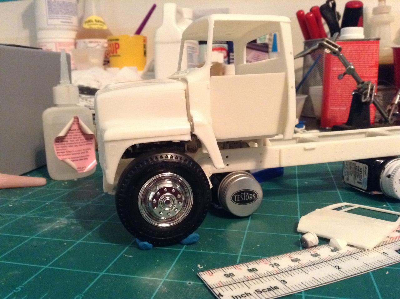

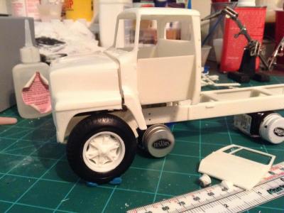

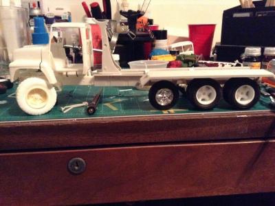

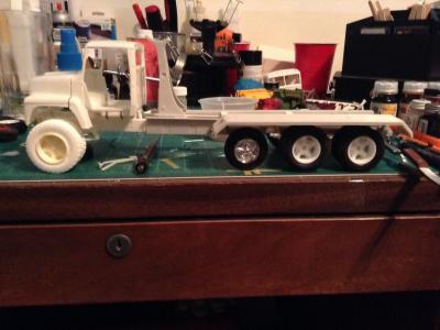

guitarsam326 Posted September 8, 2014 Author Posted September 8, 2014 I have made some progress, doors cut out, front axle now steers, got my floats for the front and the hood is hinged. I also picked up some small piano hinges to hinge the doors with, if it works out the way I want it, also working on a pusher axle.
