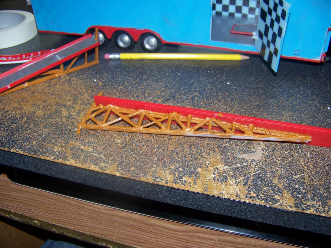

Ace-Garageguy Posted August 16, 2014 Posted August 16, 2014 (edited) A single one inch STEEL tube won't support a REAL CAR very well either, loaded in "bending"...it will bend under weight. You MIGHT LOOK at some REAL structures, and see how the elements are arranged and HOW they all inter-relate to give a structure strength. .040 plastic rod loaded in compression, tension or shear WILL support a model car, but NOT if it's loaded in BENDING.. A knowledge of structures and how they work might also be useful. Modelers ROUTINELY build trailers, roll-cages, frames, etc....ALL from scale-appearing PLASTIC, with no problems. Calling us out?? We've all given you CORRECT information. (PS. I'm an engineer.) In the REAL world, structures are made up of combinations of "flimsy" pieces, put together in such a way as to "reinforce" each other and support loads that are MUCH greater than any individual piece could carry on its own. The truss is a simple example. Each element of a truss is a "flimsy" piece of material, and has limited strength. Put together CORRECTLY, these little "flimsy" pieces will support a MASSIVE weight... Edited August 16, 2014 by Ace-Garageguy

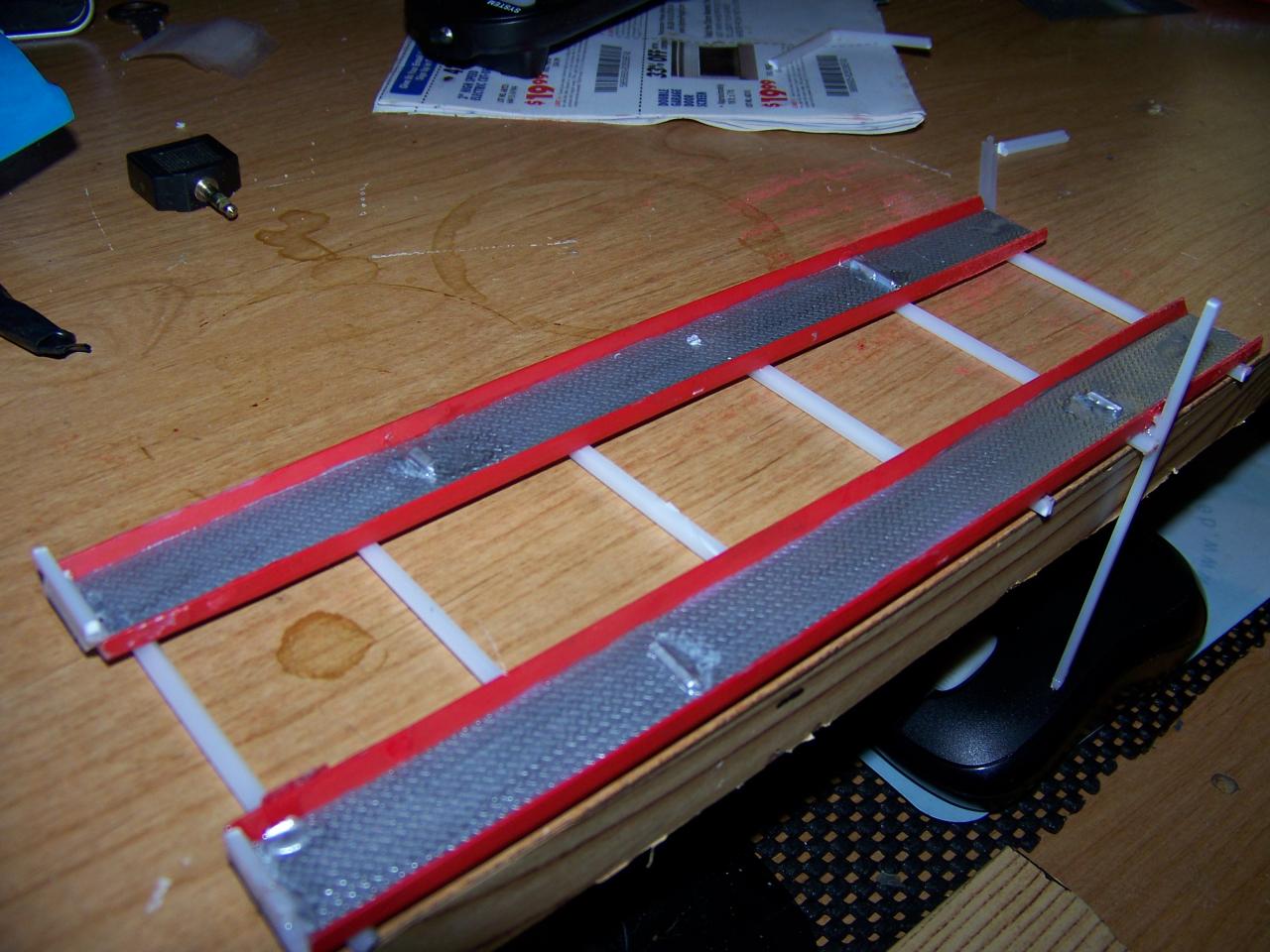

model1:25th scale Posted August 16, 2014 Author Posted August 16, 2014 here is a few pictures that I have taken to make support ramps, but I have used the extra plastic trees from the Galaxie 38 foot fifth wheel trailer. and then I am trying to make a custom transport trailer, and then I took this ramp support apart, and the 3 4 AND 5 PICTURES WILL SHOW YOU. I JUST MIGHT ORDER THE EXTRA RAMPS AND EXTRA PLASTICE TREES FROM GALAXIE. THANK YOU ALL picture will show you what I am trying to do
Ace-Garageguy Posted August 17, 2014 Posted August 17, 2014 (edited) Looks like you're moving in the right direction. Bear in mind that, although many highway standards are specifying 17'6" clearance for new-construction underpasses, there are MANY in the country that are still 14'6". Many jurisdictions also limit overall vehicle height to 13'6". This could be a problem with a car over the roof of the truck cab. Edited August 17, 2014 by Ace-Garageguy

1930fordpickup Posted August 17, 2014 Posted August 17, 2014 I like your idea about the car hauler . You might want to look into brass angle for your main supports. I have not use it but many guys have done some nice projects with it.
