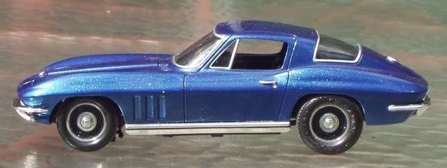

BTW, here's a shot of that blue Vette I mentioned above. Paint is a Rustoleum metallic blue (giant can, cheap!). Now in real life it looks just a bit too "flaky" and "sparkly" but not obnoxiously or obviously so. But boy does it look flaky in the pics! This Krylon sparkle green looks even more sparkly than THIS in real life! WAY too much so for anything approximating factory paint. It'll look great on a custom, though.
